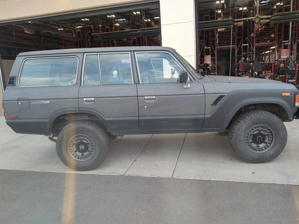

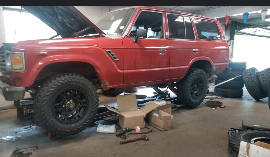

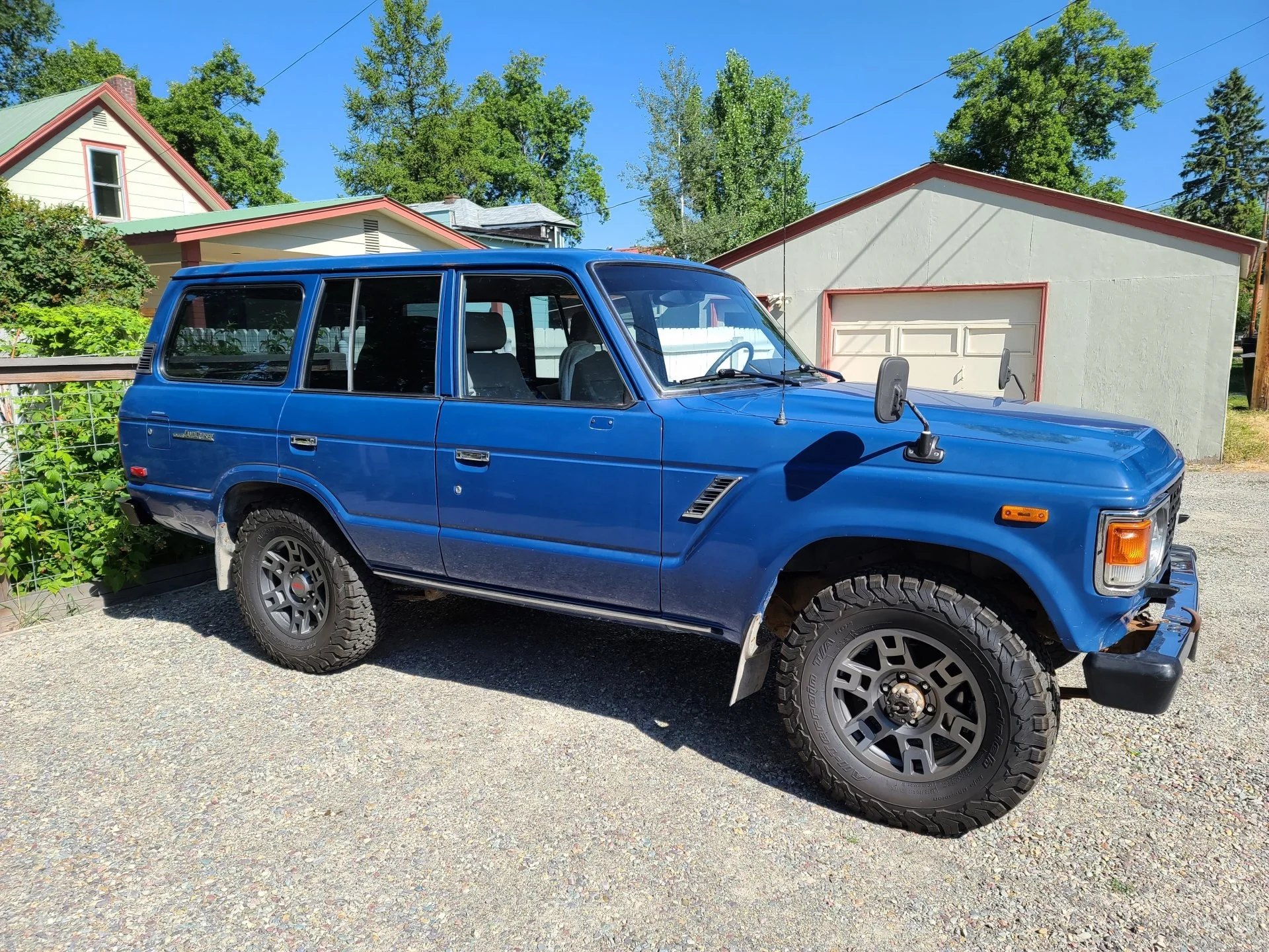

Black Rhino Armory 16 X8 6-139.70 -10 DGMTXX on 33" with 3" OME lift. -10mm offset so no spacers required, though I may put 1/8" up front so I feel more comfortable airing down some.
really diggin the look. BUt wondering if the rear is too much "inward" or jus a funky camera angle.
Those 80 axles will fix that, but nothing wrong with keeping the mud and gravel inside the fender.
I was kinda curious what the axel Conversion would do...

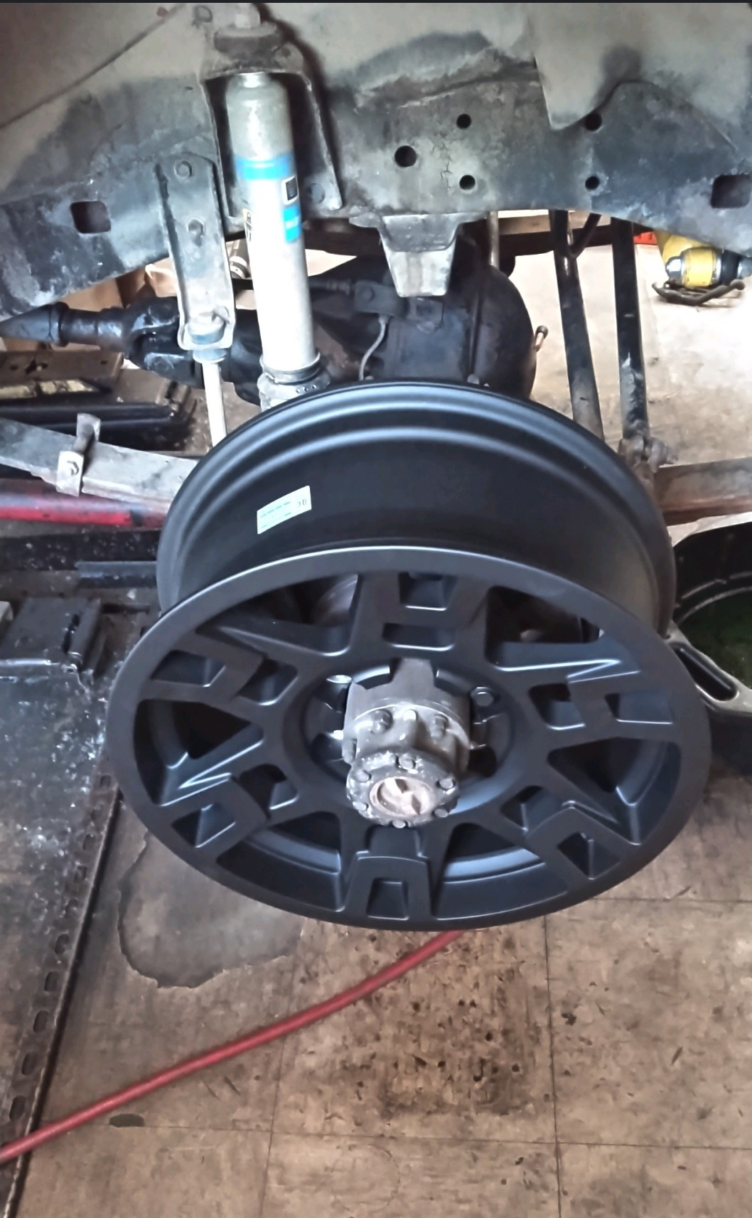

I put the 17x7.5 FJ cruzer wheels on with 195-70's. I had to run 1.25" spacers to clear inner fenders in the rear and leaf springs and inner fenders in the front.
I still get a smidgen of scrub on the front corner of the fender when it's stuffed in a turn. It wouldn't do that if it was on an 80 axle. The spacer alters the steering geometry.

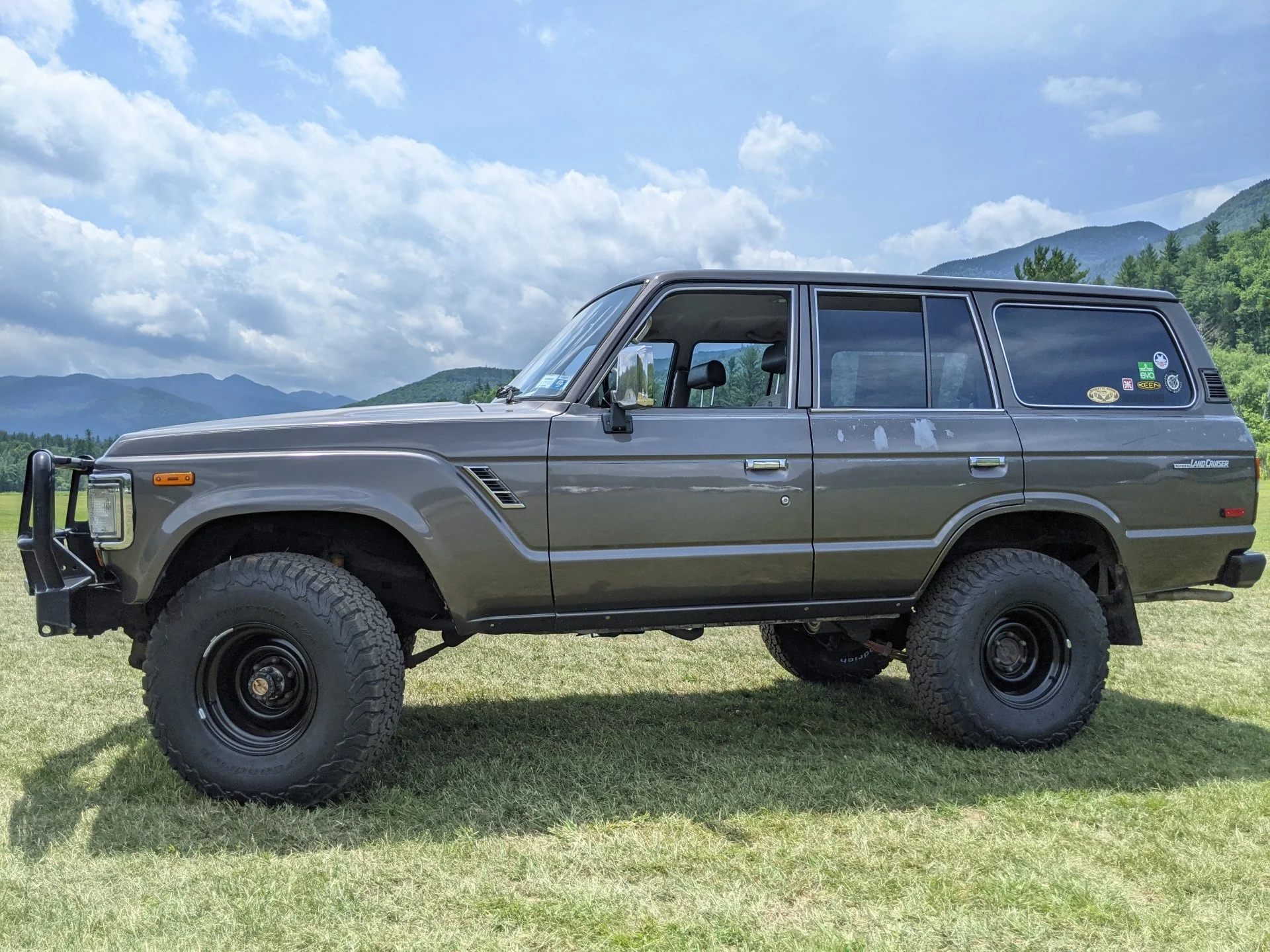

I considered those Level 8 Trackers as well. Ended up with 16x8 steel wagon wheels, black PC, perfect fit and BS, 285/75. IMO, that tire size looks fantastic on these wagons if you want the slightly bigger, less tall skinny look.

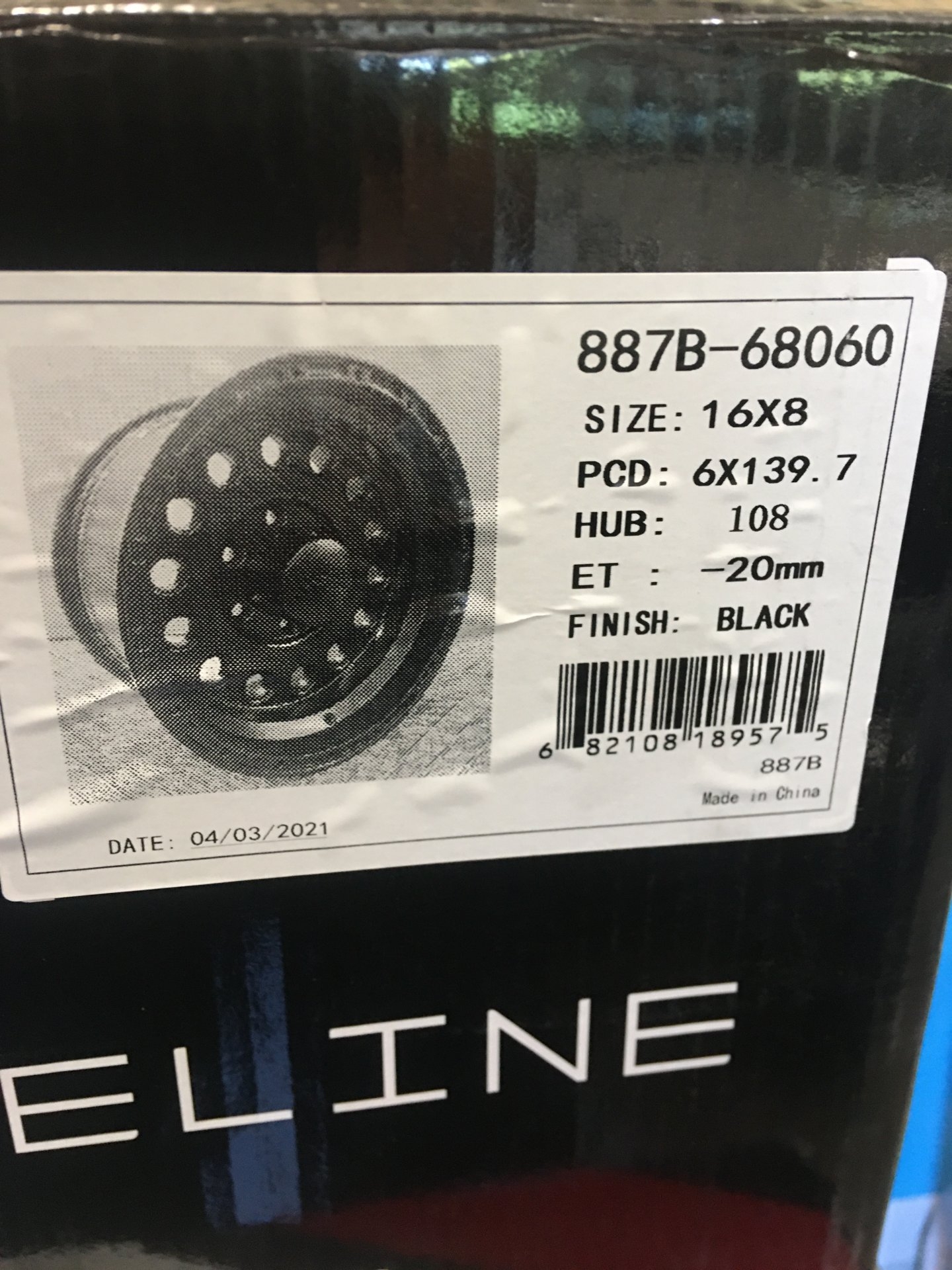

Hey @Skniper, do you have any pics of the wheels on the tire and a part number for the wheels? I'm thinking of doing the exact same thing with my 62

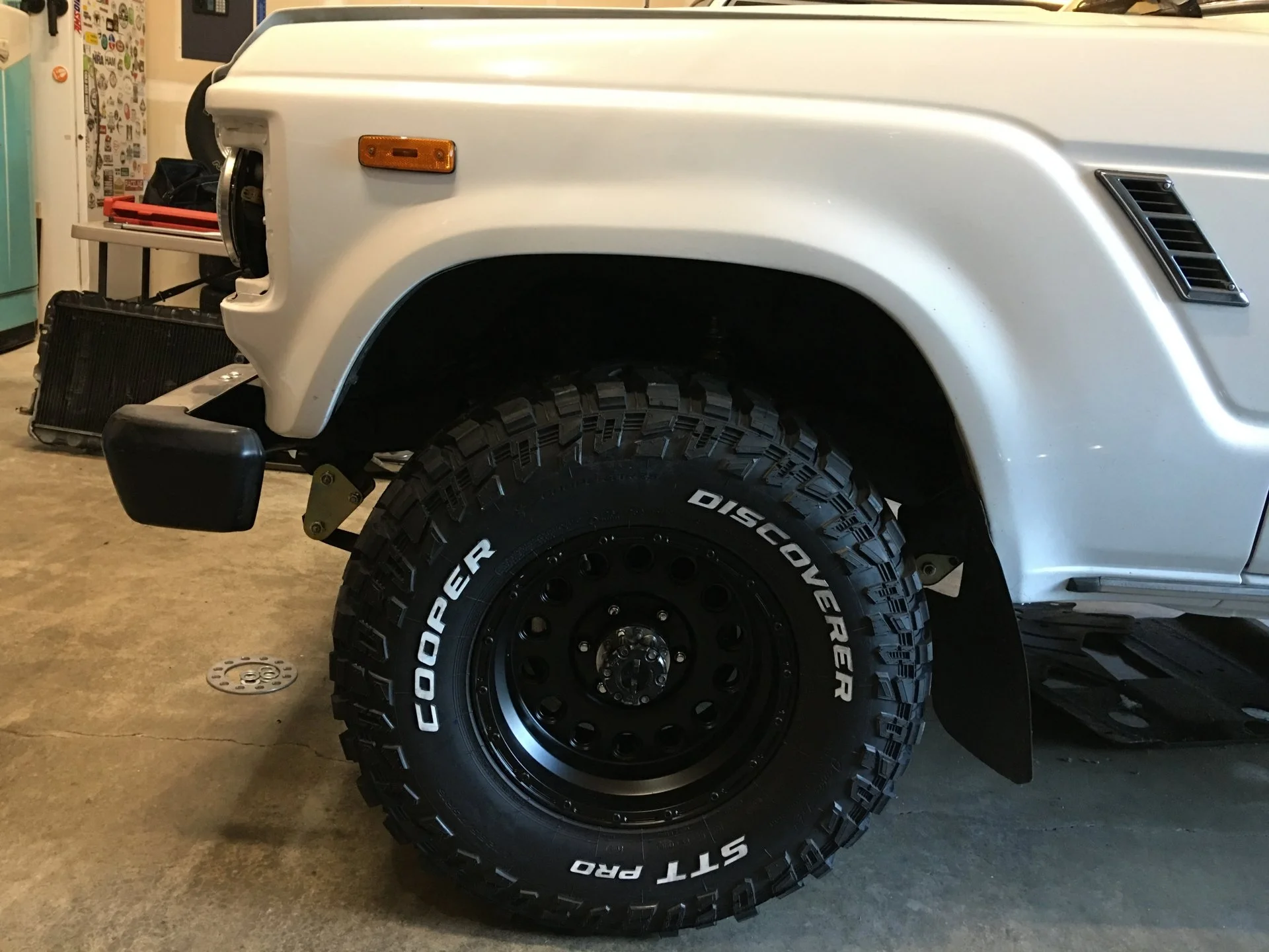

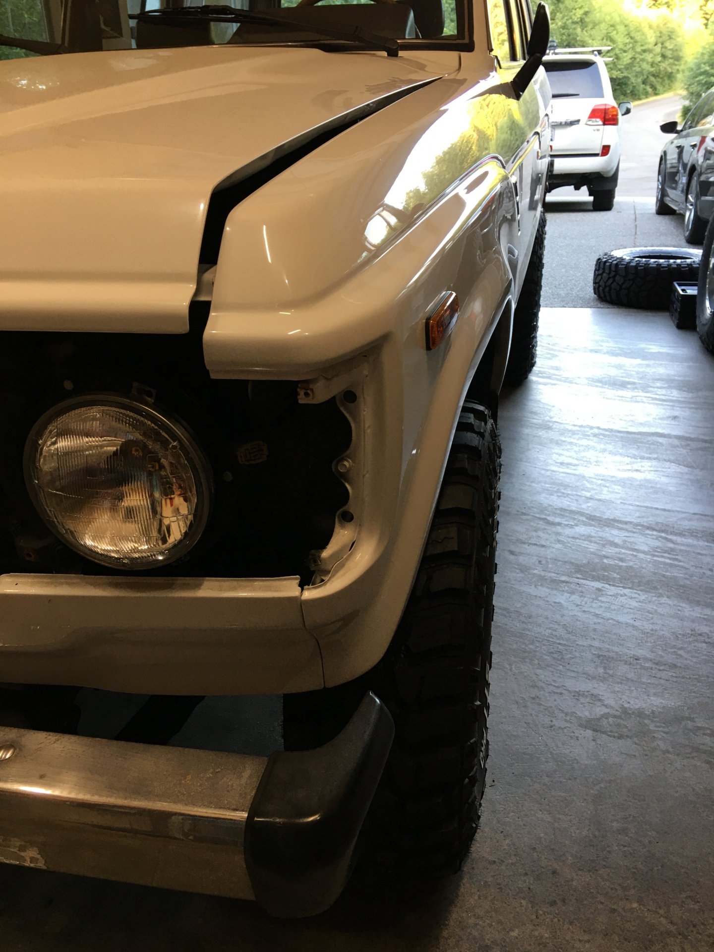

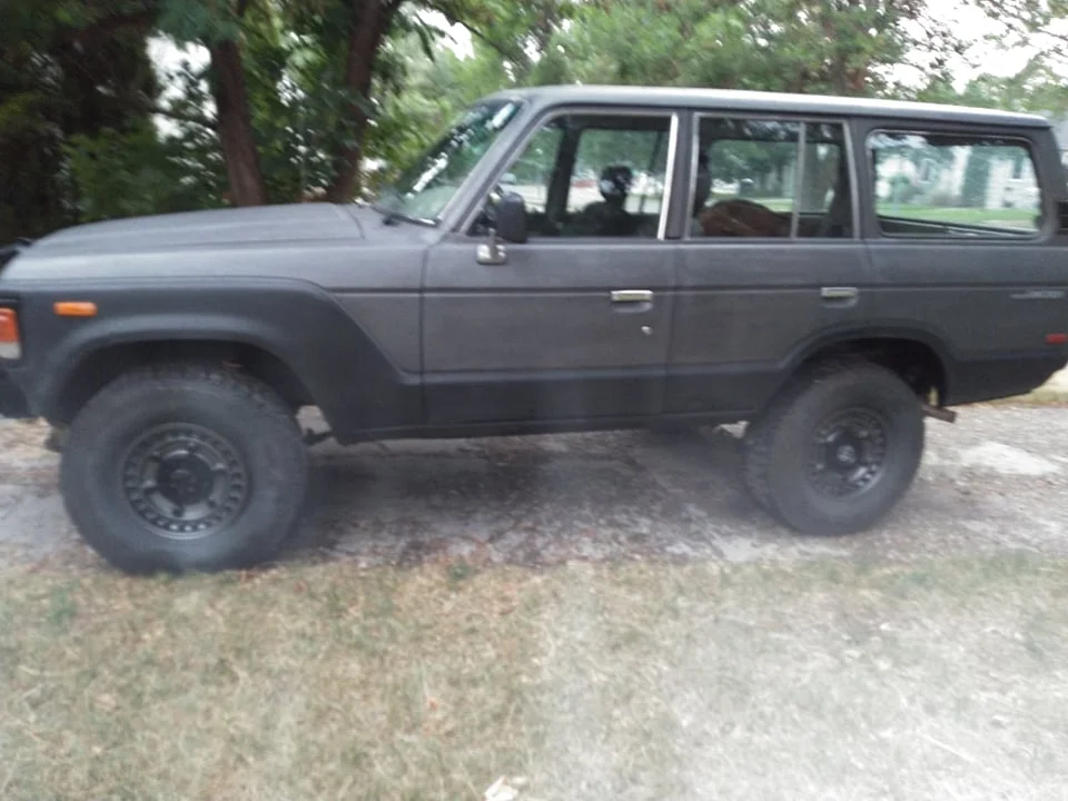

Raceline Rock Crusher 16X8
6X139.7
-20mm offset
3” OME
285/75/16
No spacers, plenty of space
