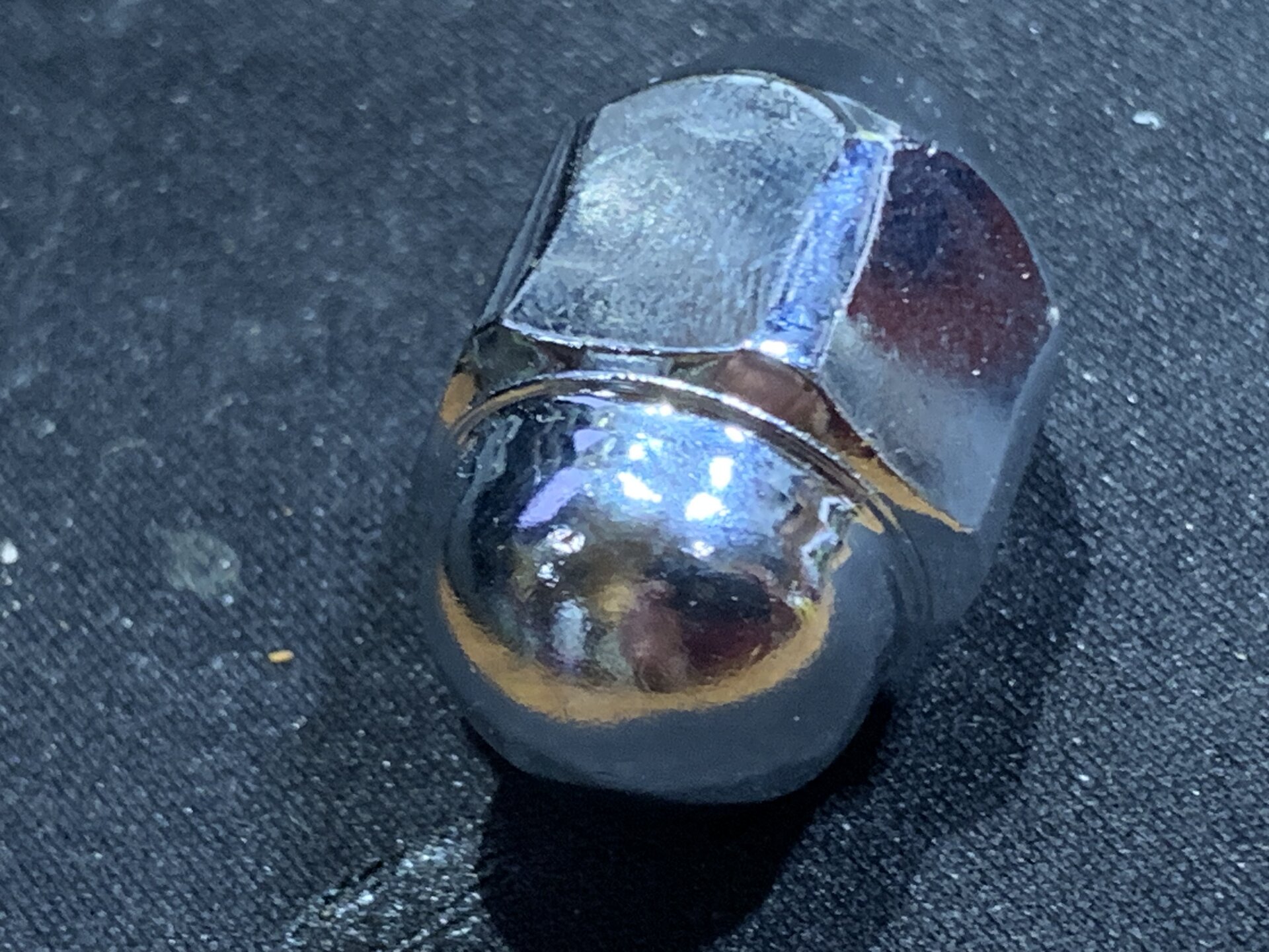

- i installed OEM LUG NUTS 90942-01021 ( SUPER THICK JDM CHROME ! )
Awesome looking Matt! How are those different than 90942-01104.....i came up with that number looking at the FJ C 17" steel wheels....but not sure if that is correct for Chrome?
here are the part # you posted Hunter
bevel to top of HEX is same ,
its the ACHORN cap that has a different profile
not sure about the chrome topic
you should order qty x 1 from dealer first to see sample before u buy a full set thats what i did ,
i had a NOS one in a selaed parts bag , thats how i knew , but toyota has changed plating cosmetics and NOT supersceded parts #'s before too ..........fyi
