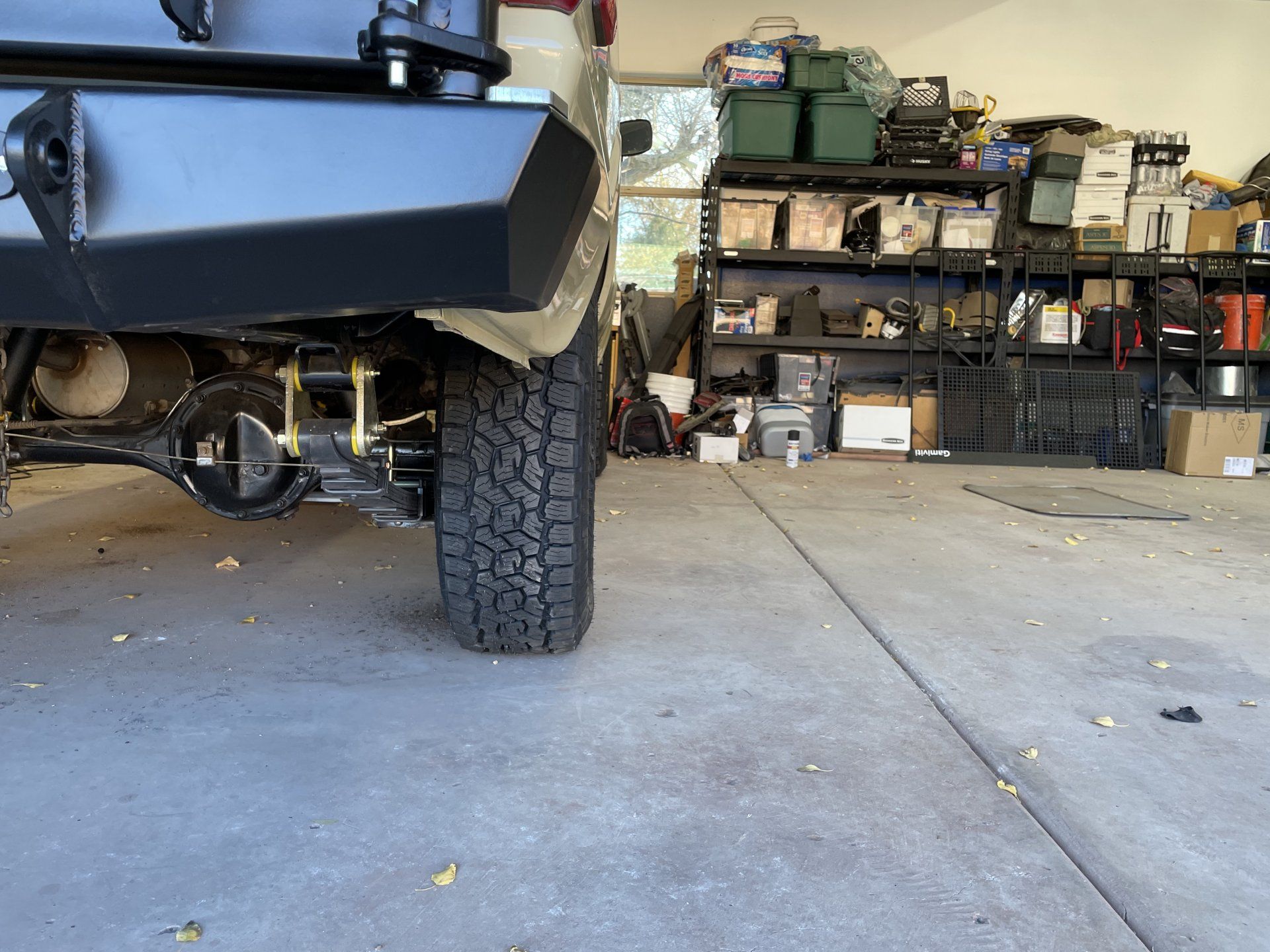

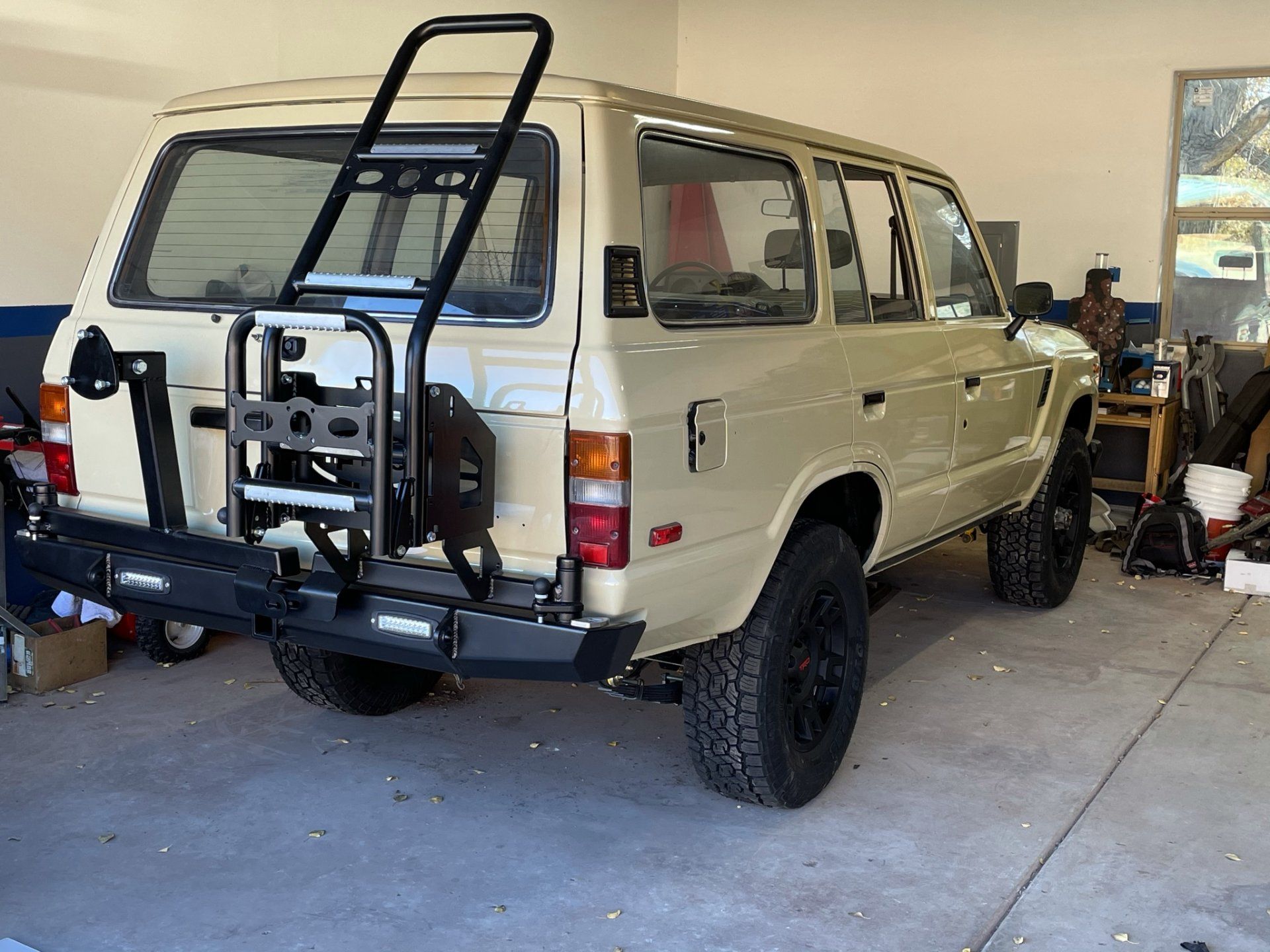

Finding wheels for the FJ60 was a pain! Thanks for everyone that’s posted here, it sure helped! I decided to go with the TRE Pro wheels! I didn’t want to use spacers and couldn't find the right back spacing. They are wrapped in 265/70/17 Toyo A/T 3. Had planned to go with 275/70/17 bfg ko2 but, it only gained 1/2 inch and were $55 more per tire.

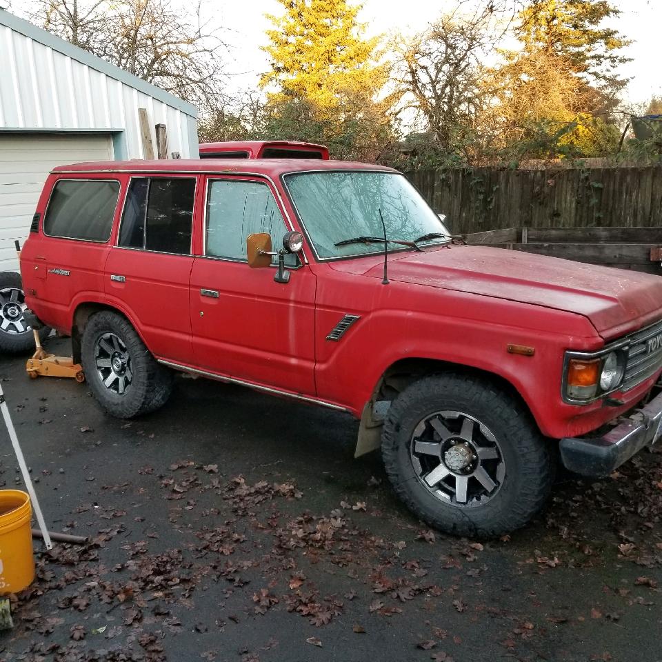

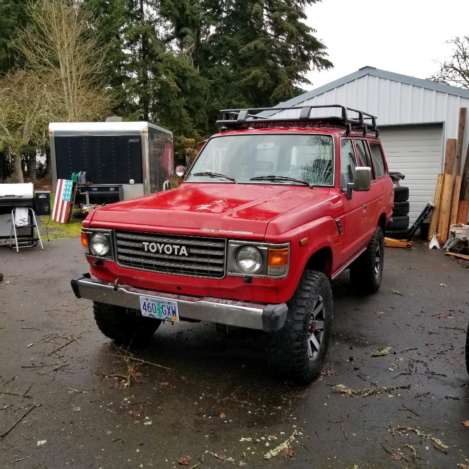

I did this to get away from the FJC / Tundra 17x7.5 steelies, with -14mm offset, since I had to run a Spidertrax 1.25" wheelspacer to make this set-up work. I DID, fwiw, run 35"x12.5" E-load Geolandar g003's on those for 10K or so, and RARELY rubbed unless I was flexing off road really hard. Found these same tires on the new rims rubbed a bit more than I liked at 1/3rd turn uptravel, so I downsized to 33's and a softer D-load tire.
Here's a picture of that:
I love the new wheels, and they sustained 1000+mi of abuse in DVNP a week or so ago with no hiccups or hernias.

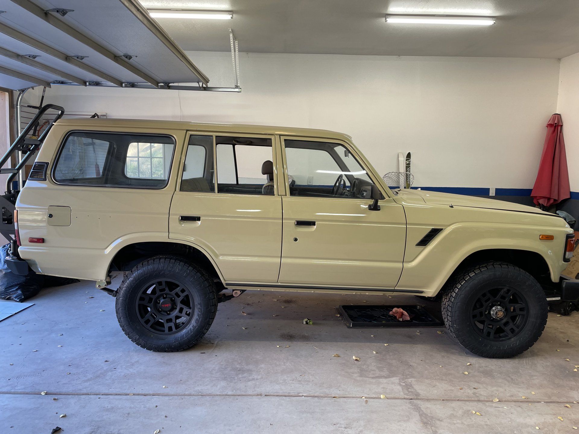

Recently picked up a '87 60. The stock wheels and old tires were chewed up, so I picked up a new-er set of wheels and tires (less than 800 miles on them).
