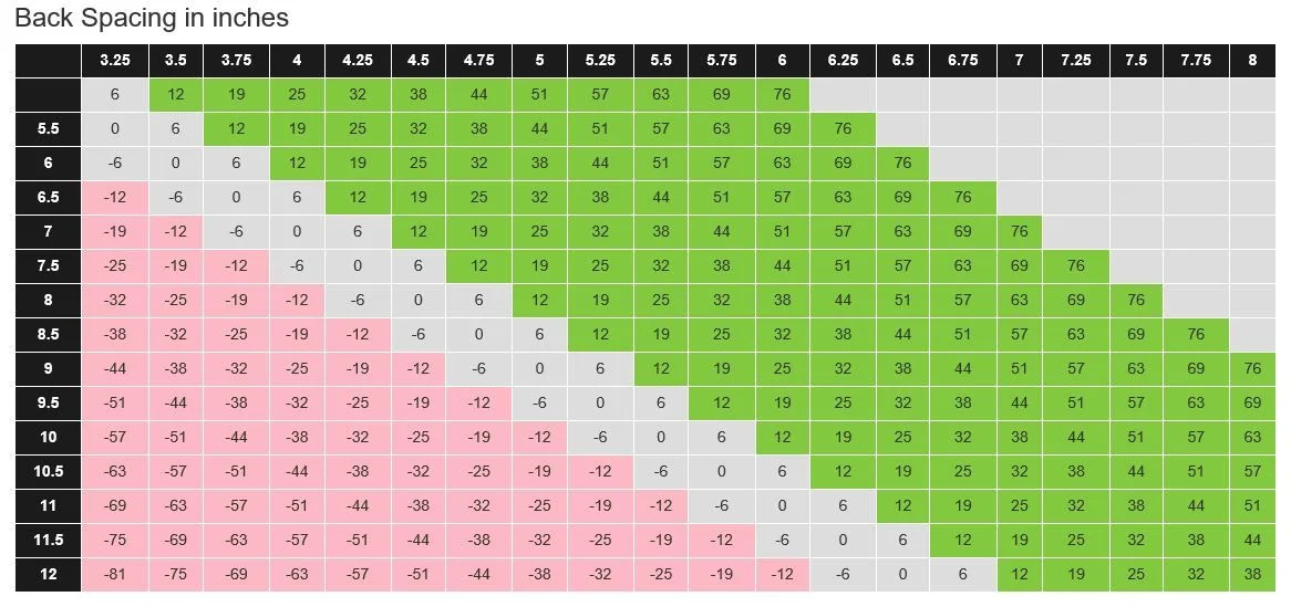

Great explanation. There are also some handy online wheel spacing calculators that can help you visualize the above concept:
Will They Fit - Online Wheel and Tyre Fitment Calculator
Wheel Offset Calculator
Wheel/Tire Calculators | Custom Offsets

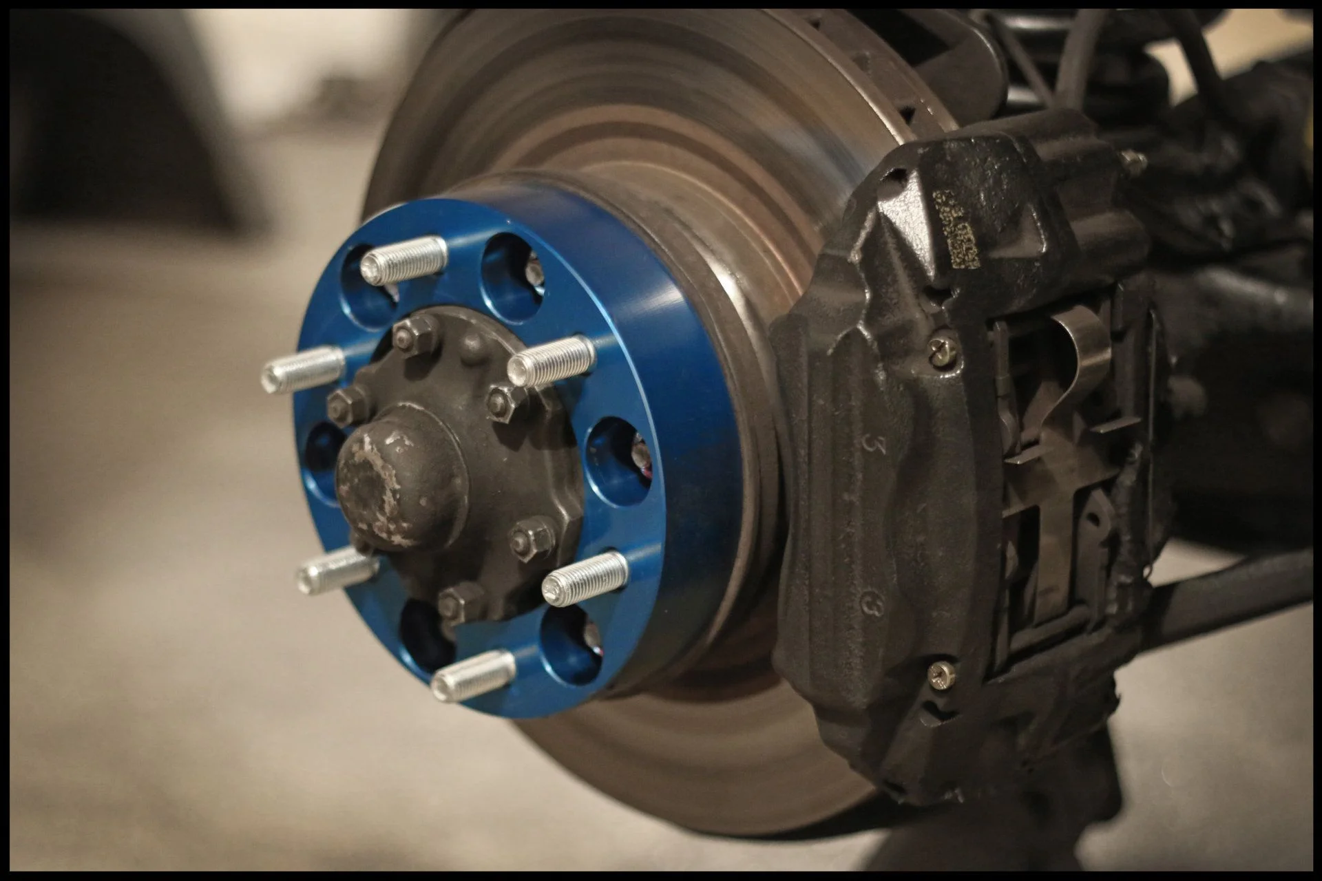

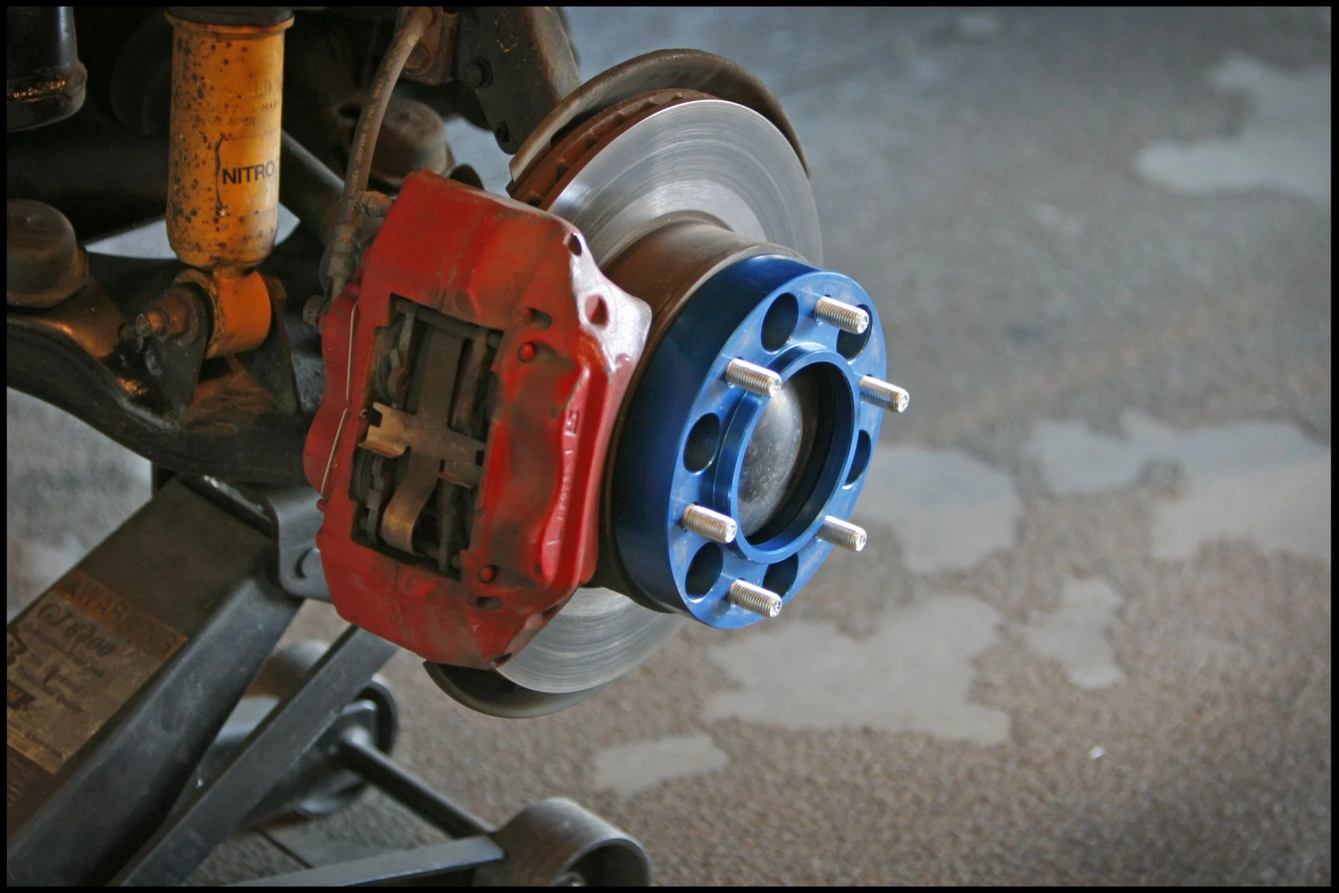

Do you use lug or hub centric wheel spacers @Box Rocket
I'm not aware of any hub centric spacer options for the 80. Here's the spidertrax spacers I have on my 80. They use conical nuts to center them on the stock lug studs. Wheels for the 80 have a center bore that fits over the outer diameter of the hub, which centers the wheel to a degree but depending on the wheels you have they will either have conical lug nuts to center the wheel properly on the spacer studs, or, in the case of later style 80 factory wheels, they will have flanged lug nuts with a shank that fits in the lug holes of the wheel to center them properly on the wheel studs.
SpiderTrax 80 series Front spacer. These are lug centric spacers.
Spidertrax 80 series rear spacer
In contrast, here is a shot of the Spidertrax spacers used on my Tacoma. These are hub centric spacers. There is a lip on the spacer around the center which will fit inside the center bore of the wheel to center the wheel properly. This lip is not there on 80 series spacers.
