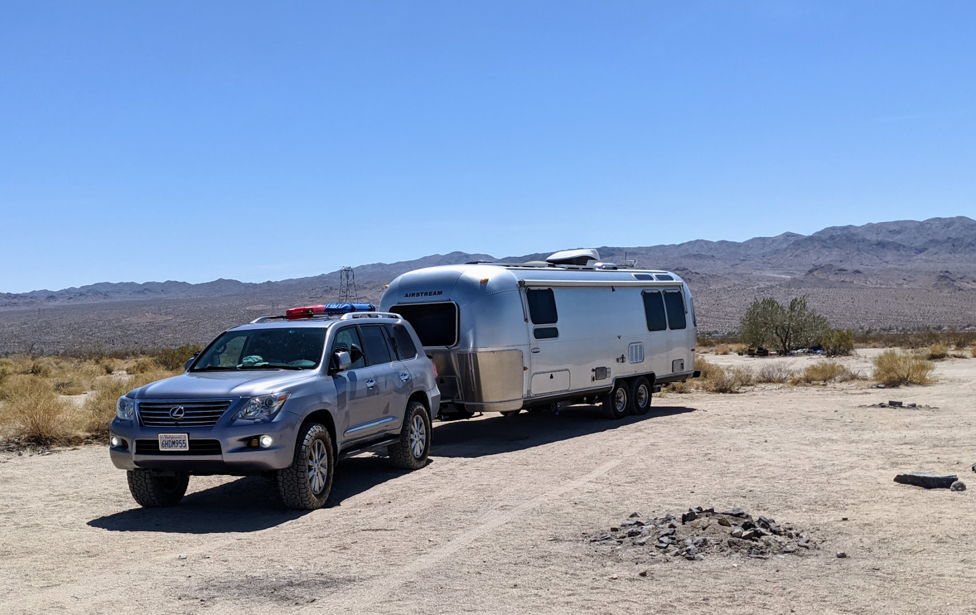

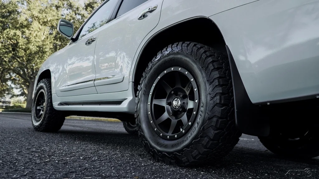

I want a similar look of this setup... not sure it's 17" or 18"

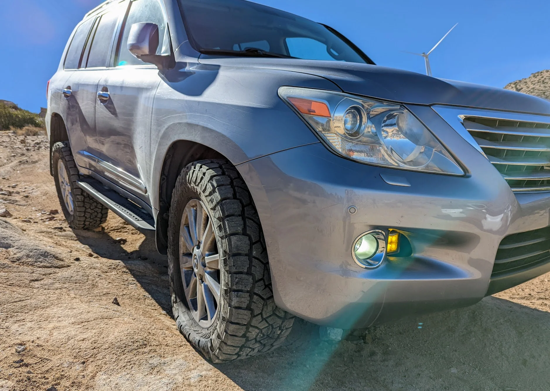

I’m running a 295/70/18 (34.5x11.5) at 30mm offset and do not need a body mount chop 👍
