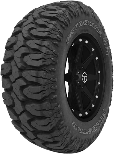

here's another wrap around lug pattern
Milestar Patagonia M/T
Nice! Although the seam is visible, it is indeed a "unilug" shoulder design. Looks pretty sick too.
Here is the "seamless" design for reference.
When aired down on your steering axle that would make for really solid and wide contact patch which im guessing is more durable and less likely to shear.
On all the others you can see where the tread face ends and meets the sidewall pattern exactly at the shoulder and joined at that seam.
I know its not all of them, but for sure some of them are just two separate elements butted together.
Seems like mostly MTs that are like this Patagonia, maybe some "true" hybrids as well.
Either way this is probably a rare failure mode if at all and just an interesting thing ive been thinking about.
Perhaps someone knows what the integrity of this sort of fused rubber weld is like and can enlighten me.
