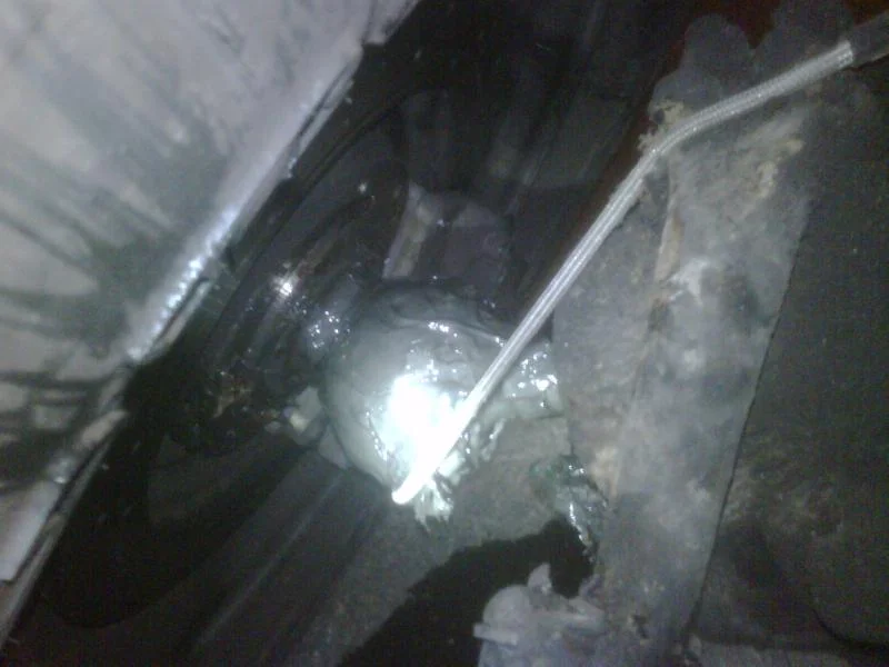

Wheel fell off- broken birfield?

I think the backing plate theory is a good one. It looks like the caliber broke off too. It is down on the ground, still on the disk, looks like it went around once and now the brake line is wrapped tight around the birfield.
AH! good point you would think the caliper would stop it from flopping out like that . i haven't seen the M-A-F conversion kit either :cheers:
I am pretty sure the discs are the Man-a-Fre conversion kits. That brake line sure is holding its own though (knock on wood).
If your truck still has the 1971 front axle, then it is very likely that it has this style of disc brake conversion.
That would also explain why the caliper is still with the rotor after the bolts that hold the spindle to the knuckle fail, as the caliper bracket is retained to the knuckle by the same bolts that retain the spindle.

What is depicted in the picture is not indicative of a spindle nut failing, as was suggested in previous posts.
The spindle nuts retain the wheel bearings to the spindle. They do nothing to keep the spindle attached to the knuckle.
The only way you can have an axle shaft walk out of a knuckle is if your fasteners that retain the spindle to the knuckle have failed.

Looks like the root cause was a dustcover that wasnt omitted by the previous owner during the disc brake conversion. This only allowed one or 2 threads of each of the 8 bolts holding everything together. Needless to say, all found their way free. I'm definitely feeling lucky this didnt happen while I was moving at any appreciable speed.

It's at Mudrak now for a rebuild of both sides. It was definitely towed up there, even that was a challenge as the brake line was the only thing holding the wheel to the vehicle.

Looks like the root cause was a dustcover that wasn't omitted by the previous owner during the disc brake conversion....
The second picture in this post shows it is a MAF FDB kit. I had one of these POS kits for a short time. These do not come with or use any dustcover so that blows your theory out of the water. The bolts attaching the spindle to the knuckle failed due to some reason. This could be anything from improper torque, too few bolts used, not the correct bolts, not safety-wired, etc). This kit utilizes the (8) stock 8X1.25mm bolts that have drilled heads for safety-wiring. I'd take a close look at the otherside to see what was done...it may not be too far behind.

Please post up a follow up diagnosis of what happened to the spindle bolts, if they failed, why they failed, etc. The torque spec is fairly low for those and they could easily be over torqued if run in with an impact.
The original dustcover was left in thus not allowing more threads to engage. Gary told me the instructions for the kit meant for that dustcover to be removed for the upgrade.
