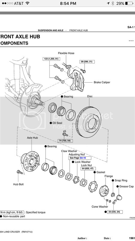

My schematic shows an inner and outer bearing.

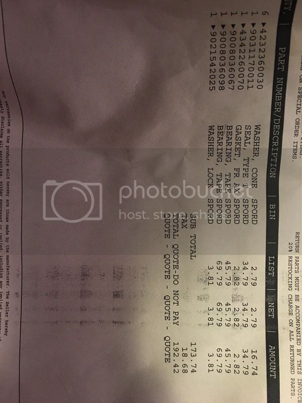

Hmm, I don't know if I ordered a new thrust washer. I ordered all parts in the schematic that were marked non-reusable. I'll upload my order form and let me know if I missed anything.
If you missed it this time you'll probably be fine, they're usually in good enough shape to reuse.
This is what I ordered.
Yes, sorry, I get confused as well. It can be reused if in good shape. Some with worn bearings see scoring on the claw washer, that is when I would replace.
