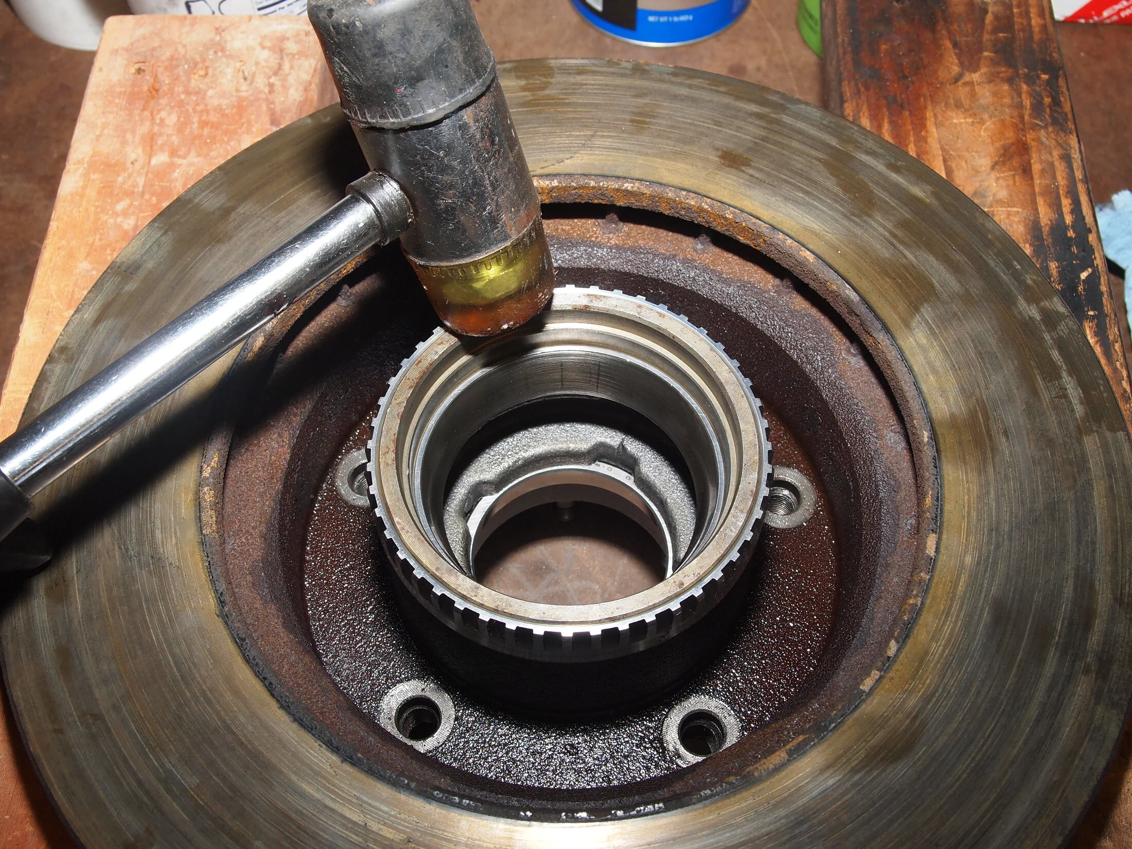

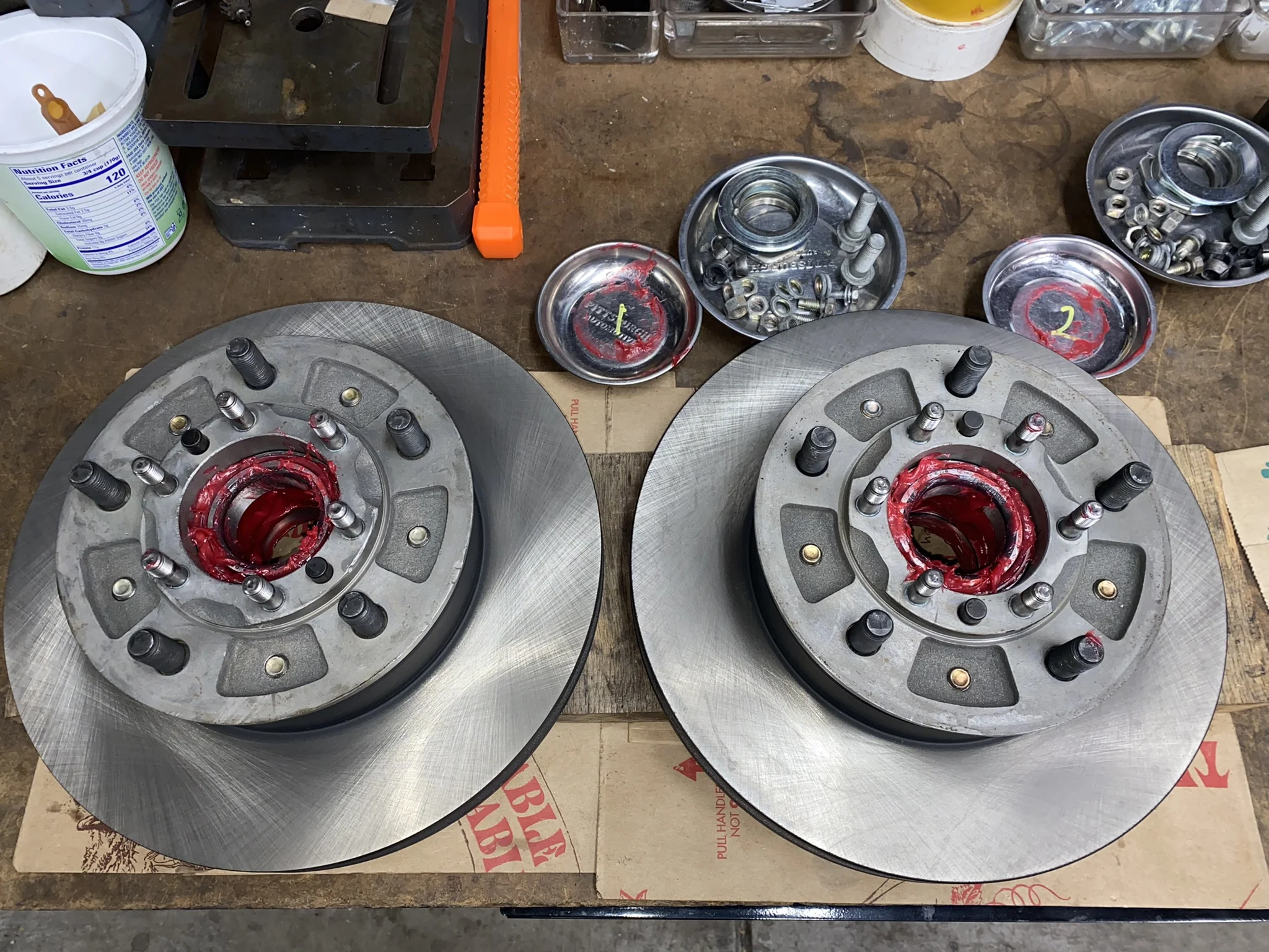

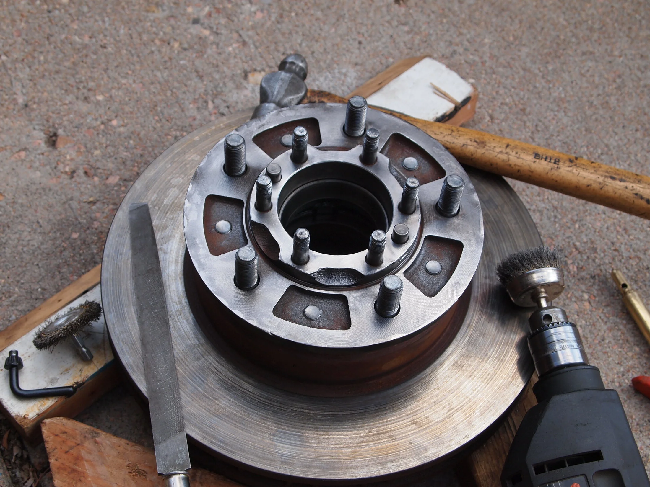

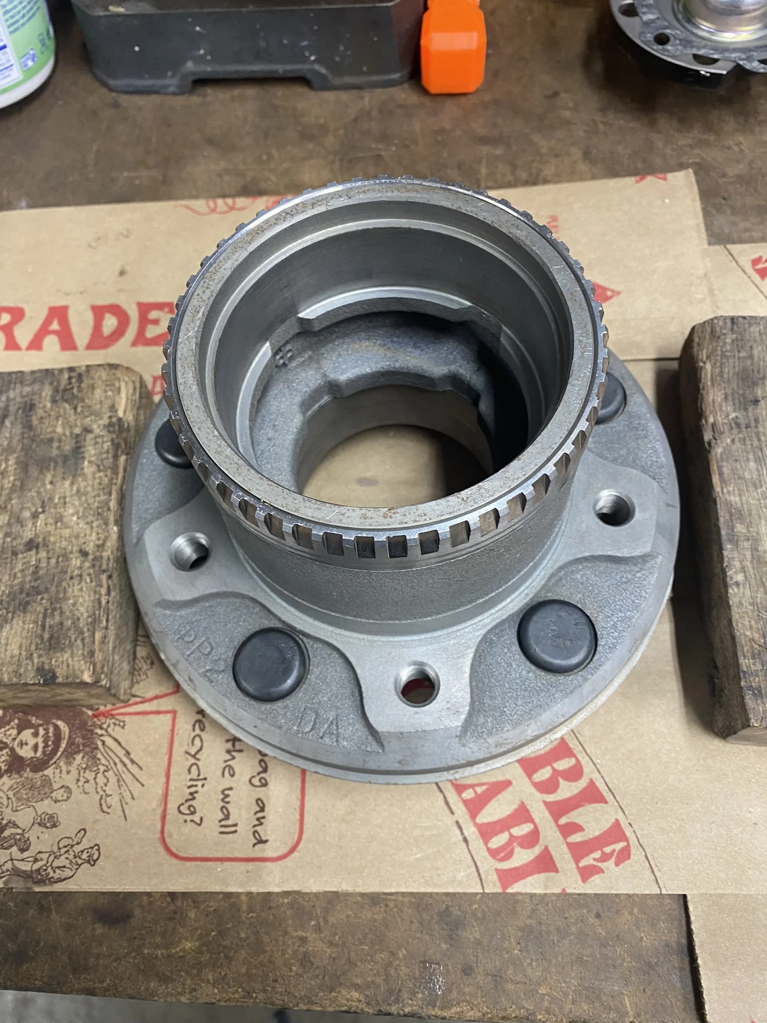

Removing rotor from wheel hub, once hub remove from knuckle:
  1. Scrape inner hub area/cylindrical that rotor must pass over to remove baked on brake dust and rust (crud rotor disk may get hung up on). Get off the harden brake dust and rust best you can. Power wash.
  2. This step for the crudy rust stuck on rotors. Place wheel hub with rotor, in a catch pan. Add ATF to inner area where rotor bolt head are. ATF is and excellent penetration and derusting oil. Let AFT soak in, overnight.
  3. Remove the five 17mm bolts.

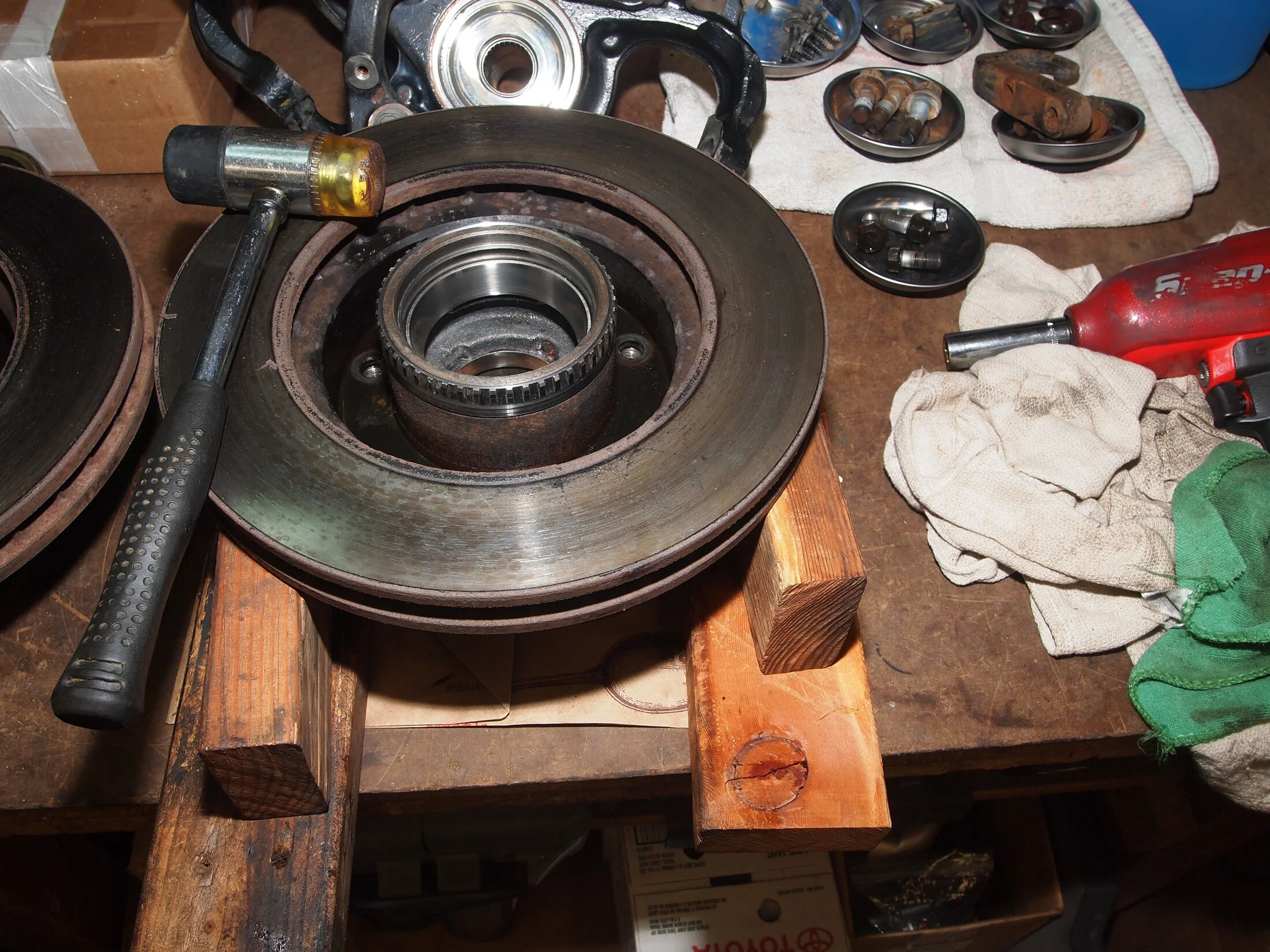

  4. Place rotors disk on wooden blocks. High enough so that wheel hub suspended in the air (off your working surface)
  5. I use a dead blow hammer, and pound on back of wheel hub. Pound wheel hub off rotor, by hitting in side to side pattern. Alternately, use a wood block to protect wheel hub or a lead hammer. Whatever you do. Do not damage wheel hub, by hitting with hard metal. Ever these brass hammers, which are forged brass, can damage the wheel hub. We must not damage the seal seat area and the teeth, speed sensor reads on back side of wheel hub.

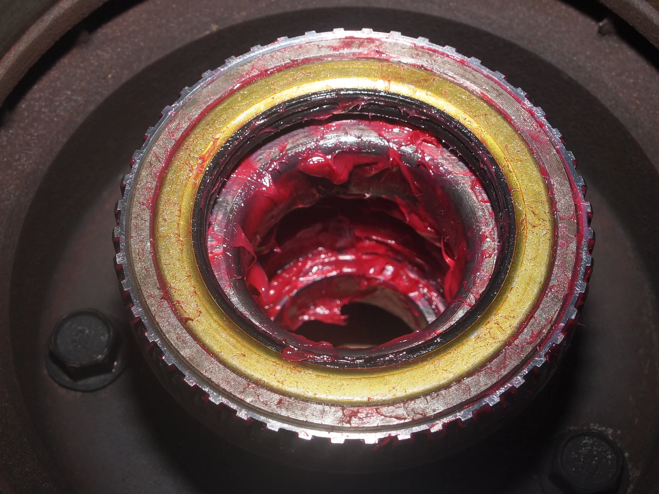

    After cleaning inner wheel hub, I soak overnight. I place in catch pan, since ATF will seeps out, as it frees rust and brake dust crud.
Rotor disk, is set on wooden blocks to suspend wheel hub above bench. So it can pass through rotor without bench interference.
NOTE: I no longer use these plastic hammers.
I no longer use these plastic hammers. I found, as I pounded out really stuck rotors. The plastic gave way, to the metal within. This can damage the hub. I've found a dead blow hammer works the best.

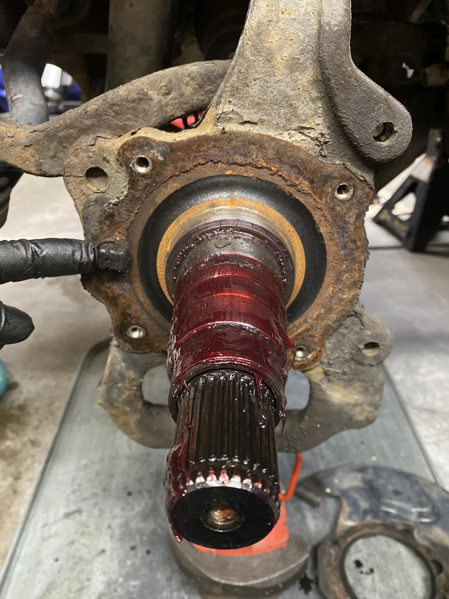

Axle needle bearing, is one I've found difficult to diagnose. They do tend to quiet down over ~25 MPH and mostly heard at 5 to 15 MPH. To me, kind of a scapinging sound.
First zero in on which corner (wheel). Then pull out FDS axle. Look at axle where needle bearing rolls. If scored more than what would be normal for the miles, replace needle bearing.
Axle bearing are also required to be lubed, with every 30K miles wheel bearing service. Unfortunately they almost never are lubed/greased.

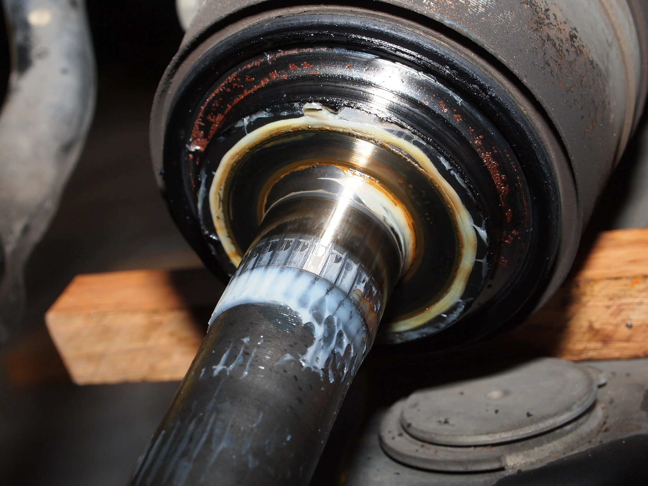

This FDS axle had less than 2K miles on it. Yet scoring where needle bearings rolls, and color (indicating excessive heat) worse than seen on some at 250k mile, that were never lubed.

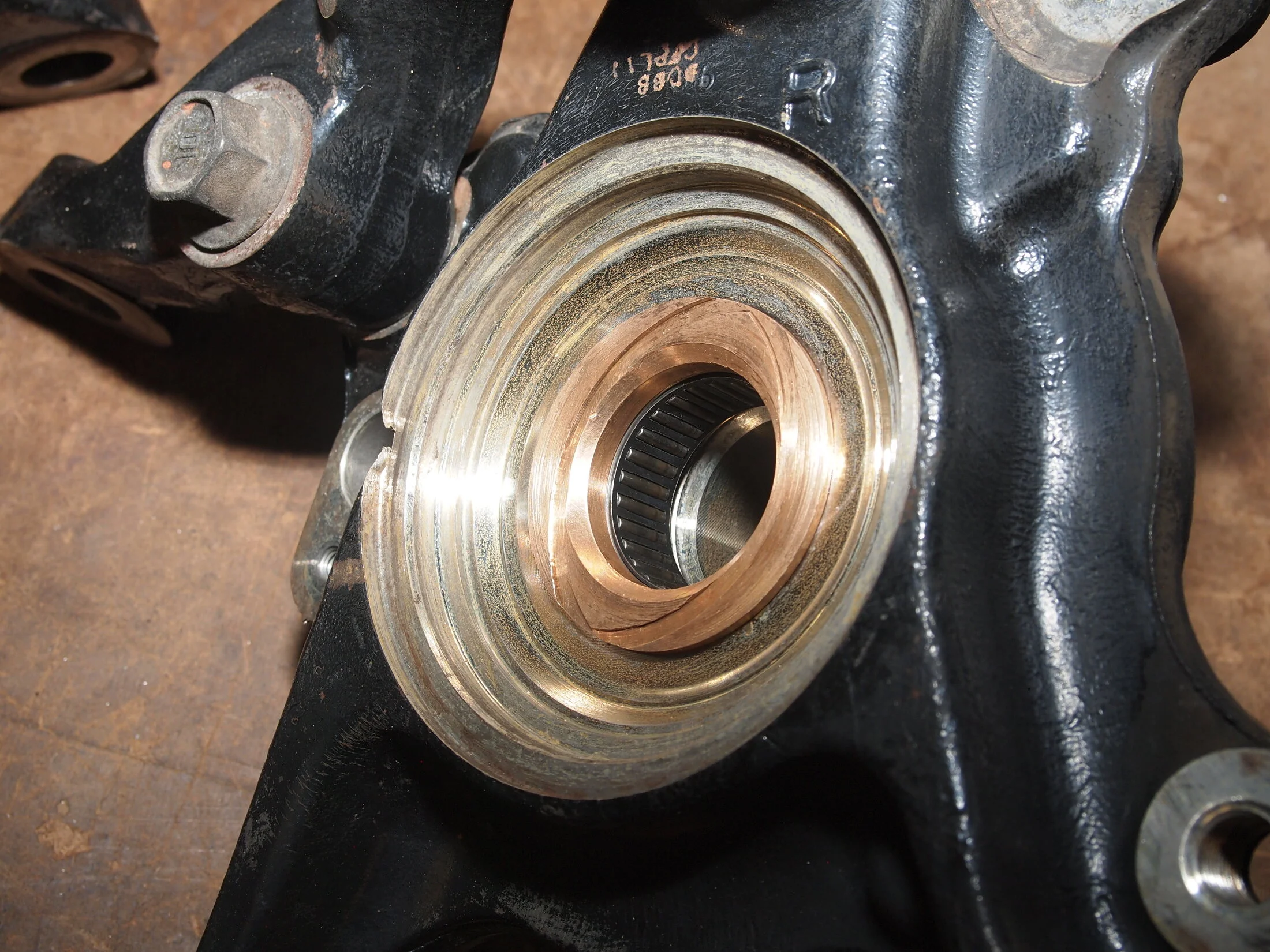

It is possible to R&R needle bearing, brass bush & seal in place. But it is much easier to just pull knuckle.

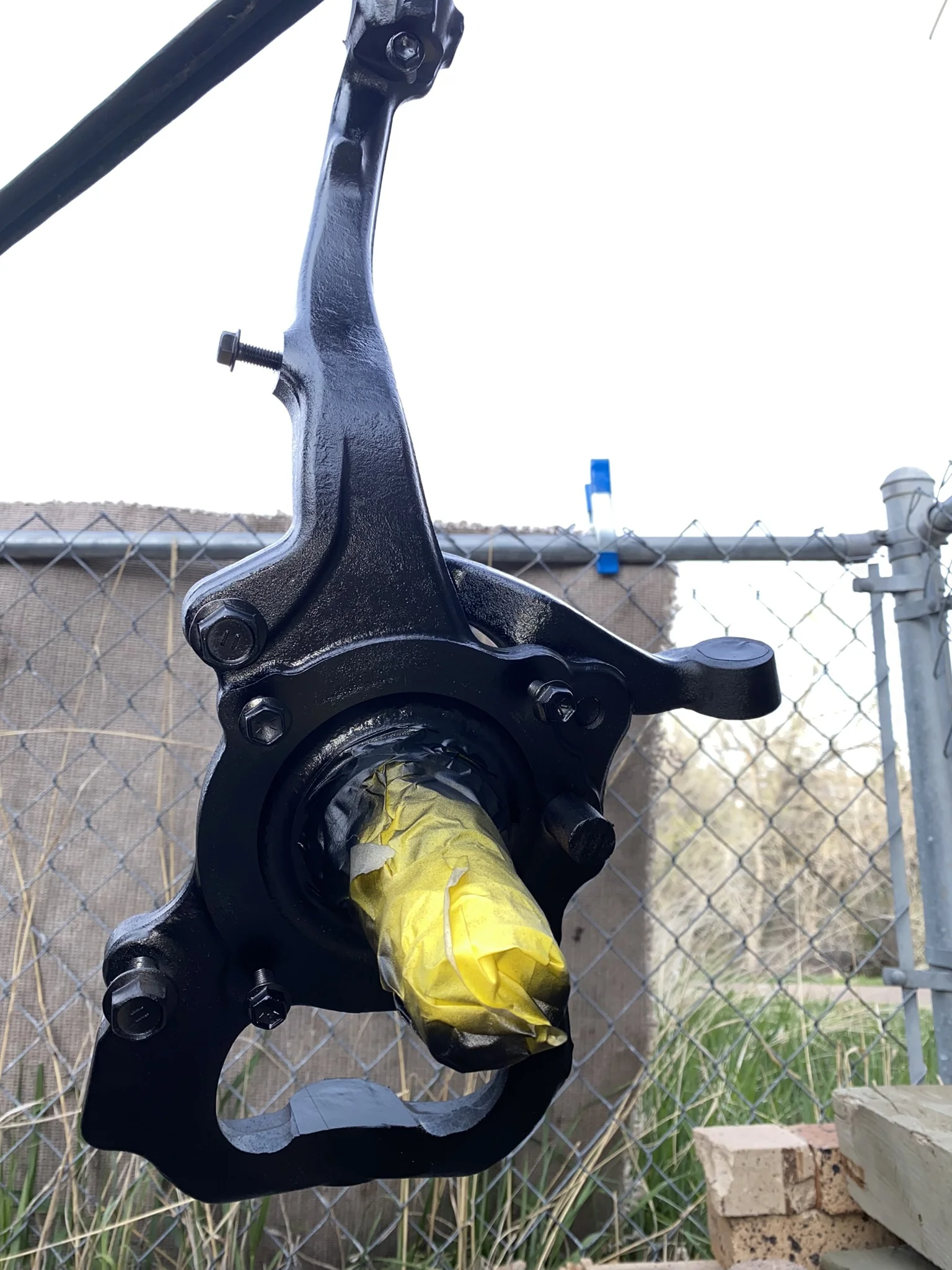

I always recommend a knuckle service (restore), first wheel bearing. First being (these days) ~20 yr old and 150k to 400K miles.
I de-rust and set up so they'll no longer rust.
I restore areas curled up, where ball joint boot seal to. Due to idiots, beating-off with BFH.
After first knuckle service, I use Slee spindle lube tool. During subsequent wheel bearing services.

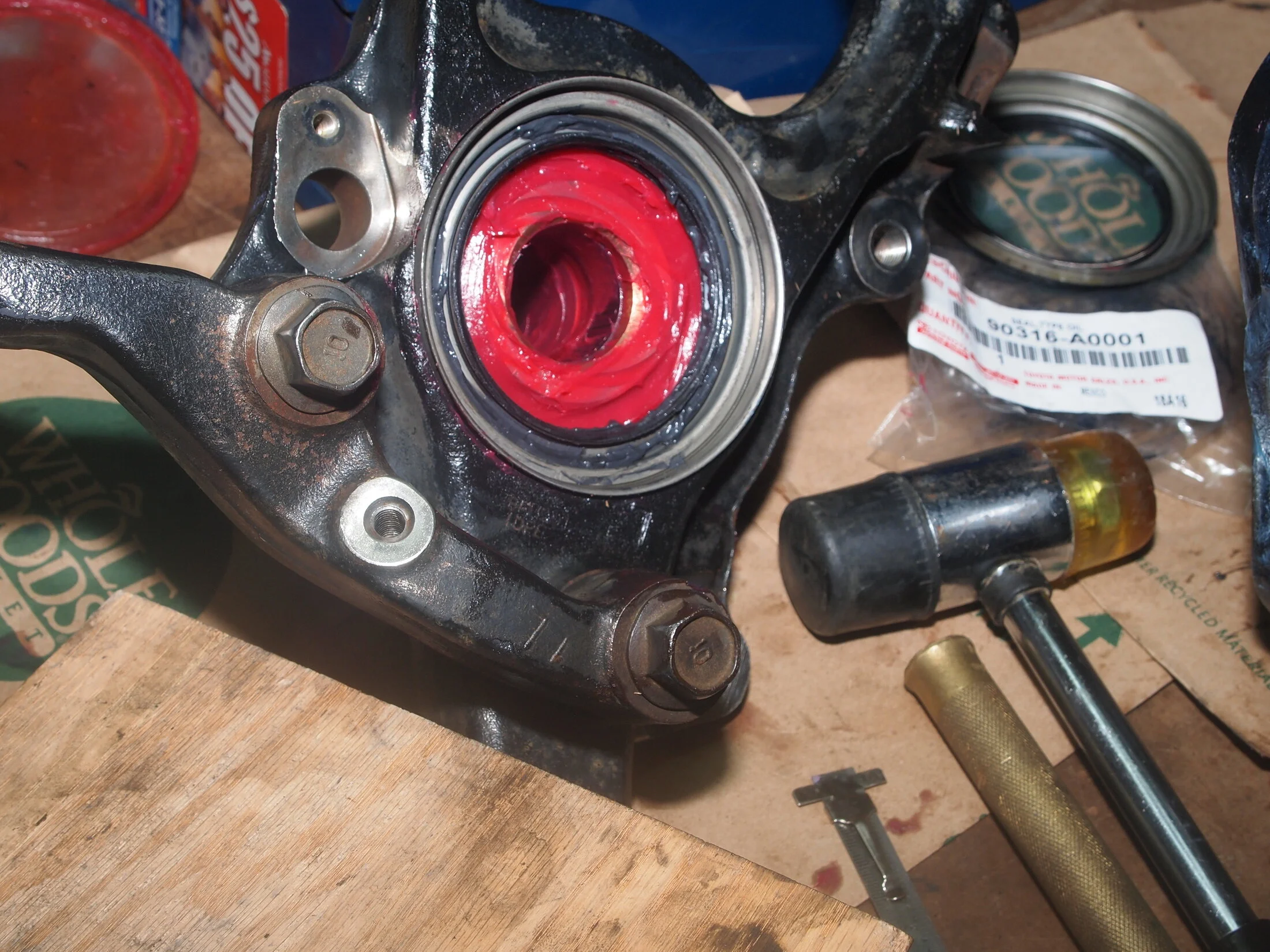

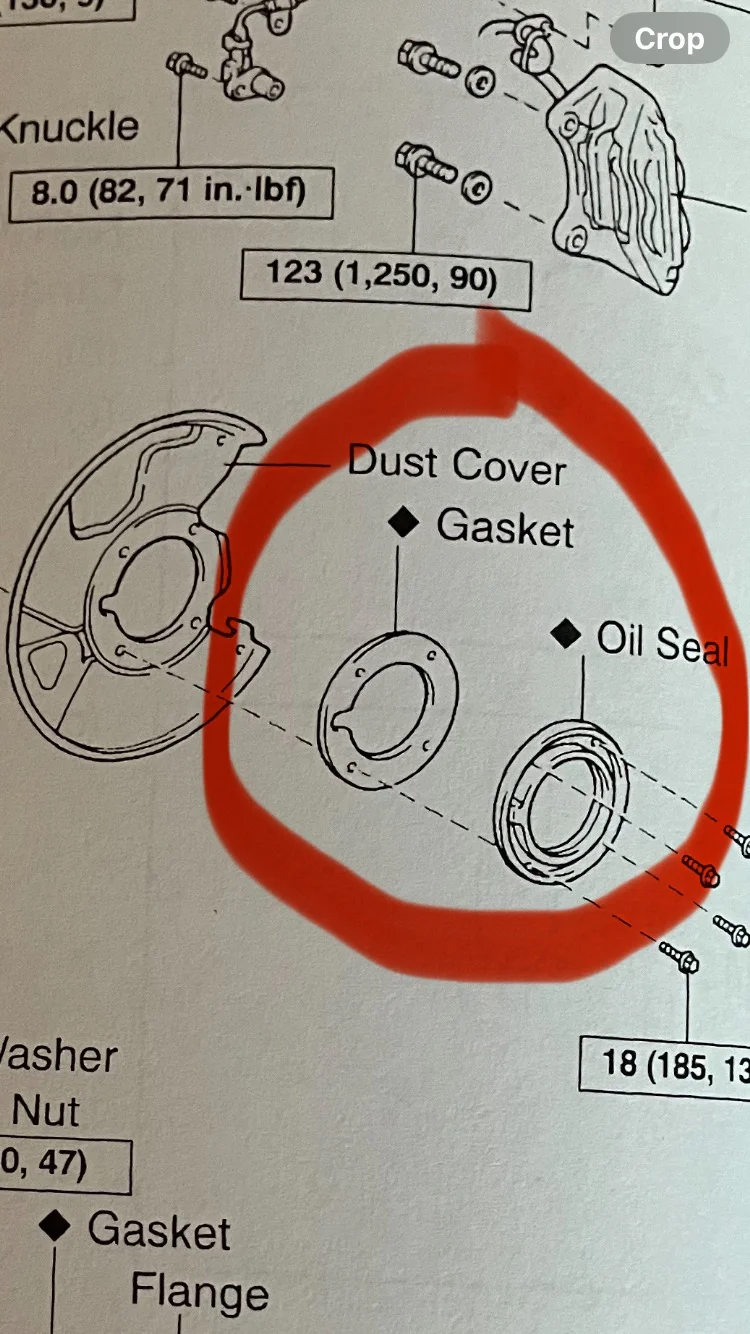

Depends on condition.
The oil seal is not a watertight seal, so not crucial. I inspect rubber of oil seal, if damaged, I replace.
Gaskets is sometimes reusable, but I always change it.

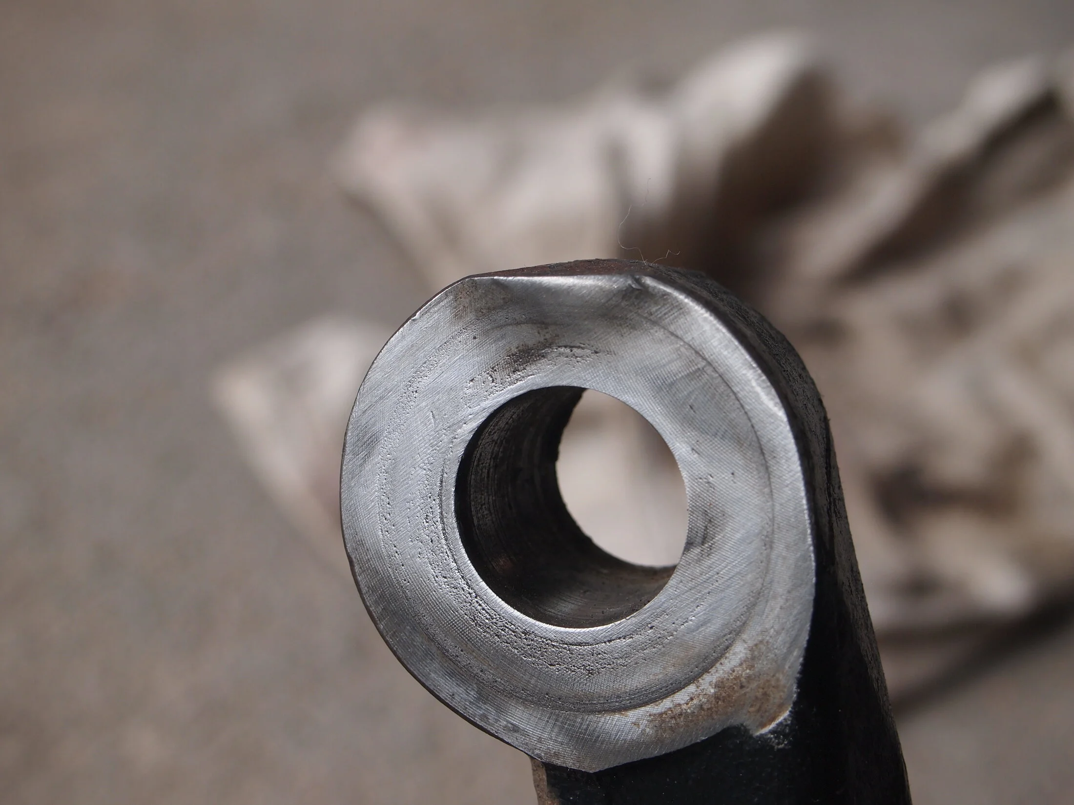

Very likely, when you get brake dust shield off, you'll find rust on face of knuckle where brake dust shield.
Once wheel hub pulled, and brake dust shield off. It easy to use a puller, and pop the 3 ball joints (upper, lower and TRE).

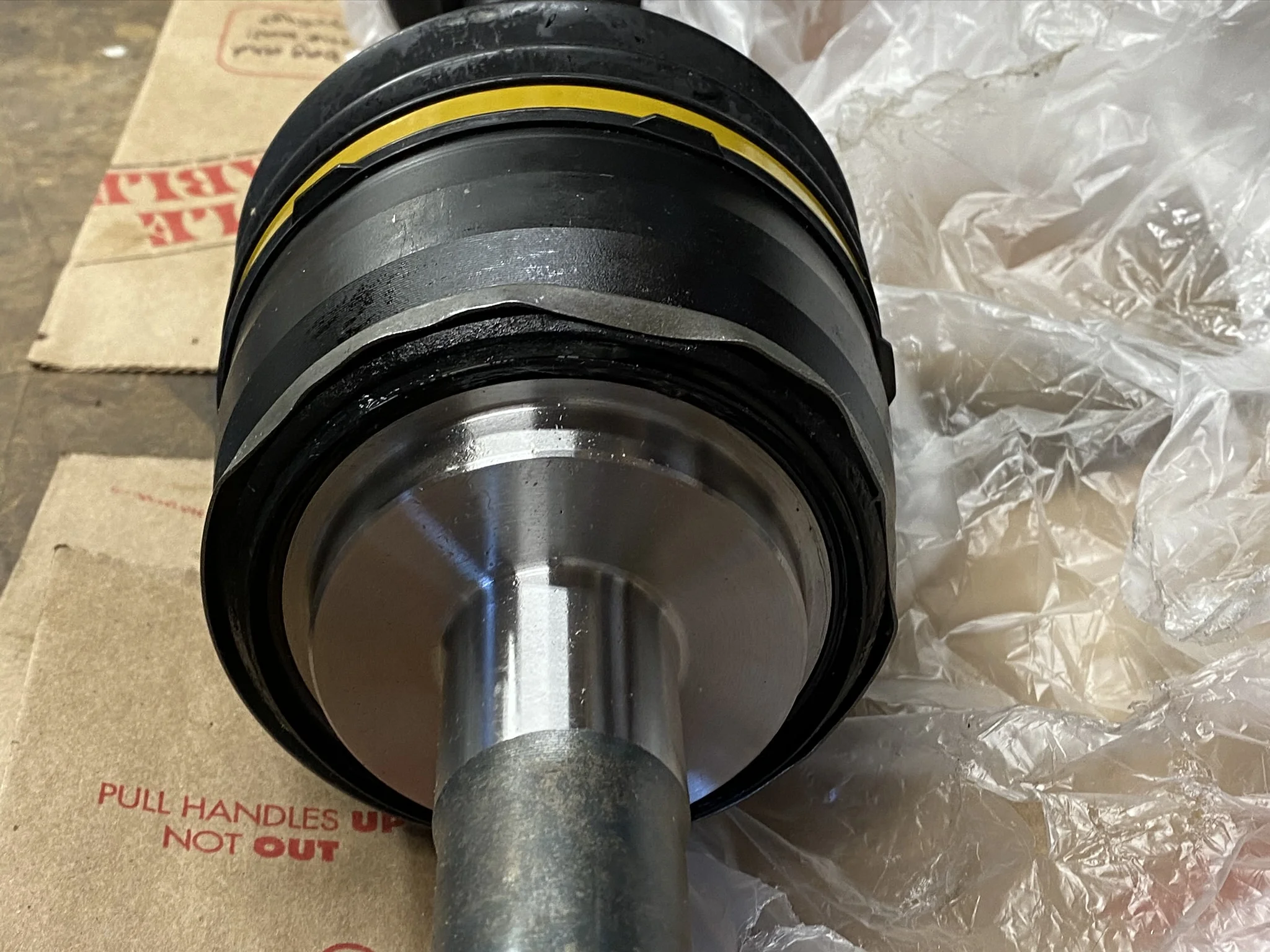

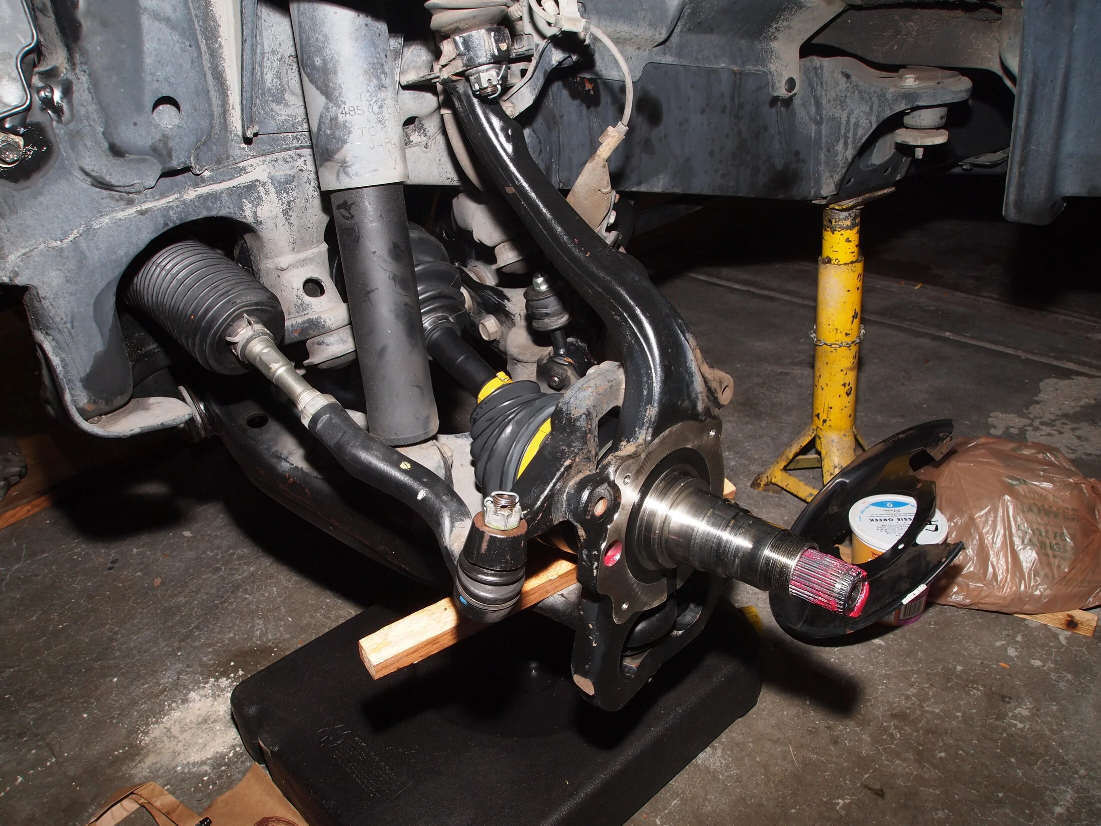

When I pull knuckles. To keep seal of FDS from touching LCA, or will bend. I place a 2" oak stick under FDS back of top of ball joint. This seal if bent, can result in a rotational scraping sound.
Bent FDS seal
View attachment 3672604View attachment 3672619
Bent FDS seal

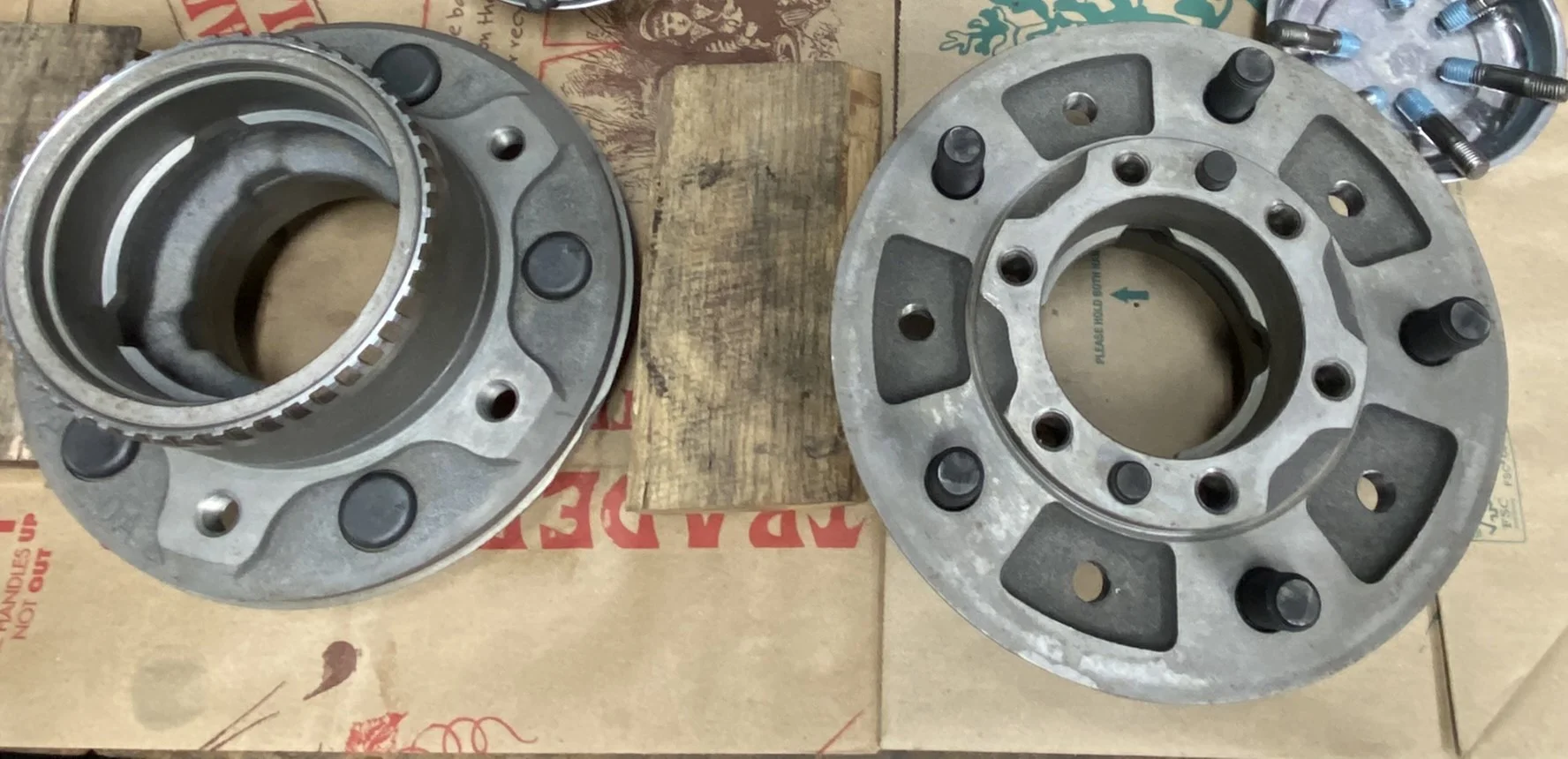

I restore a lot of wheel hubs. only 1 in ~200 that I had to replace. It was the one above, where metal so beat on it ripped the steel. Which was from improper brake rotor replacement.

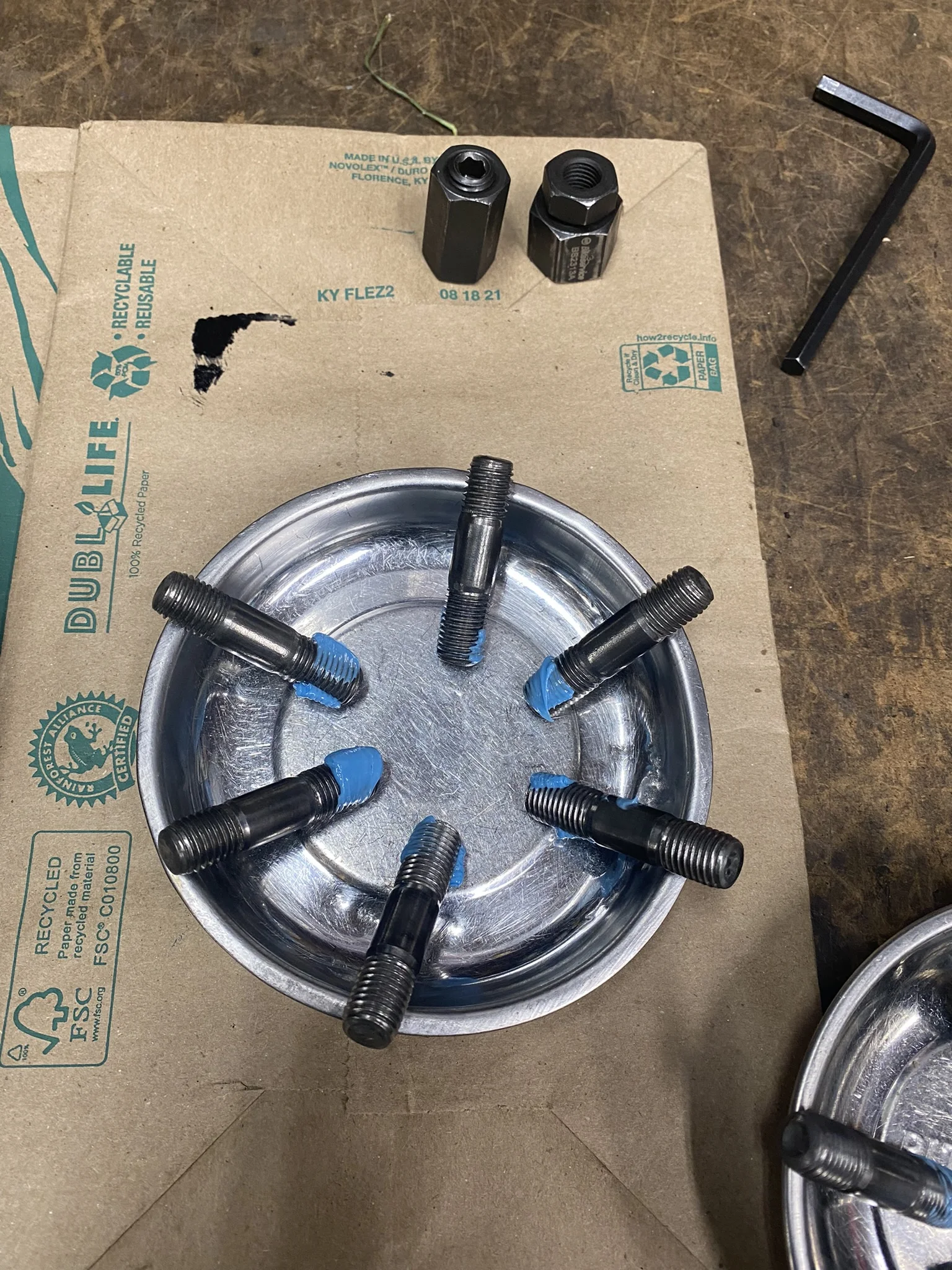

2001LC- I’ll be installing a new DS hub this weekend. For the new flange studs, the longer end goes into hub, correct? Do you recommend blue loc tite on the hub side threads. Many thanks in advance!
Installing new hub flange studs…long threaded end into the hub or short threaded end into hub. Long threaded end seems logical, but wanted to double check. Thanks!
