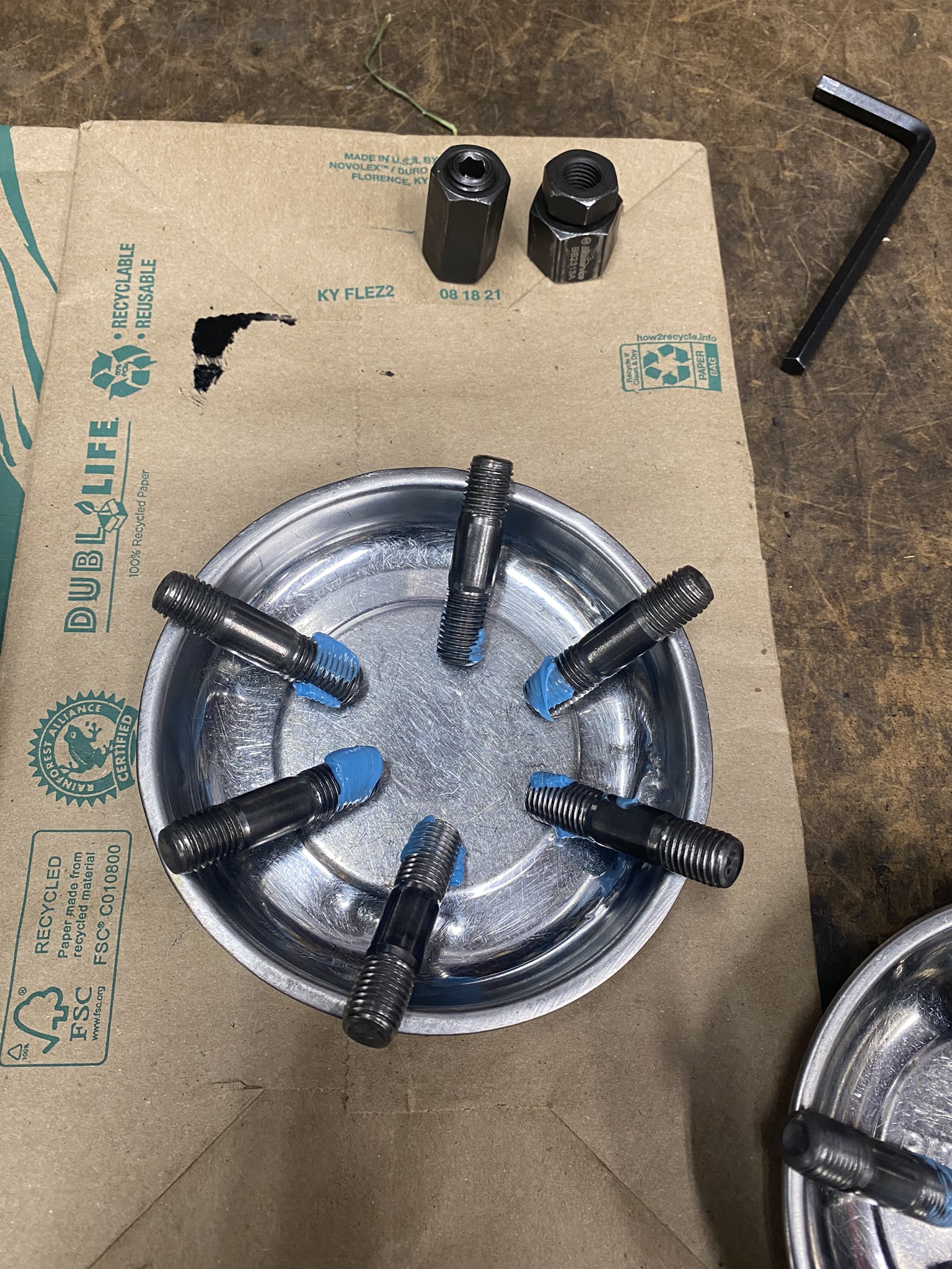

Lug bolt are pound out with steel. We're not concerned with damaging the old lug, we're replacing. Rears can be done on the vehicle. Front are much more involved. Fronts we must not only remove wheel hub. But we must also remove rotor from wheel hub.

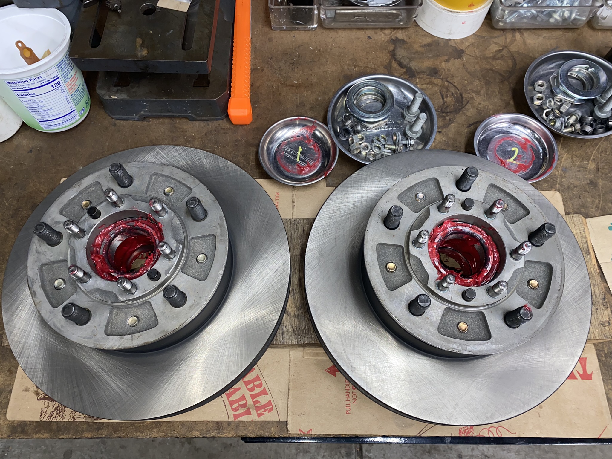

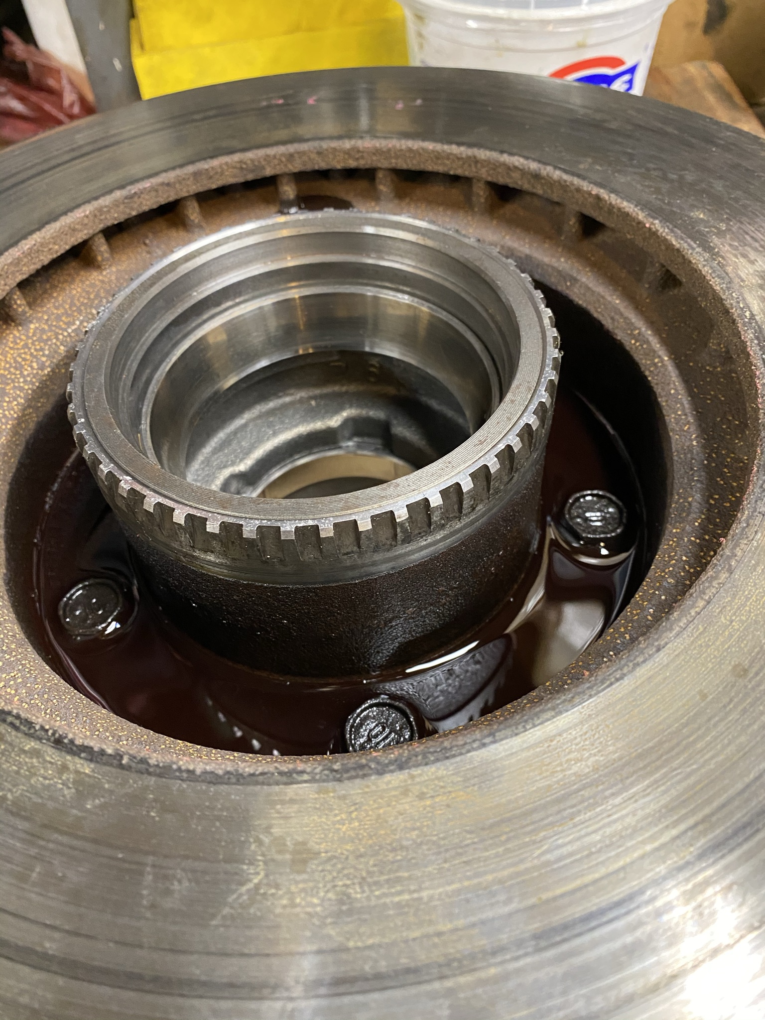

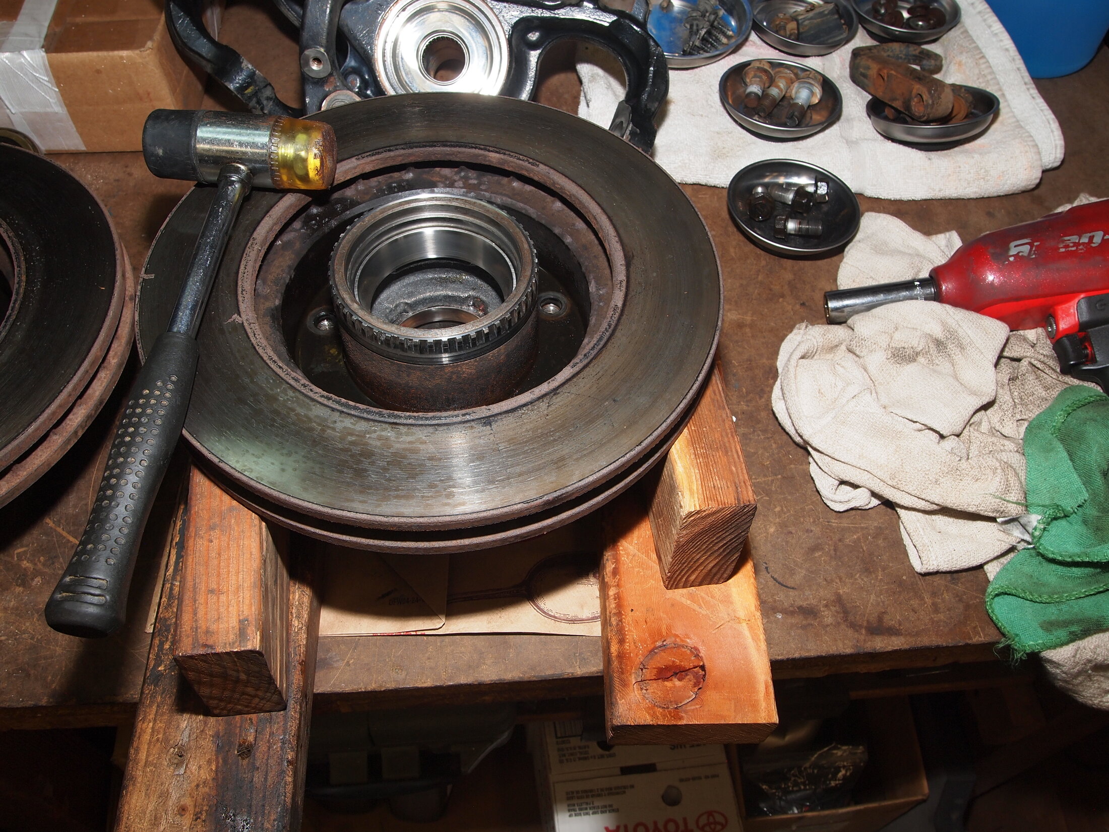

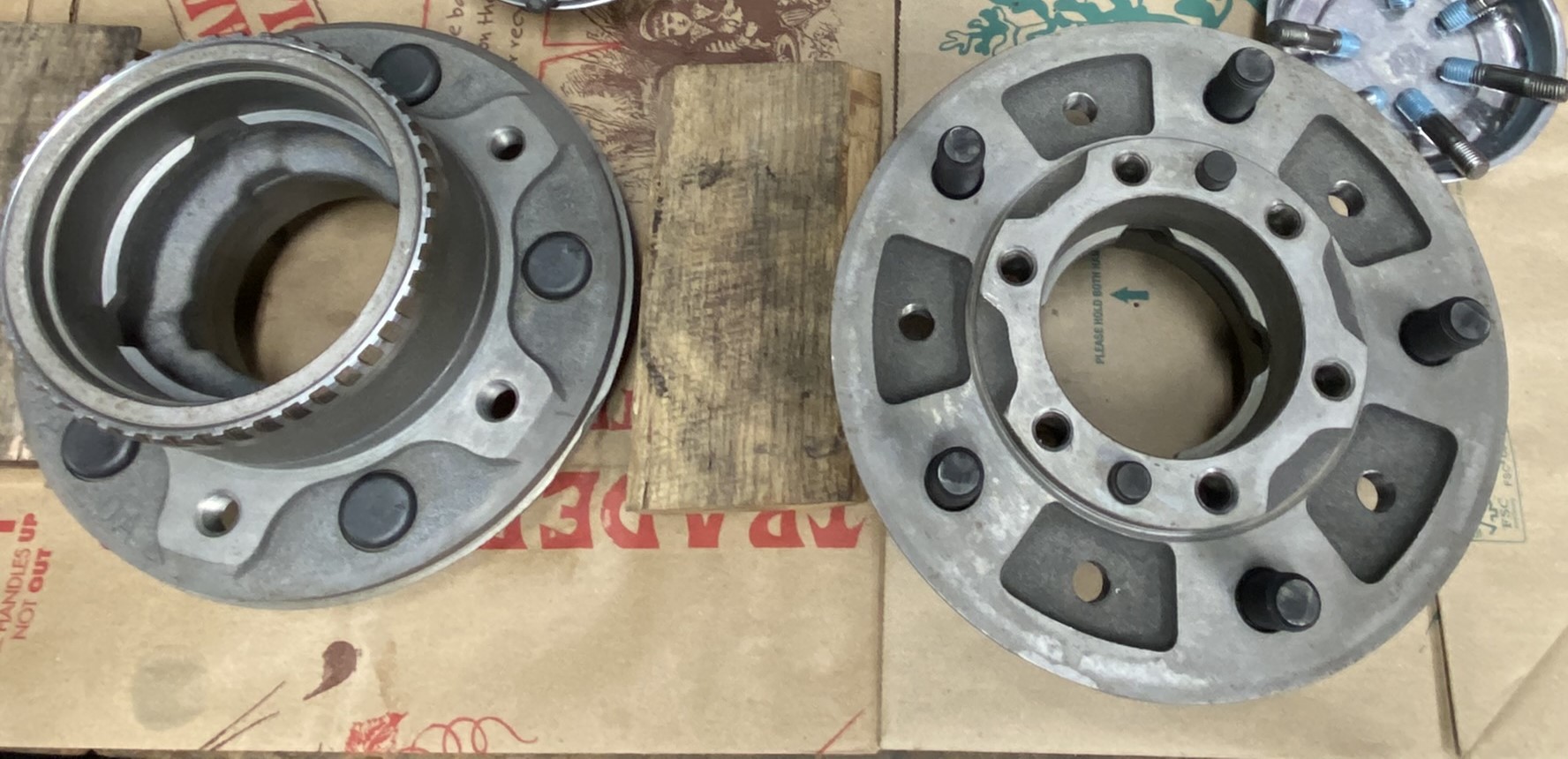

Removing rotor from wheel hub, once hub remove from knuckle:
  1. Scrape inner hub area/cylindrical that rotor must pass over to remove baked on brake dust and rust (crud rotor disk may get hung up on). Get off the harden brake dust and rust best you can. Power wash.
  2. This step for the crudy rust stuck on rotors. Place wheel hub with rotor, in a catch pan. Add ATF to inner area where rotor bolt head are. ATF is and excellent penetration and derusting oil. Let AFT soak in, overnight.
  3. Remove the five 17mm bolts.
  4. Place rotors disk on wooden blocks. High enough so that wheel hub suspended in the air (off your working surface)
  5. I use a dead blow hammer, and pound on back of wheel hub. Pound wheel hub off rotor, by hitting in side to side pattern. Alternately, use a wood block to protect wheel hub or a lead hammer. Whatever you do. Do not damage wheel hub, by hitting with hard metal. Ever these brass hammers, which are forged brass, can damage the wheel hub. We must not damage the seal seat area and the teeth, speed sensor reads on back side of wheel hub.
    After cleaning inner wheel hub, I soak overnight. I place in catch pan, since ATF will seeps out, as it frees rust and brake dust crud.
Rotor disk, is set on wooden blocks to suspend wheel hub above bench. So it can pass through rotor without bench interference.
NOTE: I no longer use these plastic hammers.
I no longer use these plastic hammers. I found, as I pounded out really stuck rotors. The plastic gave way, to the metal within. This can damage the hub. I've found a dead blow hammer works the best.
Once rotor off wheel hub. You can then beat out lug bolts you're replacing, with steel hammer. Then use a lug nut and washer (as spacers), to pull new lugs bolt (studs) through wheel hub and seat all the way in wheel hub. Alternately use a press or vise as makeshift press.

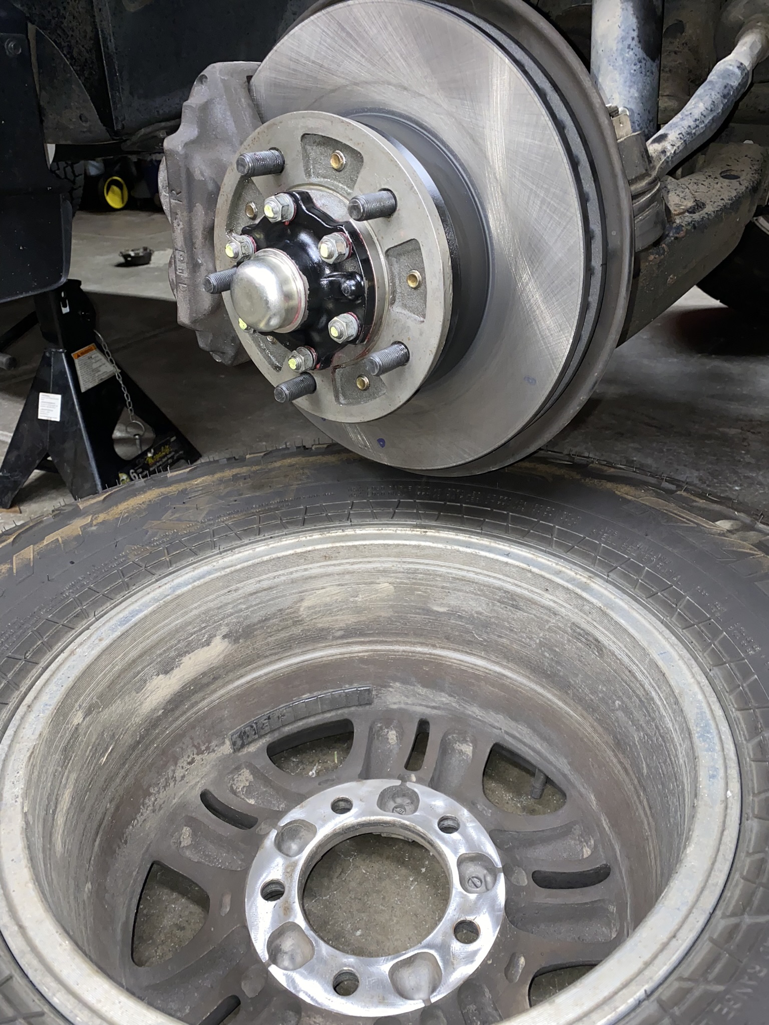

Thanks again 2001LC. I got it all put back together with new bearings and races. Much tighter and smoother now. Also found my new upper and lower ball joints weren’t torqued to spec and cotter pins weren’t even installed between the teeth of the castle nuts. Got that all fixed. The only issue left with this truck is the rotational wah wah wah above 20MPH. It’s not really a metallic sound, more of a droning / oscillating noise. Definitely not a scraping noise. With wheel bearings ruled out, spindles fully greased with tons of the old grease pushing through backs of both knuckles, and everything tight up front, I think I’m down to:
-tires- BFG KO2s w/ about 20K on them. Rotated all around / road force balanced / noise didn’t change
-front drive shafts- left front is rather new OEM. Right front looks OEM- age unknown. No rotational weirdness spinning by hand, but both sides’ boots make a rubbing sound with the ribs of the boots rubbing together due to angle of shafts w/ wheels hanging. No clicking in turns and turns are smooth.
-leaves me with front diff (noise seems to be on front 1/2 of truck). Are the diffs in ‘05s prone to fail around 200K miles? Maybe diff carrier bearings? I drained and refilled. Old fluid looked good. No metal chunks on magnet.
-or, and my bet, prop shafts / u-joints. They are original. I’ve greased the s*** out of the u-joints and greased the slip yokes. Couldn’t get grease to go past the oil seal on slip yokes. Prop shafts / u-joints are original. U-joints / slip yokes that have probably been neglected a good part of their life prone to failure around 200K miles?

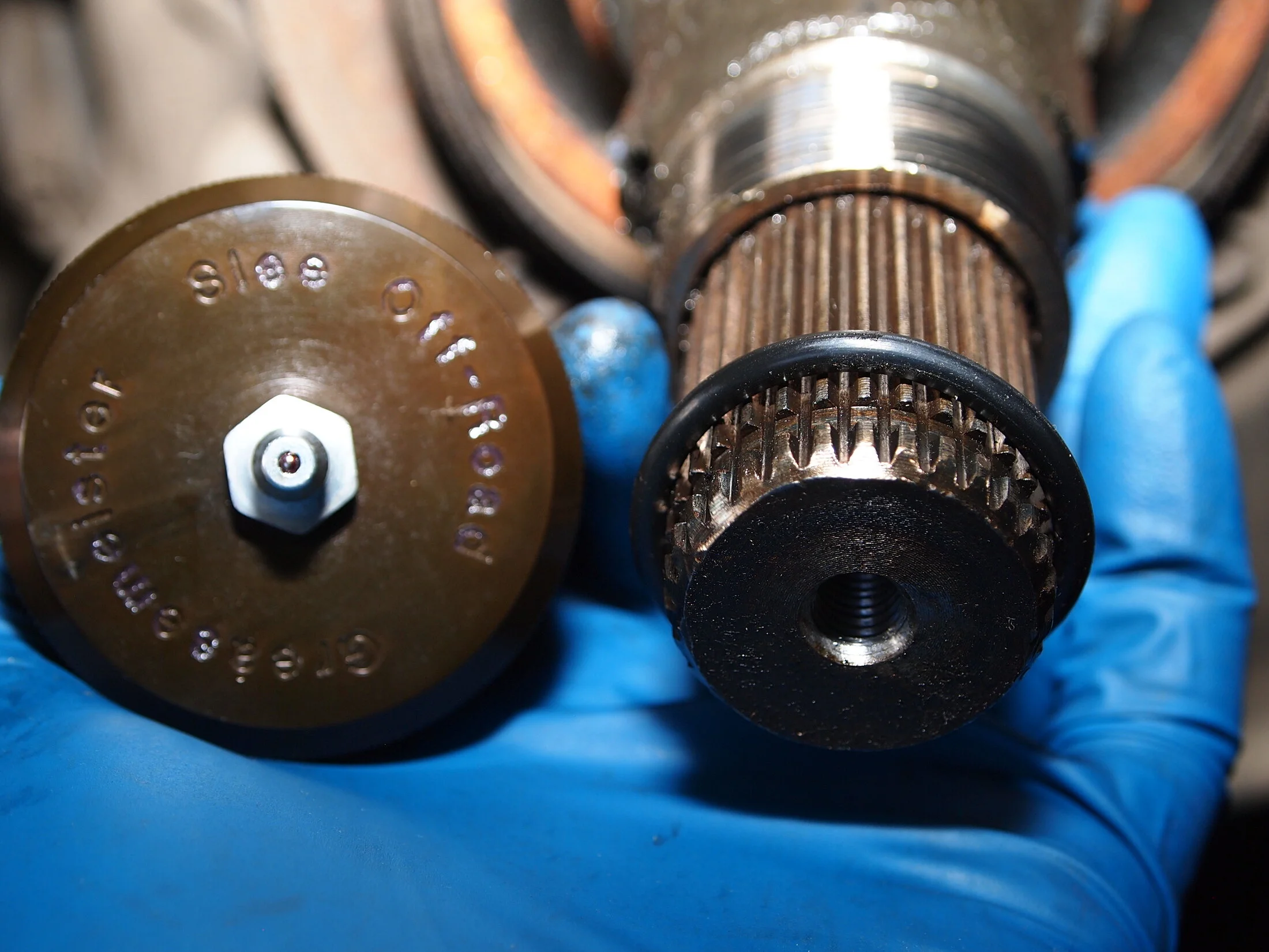

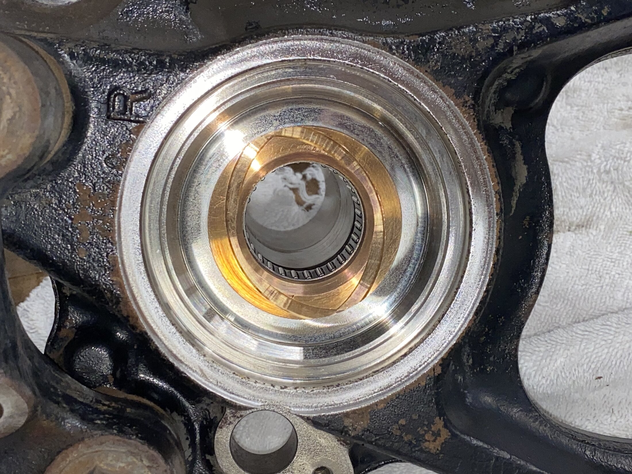

If I've know, needle bearing good and no contaimates inside spindle. I use the Slee spindle lube tool. Which I do have and extra one, if anyone needs one. Usually I use the Slee lube tool, the second service I do. First service, I pull knuckle and restore. Checking to see if bent, restoring where others beat the ball joints off with BFH, defroming the ball joint boot sealing surface and derusting. New needle bearing and bushing R&R, if needed and always a new knuckle seal. View attachment 3666759

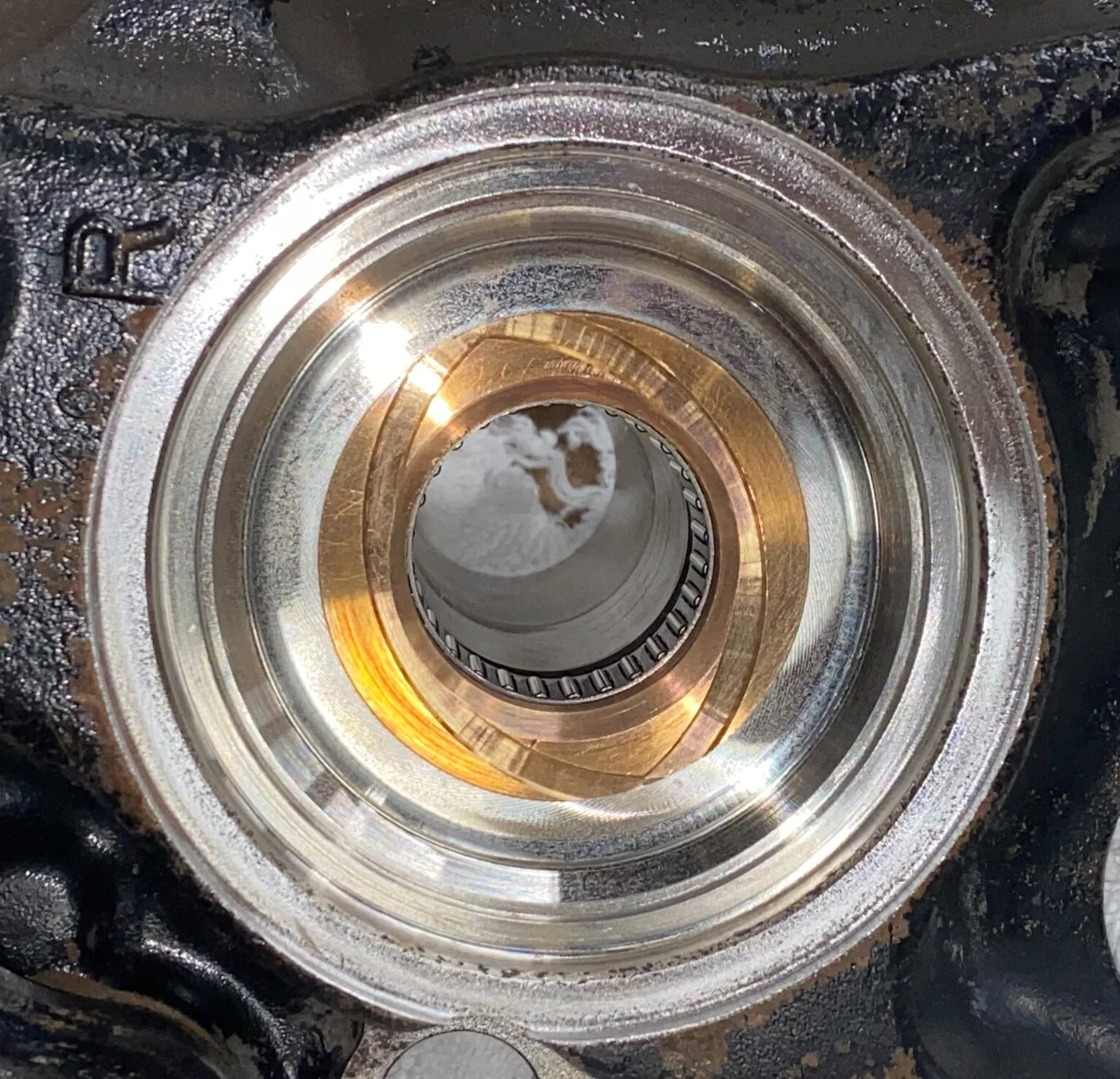

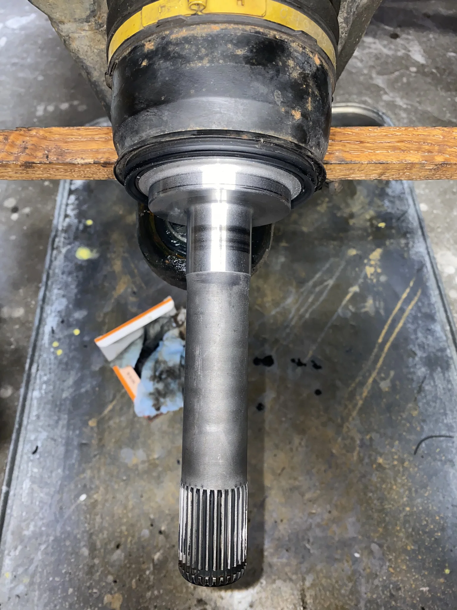

Can anyone explain the brass bushing to me, what's it's purpose, why are their grooves in it, why does it need to be greased?
The brass bushing, is so the FDS axle can float up against it. It's a wear point, since brass is softer than steel. The grooves hold grease, to reduce wear and thus sound of metal to metal.
The hub flange snap ring, come in various thicknesses. By setting hub flange snap ring gap at less than 0.20mm. Were pulling the seals (knuckle seal and FDS outer axle seal) together, to make a watertight seal. The brass bushing, is number the one wear point. The various size snap rings, take up the wear of brass.

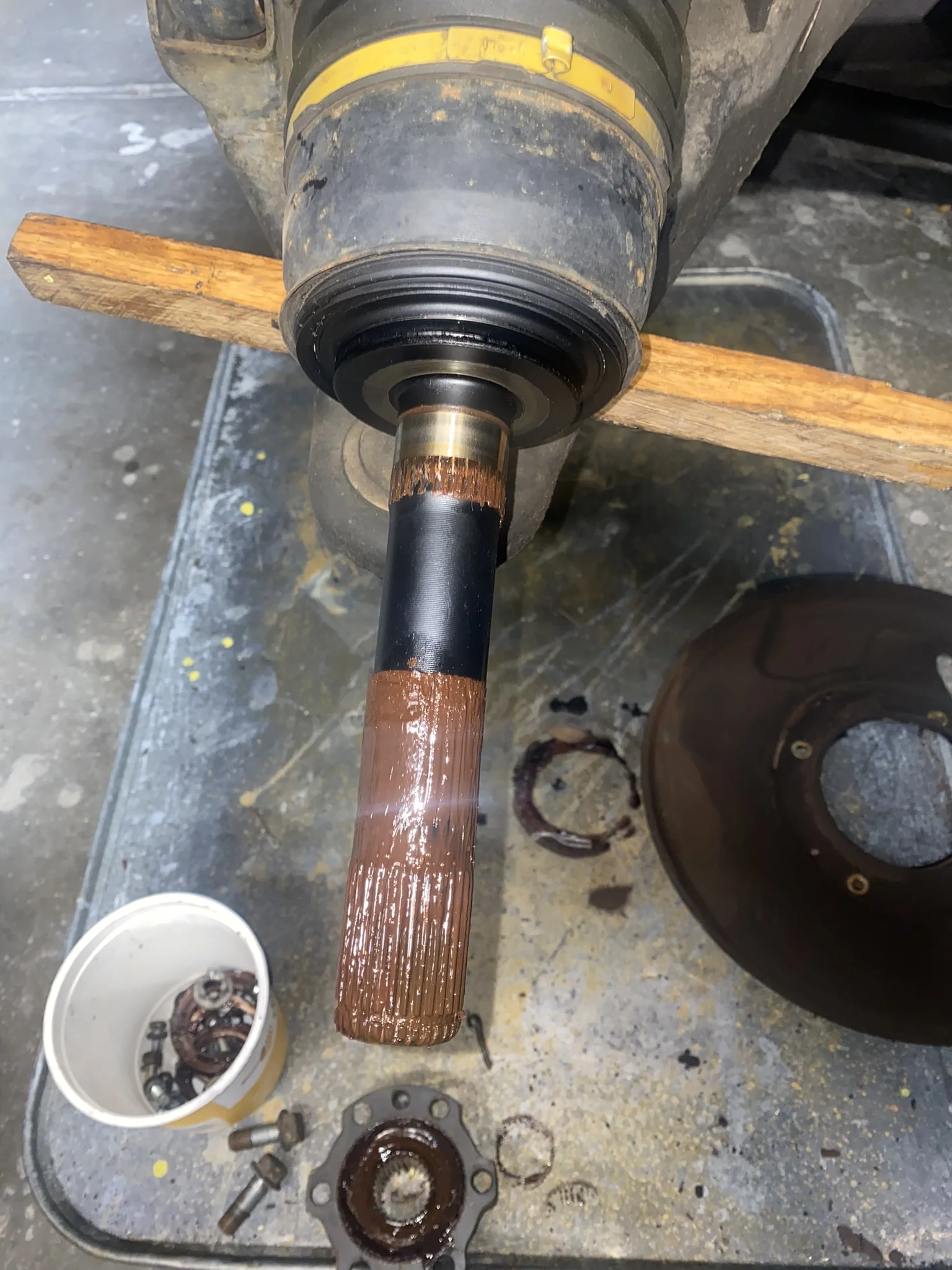

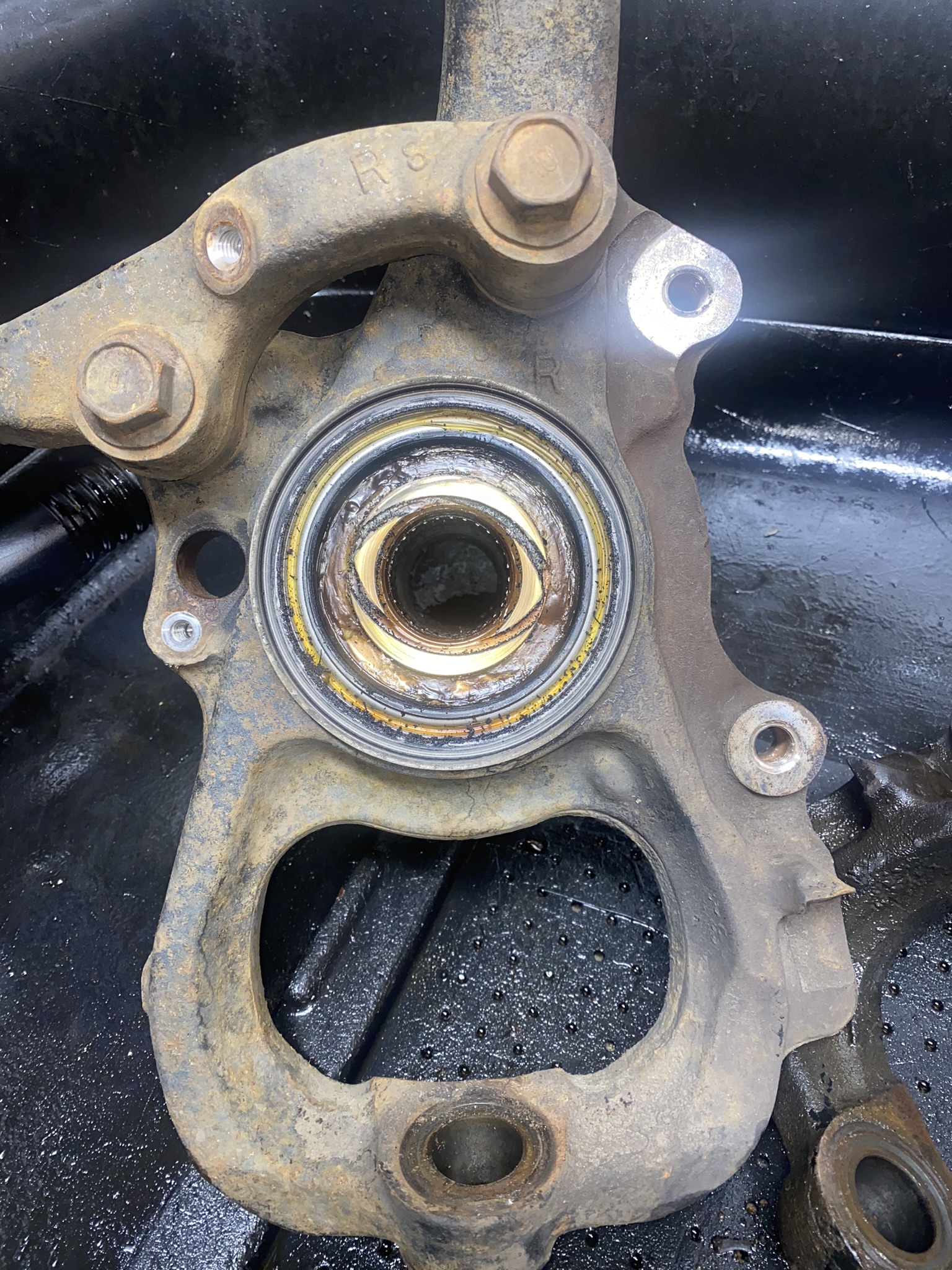

CVJ reman FDS, painted black (I hate that paint). The paint damaged axle bearings, and can damage wheel hub seal. Note: If using a painted FDS axle. Remove the paint, before installing.
This one had spindle threads damage from reuse of wheel bearing lock washer, also damaged ball joint & TRE boot seats, from pound off with BFH, rather than using ball joint pullers as one should. Additional, it was an excessively rusty knuckle.
Axle contaminated grease cleaned up, paint removed. Also axle needle bearing, brass bushing, seal surfaces polished (shown before polishing).

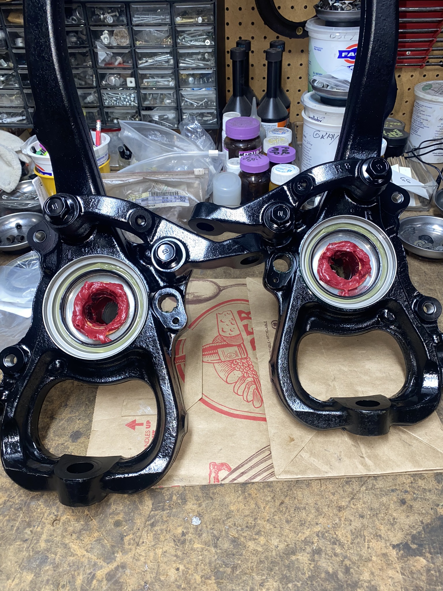

Recondition all metal, painted with POR-15 Top Coat, new needle bearing & brass bushing, seal. Needle bearing pack with grease and brass coated with grease.
Knuckle recondition and ready to install..

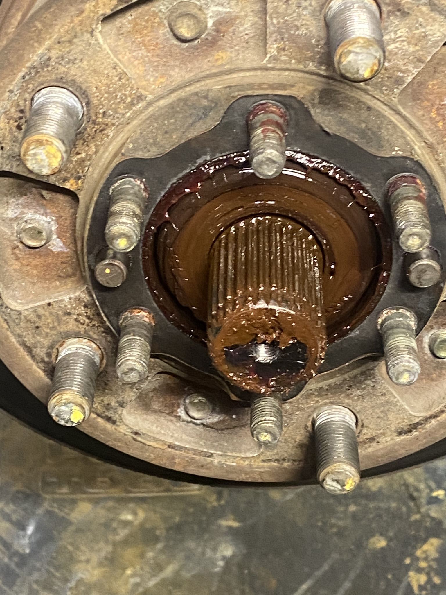

When water gets into grease, it turns brown and very had to clean off.
Some of reasons we get water into hub:
  1. Reuse of grease cap, is #1.
  2. Beating on hub flange and wheel hub where the two meet, warping seals mating surface.
  3. Not setting hub flange to snap ring gap, within limit of .20mm. Resulting in excessive gap at seal in back of knuckle and its mate on FDS (AKA CV)
  4. Loose wheel bearing, hub wobble. Damaging seal in back of wheel hub.
  5. Not replacing hub seal or hub gasket.
  6. Damaged FDS seal
  7. Damage knuckle seal.
