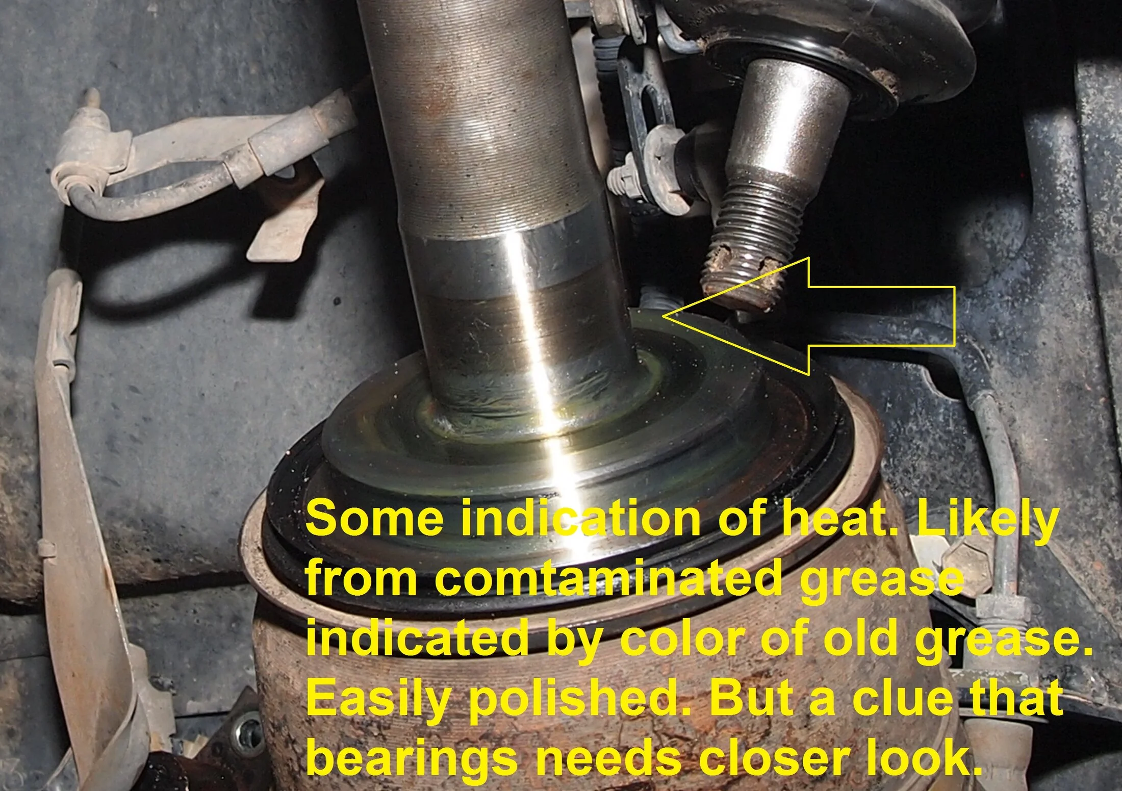

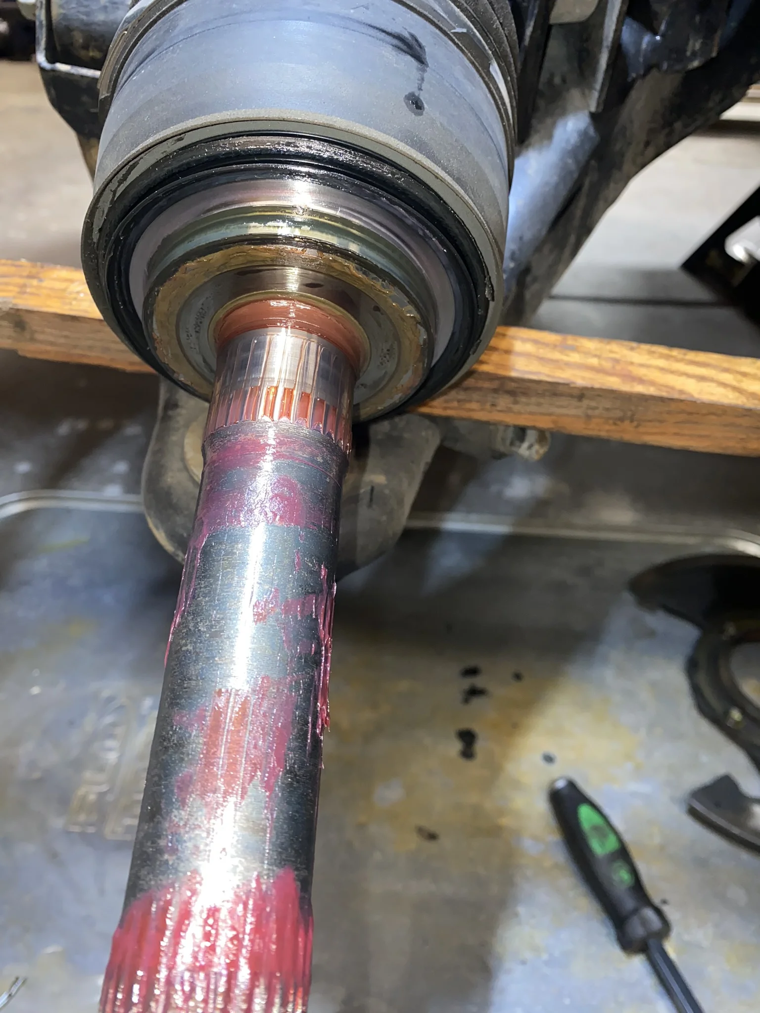

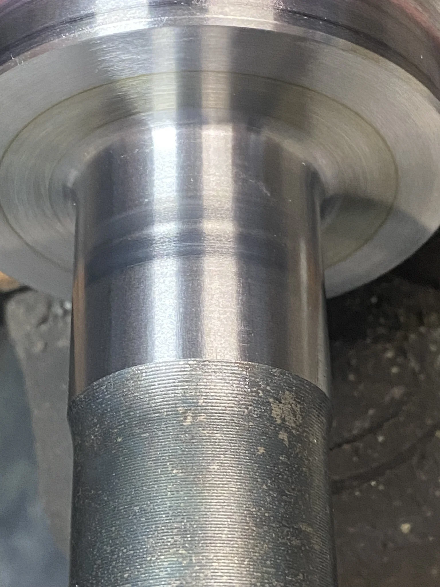

First zero in on which corner (wheel). Then pull out FDS axle. Look at axle where needle bearing rolls. If scored more than what would be normal for the miles, replace needle bearing.
Axle bearing are also required to be lubed, with every 30K miles wheel bearing service. Unfortunately they almost never are lubed/greased.
This FDS axle had less than 2K miles on it. Yet scoring where needle bearings rolls, and color (indicating excessive heat) worse than seen on some at 250k mile, that were never lubed.

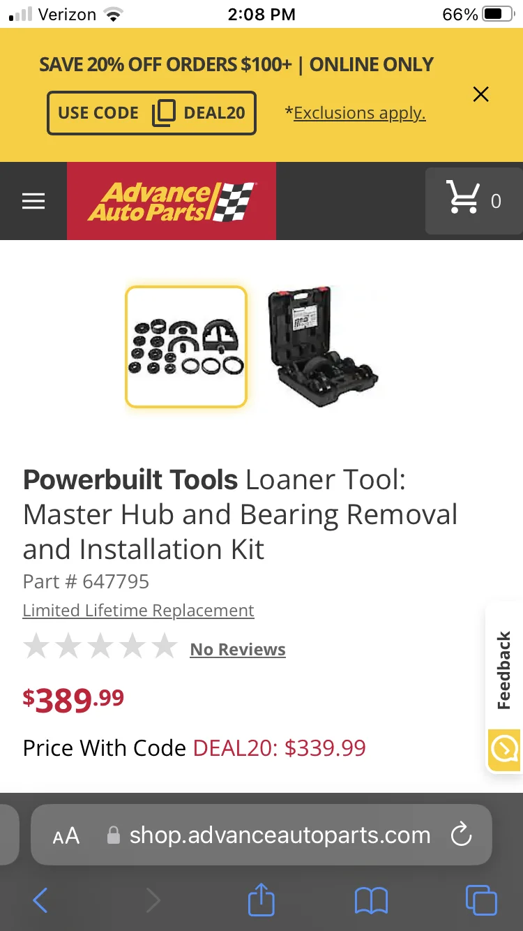

Quick question on the wheel bearing job…I’m working on my parts list now. Planning on doing bearings and races- not reusing old races. I don’t have a press in my garage. That being the case, will I need to take hubs and races to a shop to have new races pressed in? Or, is there DIY way without a press? If there is a DIY way at home, is it best to just punch out old races with a brass drift?
You can rent this tool from Advance Auto (I think Autozone may also have this as well).
I have not used this on my LC yet but I did front bearings on my AWD sienna (different setup) and it made the job a breeze.

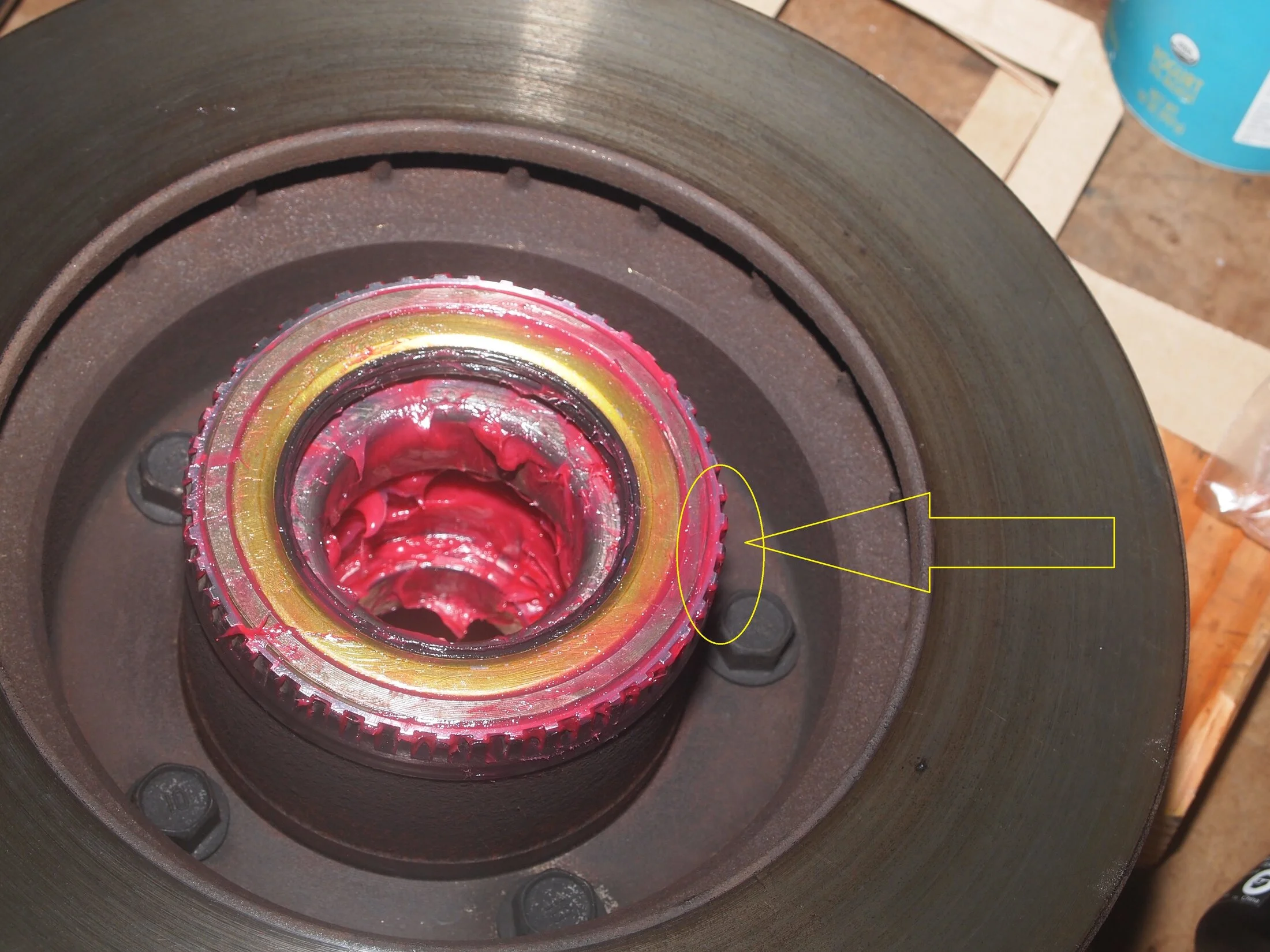

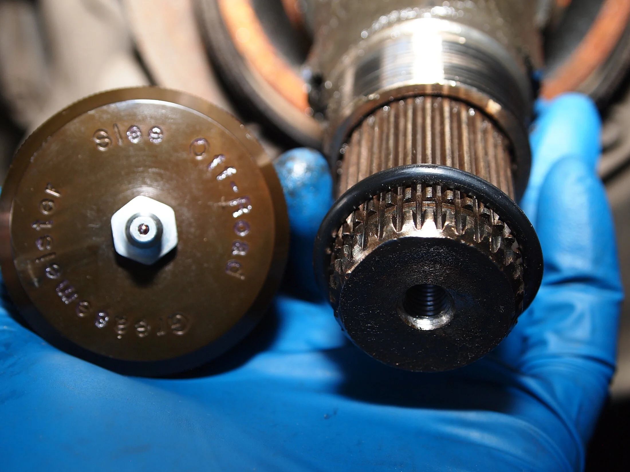

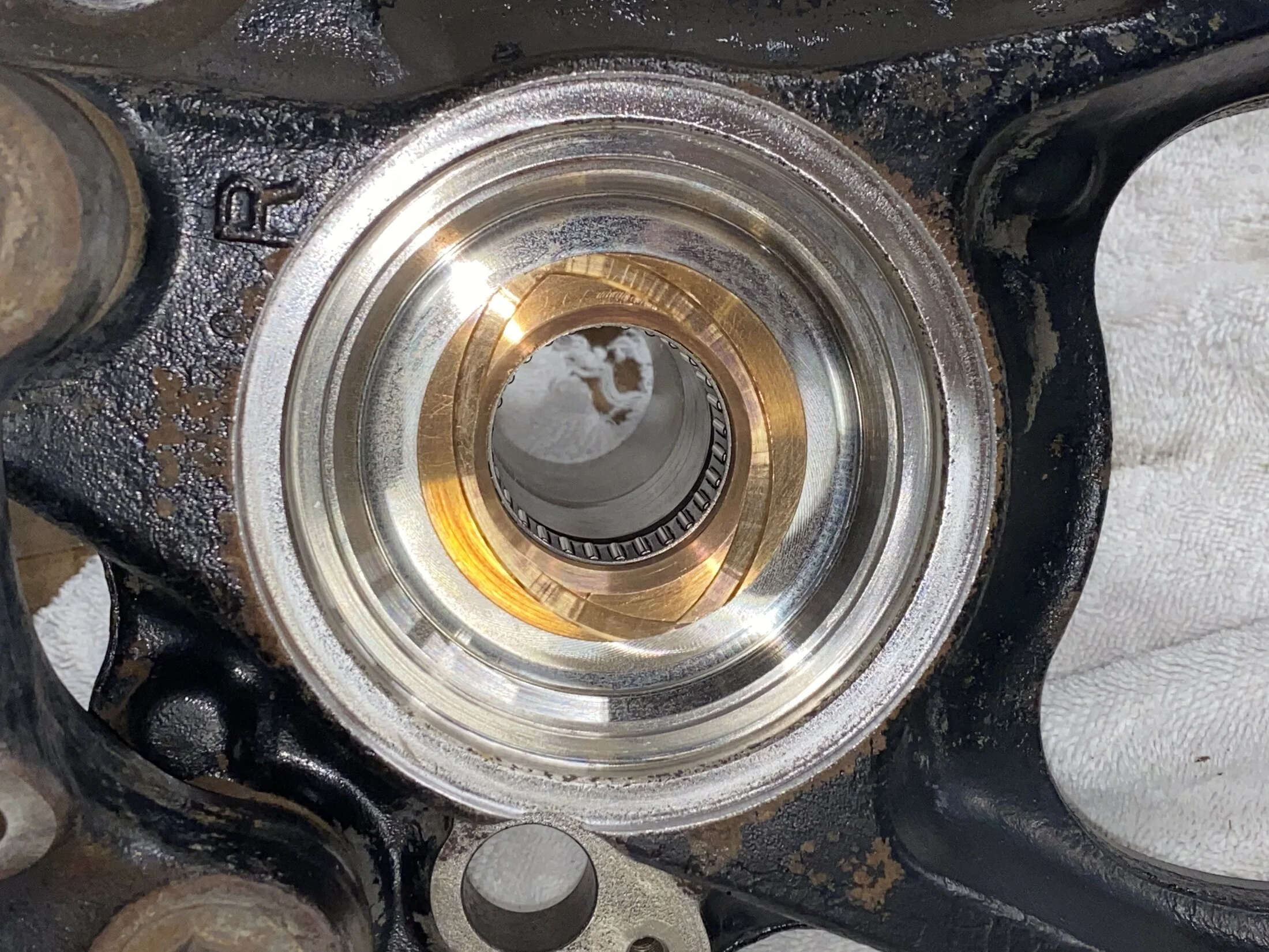

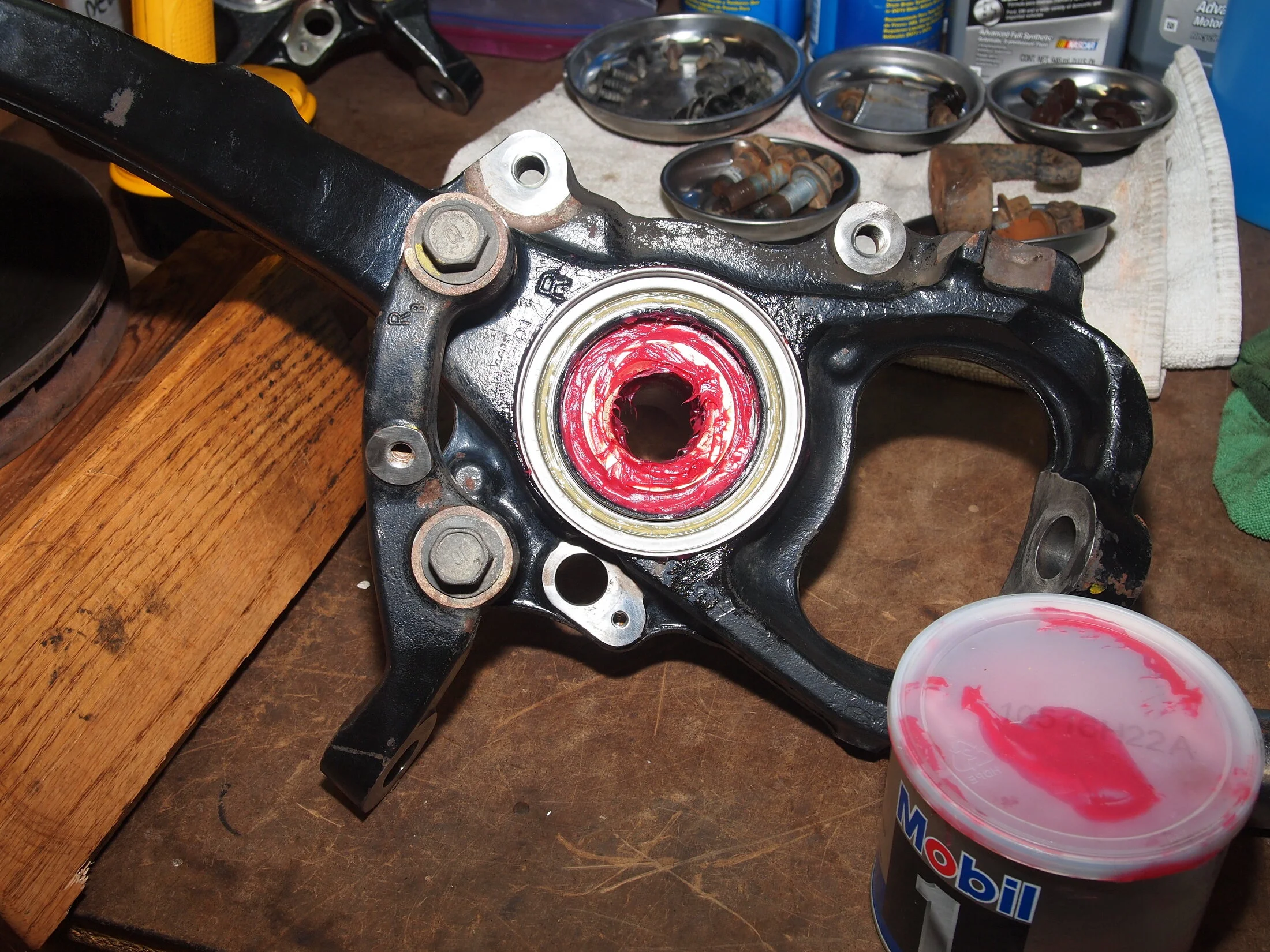

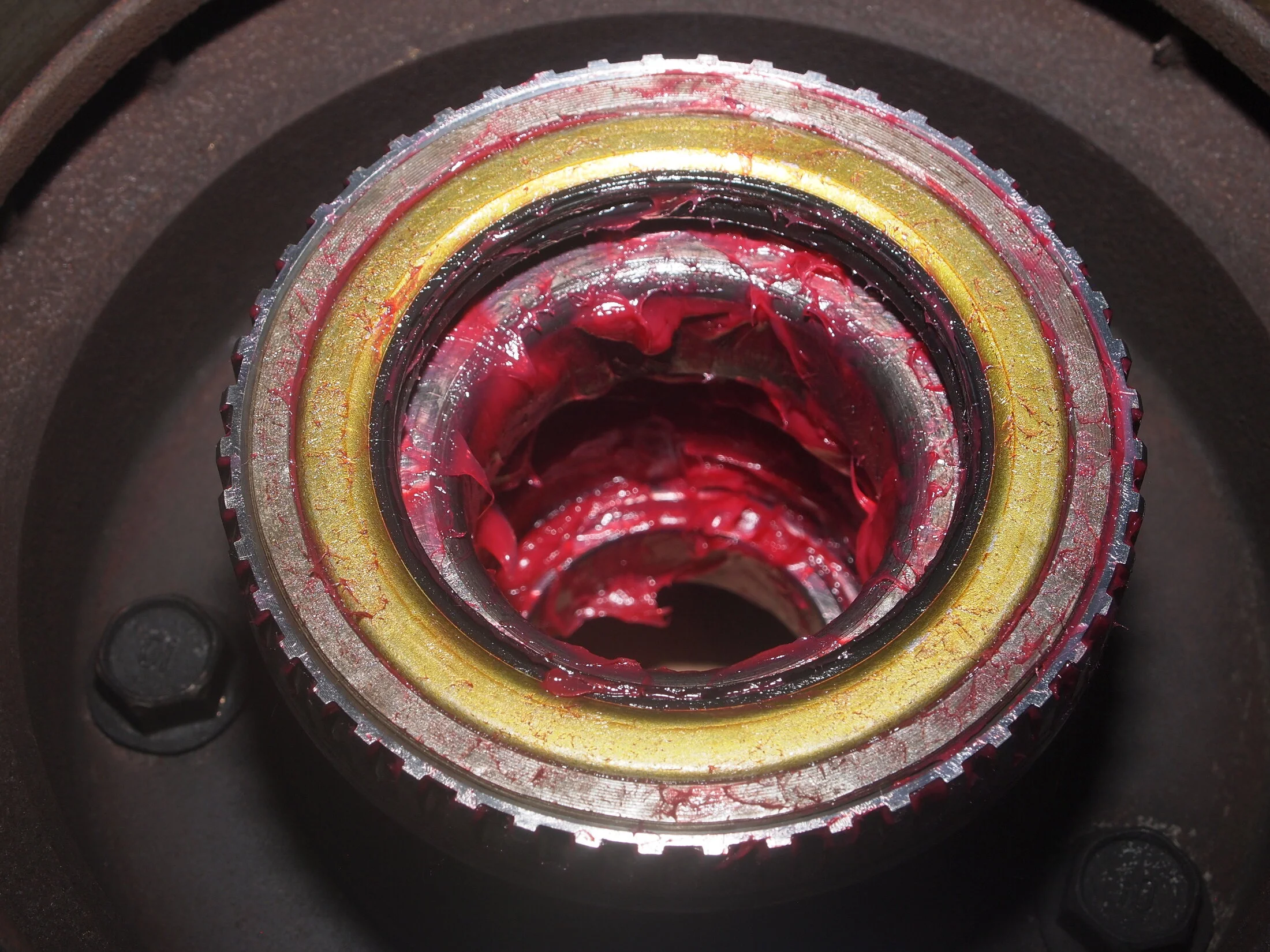

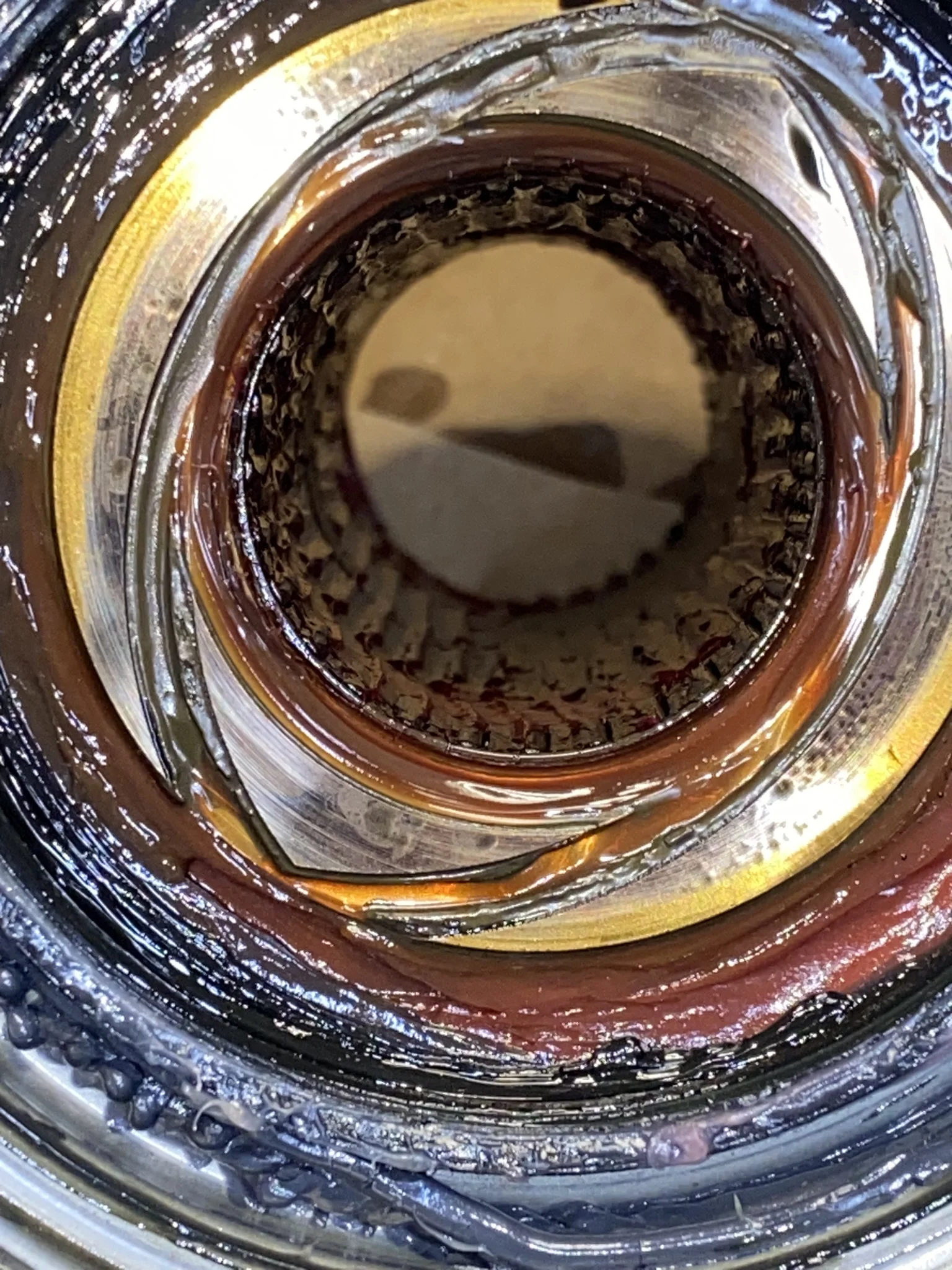

If I've know, needle bearing good and no contaimates inside spindle. I use the Slee spindle lube tool. Which I do have and extra one, if anyone needs one. Usually I use the Slee lube tool, the second service I do. First service, I pull knuckle and restore. Checking to see if bent, restoring where others beat the ball joints off with BFH, defroming the ball joint boot sealing surface and derusting. New needle bearing and bushing R&R, if needed and always a new knuckle seal.
The first time I heard a Wah Wah Wah. Was coming down a mount HWY pass. I shifted into N at 65 MPH and coasted. Wah Wah WAH. This was due to under lubed spiders (AKA U-joints). The splines of the slip yoke of propeller shafts forward and aft (That again is what Toyota calls the AKA drive shafts) don't typically make a wah wah wah. They produce a clunk thunk at about 35 MPH, as one let of the gas and presses on gas again...

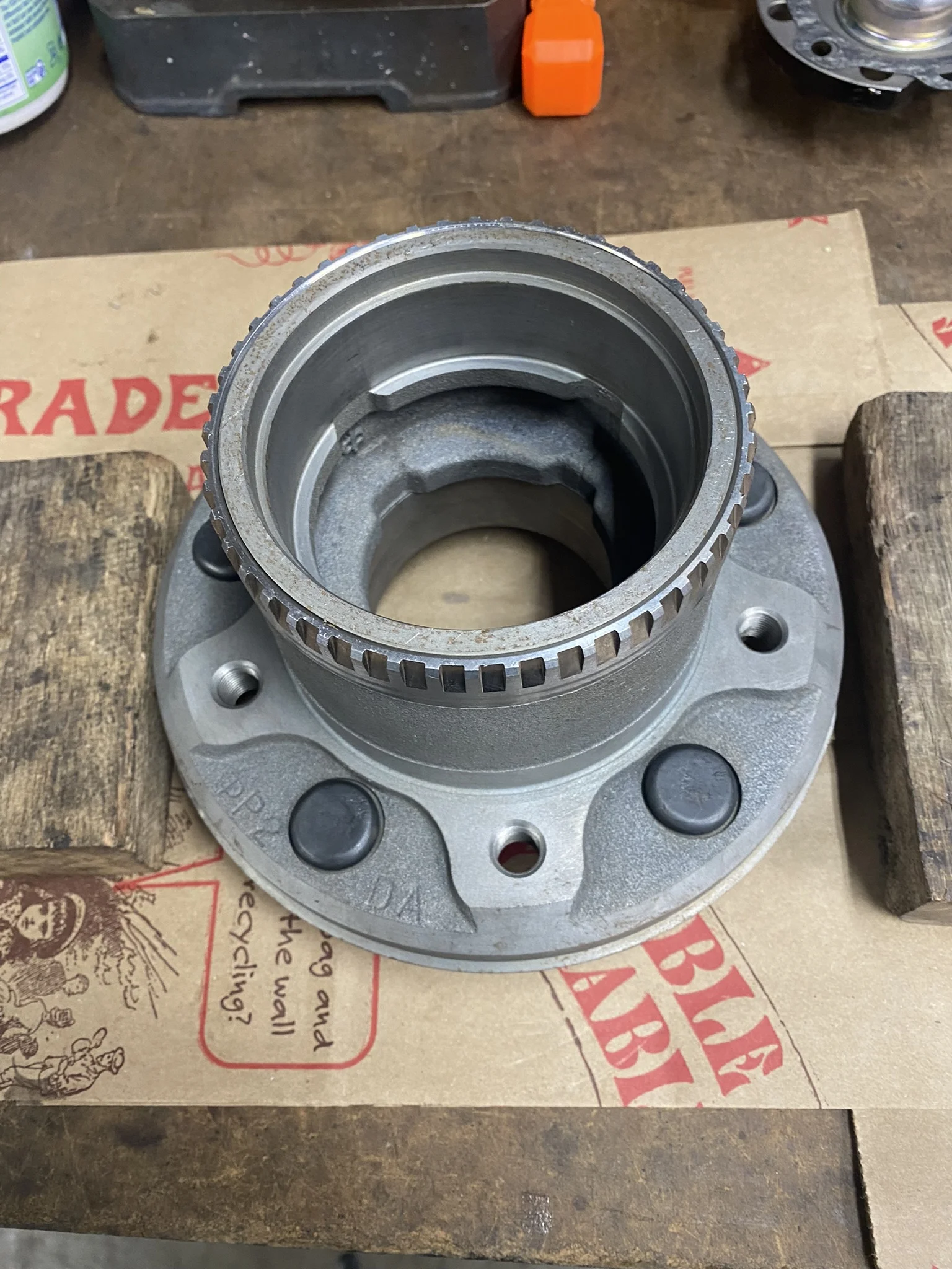

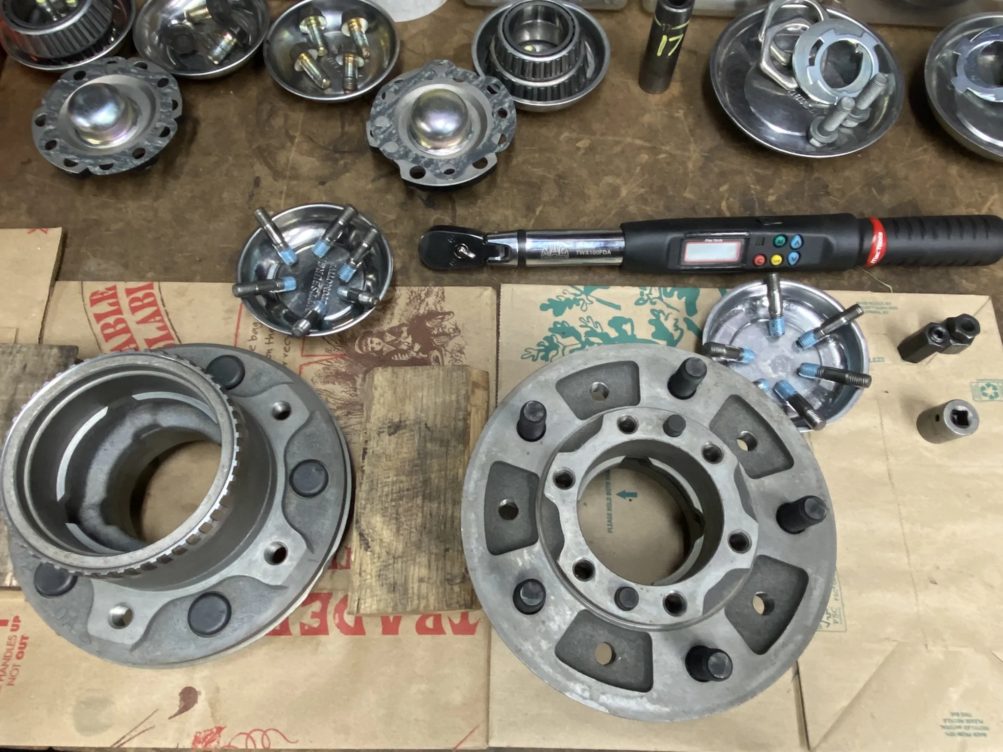

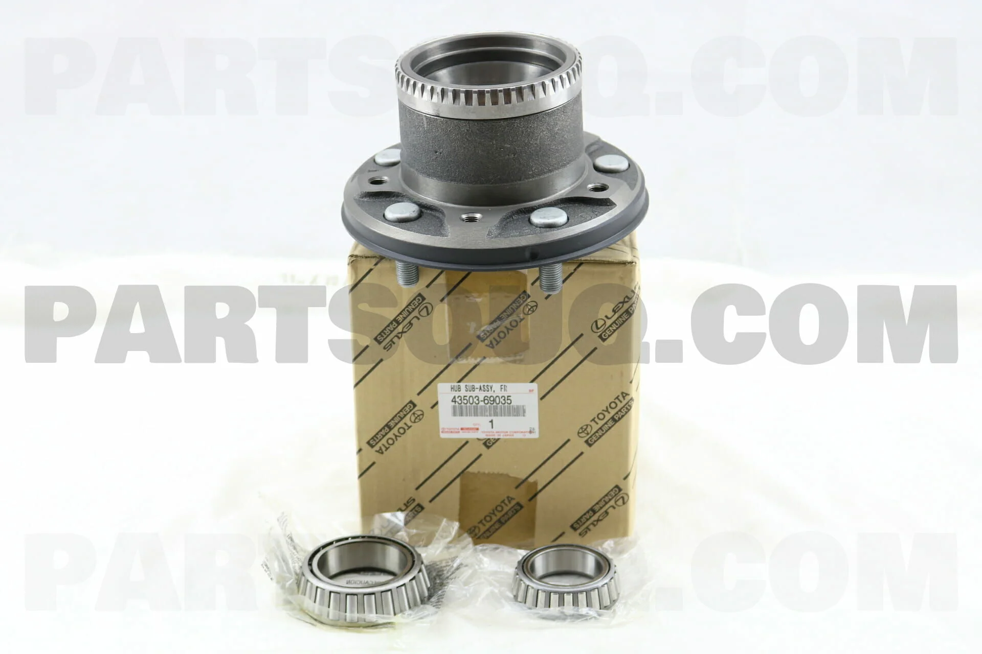

Wheel hubs actual come loaded (with bearings and races).
But it waste of money. Unless wheel hub damaged beyond restorability.

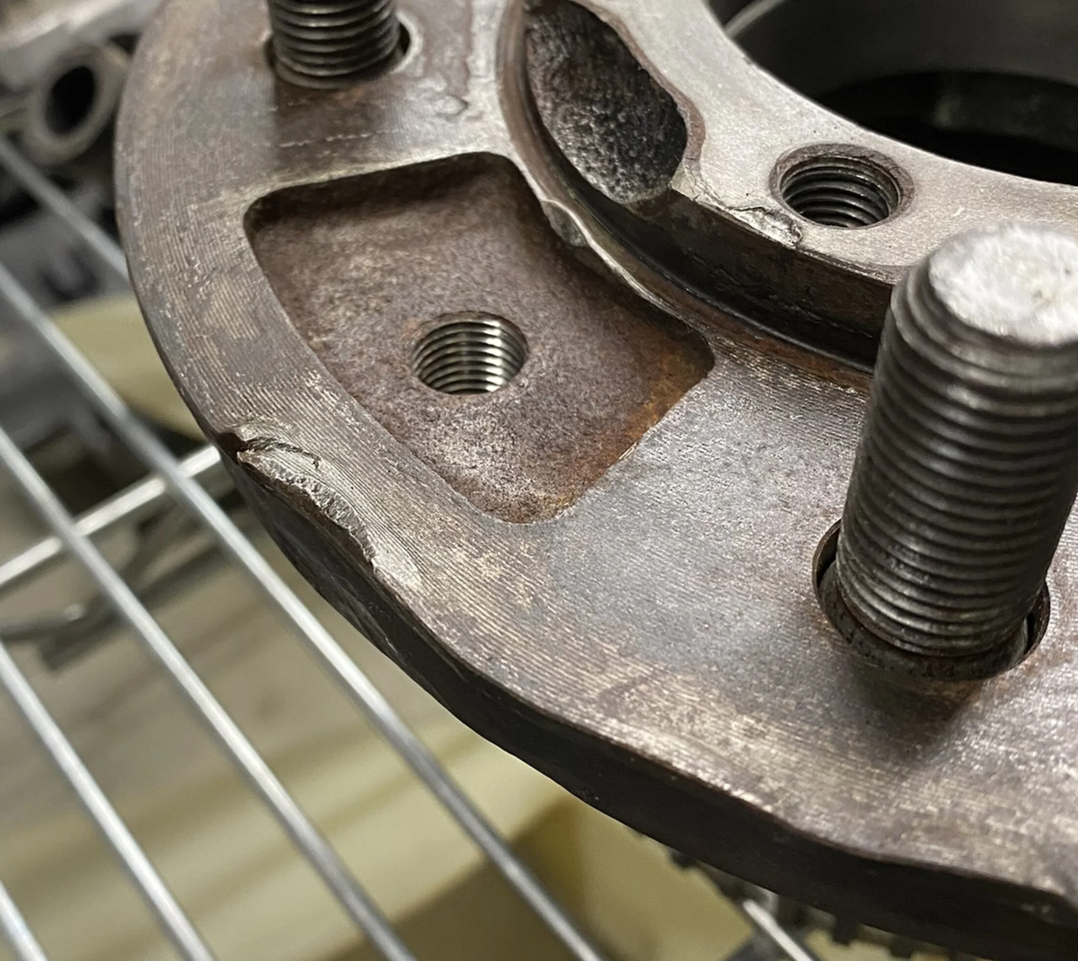

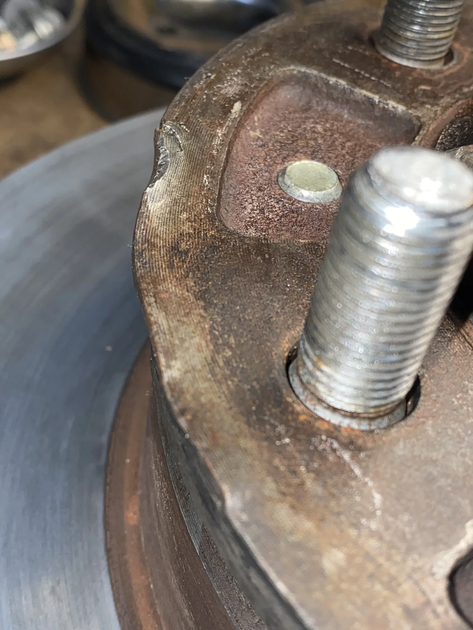

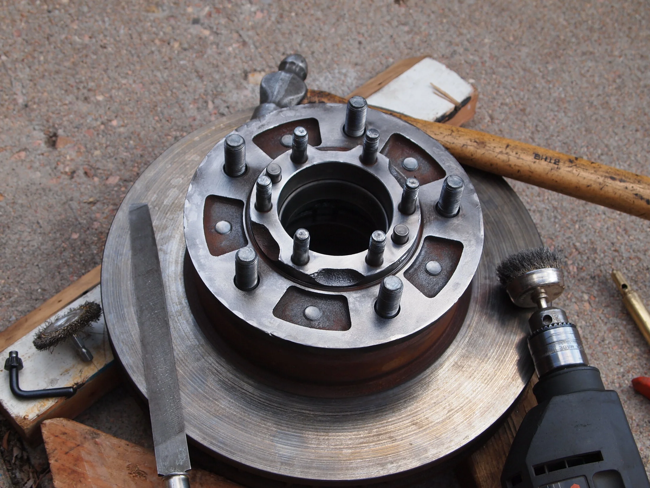

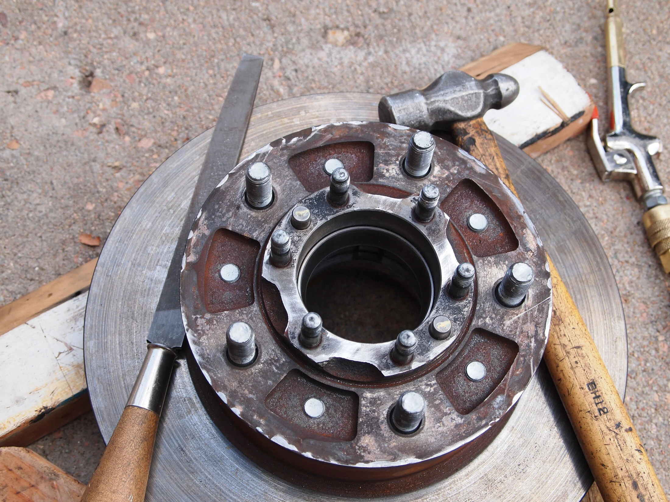

Number one way (other than accident) wheel hubs, get damaged. Is again with BFH (Big F-in hammer) used to remove brake rotor. These kids at brake shops, beat then off by pound on hub face and or back side with steel.
Some pound on teeth, that wheel speed sensor reads. So we inspect for damage.
I restore a lot of wheel hubs. only 1 in ~200 that I had to replace. It was the one above, where metal so beat on it ripped the steel. Which was from improper brake rotor replacement.
