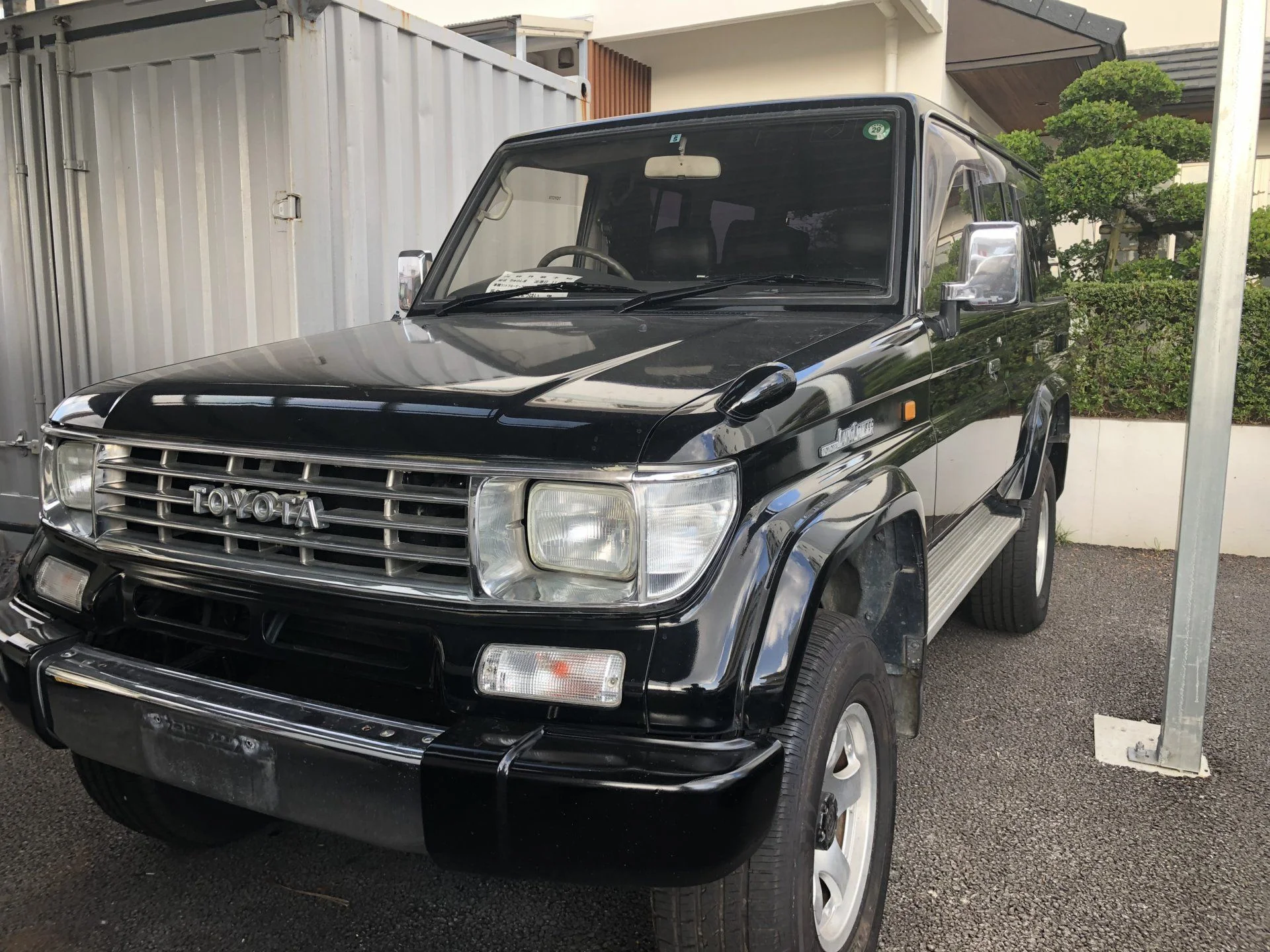

Hello all! Just wondering what wheel and tire combos can be put in my newly purchased 1993 70 series Prado KZJ78? It’s lifted only 2 inches because I don’t want to have to get a stool for the wife to get in but I still would like beefier tires on it. Pics with specs would be a GREAT help please! Thank you!

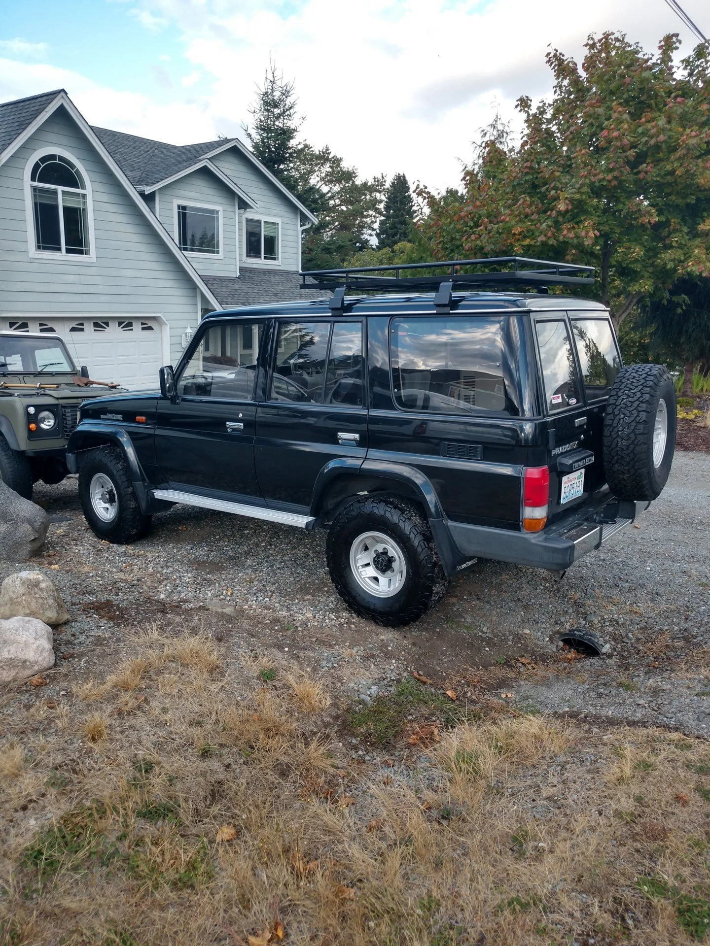

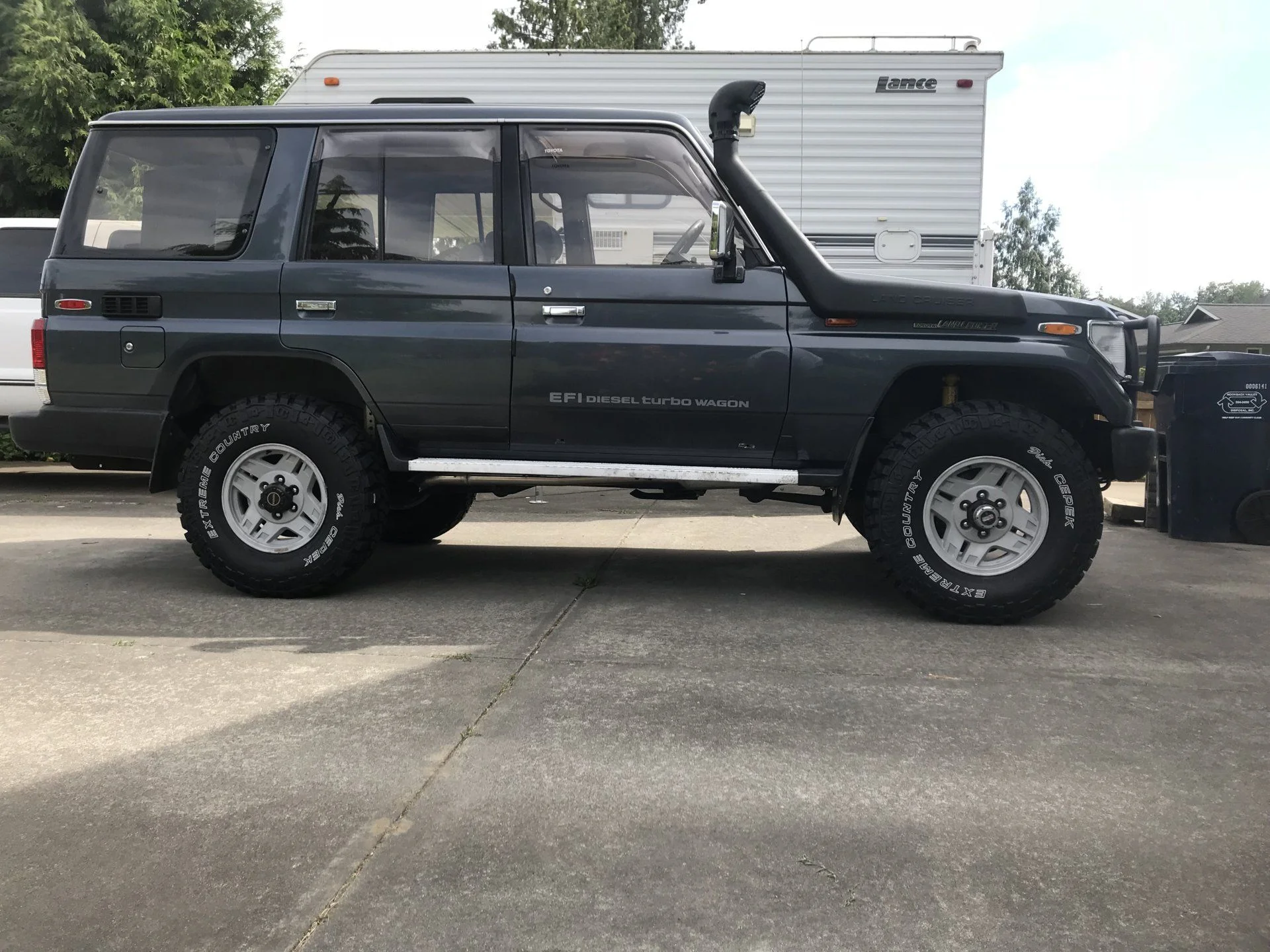

Not sure what size rim you’re looking to get, but tall and skinny work best, otherwise you’ll have rubbing issues. I just got a set of 235/85R16’s for mine. 255/85R16 work well with a small lift. My previous Prado had 31x10.5R15’s.
I believe @JimmyPrado has some photos of 255’s and a 2” lift on his rig. Not sure how much wider you could go, a 255/85 is about a 10x33” tire, I test fitted a 32x11.5x15 on my old Prado and IIRC it barely fit with no lift. You could also play with backspacing/spacers to get a different stance, but there is always a risk of having them rub.
I have about a 60mm lift and run 235/85R16. But I have run 35x12.5R15 before. They were on a 15x8" rim with 0mm offset. They rubbed at full steering turn. However, I believe if the rims had a more negative offset they would have been fine. Although I would have needed fender flares at that point, and I'm not sure how well they would have tucked then either.

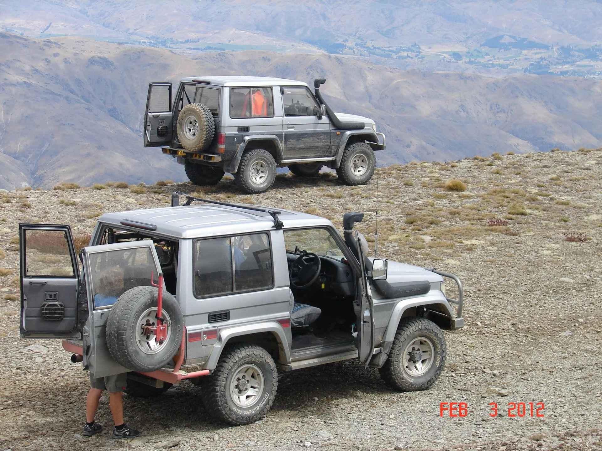

If you want to feast your eyes on lifted Prado 70 series with big tires, check here (scroll down a bit to the start - it keeps loading as you scroll down): Toyota Land Cruiser Prado 70-series. Мнение реальных владельцев на DRIVE2.RU
