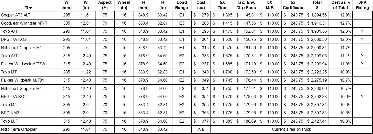

I'm kinda angling toward the BFG T/A KO2 in the 295/75R16 (33.4" tall) size they're $50 less each than the 315's (34.6" tall) and I don't know that the extra 0.6" of ground clearance will make a difference. I've been running 295/75 for a long time and find them ok; of course they all suck when going up a long steep grade, so I just slow down and enjoy the scenery.
My current comparison table from Discount Tire...
That's a very handy table you have there. I would just add that in my experience the replacement certificates are not worth the money. They are just insurance on a disposable, depreciating asset. Yes, we all lose tires every once in a while. But over one's lifetime it's generally a better financial move not to buy insurance on things like washing machines, air compressors, tires, etc. Google Clark Howard extended warranty if you'd like to hear his take - he's way more knowledgeable than I am about money matters. (Should I Buy an Extended Warranty on Tires? - https://clark.com/cars/tires-extended-warranty/) Just my two cents, not trying to come off bossy. I just see that the tire insurance alone is 80% of the price of one tire. That's a lot, in my opinion. (I actually asked the guys at America's Tire once when I bought a new set of tires if I could just buy one replacement certificate - for the one tire that might fail. The guy paused and said something like, 'That's not how it works.' That told me right there all I needed to know.)
On the subject of 'extended warranties' in general I am in full agreement with you and do not buy them. However, in the case of tires, and really tires that are intended to be deliberately abused when offroading by way of repeatedly airing down, subjecting sidewalls to driving in steep ditches or ravines, etc, impacting rocks, etc, the Discount Tire 'certificate' is really more of a 'tire insurance policy' than an extended warranty. In writing they claim 3 years or 3/32" tread, but in reality its more like 10 years, they just don't put that part in writing...
In my table the total certificates cost for five tires ($243.75) is shown as a function of the total cost of a set of five tires and ranges from 10% for the largest and most expensive tires to a about 14% for the smallest, cheapest set of tires. And, yes, that averages out about 75% of the replacement cost of a single tire. Meaning, if over the term of the life of the tire insurance policy you get one tire replaced, you will have effectively gotten it for about 25% off the replacement cost (and perhaps more of a discount if accounting for time and inflation...).
In the case of my current set of five Nitto Terra Grapplers from 2017 I have had Discount Tire replace two of the tires, no questions asked, one with a offroading induced sidewall tear from bead to tread two years ago, and one right now with a sidewall bubble (possibly induced by years of airing down and accompanying side wall flexing). So, two tires replaced for free out of five originals that are 6+ years old with a lot of tread life left on the three remaining originals. To me the certificates were a good investment (especially since the previous owner of the tires and wheels paid for those certs...). Which brings me to another good thing about Discount Tire certificates, that being if you sell your tires, those certificates are transferable to new owner; which can increase the resale value of your tires...
To be sure, some (maybe most) people will never recover an investment in tire insurance. For a daily driver car with street tires that rack up lots of relatively benign highway or commuter miles where road hazard damage is pretty unlikely, the investment may not make sense. Likewise for a mixed use daily driver vehicle that racks of lots of highway miles and only a little offroad for which the tires might last only a couple years before the tread is gone, the economics might not work out... But for the non-daily-driver vehicle that really only gets 5-10K miles per year put on it and tires intended to be abused; based on my experience thus far, heck yeah, I'll take that bet.

I can definitely see both sides of the argument regarding tire replacement certificates. I have purchased them from discount tire in the past but more recently I haven’t.
Getting back on topic I’ll throw out my experience with a couple of the tires on your list.
I’m running BFG KO2 on my 80 in 295/75r16. I like the size; it seems to be a good compromise for my use. I live at altitude, so I thought 315s would rob too much power from the 1FZ. I haven’t had any negative consequences by running this size off road. The 80 is so capable off road that I’ve considered moving down to 285/75r16 to save a little more weight and get back some gearing. That said, I like the KO2 but don’t love them.
I’m running the Cooper discover AT3 XLT on my 100 in 285/75r16. I had heard lots of rave reviews about this tire and was hesitant to switch from my normal BFG AT, but I have to say that I’m super impressed with this tire. They are smooth, quite and all four tires took little to no weight to balance them. They are way better in the snow and ice than the KO2’s and as good, if not better off road. I am a convert now and thinking about the Coopers for my 80 when the KO2s wear out.
