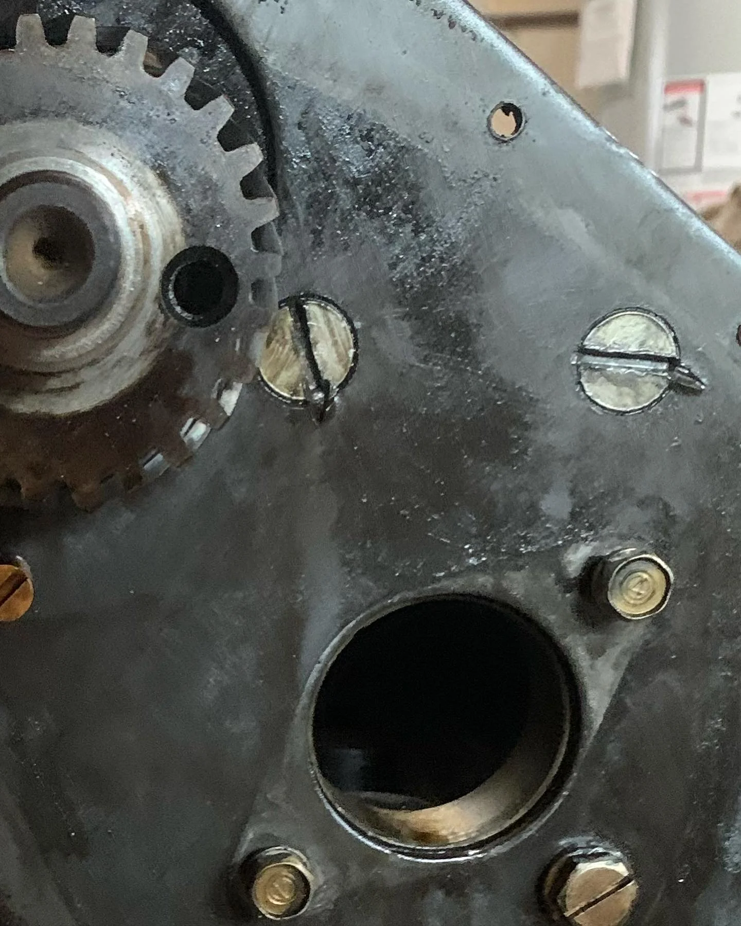

I’m looking for a shop that is reputable in north county. I’ve got a 8-72’ FJ40 block I’m trying to restore. Currently stuck with the flat head screws staked into the timing plate. Would love to take it to a shop and have them replaced along with other clean up processes while I have the block out.
Any suggestions would be greatly appreciated.

Those aren't terribly hard to remove if you would rather save some money. I just hit mine with a flatheadon one side and it went pretty well.
This is the tool most would recommend for the job
Amazon product ASIN B004QO9FK2
You probably already know this, but be sure to replace those with the allen head variant, I think they are from the 80 series.
