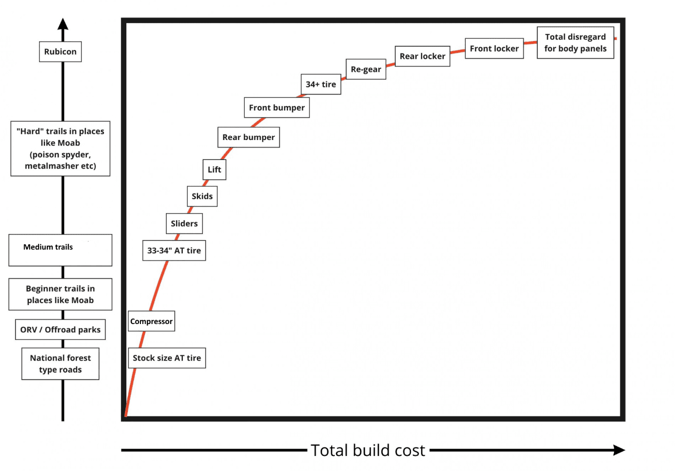

With 200-series (particularly LX570) prices coming down, there have been a huge influx of new owners here (👋 WELCOME!) trying to figure out where to start.
While I love a beastly build just as much as much as the rest of you - I also admire some of the more restrained, carefully built rigs that focus maximizing capability against weight, cost, and utilization.
I've had this doodle in my head for while (updated 15-Jul):
I'll caveat this with:
  • There is no wrong answer
  • It's an oversimplification obviously
  • Some sequences are subjective—you could argue that basic armor lessens need for bigger tires, or the inverse
  • Factors like convenience, range, frequency of use, and comfort are important considerations that aren't represented here
My assertion: With such an already capable truck, the basics get you 80% "there" depending on your desired use. Beyond that, there is a pretty long tail in terms of additional capability per dollar spent.
I'd love to hear your perspectives!

This is a great thought exercise. Laid out in a easy to understand visualization of what's necessary to tackle different technical terrain.
I hope you don't mind and I've taken a cut at your graphic from my perspective. I give a lot more stock to the factory vehicle tackling more difficult terrain. Out of the box, it'll handle even medium trails with no upgrades and a descent driver. Once you get into larger tires, even hard trails are viable. Much of which is due to the stock lift capability already built in. I like the sentiment of sliders, skids, bumpers and armor, but frankly with the amount of lift and clearance and control that can be had with the vehicle with big tires, and AHC sensor lift, I don't really plan on contact sports in the first place.
I added in a compressor as an early mod.
For basic wheeling...in order of benefit compared to stock:
-FREE Remove side steps (avoids rocker panel damage multiplier)

@tbisaacs I like it! I think graphics like this are better left simple and straightforward like you've done, but I might note the list is slightly different for an LX vs LC. The suspension in an LX is already as good as or better than most expensive aftermarket lifts, but the bumpers particularly on a 16+ LX are going to be a challenge off road. Of course items you put inside the truck are also a big consideration like the air compressor @TeCKis300 mentioned as well as tire deflators, so maybe a similar chart showing what you should pack based on where you're going would be a valuable exercise as well? I just created a "packing list" video with most of the basics and tried to outline in a similar fashion with buckets of must have, good to have, nice to have based on what people are doing. Of course these things can get way out of hand when one person swears you need a pull pall winch anchor to go to Costco whereas one guy said he did the Rubicon in a stock Rav4 with bailing wire and duct tape, but these graphical representations are most helpful when they're "geared" towards the masses.
