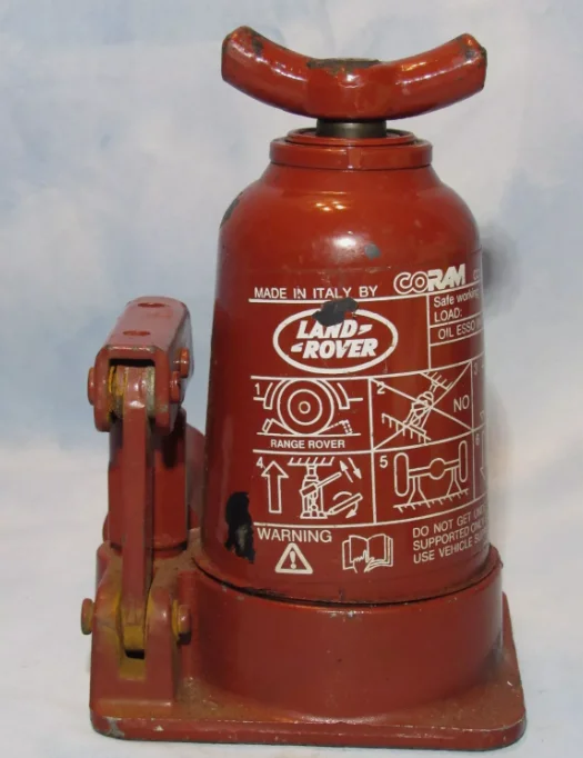

I only run these LR :flipoff2: hydraulic jacks because they have the axle cradle built in, and they go up quite far. Also they're rebuildable, even though I have never rebuilt these since they don't leak a whole bunch. My baby girl is 7500# and using a mechanic jack is plain silly, IMHO. I've never tried to mount one in the factory location since that's where I keep a gallon of coolant upright but it should work with some creativity.
Yeah, I know about the aftermarket axle cradle adapter thing which can also be made up easily. ;)
