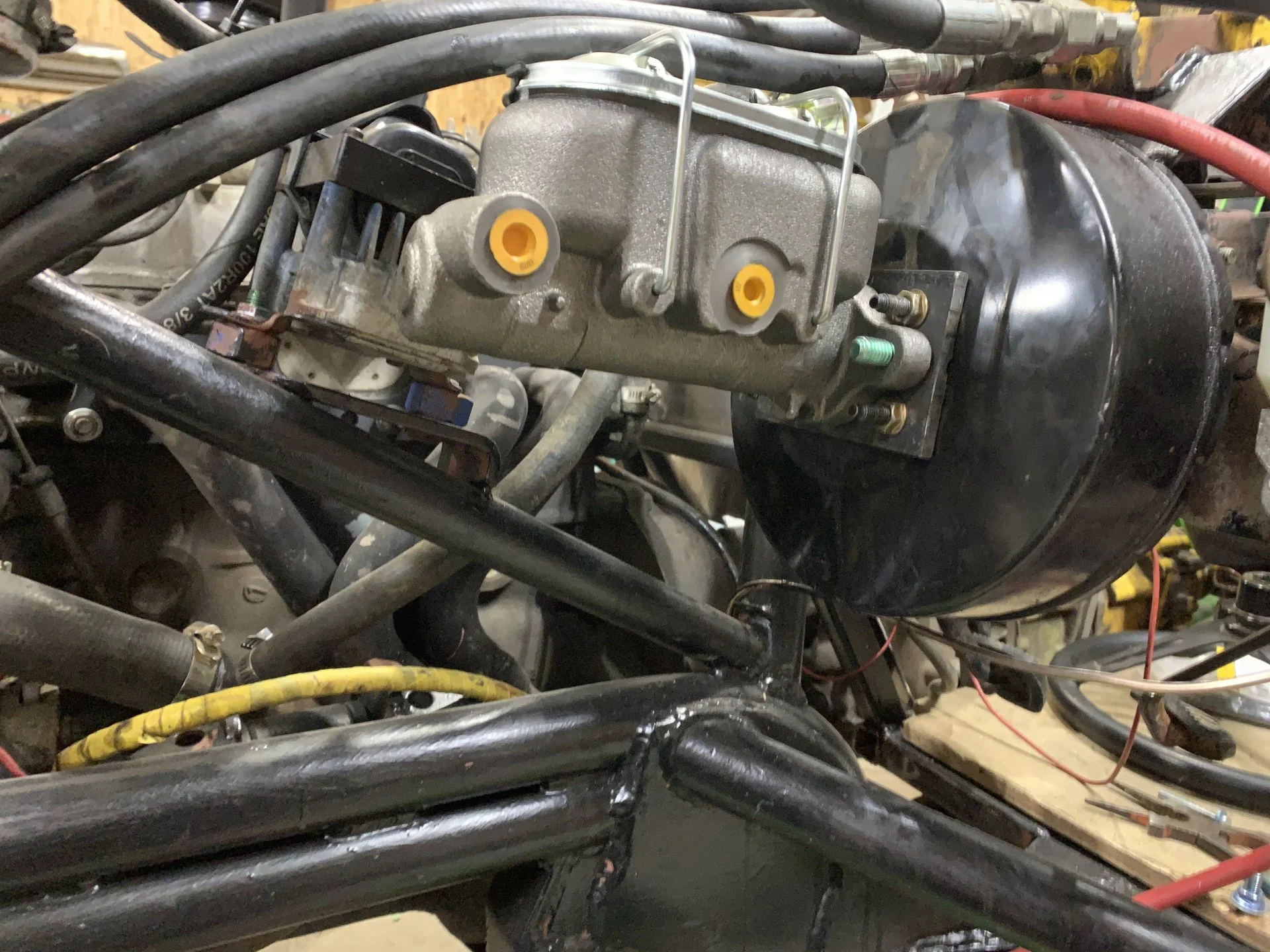

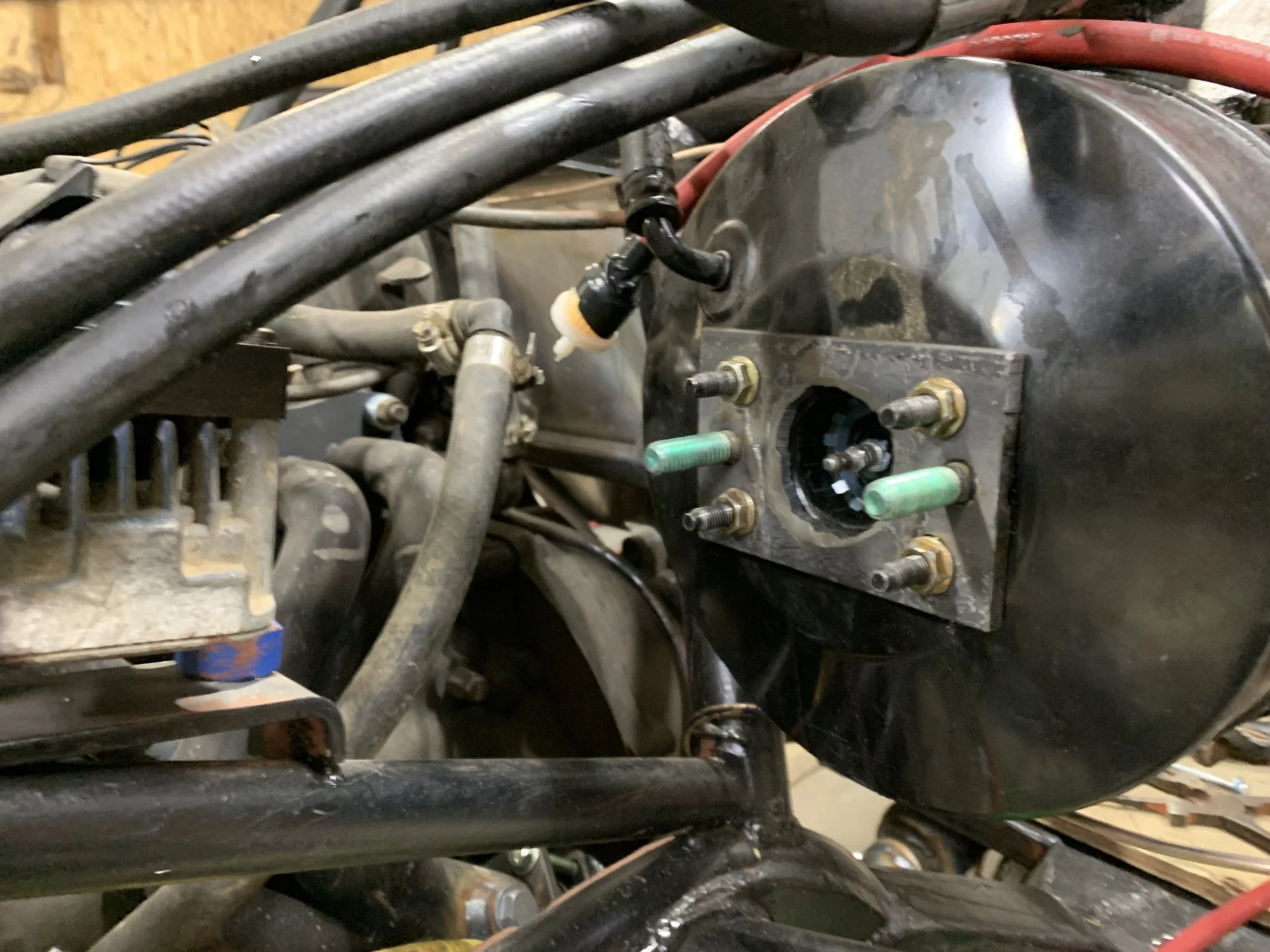

i think thats the same one i use and i never had so good of brakes, dana 60 front and back. a pro. valve would be needed for street use but holly chit 42s it locks up like mad now. and i made a simple adapter, this was not my idea, i found it on here or the other site but works like a champ
When I ran disc brake 60’s front and rear in my old mini truck, I started with the FJ80 master that I had upgraded to for the bigger IFS/FJ60 brakes and it just didn’t move the volume of fluid needed. So i got sky’s adapter and followed the part numbers they recommended. Fairly certain I kept the vacc booster, never had hydroboost. It worked on my junk at the time and would lock both axles if you wanted it to.
