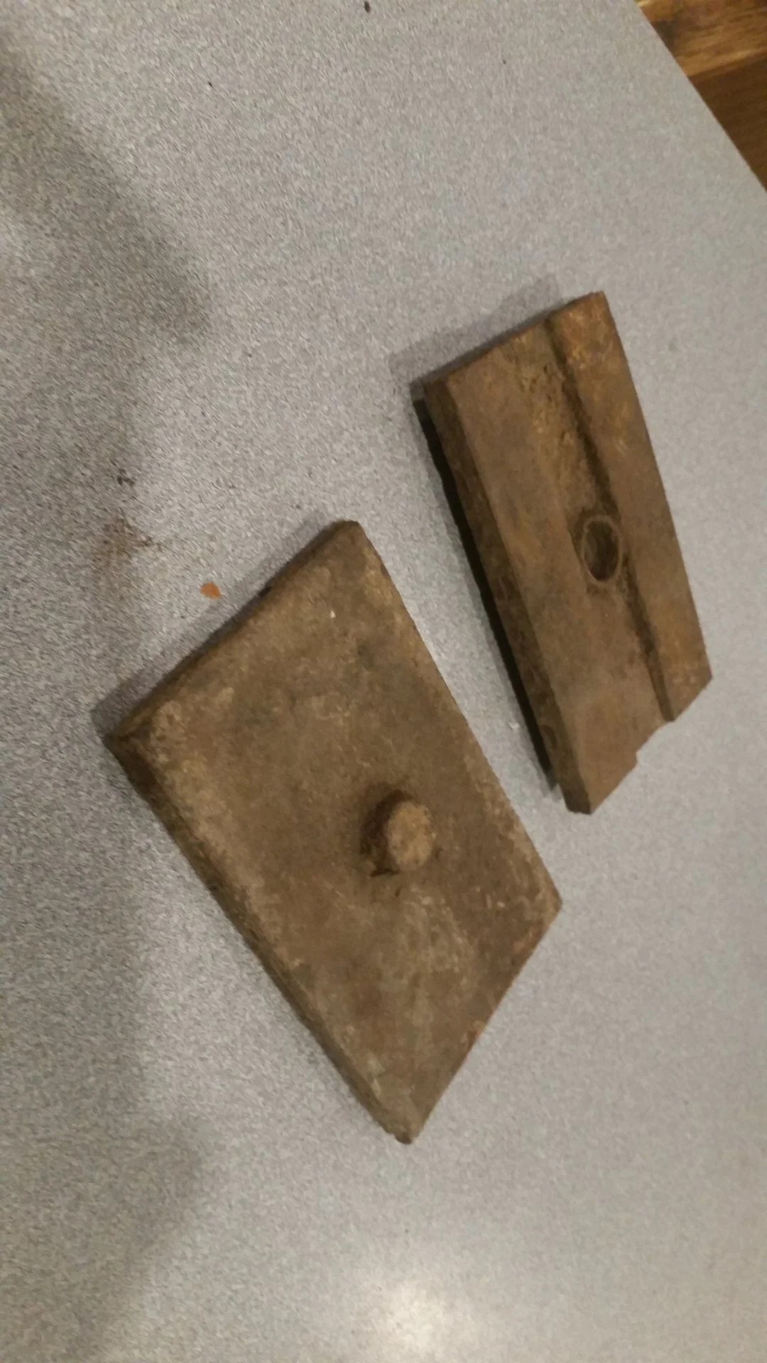

Nothing, really. What does work for a SUA is a spacer on top of the PS rear spring. Toyota makes one for that reason, but a piece of plate will work just as well with a hole drilled for centering bolt. Or you could get this:

Yep! Here's pics of Toyota's fix.

That Spring block looks to be easier than swapping the springs.

Good suggestion, I like it. That will definitely work and easier to install than swapping springs. Don't swap the springs, get the blocks.
The Toyota part is longer available.

Looks like we are getting deep into this conversation.....I did the CCOT block on the pass side and did not correct the issue so I took it out. I'm still confident that there is a weight imbalance mixed the potentially softer pro-comp springs that I'm running. The biggest change point to the good was removing the spare tire and rack.

Interesting. It worked well for me. I had OME springs at the time when I installed it. Then I went to HFS for the greater lift and moved the spacer over to them and it kept things level as well.
