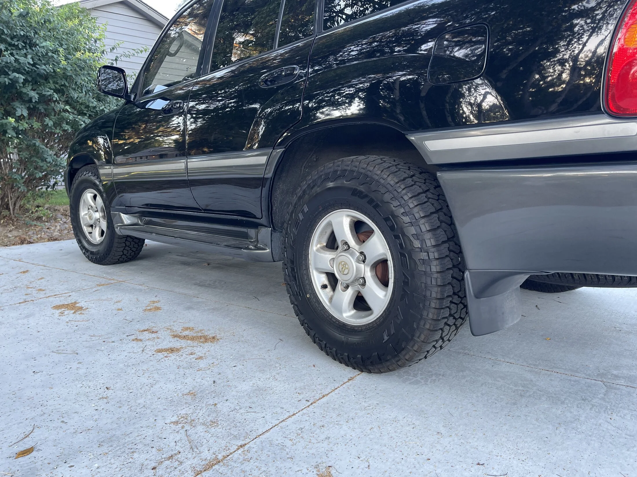

Installed the Gamiviti rack.
Good choice 😃 I have the same 😉.

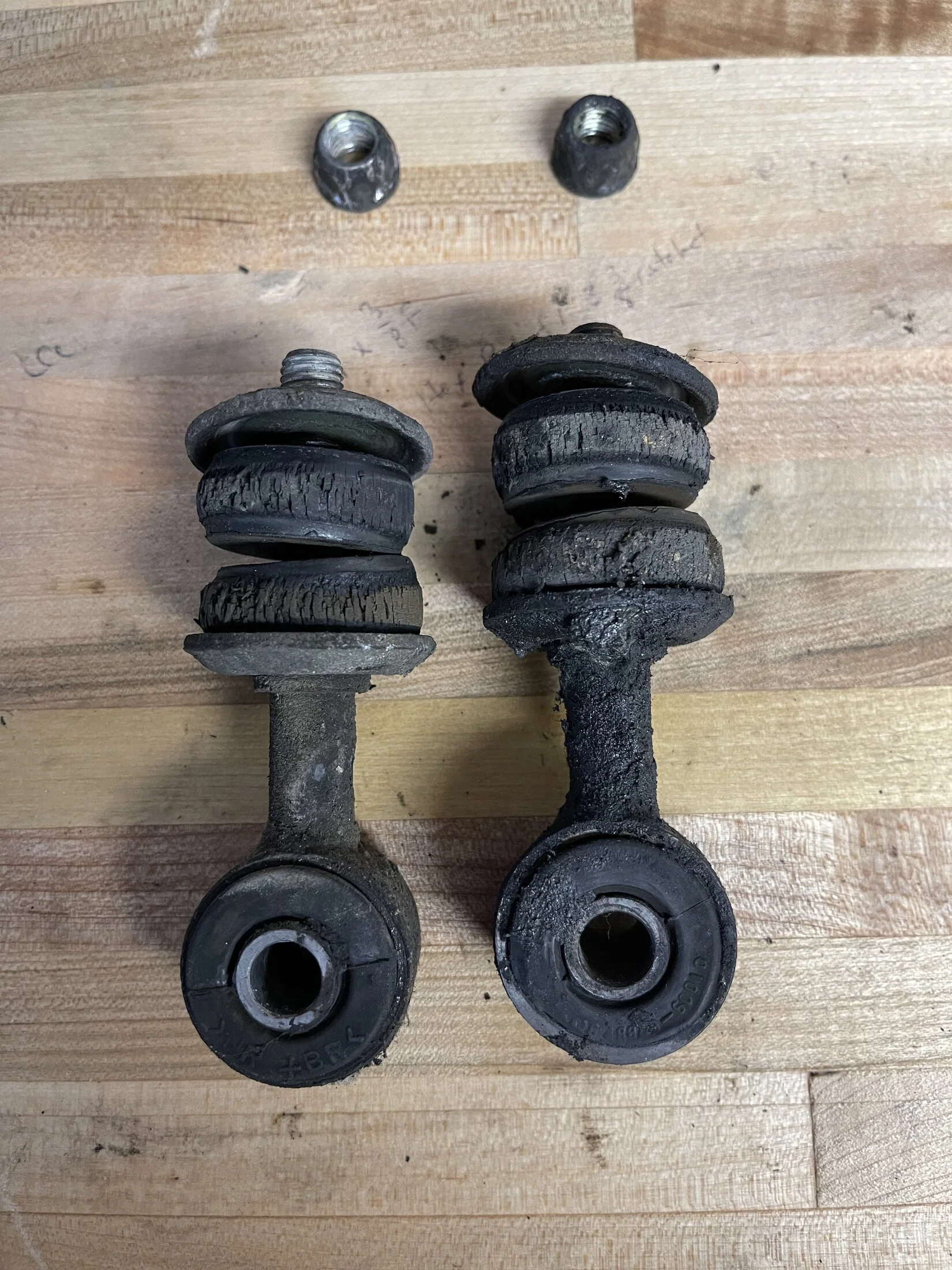

last week was the rear sway bar end links and bushings, today I did the front sway bar links (trail tailor extended) on my otherwise stock suspension TLC. Didn't have the energy left for the front bushings as it looked like I would need to remove the splash guard. Maybe tomorrow.

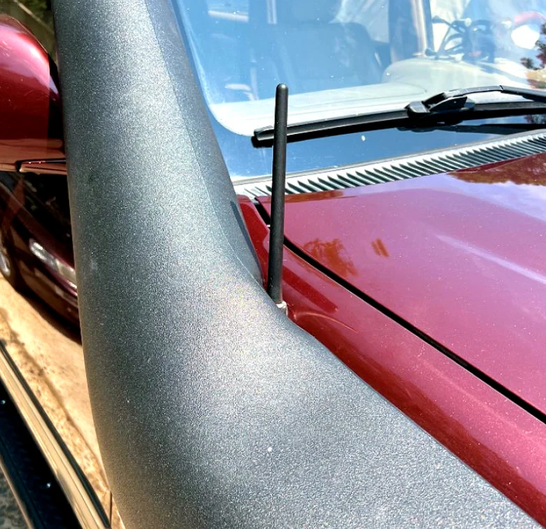

Installed an AntennaMastsRus shorty for 100 series. Removed the antenna control module behind the glove box. Also installed cabin air filters from the LX470.

how is the reception?
Better. The radio has reception from a second antenna, which adds reception. With this arrangement, I can get the weaker small stations when I'm two hours away up in the mountains. This is my 2nd use of this on my 2nd 100 series.

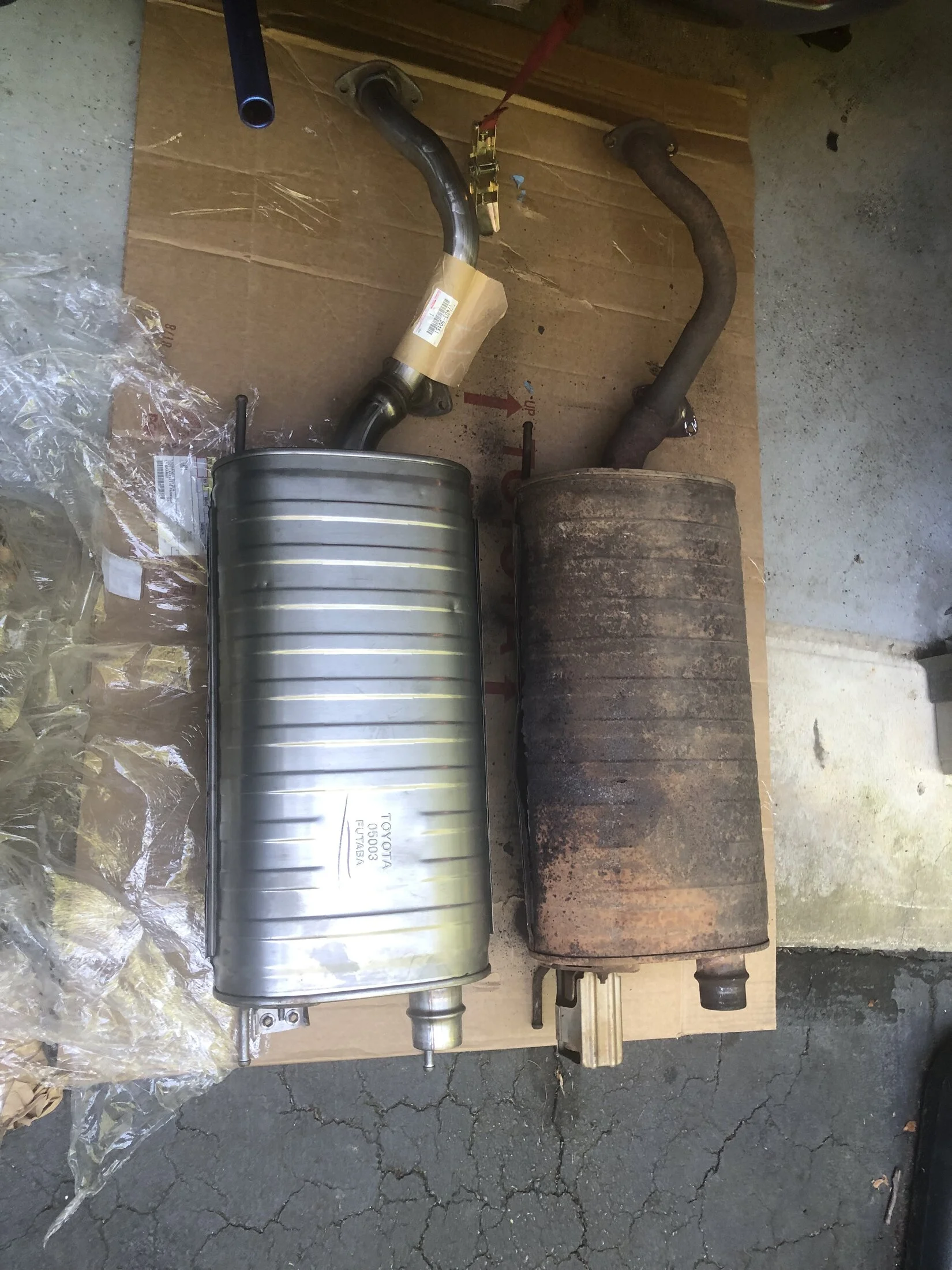

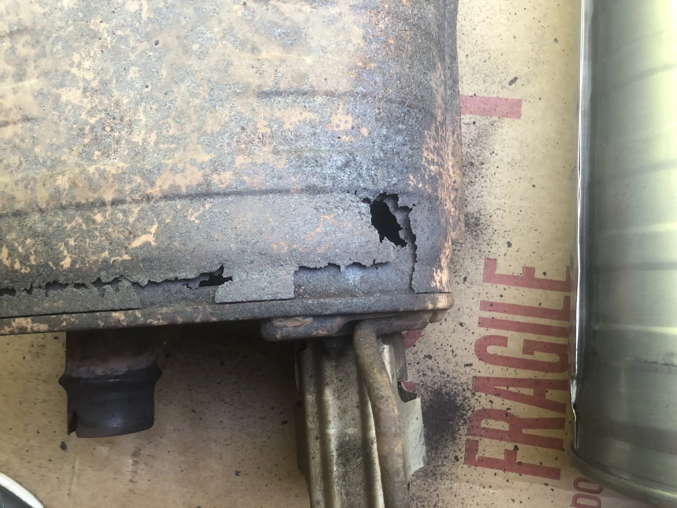

I'm planning on tackling the muffler job here shortly. Replacing with an OEM muffler with the current 25% off sale... still expensive though.
How did the job go? Were you able to get all the old rusty nuts/bolts off easily to remove the old one?
Not a bad job. I had to use an angle grinder for the two bolts connected to the flex pipe (the nuts were completely dissolved in to some unrecognizable shape). The other bolts came off easily after spraying the hot bolts down with pb blaster and letting it sit overnight. Spray the rubber hangers with wd40 to help them slide on and off the mounting points. You will need to transfer the vibration isolator over to the new muffler.
It’s heavy. Install the squeeze clamp in the rear section first with the thin gasket on the new muffler. Slide that end in first and then swing the front pipes into place with those gaskets on (clean up matting surfaces). Have a bolt and nut ready to temporary connect them. I put up some jack stands to help support things while I was attaching the bolts. After the bolts were snug I used a floor jack with some wood and padding to lift the muffler up so I could connect the rubber hangers. Then just tighten everything up.
Be sure to order replacement hardware and gaskets.
