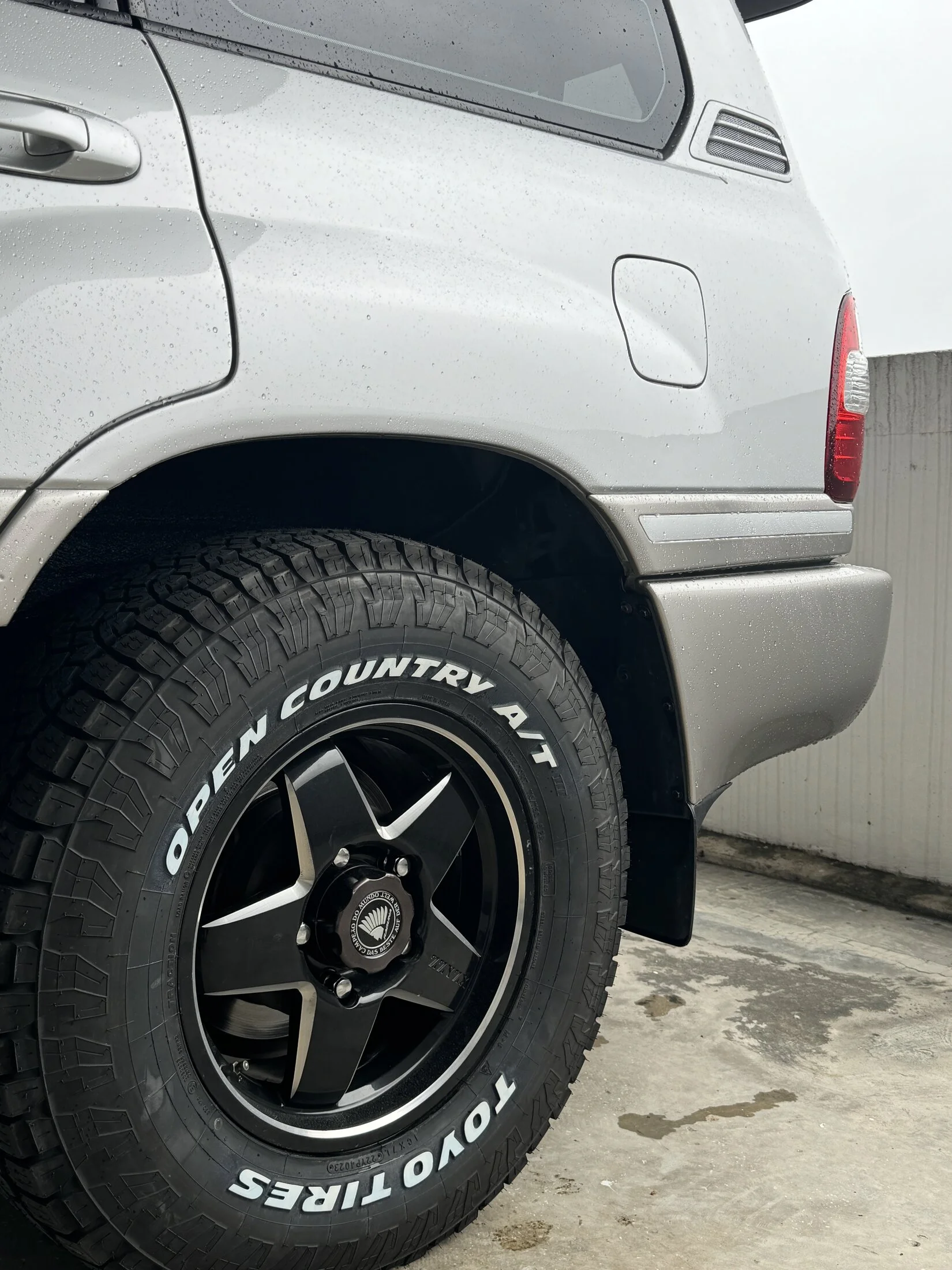

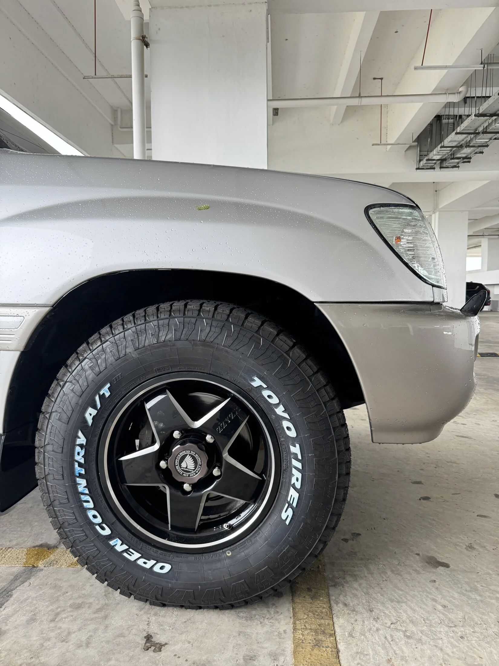

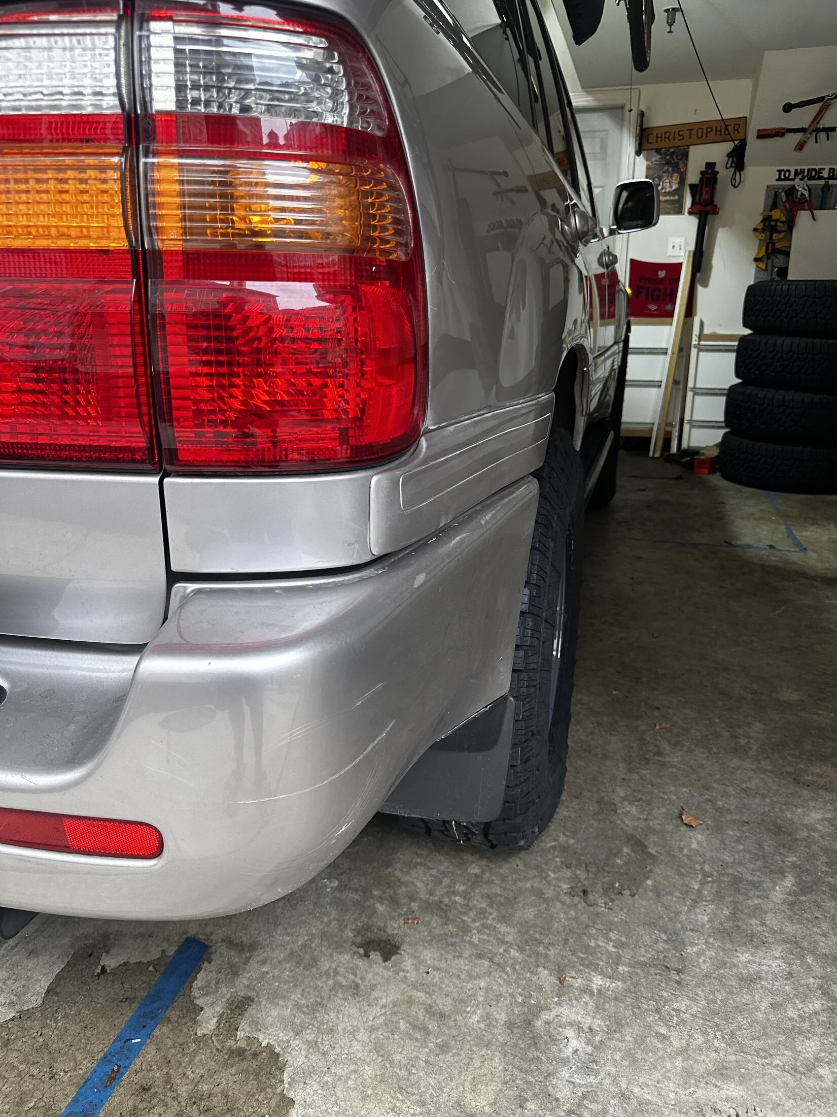

Just got myself a set of new rubber today!
New Toyo Open Country AT3 with white lettering. :cheers:
