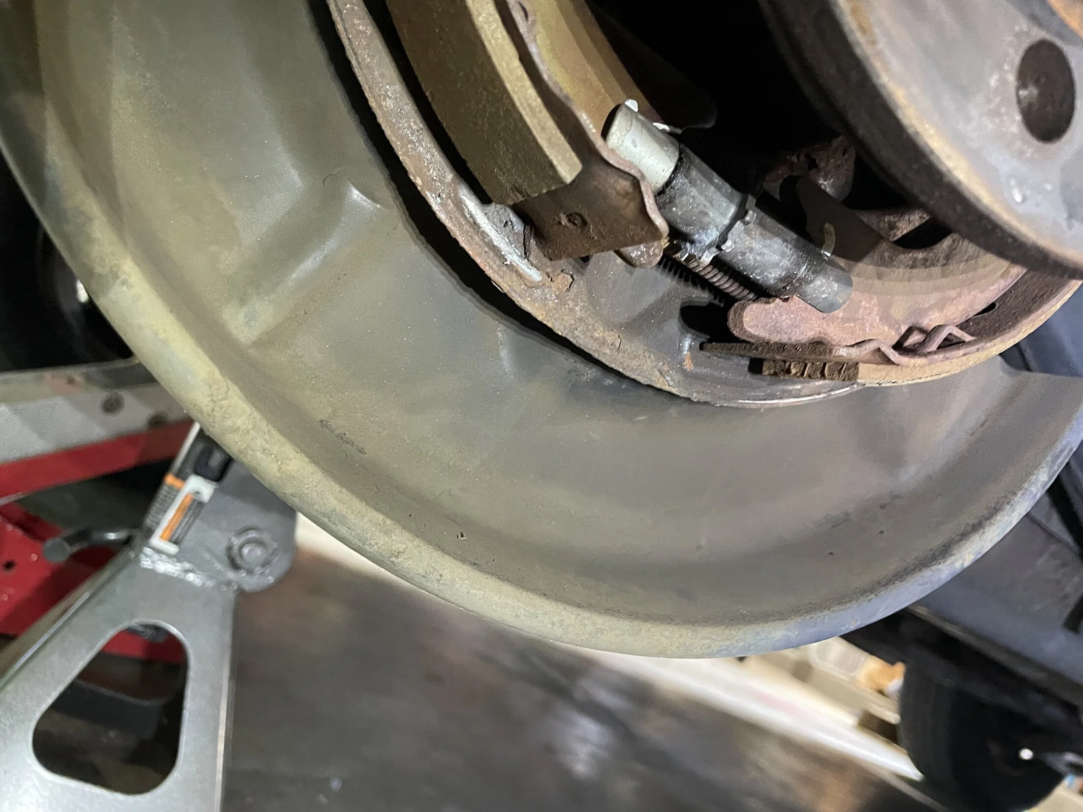

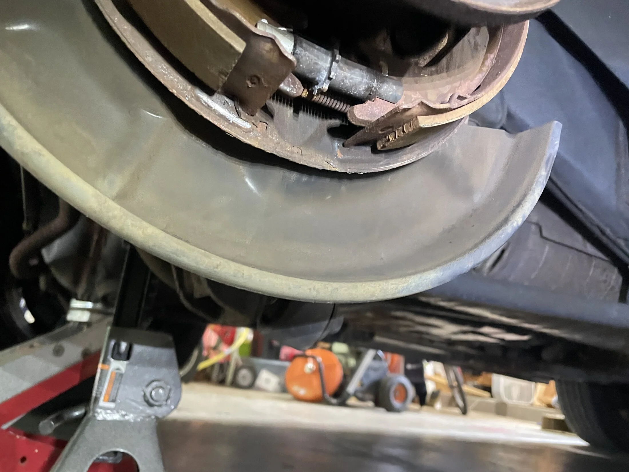

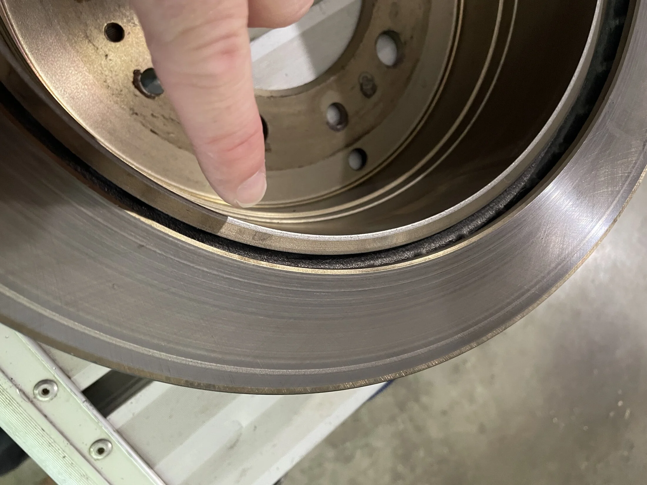

Installed new rear OEM rotors and Terrian Tamer pads last week and had a grinding noise only when turning left. Turned out it was the e-brake backing plate rubbing on the rotor. Thankfully the grinding left me a good indication as to where I needed to remove material. A few minutes with a Dremal and all is well. Had this issue about 7 years and vaguely recalled having to work on it some to get the noise to stop. Either the rust on the backing plate caused the issue or it was something else...PO?

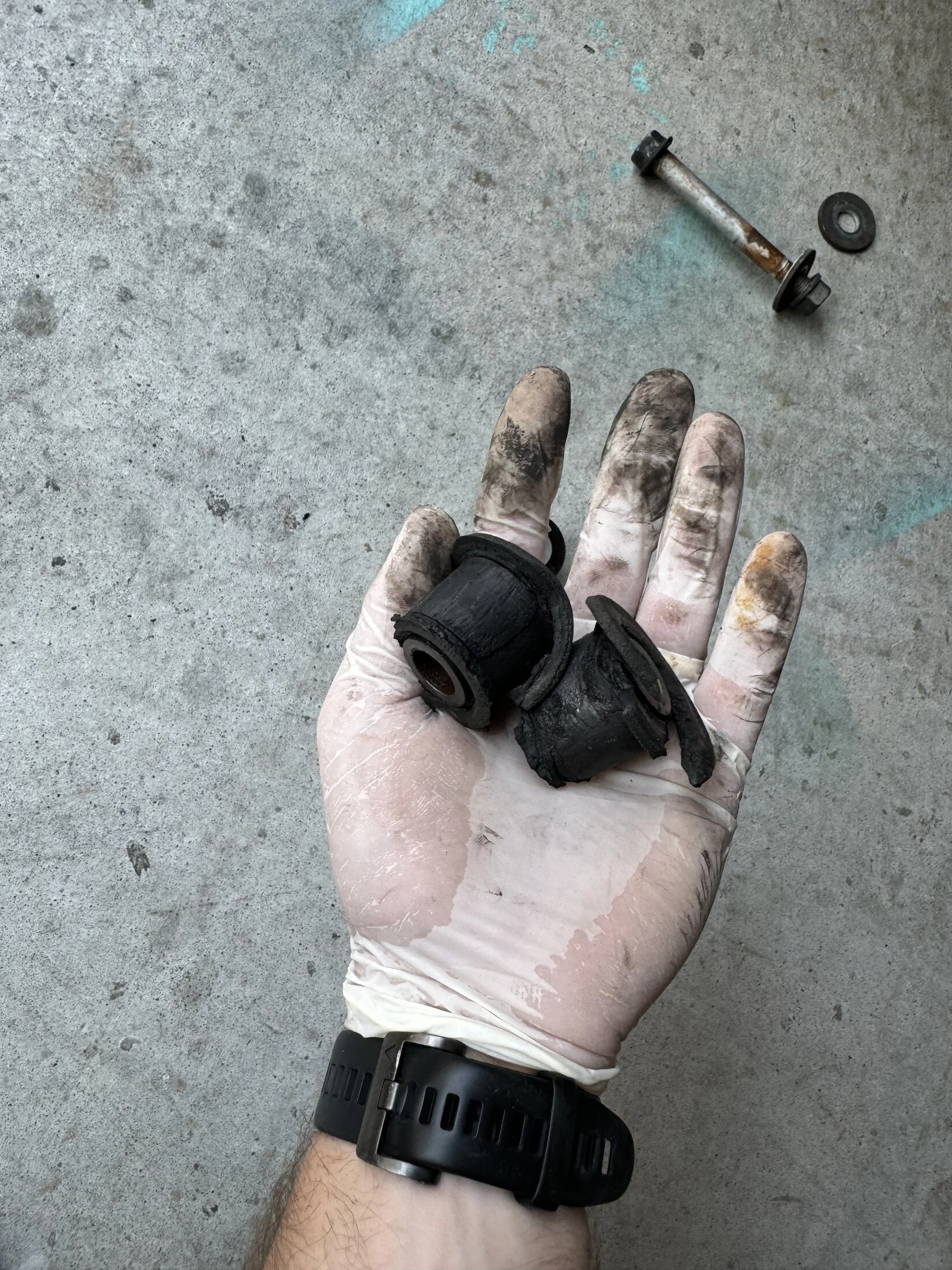

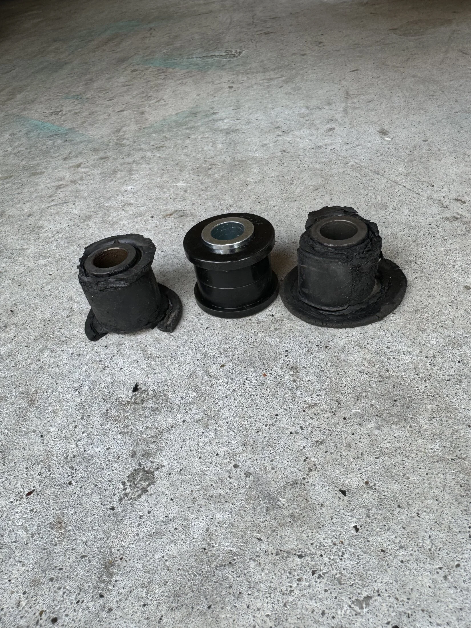

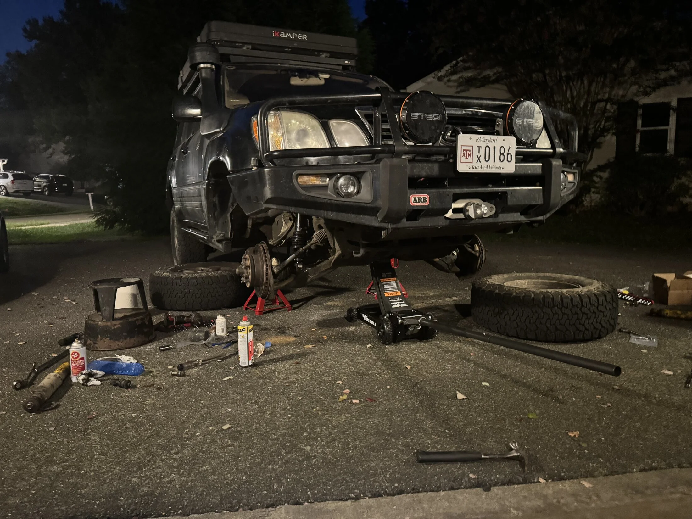

Replaced the steering rack bushings yesterday. Bushings were toast and everything feels much better now. With that slop taken care of and tightened up, on the way to get an alignment this am, since I'd also recently done inner and outer tie rods, steering wheel starts shaking intermittently on the freeway. Alignment shop calls and says one of my UCA (original 260k) is completely shot and they cant align it until it's replaced. This more than likely explains the loud popping I've had going on for a while now. Thought it was LCA related, but I guess I was wrong.
Would a bad UCA/ball joint cause the wheel to shake? Regardless, it's a great excuse to order the OME control arms I've been eyeing.

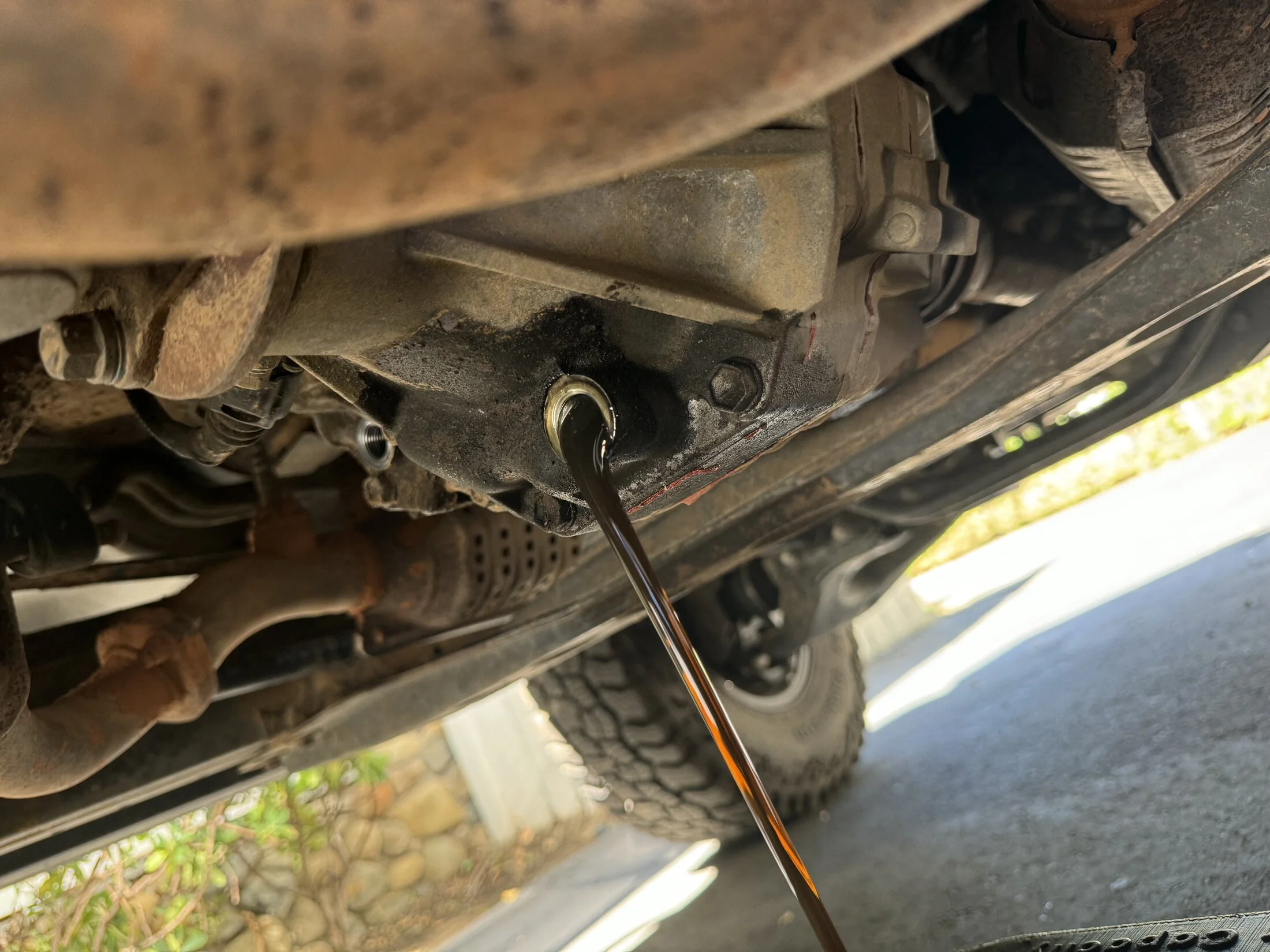

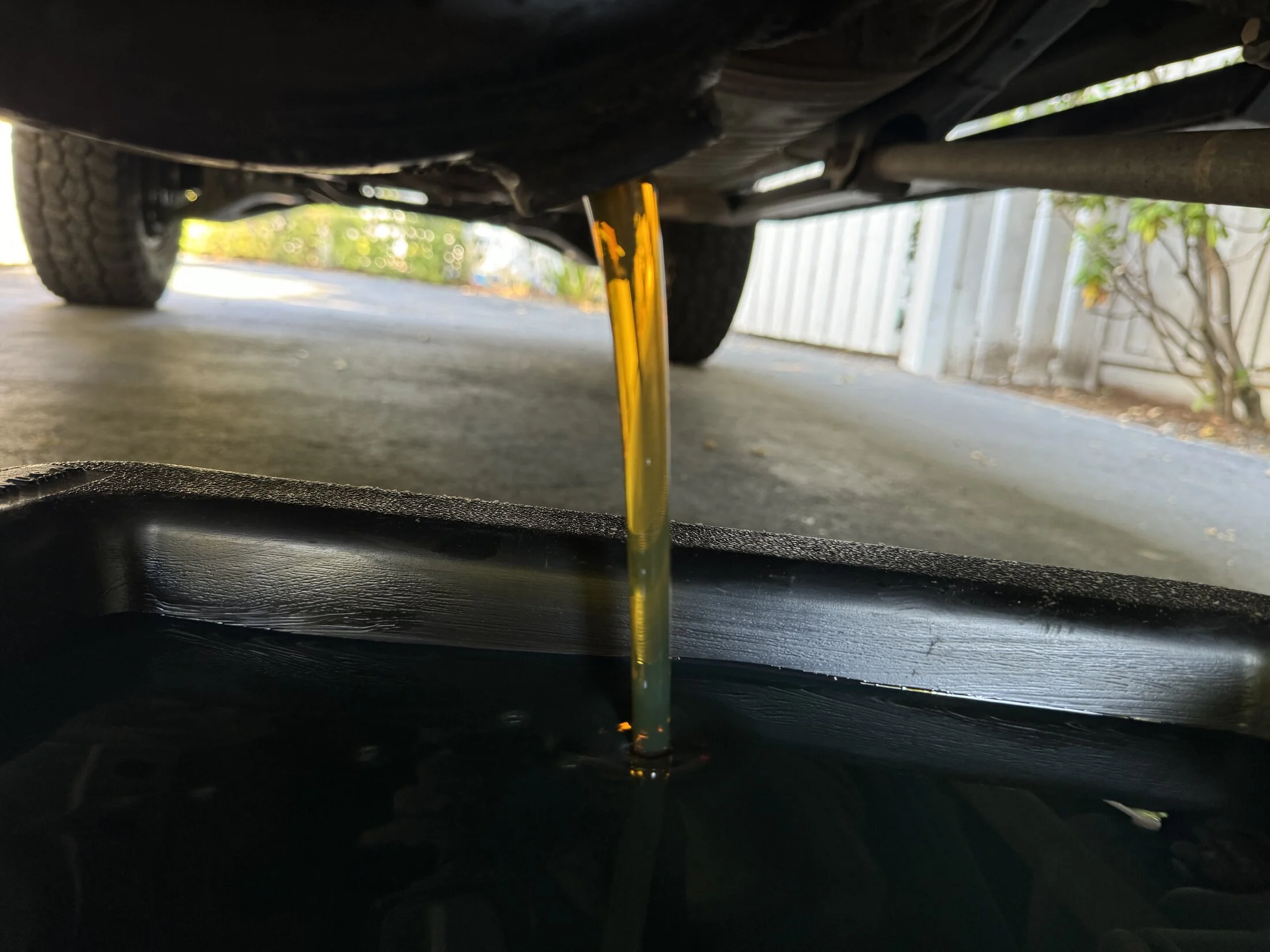

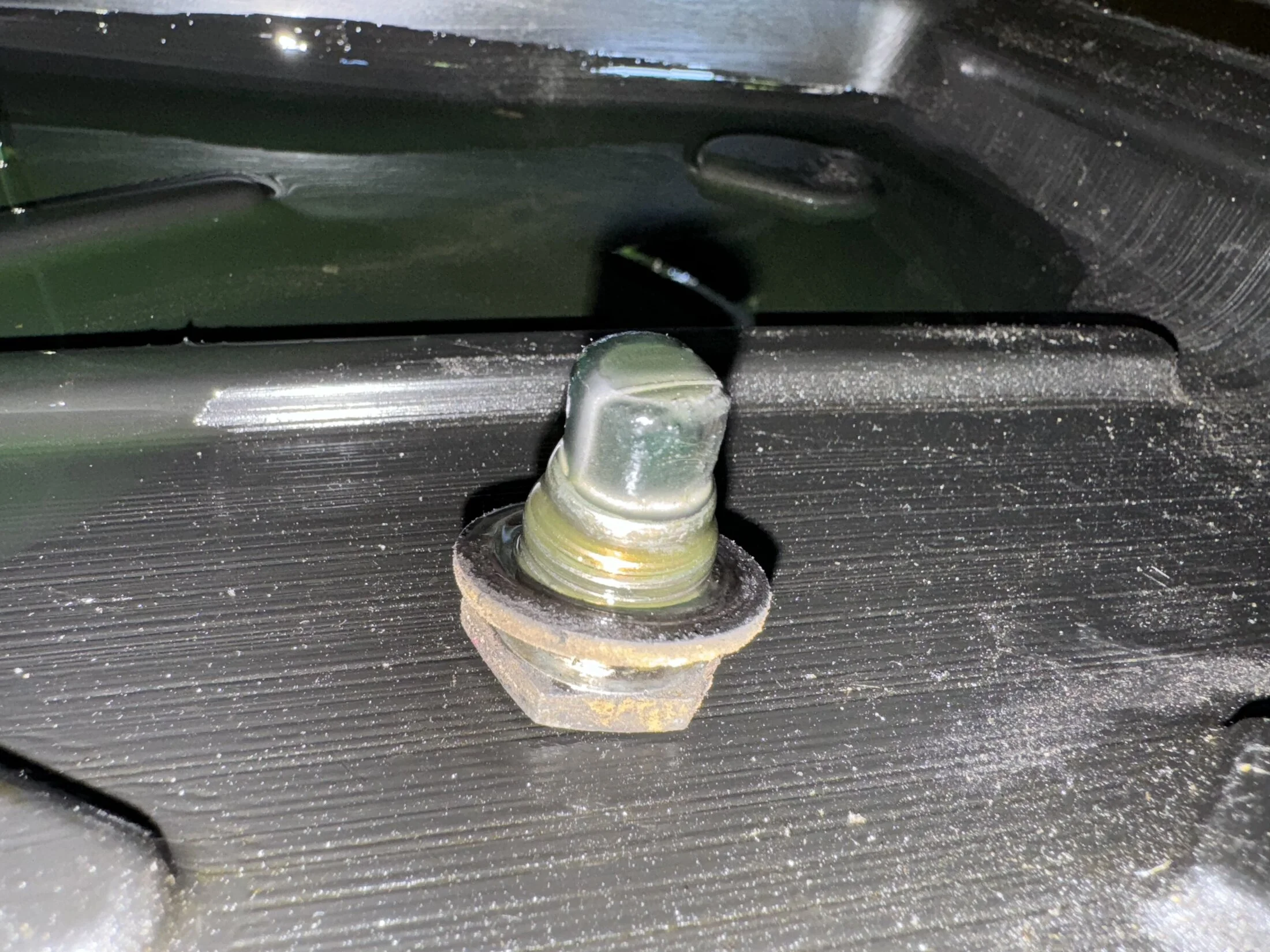

Swapped rear diff and T Case oil.
Somebody must have changed rear diff not too long ago although I can‘t find something in the invoices…
T Case looked „normal“…
Would a bad UCA/ball joint cause the wheel to shake? Regardless, it's a great excuse to order the OME control arms I've been eyeing.View attachment 3711503View attachment 3711505
How’s the condition of your steering column/rack & pinion bushings? Also the condition of your front differential bushings?
Which bushings are you referring to? Bushings in the column assembly from the steering wheel to the rack? I replaced the three main ones on the rack Sunday.
The diff support arms definitely need replacing, I couldn't tell the condition of the No.1 bushing you have to press in on the diff mount.

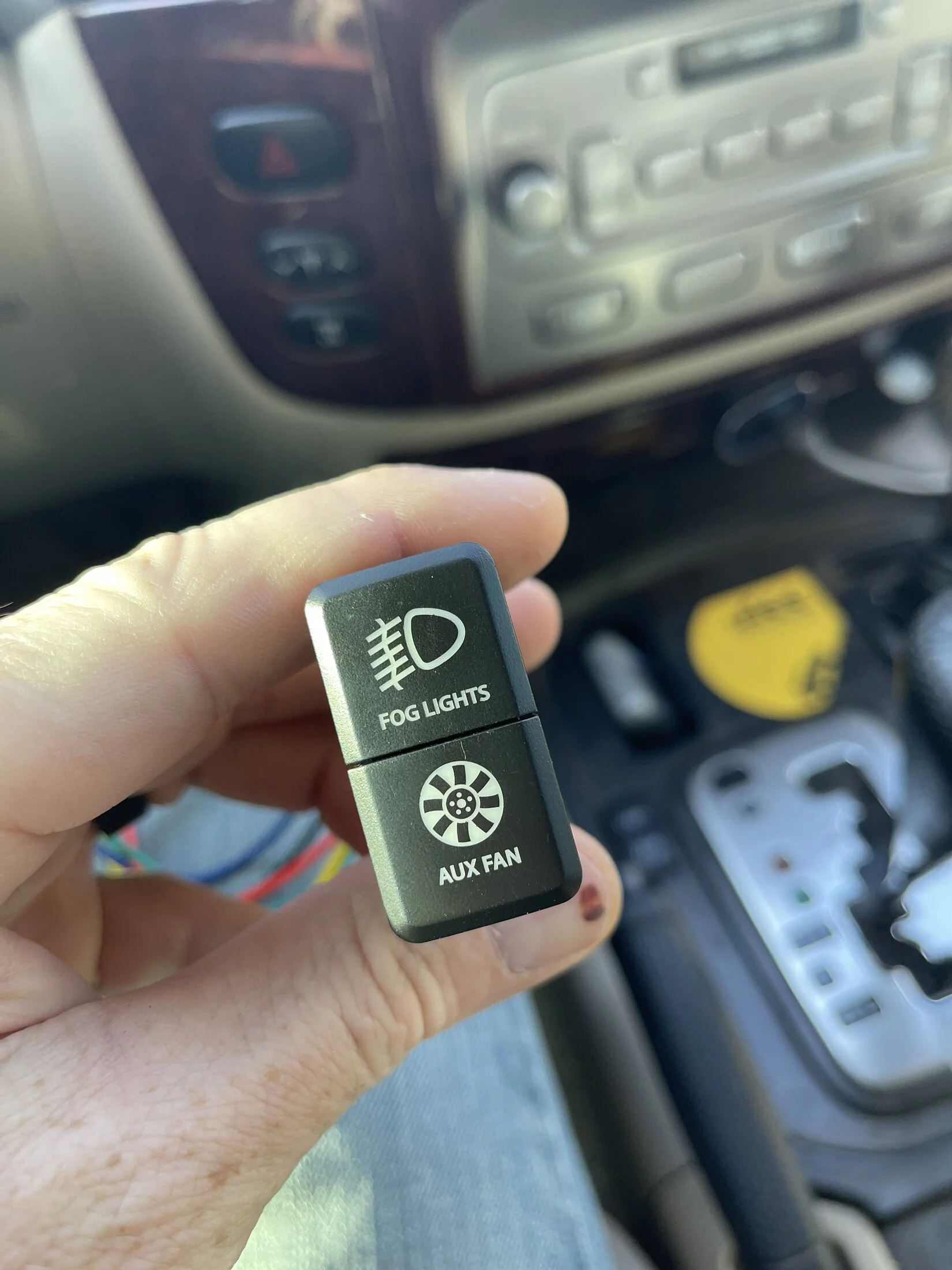

To prep for front lockers, I'm downsizing my switch sizes to make room on the dash. This is my first switch custom made by CH4x4 and it's nice quality. I tested each function with some test lights and a jump pack and both switches work well. Five wires total out the back. Shared Positive/Ground/Illumination and 2 for the 2 accessory relays. In my case, fogs and AUX A/C fan. They are made to Toyota switch size dimensions.

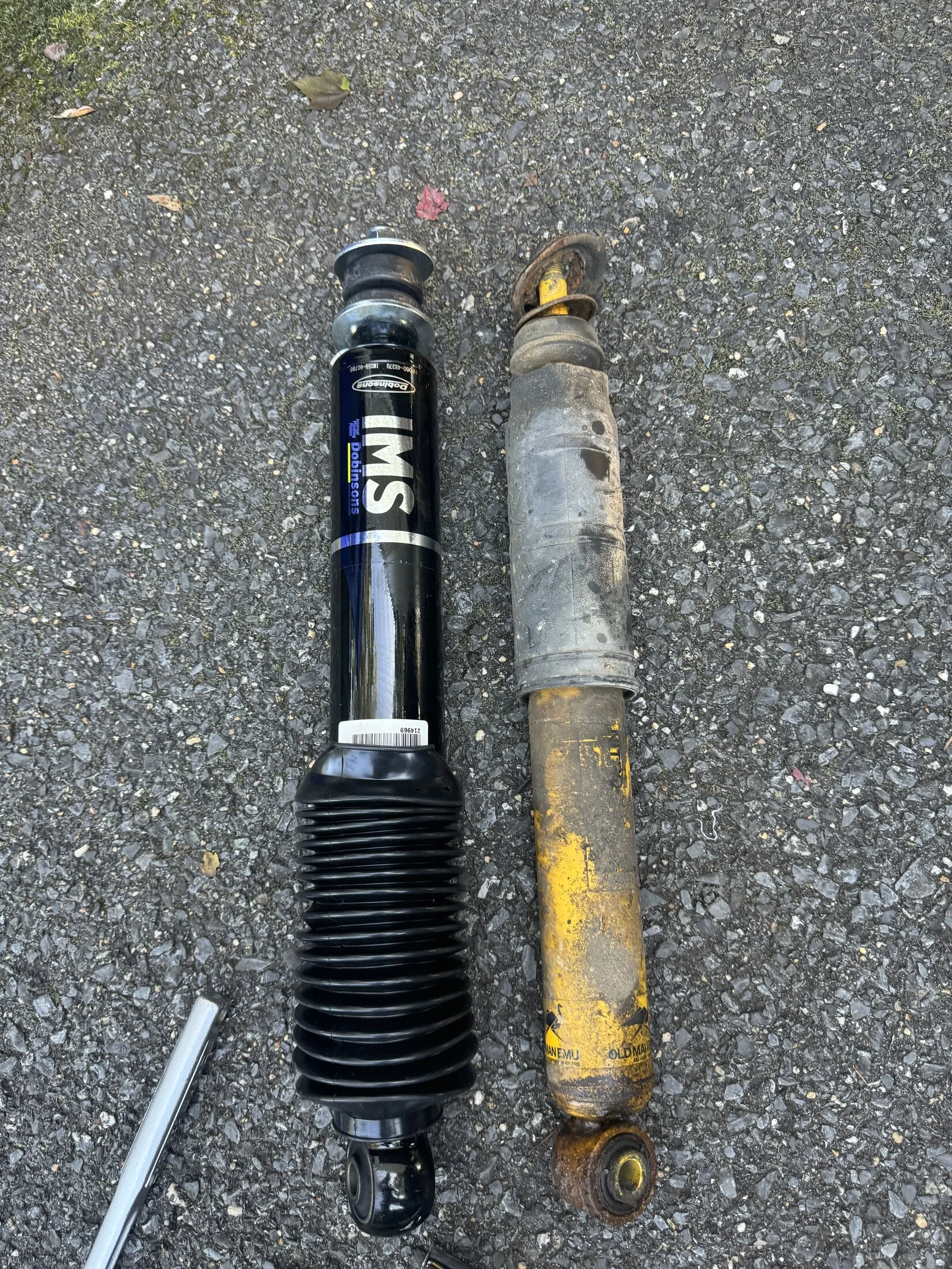

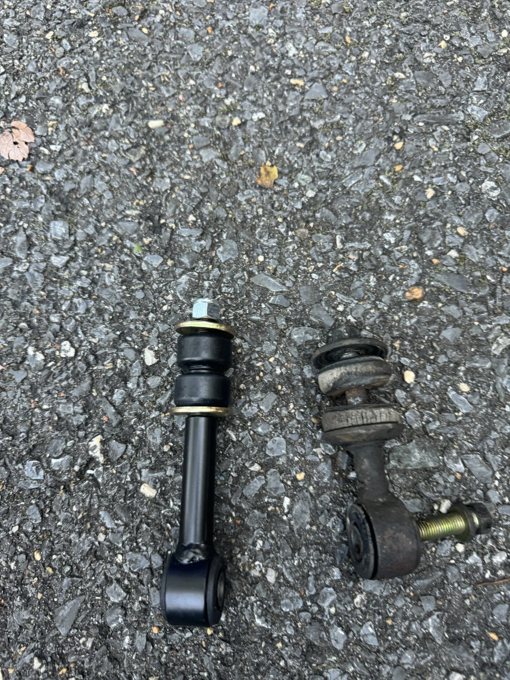

Installed some dobinsons IMS extended shocks along with trail tailor extended sway bar links.
Great shock choice. Would love to hear your feedback - I’m hoping to update my IM pros this Black Friday
Did your spc uppers play nice with the extended length?
Install was pretty straightforward. Verdict is still out on how well these perform. Still need to get an alignment done. But based on a quick 2 mile road test, it seems a bit firmer.
