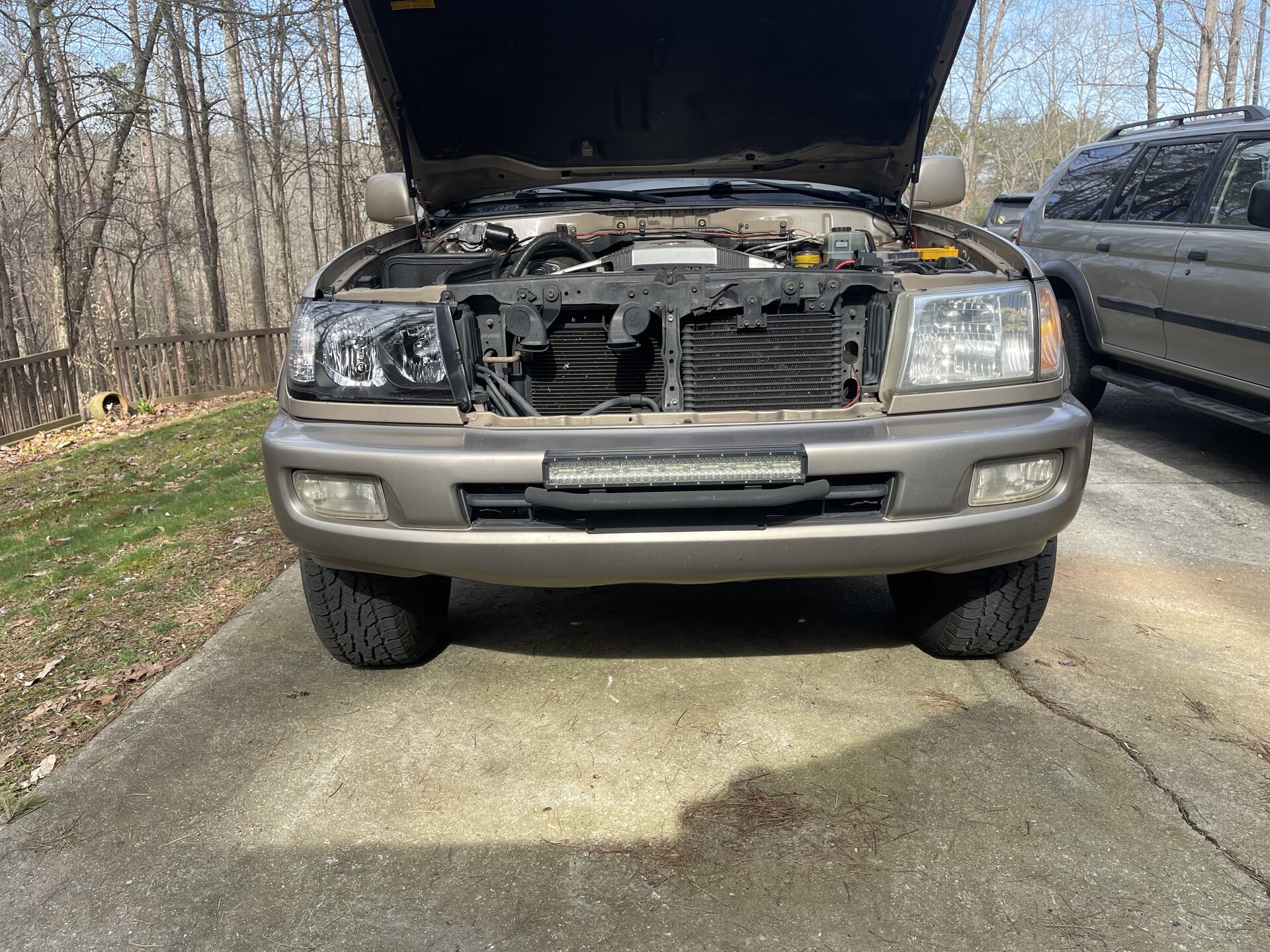

Turned 302,000 miles today & replaced the OEM headlights and turn signal assemblies after someone was kind enough to smash mine while they were drunk… $350 dollars later, and the new ones were installed and looking goooooooood!!!.. got new LED headlight bulbs on the way to replace the halogen bulbs.

Nice, but please say those reflector assemblies are meant for LEDs, otherwise you’ll be one of those $#*+$ blinding everyone at night.
