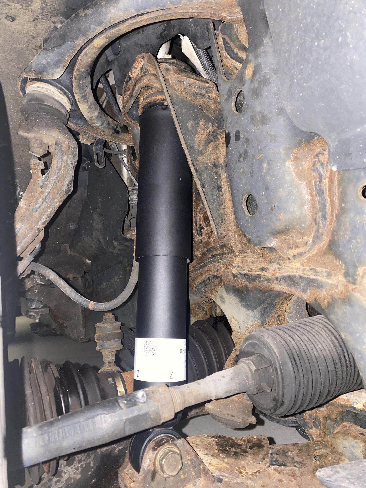

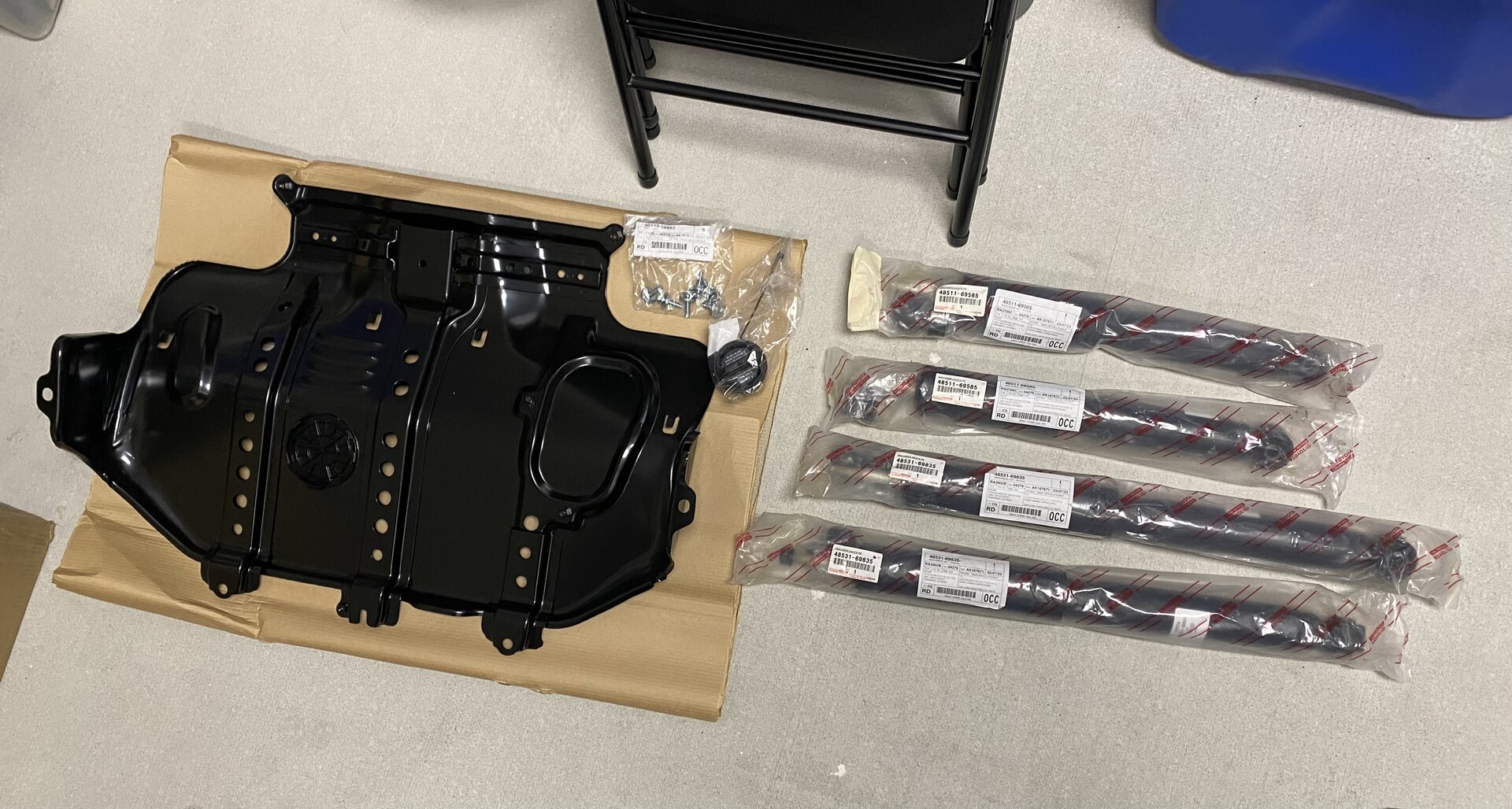

Thanks to Capo Valley Toyota, got some shocks for the mechanic tomorrow, finally replacing the original OEM shocks after 19 years and 99k miles. Installed a new gas cap. Couple of weeks and I’ll use the navy base garage and replace the old rusted splash guard with a shiny new splash guard that will never see snow.
