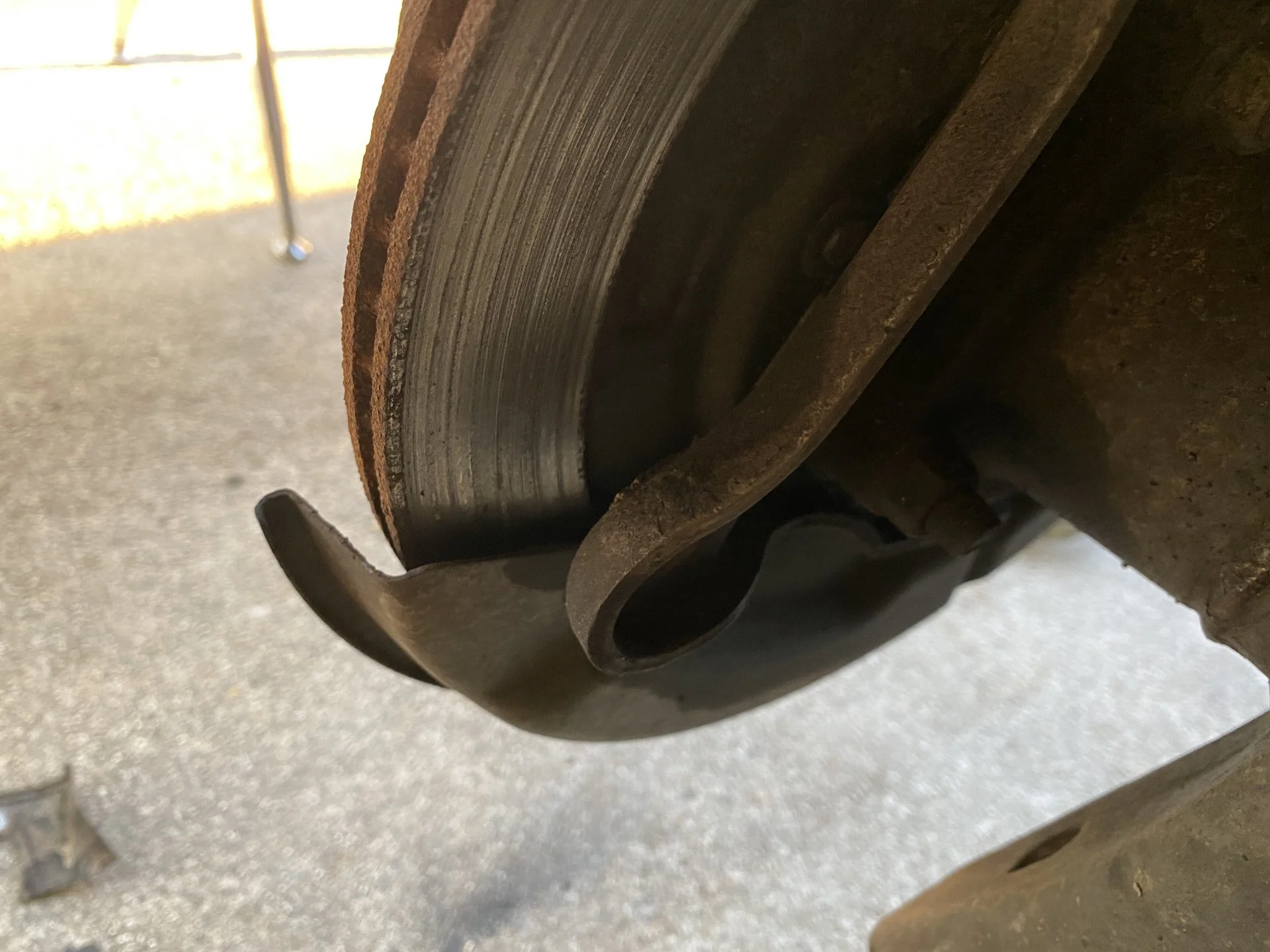

This is bittersweet because it serves as a battlescar. I finally worked up the courage to take my mallcrawler on an intermediate ohv trail, rather than the beginner trails ive run over and over again. I came across an early 2000s jeep and early 2000s 2wd ranger running the trail ahead of me, all new to offroading themselves. We helped spot eachother through some gnarly ruts and i towed the 2wd ranger twice out of said ruts.
All in all it was a great time, and I’m surprised with how well my truck did.

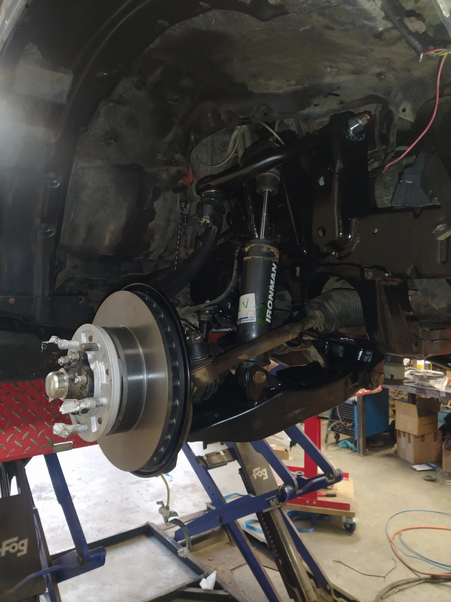

While installing everything this week I replaced Everything, front LCA & UCA, Seals, Wheel Bearings, Needle Bearings, all bushings in the front & rear suspension and I sandblasted and painted all reused parts.
When I had all the suspension off the car and had the rear axle hanging off a few straps it was time to tackle frame rust.
Knocked off all the loose stuff with a Needle scaler, then a wire wheel on a grinder, wire wheel on a drill, wire brush, degrease & paint. A lot of work but really worth it in the end. Lower control arm bushing (the one in the frame) was a bit of a pain. One pressed out easy, the other one I had to cut and chisel out. I replaced those with OEM.

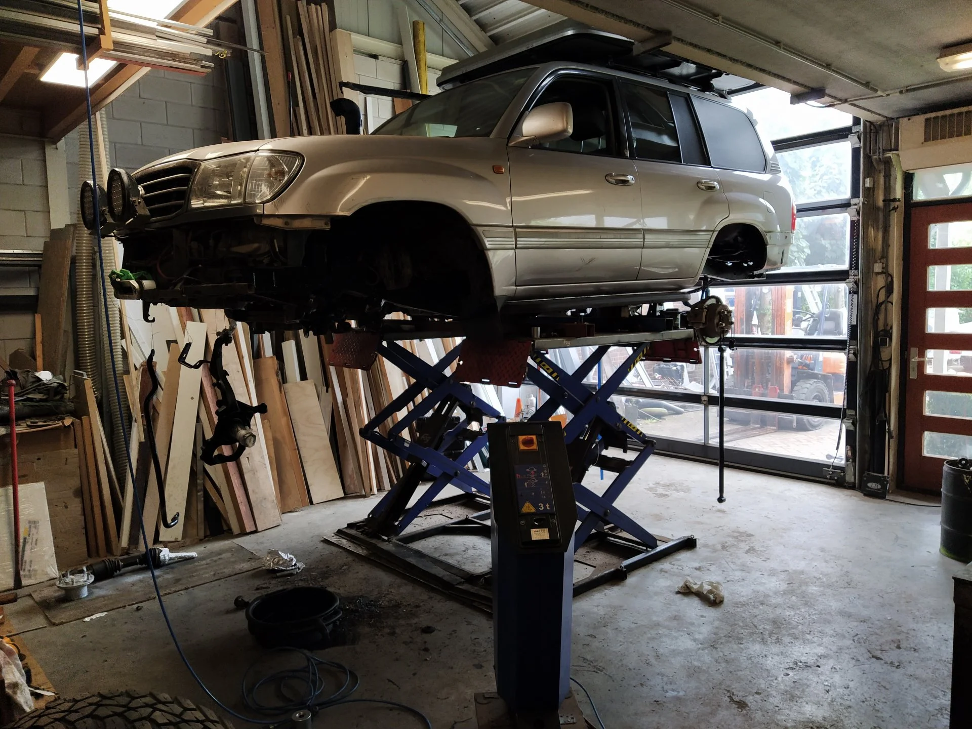

First step was removing the AHC, it was hard to reach and there was some rust on the bolts so we used a sawzall to cut off the shocks.
Here is the Cruiser up in the air, all parts taken off. You can see some parts hanging on steel wire being painted:

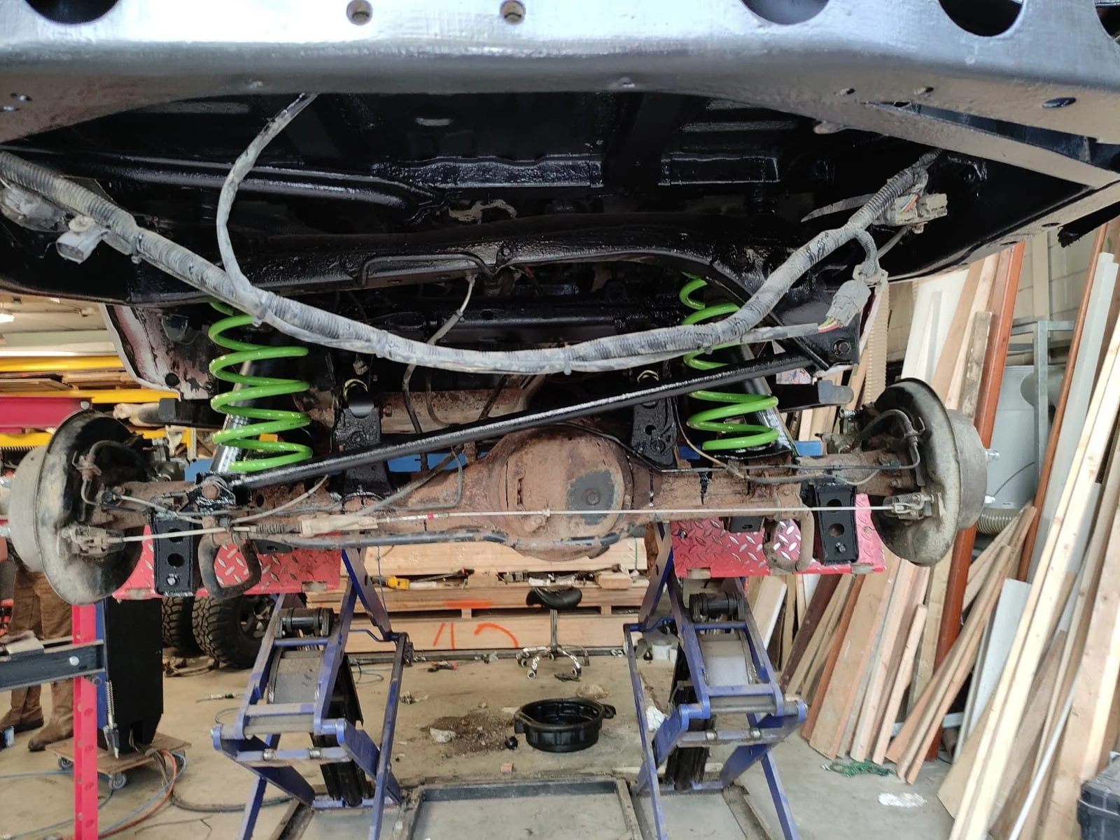

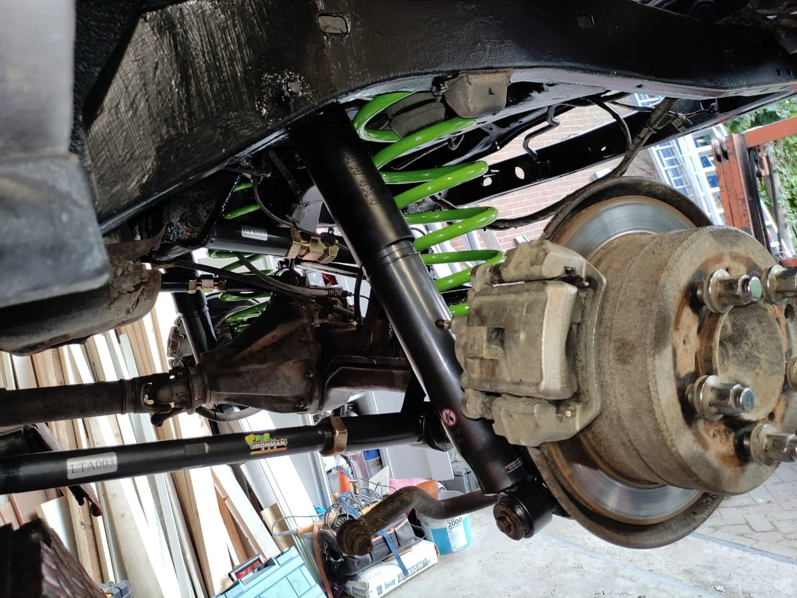

Rear suspension installed, as you can see I only painted the axle where the new suspension mounts. The rest I can reach later:

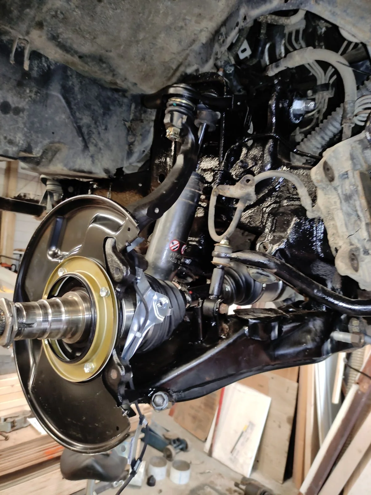

New Axles, Dust shields, Sway Bar Bushings, Seals, Wheel bearings, Needle bearings, UCA, LCA, ABS sensor, DIY extended sway bar links (Extended normal ones with a piece of thick wall pipe):
Sandblasted, painted and assembled the wheel hub with some new Brembo Brakes, OEM bearings and all new hardware:
The suspension has 50mm / 2 inches of lift. I adjusted the front torsion bars to 540mm, it gives me enough rake. I will see how that changes once I get the spare back under and load up the back. Installing the new suspension was easy and fast compared to cleaning the frame & body before painting.
It rides just a bit firmer that my (modified with king springs) AHC, bottoming out isn't really an issue anymore I can take every speedbump at speed, had the wheels of the ground a few times and Really, Really like the new suspension.
