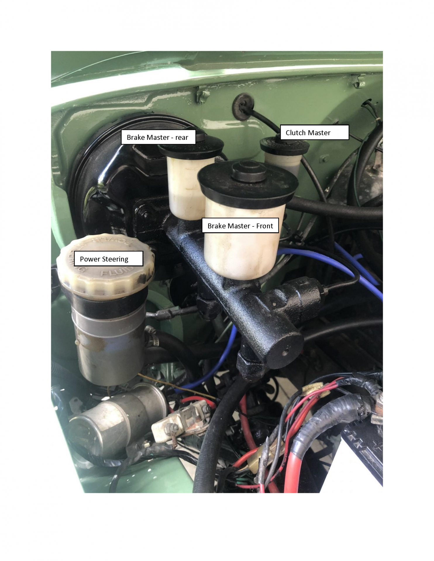

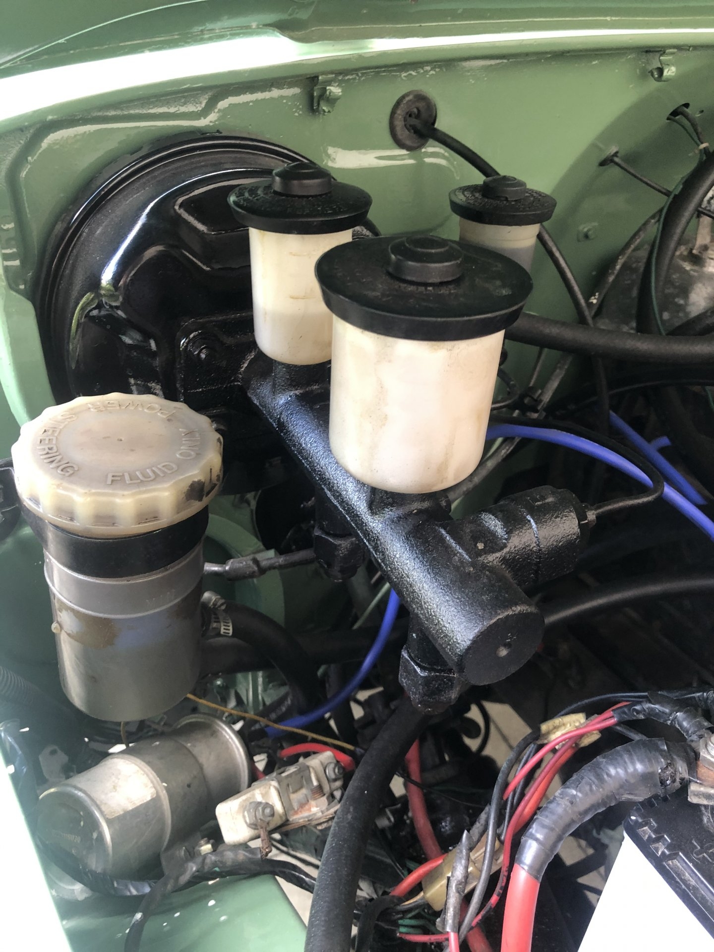

You have three reservoirs.. One is clearly marked "Power Steering Fluid".. Generally that requires AFT.. BUT always check YOUR vehicle's Owners Manual (OR the Factory Service Manual) for the correct type fluid!Sorry for the new year’s question. The small reservoir is a little below the minimum line. Thanks for the help.
looks like slave cylinder in case photo not come through.
The other two "containers" are: Double Reservoir: This is for the braking system, use the proper Brake Fluid for your vehicle. Small, single Reservoir is the Clutch Fluid Reservoir.. most likely uses brake fluid, as well BUT always check YOUR Vehicle's Owners Manual OR the proper Service Manual!
When in doubt... RTFM!!
Charles 1974 FJ40
I already gave you the answer. DOT 3 or DOT 4 Brake fluid.I am referring to the small one on the rail. The other 3 reservoirs seem full.
