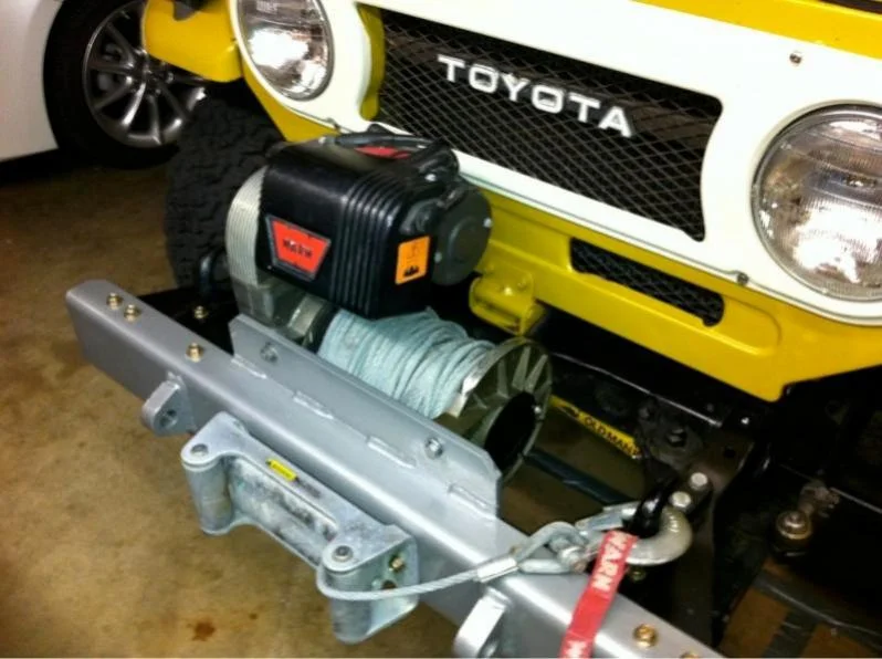

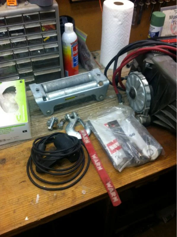

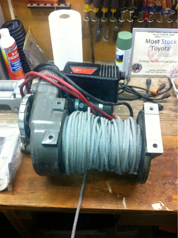

Here are pics of my $500 CL buy, guy was asking more but did not want to hassle with shipping so I think I got lucky. Otherwise I was going to look for an older one that needed TLC and try to get it real cheap.
3 fasteners (mine has hex head cap screws and square captive backing nuts) and the top assembly comes off, so if you're serious about buying it they should let you crack it open. You just need to reseal it.
