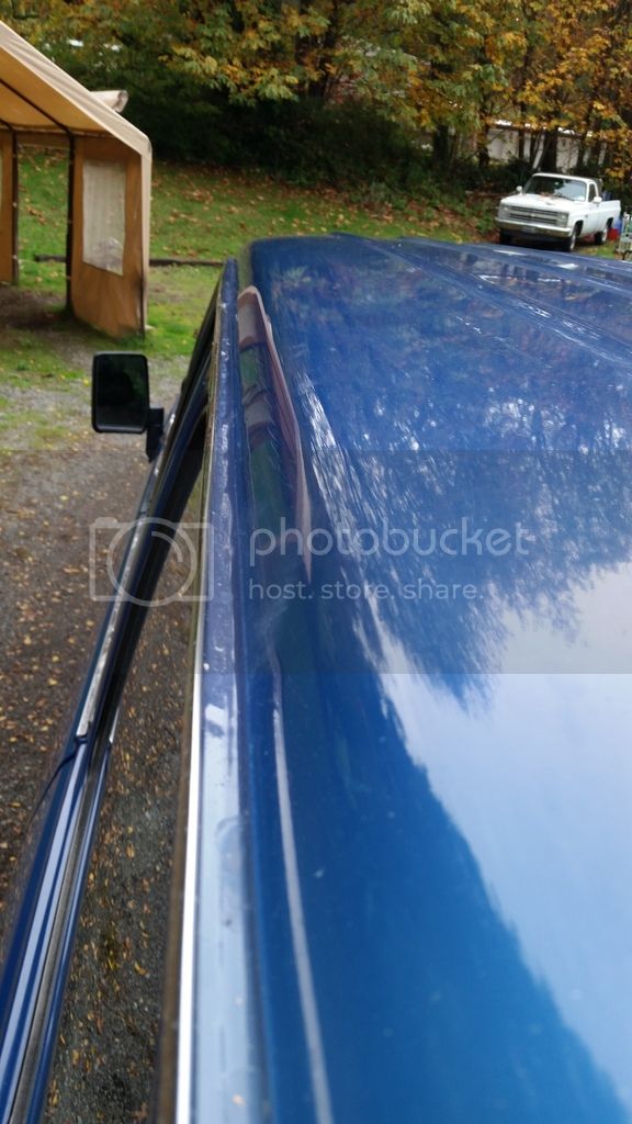

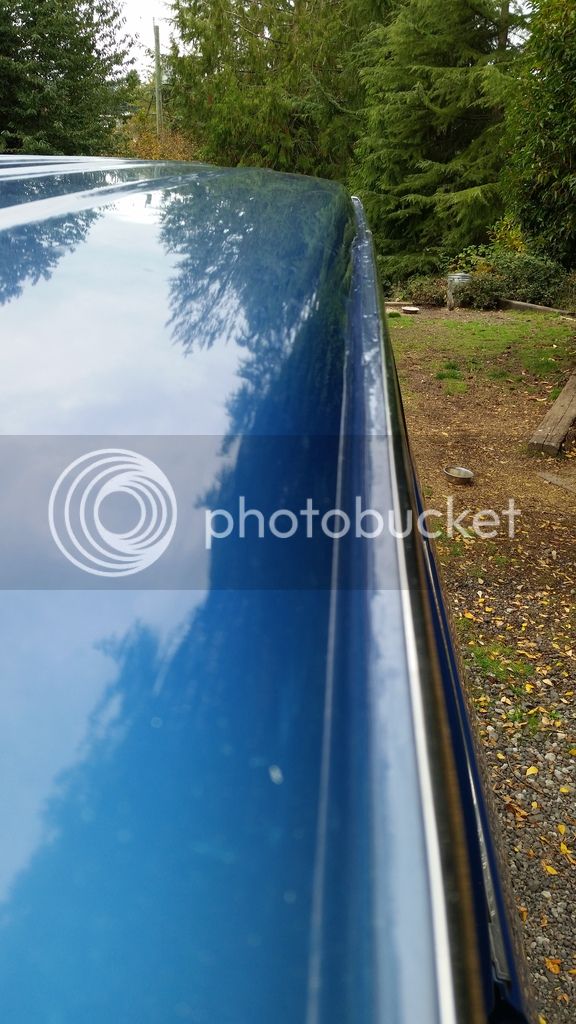

had the gutters re-sealed last weekend. had a friend do it, he is an auto adjuster and was a body guy......took some begging but he chipped all the old caulk out, no rot under but some surface rust, treated that, used a self leveling sealer, taped it off and repainted. Best $300 I have spend in along time.

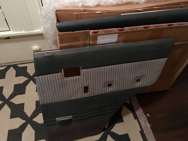

Received a nice set of door panels from @mel lowe . They will be getting stripped down, cleaned and glued onto new backing...

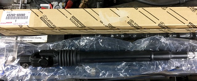

Also received a new portion of the steering linkage, I plan on replacing the upper U-joint as well. Goal is to totally refresh the steering system back to as new as possible.

I just dropped mine off this morning at a local shop for the same treatment in preparation for new roof rack.
