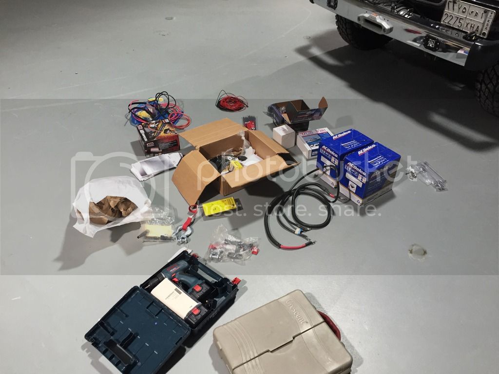

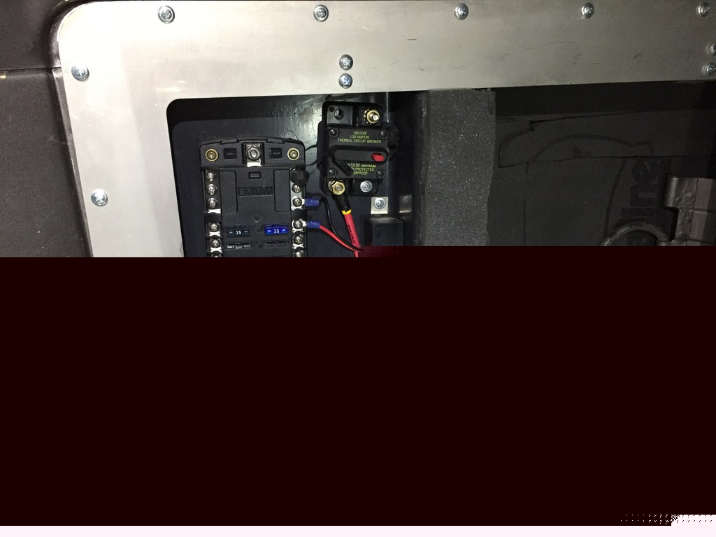

Dived into some wiring. Dual battery set up, intelligent solenoid, front and rear flood lights, and the winch.

Look at that for you dual battery setup. How you have your setup now is how I setup all of mine, but I add this into it.
I have run this in anything from a LR3 to a FJ60 (putting one in mine this winter)
The Battery terminal, and solenoid are garbage, But the controller is a less expensive version of the National Luna kit and works great.
Nice thing with this is you can see your voltage, keeps both battery's happy and isolated and you can jump start your main battery if needed.
