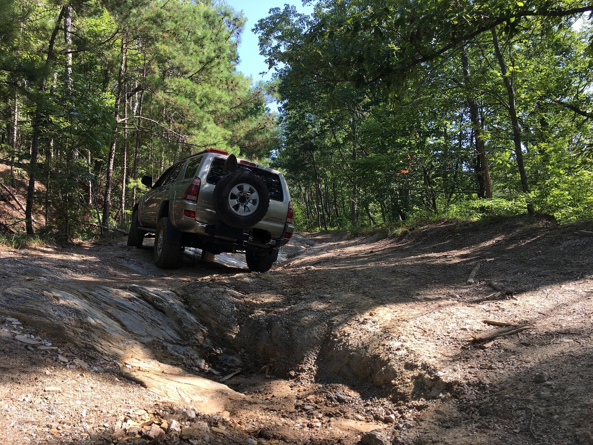

...And spent the morning playing around in the Taladega National Forest on forest road 600/Skyline Drive. It's about 14 miles long, and not very difficult--but fun for a Floridian who doesn't have a rock to drive over if he wanted one. Lots of deep washes, and loose rock. A few of the side trails I found were pretty legit, but I suspect you could do the main trail in any 4WD with decent tires.
The pictures never do it justice, but it is steep as hell in the pic.
