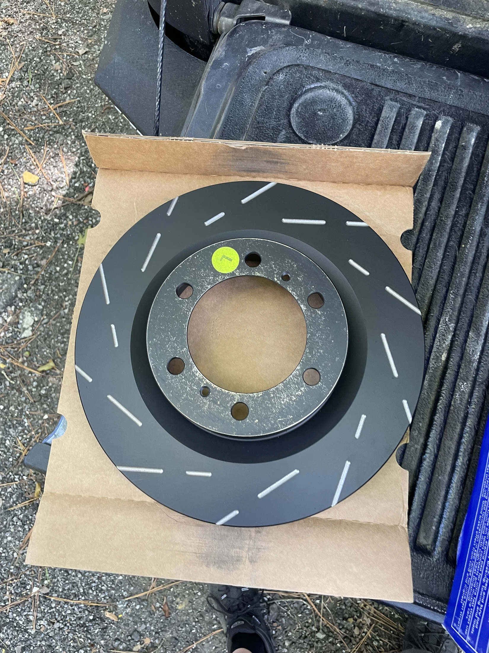

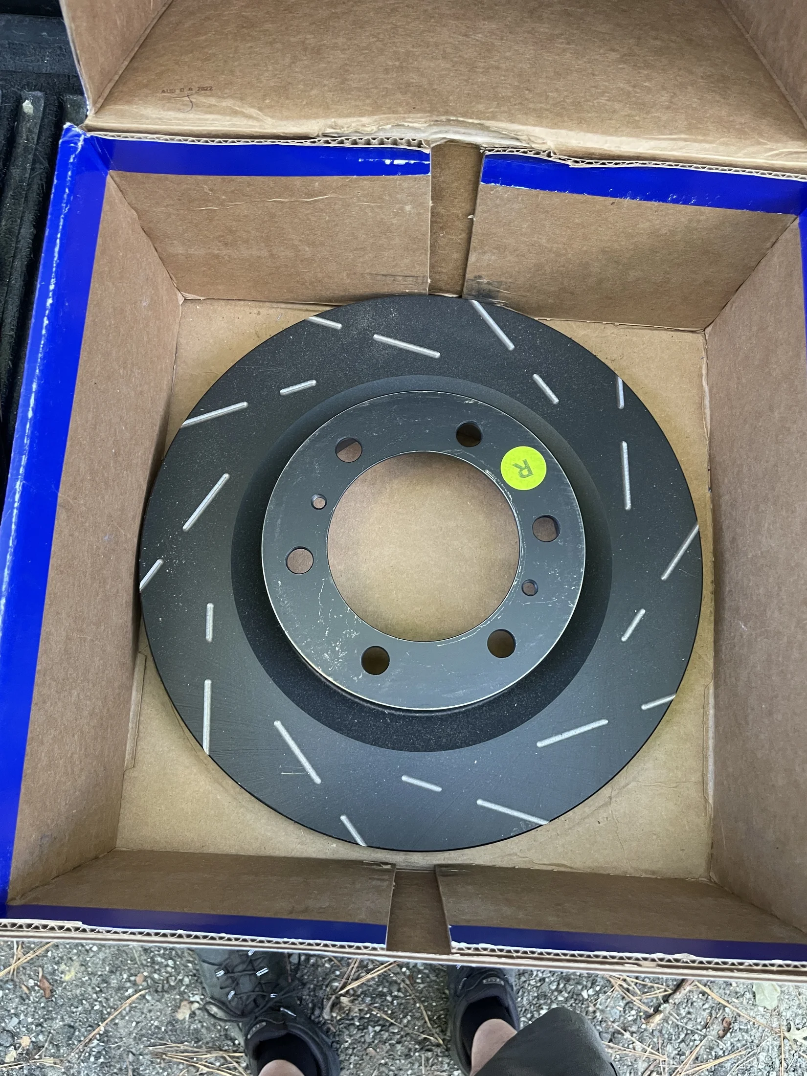

Saw an ad on FB Marketplace for EBC 5th gen 4Runner rotors and scored them for $50. Couldn’t pass that up.

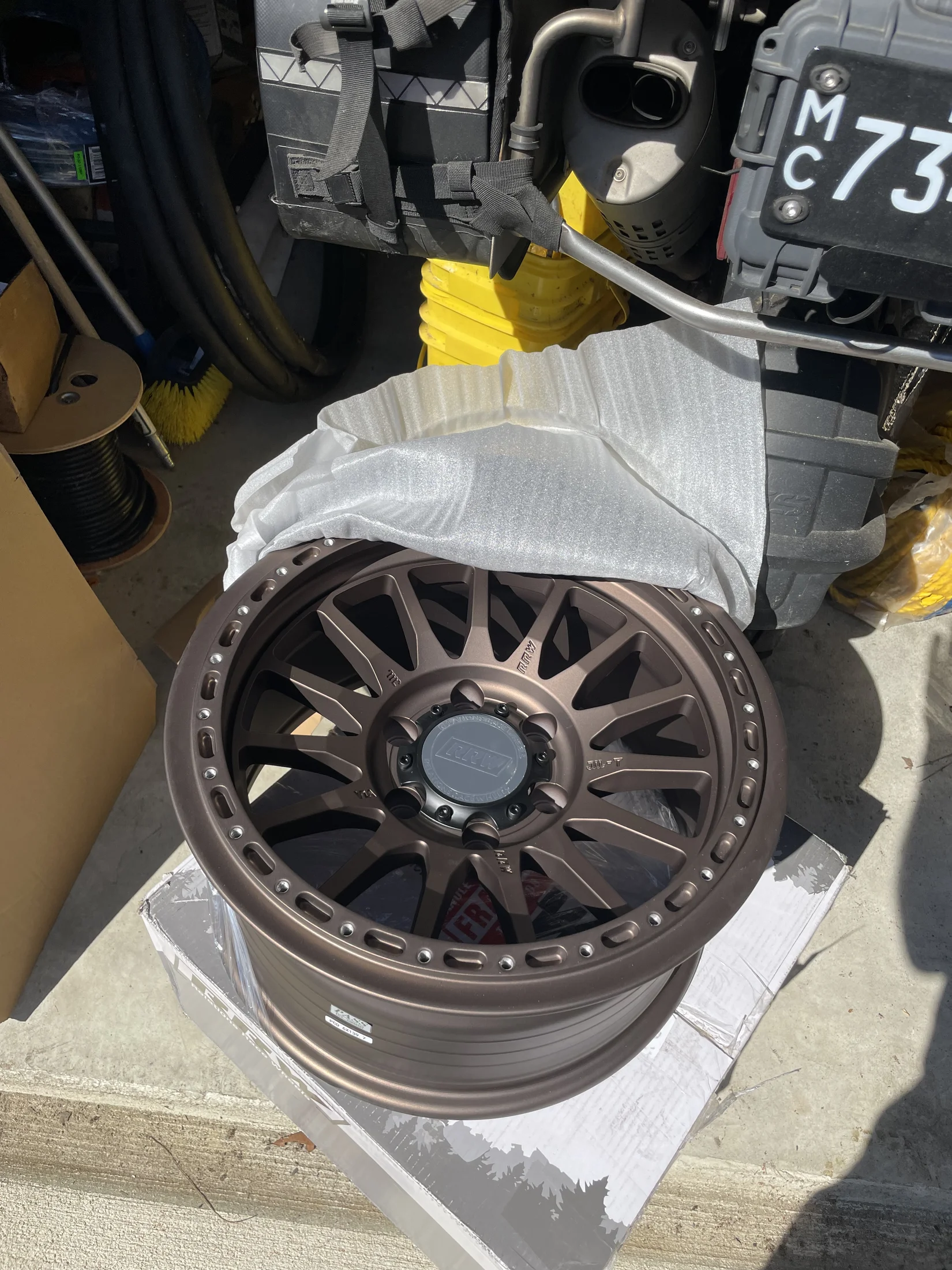

My wheels are arriving over 4-5 day spread(thanks UPS) but one is here so far

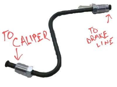

Front driver side brake caliper hardline was also weeping ever so slightly from the caliper so I replaced it as well. Tried installing it upside down for a frustrating 45 minutes, got completely soaked in brake fluid and worried I had stripped it since it wouldn't seat in the caliper. Hit it with a die (M10 1.0) which went on so smooth i realized i didnt actually strip it and it was just upside down. The side that goes to the brake line has about 3mm at the base where there is no threading. Installed it the right way and no more leak!.

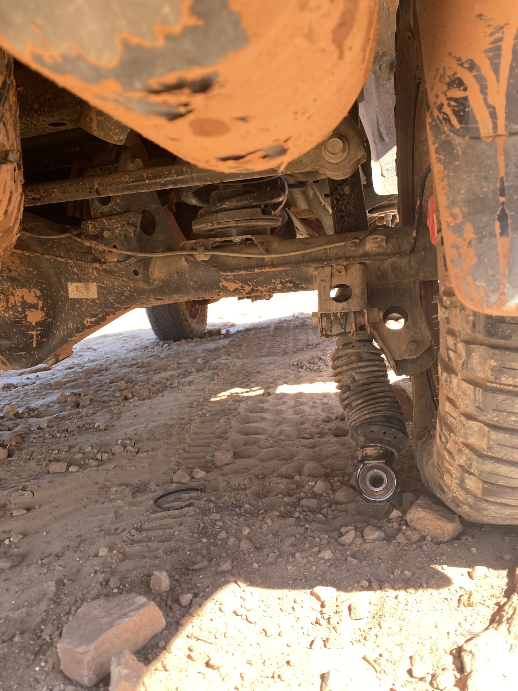

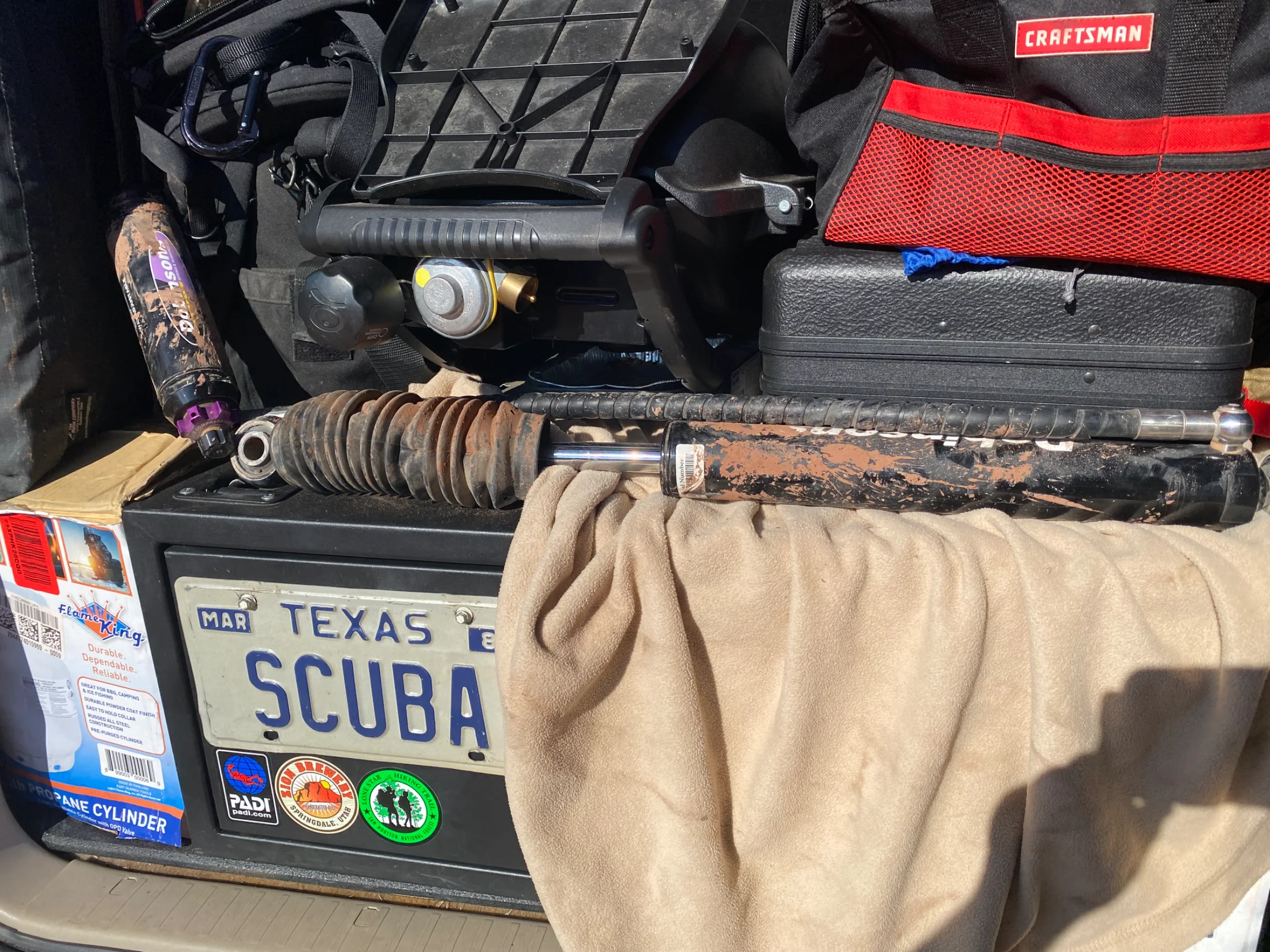

Lost a bolt and a shock on the Rimrocker trail on the Utah/ Colorado border. Just installed, torqued to specification and lost after 2,000 miles. Took it off and drove back to Texas on three shocks to see about fix or replace.
I've lost a panhard bolt before, like you not sure HTF that happened but it did. Did you zip tie and fly or "cringe" let it drag as punishment?
I had windows down , not on anything difficult, and heard something dragging for a second. Got out to inspect and couldn’t believe it. Luckily I had just installed a few months ago so I just finagled it off and threw it in the back
Bolts and nuts seem like good spare parts to carry for trail fixes. I lost the top nut of my rear icon shock and now I carry a spare nut and bushings.
Also, I carry large bolts and nuts that hopefully fit the lower shocks and/or lower rear arms and/or the panhard
It might also be a good idea to put some loctite on the bolt. I've never had one pop out. I use loctite on the LCA , UCA, and panhard bar bolts, but have not used it previously on a shock bolt. I might next time.
