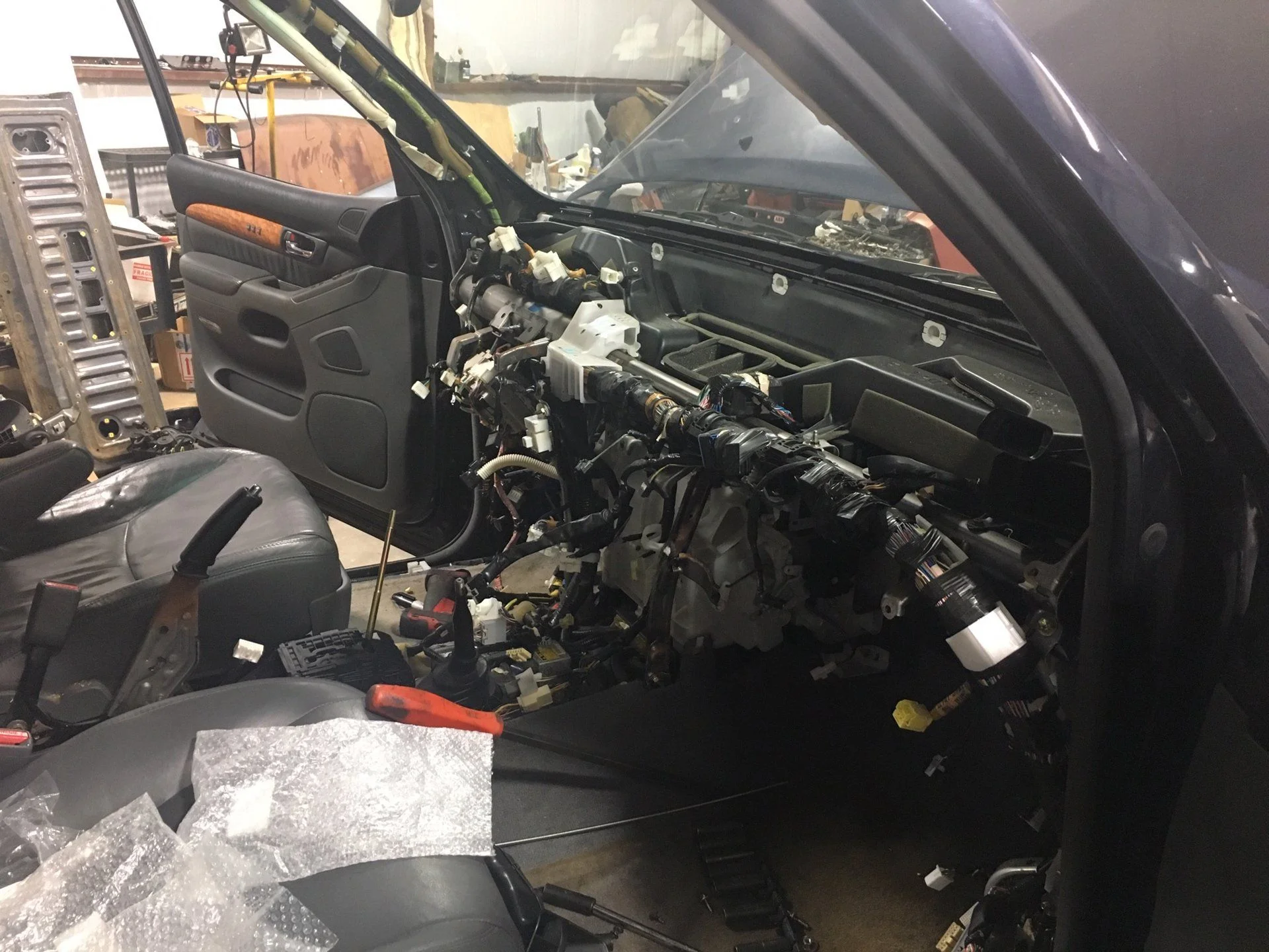

Finally got tired of not driving the truck in the summer, so I decided to follow my local Lexus guru's advice from the beginning and just replace all four servos. Like I said in earlier posts, I've resisted that suggestion, because it just seemed to me to be unlikely that all 4 servos would go bad at EXACTLY the same time! I have been convinced it was an issue on the controller side of things and not the items being controlled. Again, it just didn't seem like four separate mechanisms would go bad at the same time.
I was wrong. Dug into it this far this past week (photo below). Replaced all four servos. Quiet as a mouse. In fact, no amount of input will cause ANY sound behind the dash.......there's been a LOT of down time because of my resisting the correct suggestion!

Wow dnp! You’re brave.
