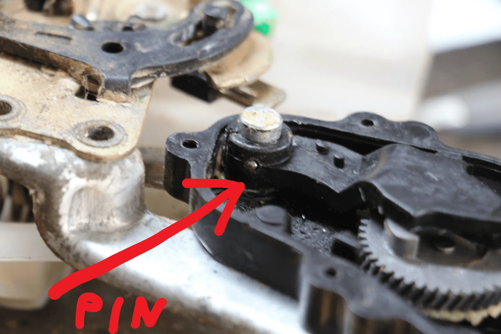

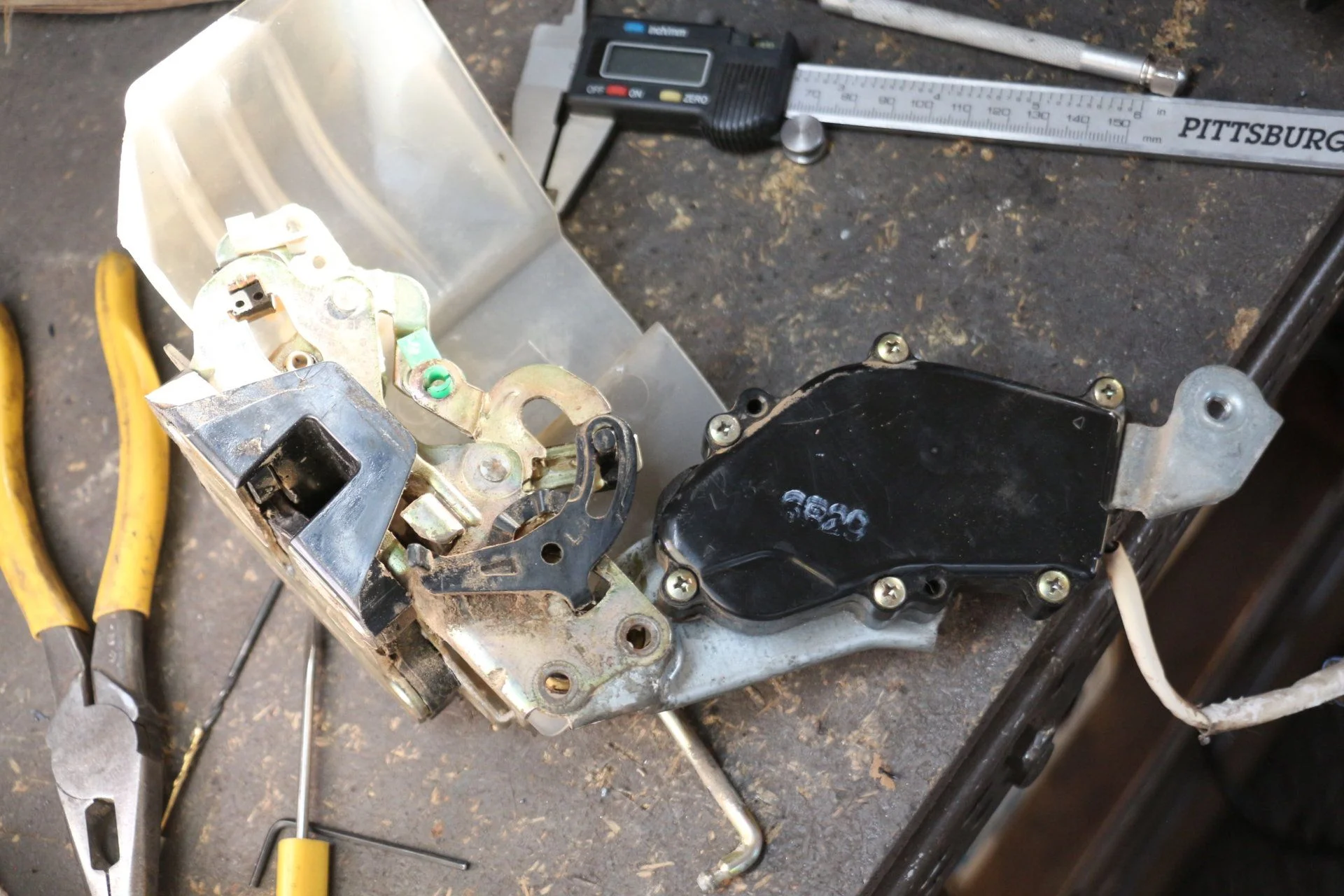

Drivers side rear door lock failed. Once removed it was not simple fix like the motor.:( Turned out to be the arm cracked where it fitted on the knurled shaft. Having been there before I drilled and pinned the arm to the shaft and reassemble it for the fix;)

I had the same problem on the same door, fixed by the same nice guy too. Thanks Phil!

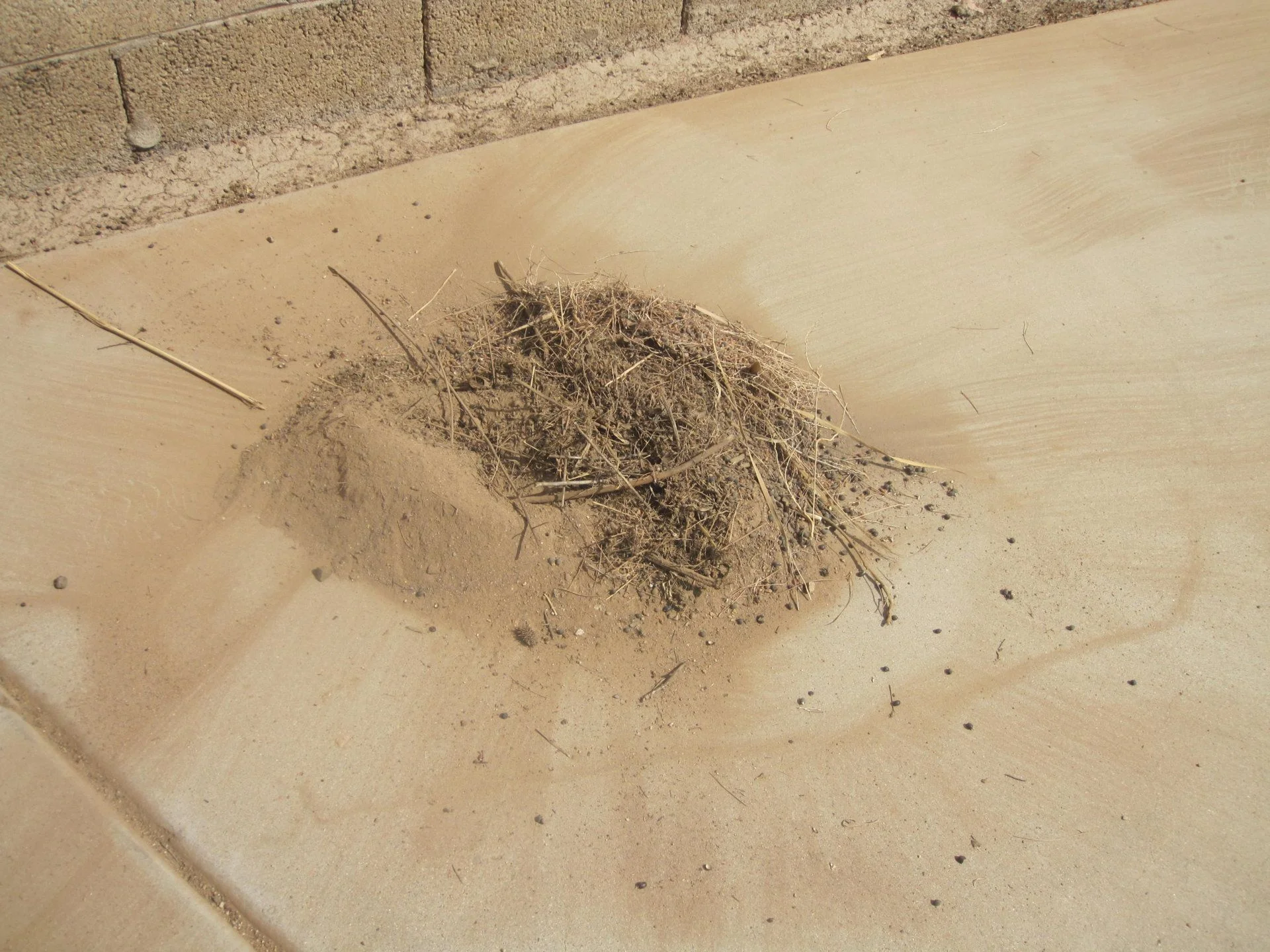

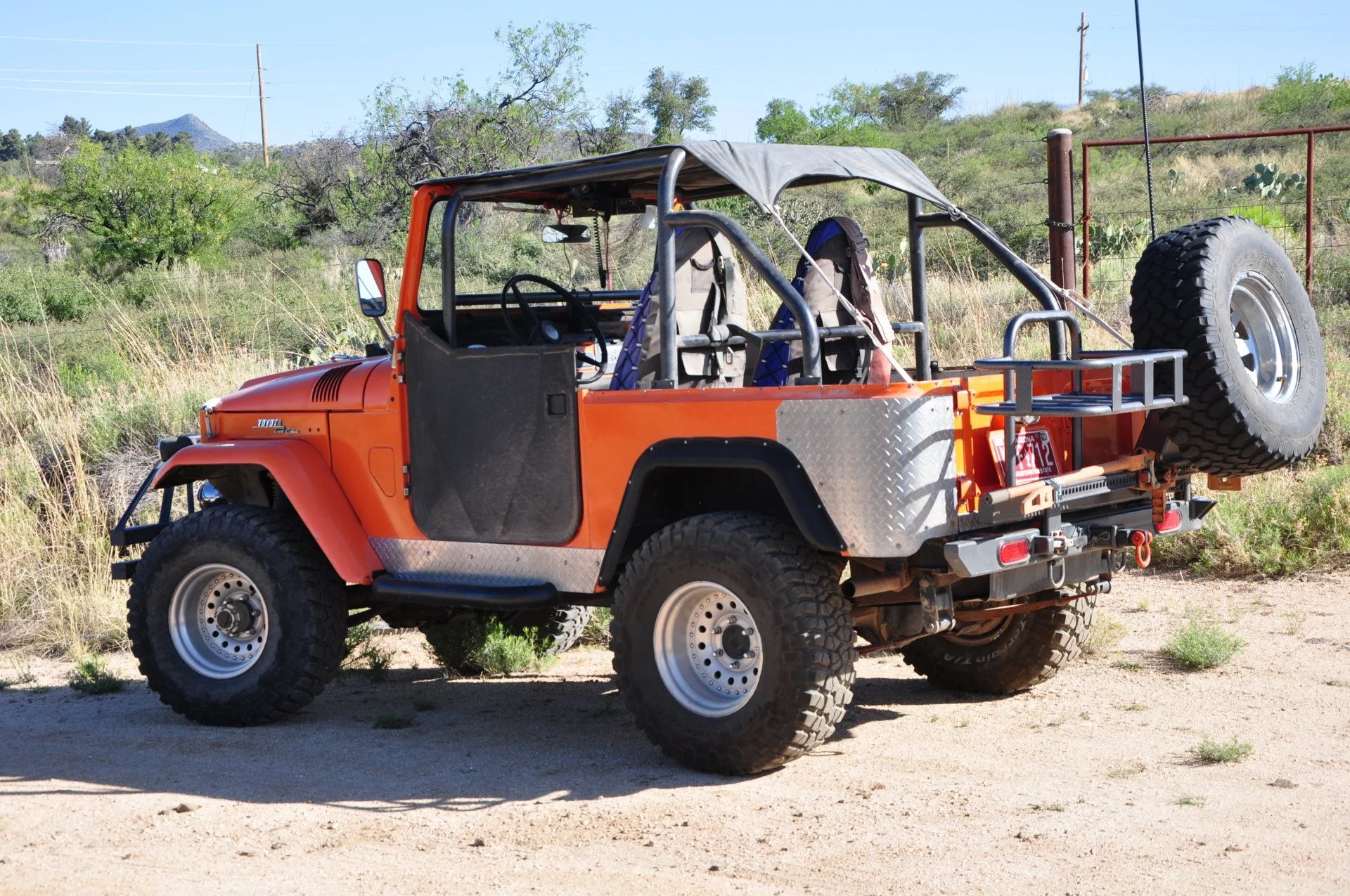

Since my 70 FJ40 was in the valley for a days used it as a opportunity cleaned the inside of the frame. As clean as this 40 looked it still suffered from the lack of clean frame. Besides the dirt and rocks it must have been parked for a long time next to some kind of hedge. All the branches came from inside the side frame rails. With the current heat the frame will dry out before moving back into cool storage. On the positive side it has always been parked and concrete surface and kept dry so no sign of any rust in the frame.

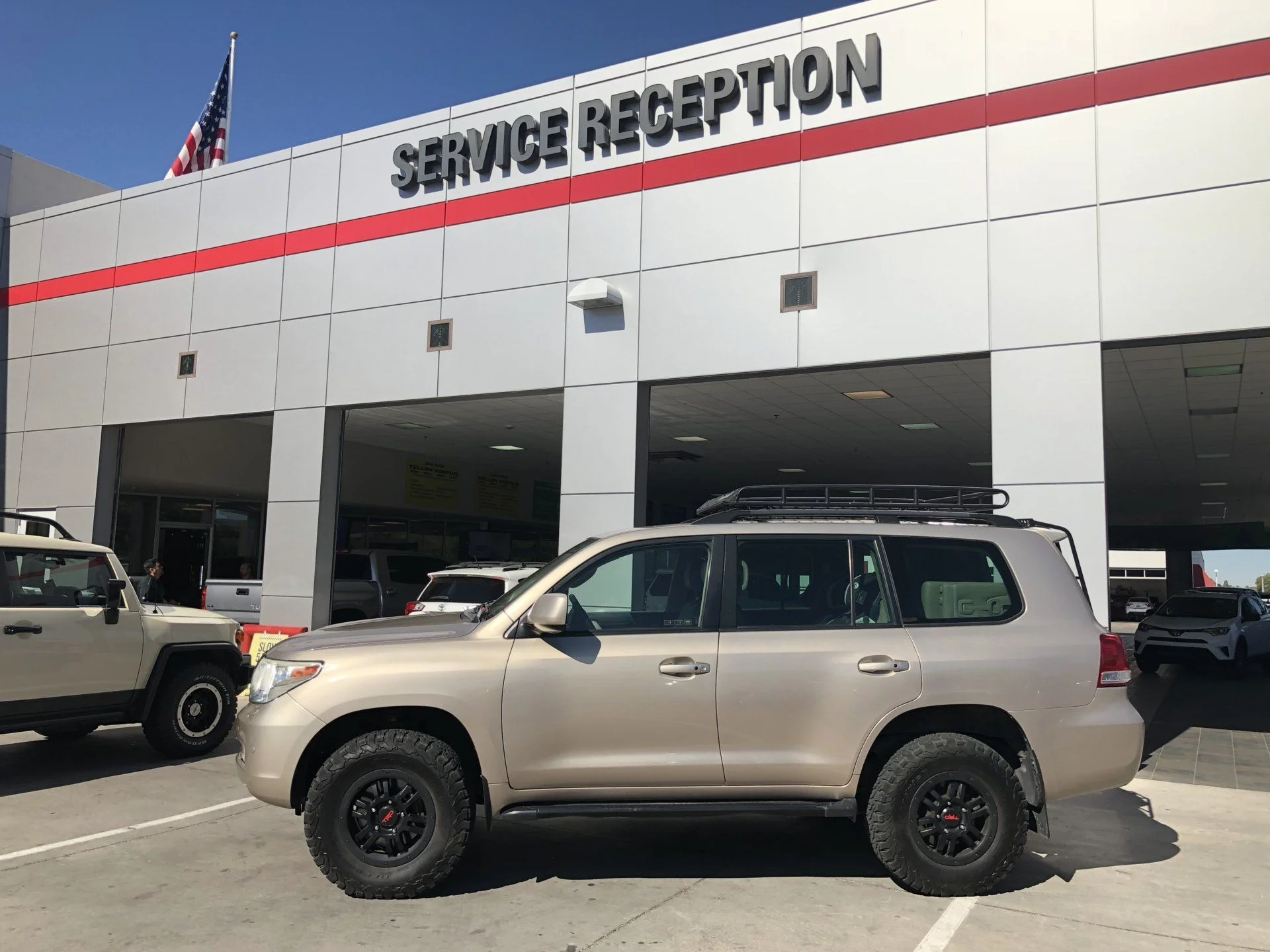

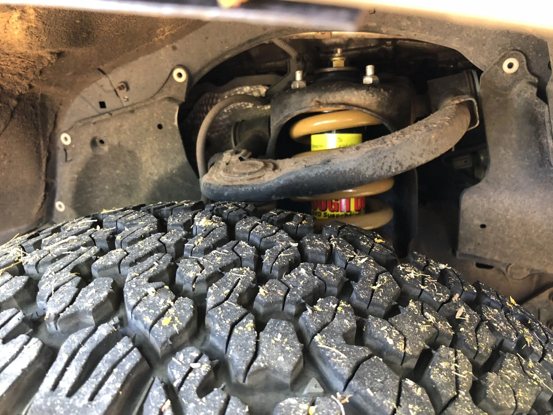

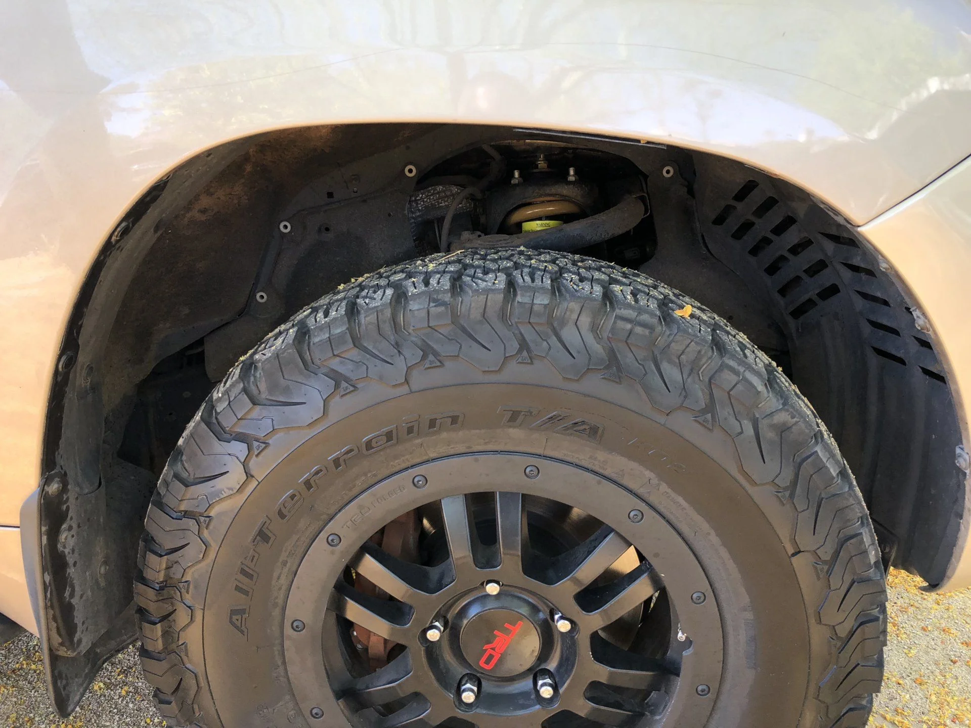

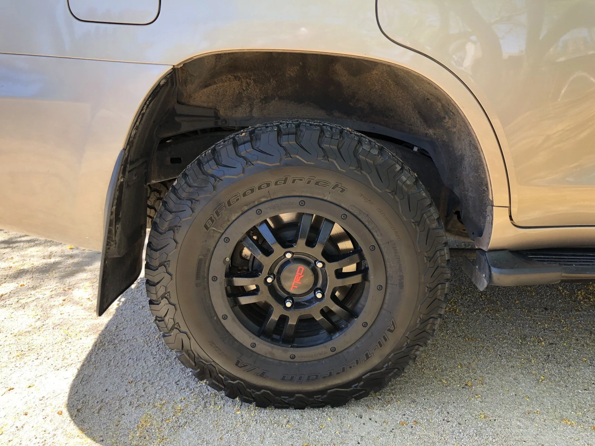

Got lifted! BIG thanks to @murf and the Land Cruiser expert crew at Camelback Toyota for getting my new suspension installed. Rides great and looks great! I went with Tough Dog 41 foam cell front, 45 adjustable rear with 0-660 springs. Thanks @reevesci at Trail tailor for all the guidance on the best configuration as well.
Did Murf get it aligned? I don't see any aftermarket UCAs so I assume all went well without them. Please advise on the UCAs.
J
Yes and No on the alignment. This was the only issue with the install. My truck spent the 1st 6-7 years of its life in NYC. I moved to sunny AZ after that. No rust issues, I've had it looked over, but it seems to be whenever i go to upgrade or replace something the hidden rust shows itself. This time it was actually the lower control arms adjustment bolts and sleeve were completely seized and they couldn't adjust the lowers due to this. So they did a great job and gave it they're all on getting the alignment and got very close, but not perfect. Toe is fine, camber is right at the limit, 1 side slightly over but barely. Caster though misses by about 1 degree. So not a big deal, but not perfect. I don't notice any issues driving it the steering feels totally fine so I'm going to just go with it. Murph drove it too and he said it felt fine also. Basically where the problem was with fixing it is if they cut the lower bolts off with a sawzal they might still not be able to get the sleeve out then and damage the arms. the lower arms cost quite a bit even the stock ones so i really didnt want to risk that. The easier option would be replacing the Upper Control Arms as this would provide more than enough adjustment range to get in line and cost less. Like i said though, It drives great as-is so I'm just going to leave it and see if it becomes an issue down the line. the shocks feel great, the extra height feels great and other than the rust issue they install went great.
Sounds good. Keep me posted on the alignment. I keep track, as you know, of how many need UCAs or not to align. I'm still at about 50/50% on the UCAs.

@DPA200 frozen lower control arm bolts are a known issue. SPC makes a replacement with a plastic sleeve.
Keep an eye on the forum for members that do the tundra swap. You can probably pick up a set of arms pretty cheap. Also check eBay.
General consensus is 2.5" of lift or more and you will need aftermarket upper arms. Some have had trouble at 2". Odd variances in geometry.
Truck looks good.
Truck looks good.
Thanks @TexAZ. Before I picked up my truck today I did find those SPC replacement online and actually brought a printout of them into the shop thinking that’d be an easy fix. We talked to the mechanic and what he said was if he cut the bolts off he didn’t think he’d be able to get the sleeves out without damaging the arms. He also said the bushings were in fine shape so safest just to leave it. He said it’s such a small amount of adjustment anyways on lower’s that he’d have much more adjustability with new UCA’s. I measured before/after and it was a bit higher than expected 2.25” front and 2” rear. You think my plan to just Rock with it slightly off is ok? It’s not way out just a little out on caster. I am curious about the tundra swap I’ll search for that. The stock LC lowers were somewhere around $700, plus labor plus allignement pretty pricey for a part I really didn’t want to change. I dunno maybe I shoulda just done UCA’s at the same time but I spent that $ on my new bud built sliders as I wanted those much more
