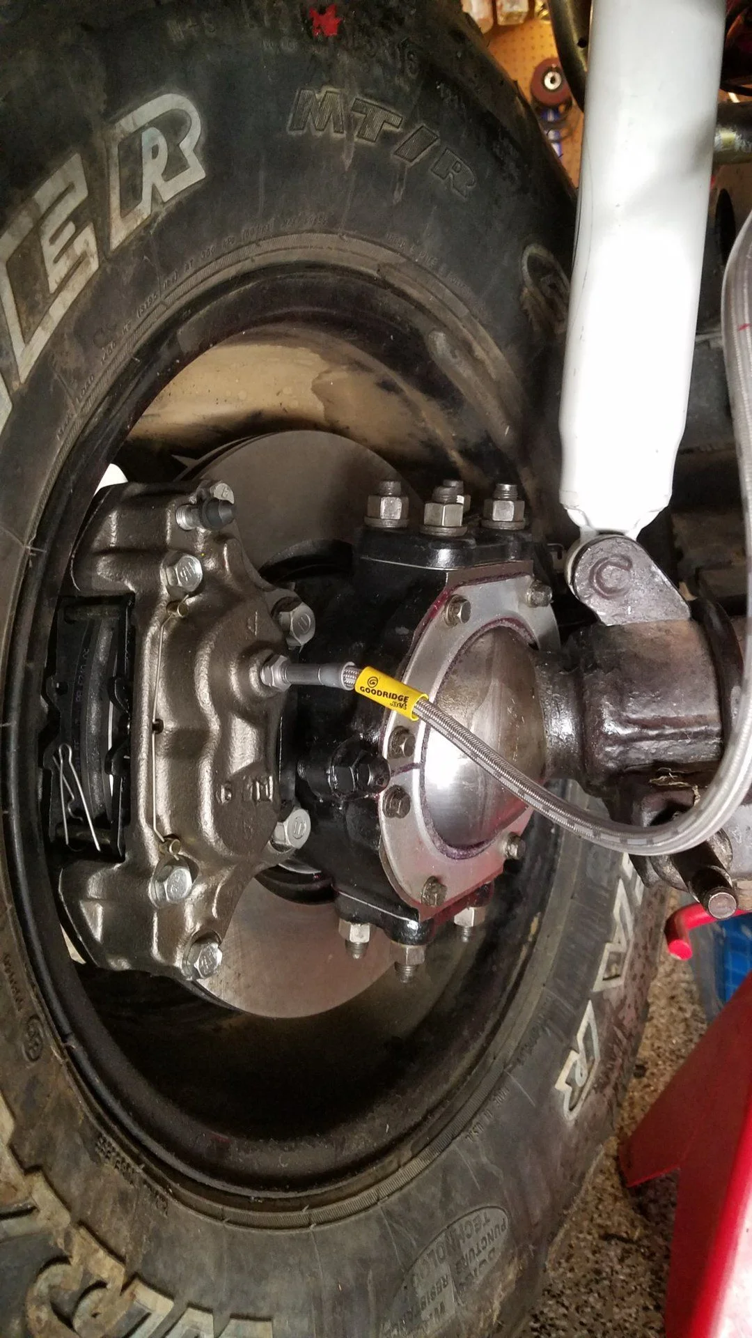

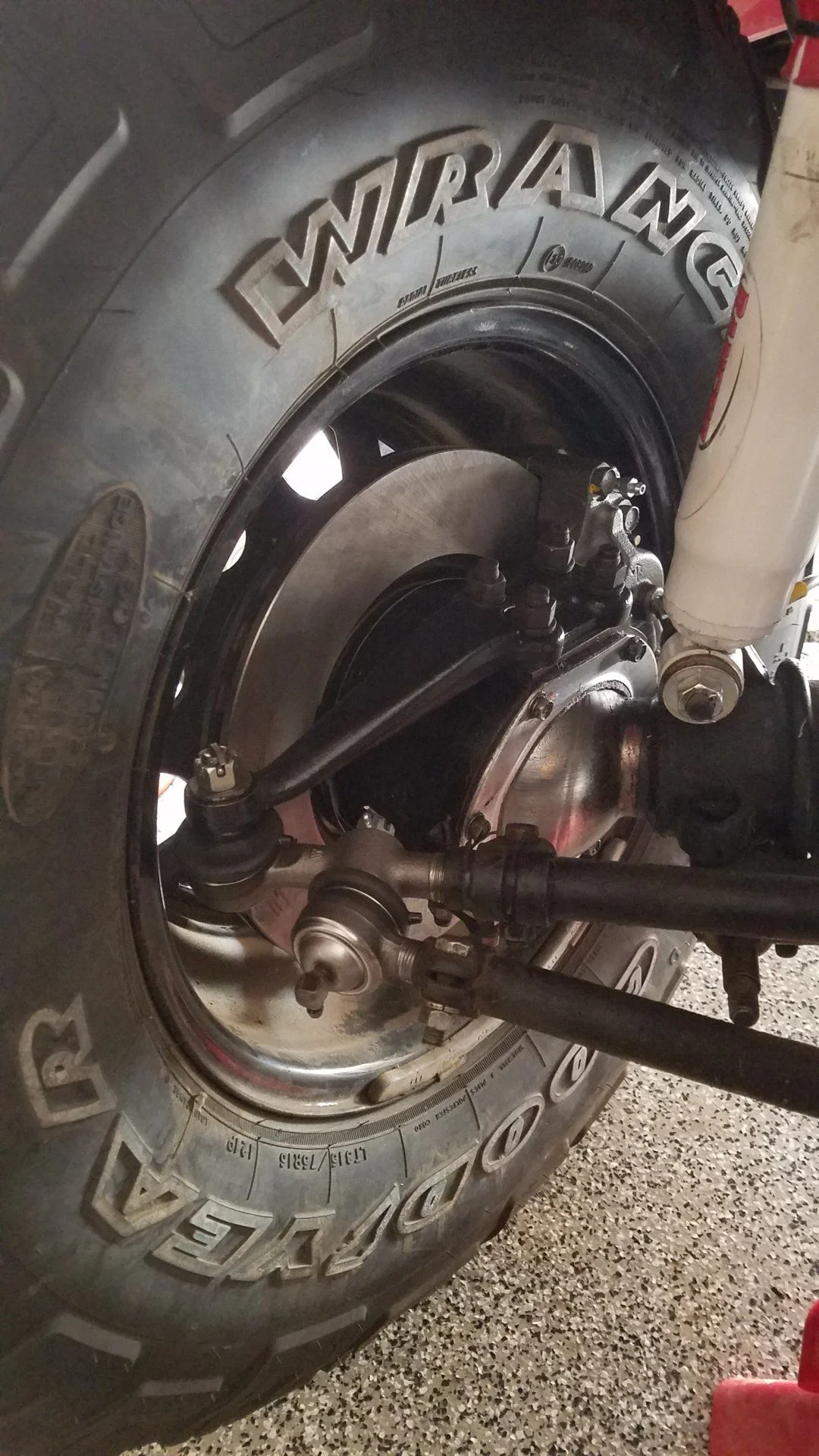

Ok, so I finally got to a really good place with my front disc brake rebuild. Got everything put. Ack together and got the front tires on!!!
Last week I tried to put the tires on but found out that the used wheel studs that I got ahold of were mushroomed and the lugnuts would not go on, that was a fun day.
New almost everything... and it is all put back together.

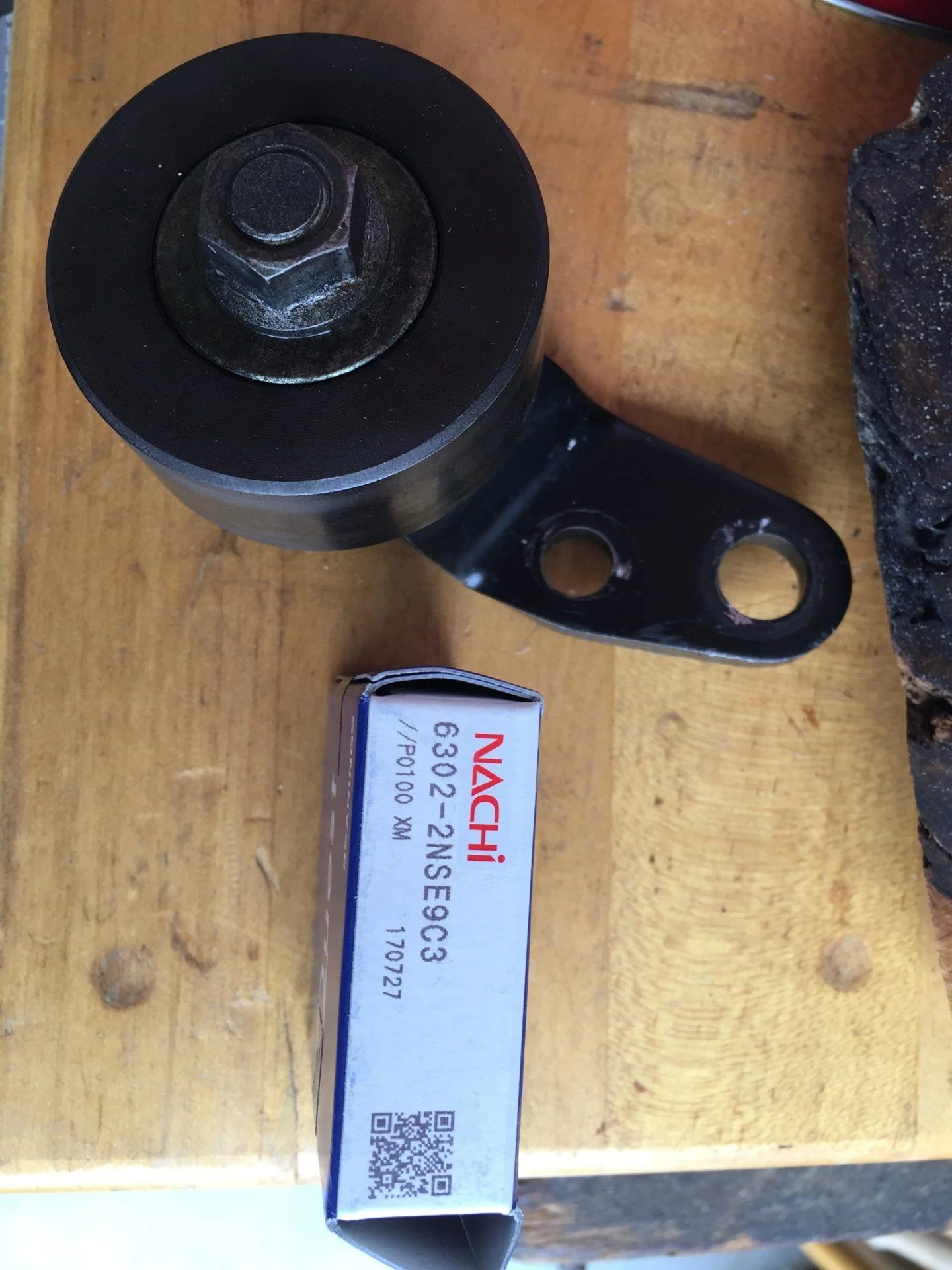

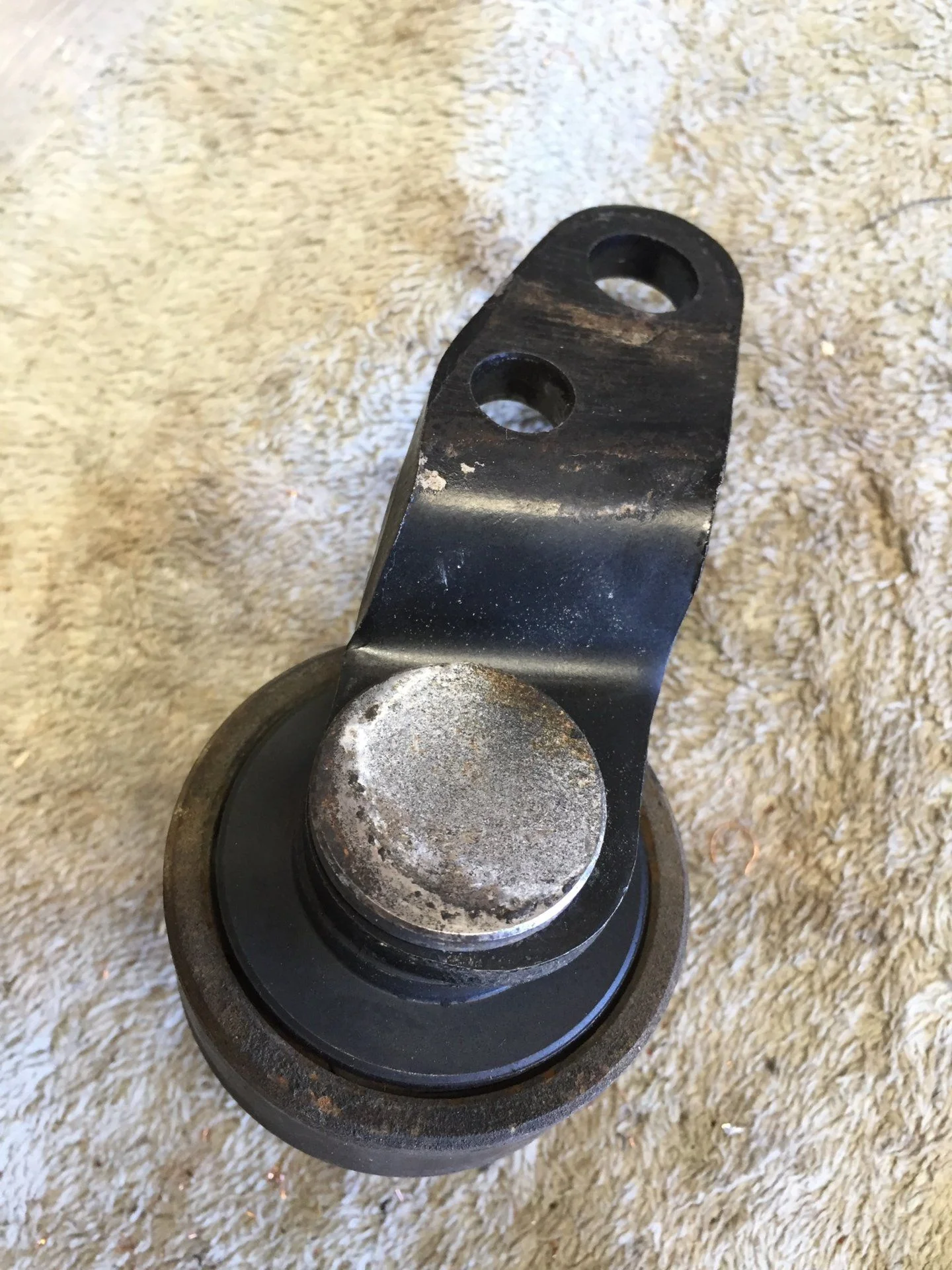

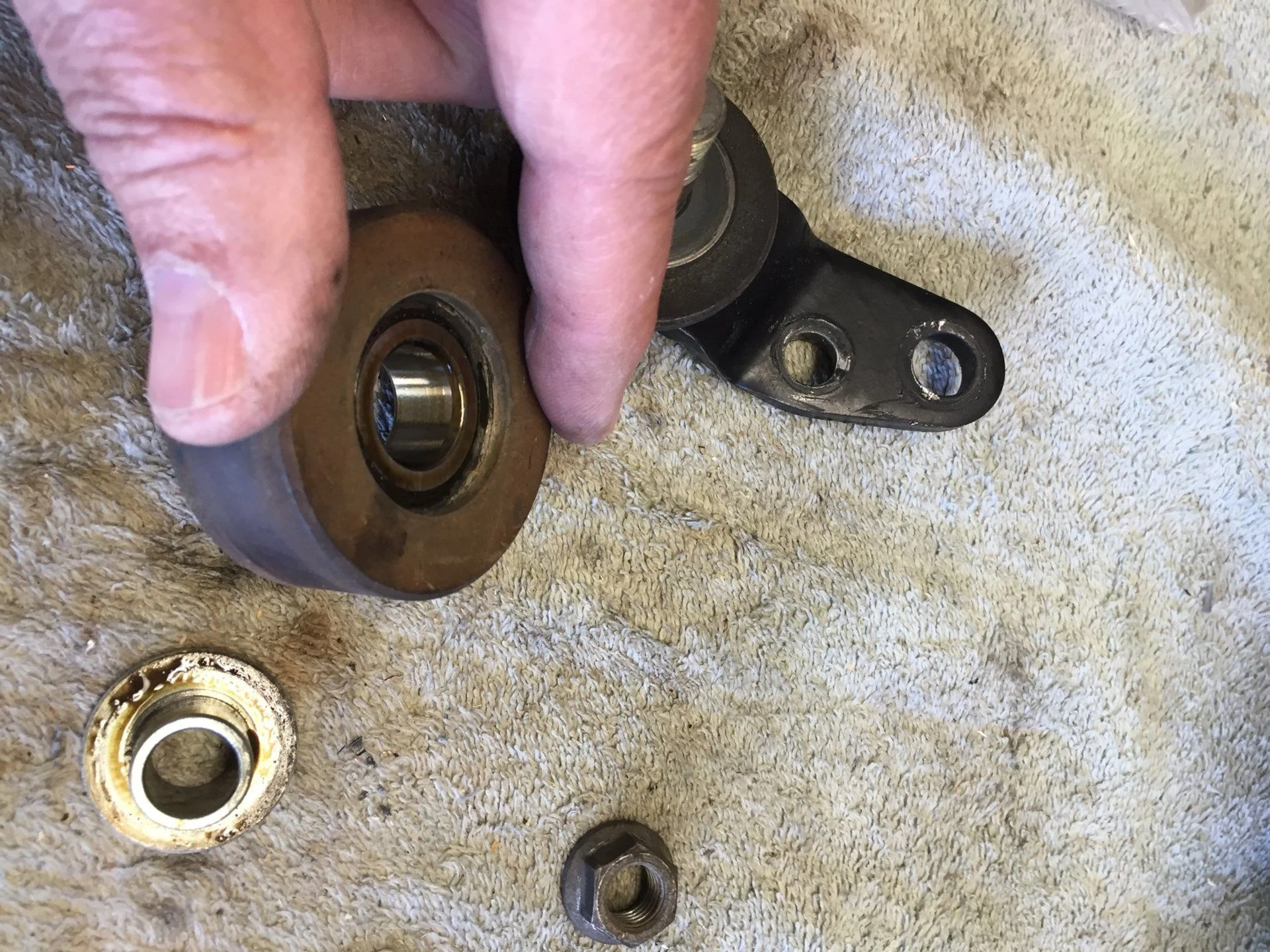

Working on a few parts for @brices123 1986 FJ 60. The AC idler bearing was seized and the part is no longer available as a whole assembly.
Ordered a Nachi bearing, swapped it out with the NSK, both are Japan made so it should last a long while.
A few shots of clean up and parts:
Before I pulled it apart
Bearing part number, only $9.00
Back together and spins freely. Goes back to Tom this week.
Ordered a Nachi bearing, swapped it out with the NSK, both are Japan made so it should last a long while. Bearing part number, only $9.00. Back together and spins freely. Goes back to Tom this week.
I have found this as well, replacing with a high quality bearing is better than a cheap aftermarket assy (if available).

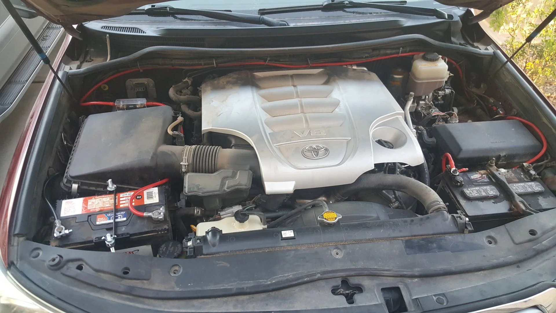

Wrapped up 2nd battery install. Then found out that my old battery was dead....:bang:
Debating on battery size and type now. Did a lot of "customizing" to get a group 27 in there.
Another 200 owner put a group 31 on the drivers side, and moved the 27 to the passenger. May go that route.

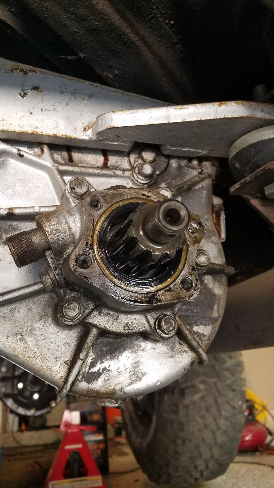

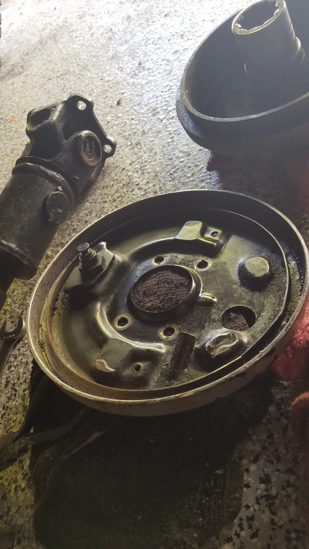

Starting to rebuild the e-brake, realized that the PO removed the guts completely. Anyone have a feeling for why an automatic transmission setup would not need an ebrake...?

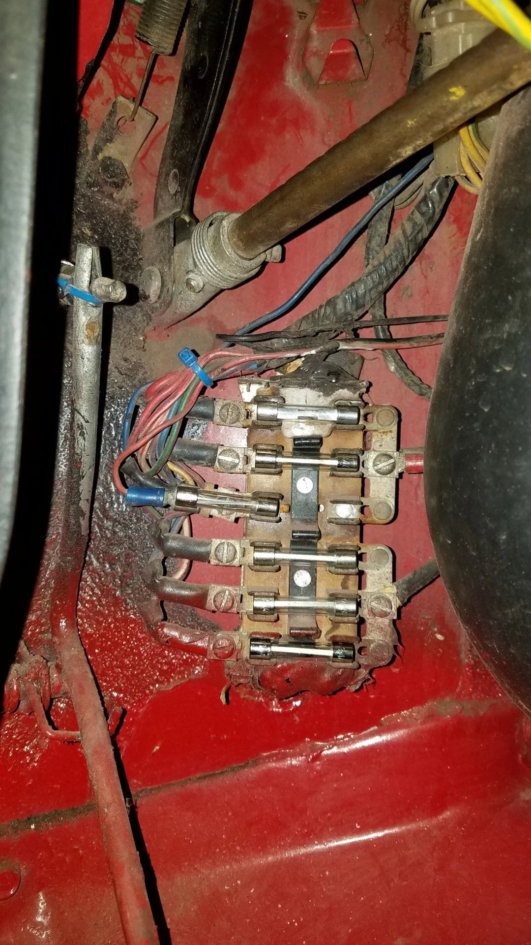

So along with all of the other fun things that I am doing to Rusty recently..., I am trying my best at finding out how best to find a shorting wire which is slowly draining the battery.
I have setup a voltmeter on the negative side of the battery in series to identify which of the circuits / fuses is the culprit. Finally pulled open the 4th fuse from the bottom (as pictured) and the voltmeter goes to zero..., voila.
But now i am stuck. How the heck should I go about tracing out where it goes and how many things it might be connected with...
Thoughts?

Start here:
Fj40 Wiring Codes
and here:
Schematics
Coolerman used to be able to supply you with a new wiring harness.
I ditched my PITA fuse block a long time ago and 80% of my electrical problems went away with it.

Stepmurr,
Thanks for the info and links. That wire color coding bit should get me going down the right road.
Your plug type fuse blocks look much better than what I am looking at...
