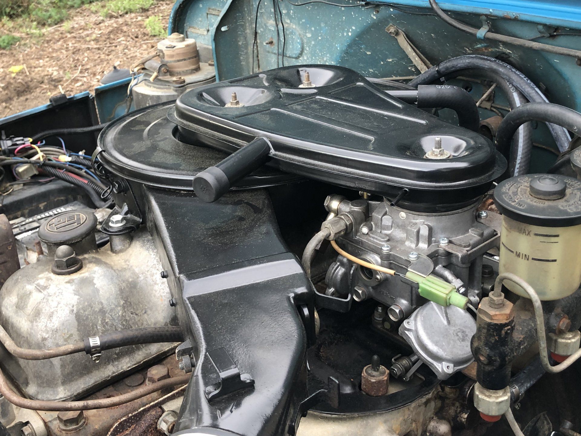

I have been collecting parts for about a year to take my fj40 Weber carb back to OEM. Gary @shmukster offered to help and I finally got around to taking him up on his offer last week. He was instrumental in helping get things done smoothly and having all of the little parts, pieces, knowledge and tricks to make quick work of the conversion! And for anyone looking for a carb rebuild, @FJ40Jim is the guru! We installed everything and my 40 fired up with the quick flick of the key like never before! It really honestly idles like a sewing machine! Anyways, just a public thank you to Gary, as he is a true asset to our club!!!

Rob, you and Gary do good work, looks nice. :beer:

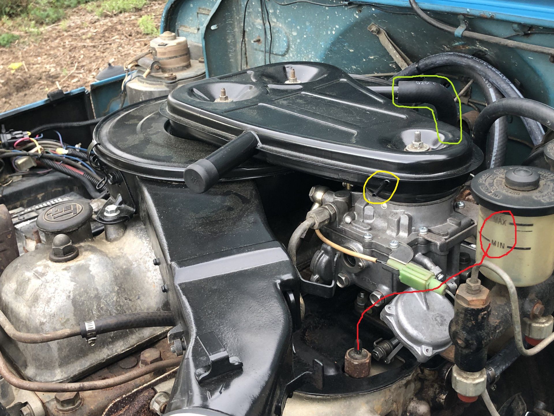

Enjoy some delicious free tech support:
Replace the air cleaner hex nuts with rubber gasketed Toyota wingnuts, 90175-06003.
Cap the vac fitting on air cleaner lid (circled in yellow). It's just letting dust & dirt right into top of the carb.
Replace the valve cover breather hose (circled in green) with Toyota 90910-05101. The molded heater hose currently installed is not oil proof and will turn to mush shortly.
Connect the choke breaker (red circle, hidden by MC) to a manifold vacuum fitting (red line).

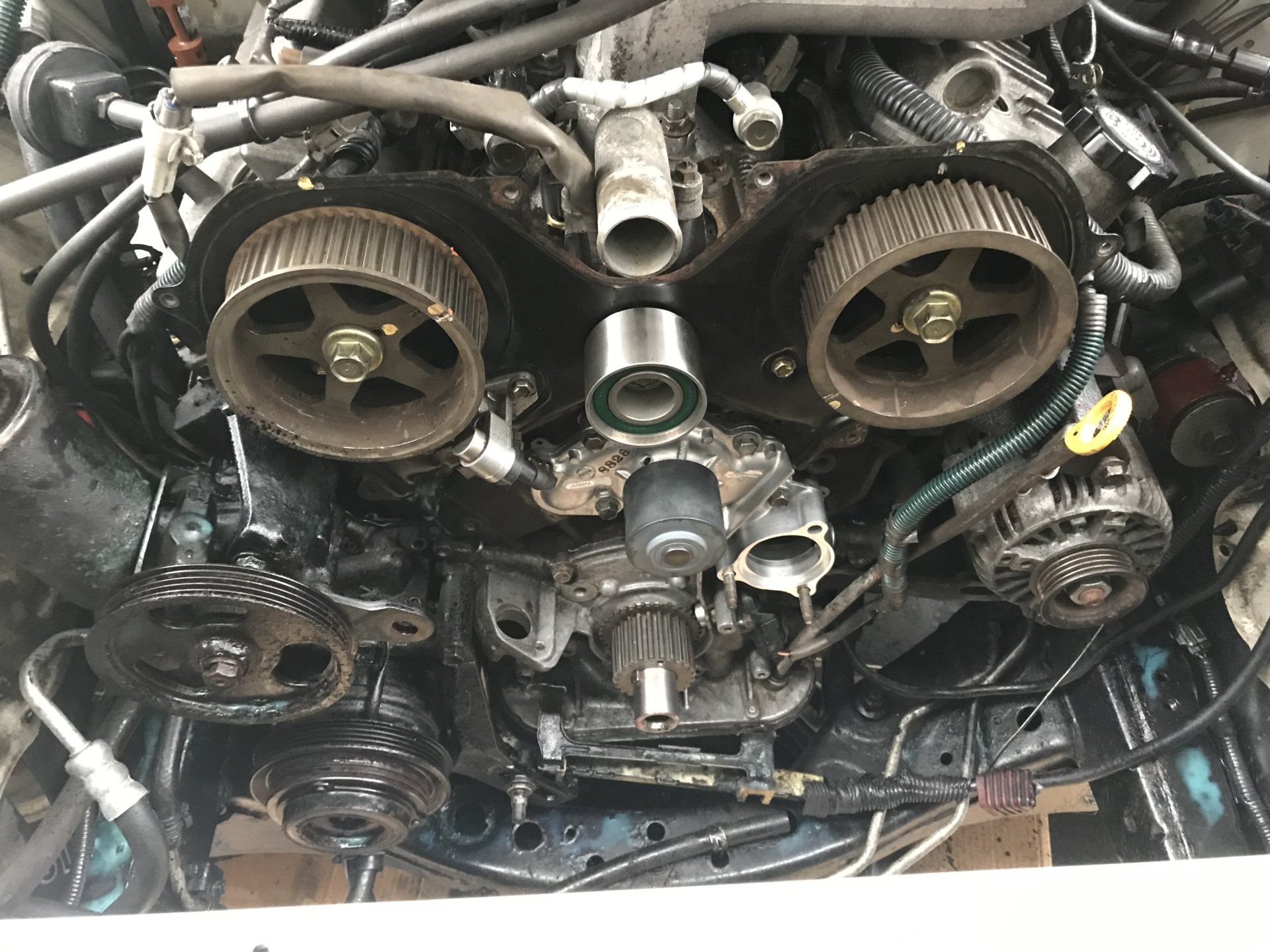

I just finish fixing my 3rd Gen 4Runner and found out I had a bad injector. The past couple weeks I have been fixing the 4Runner which included water pump, timing belt, pulleys, cleaning out the intake manifold , new gaskets and seals. I also powder coated a bunch of small parts that were rusting out. It looks like I might be able to make the green run with the group and it will be my first time I have driven the truck on a trail.

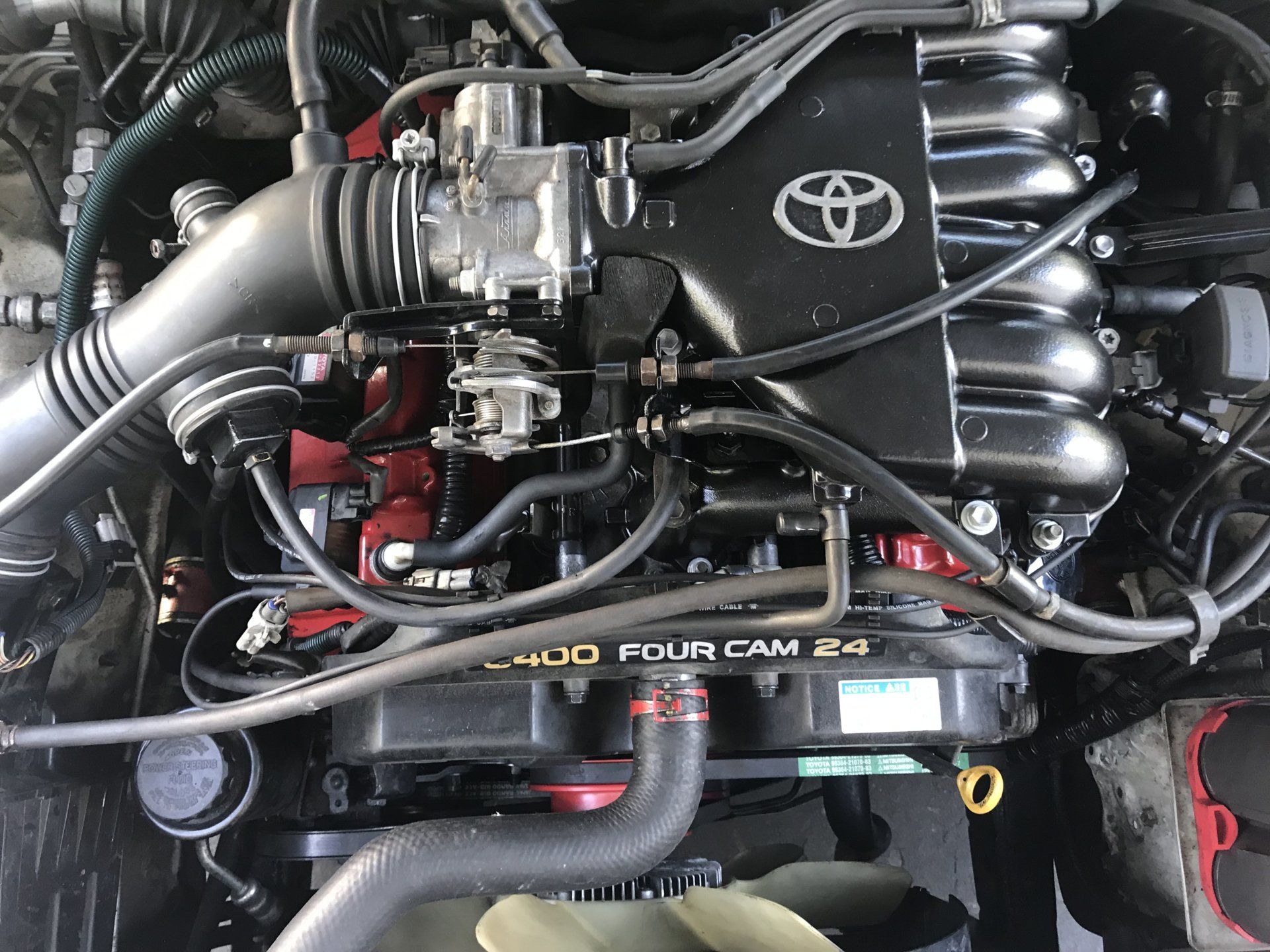

Looks great, nice work!
Looking forward to seeing it!
So clean and shiny... I miss those days lol!!
Looks awesome dude!!!

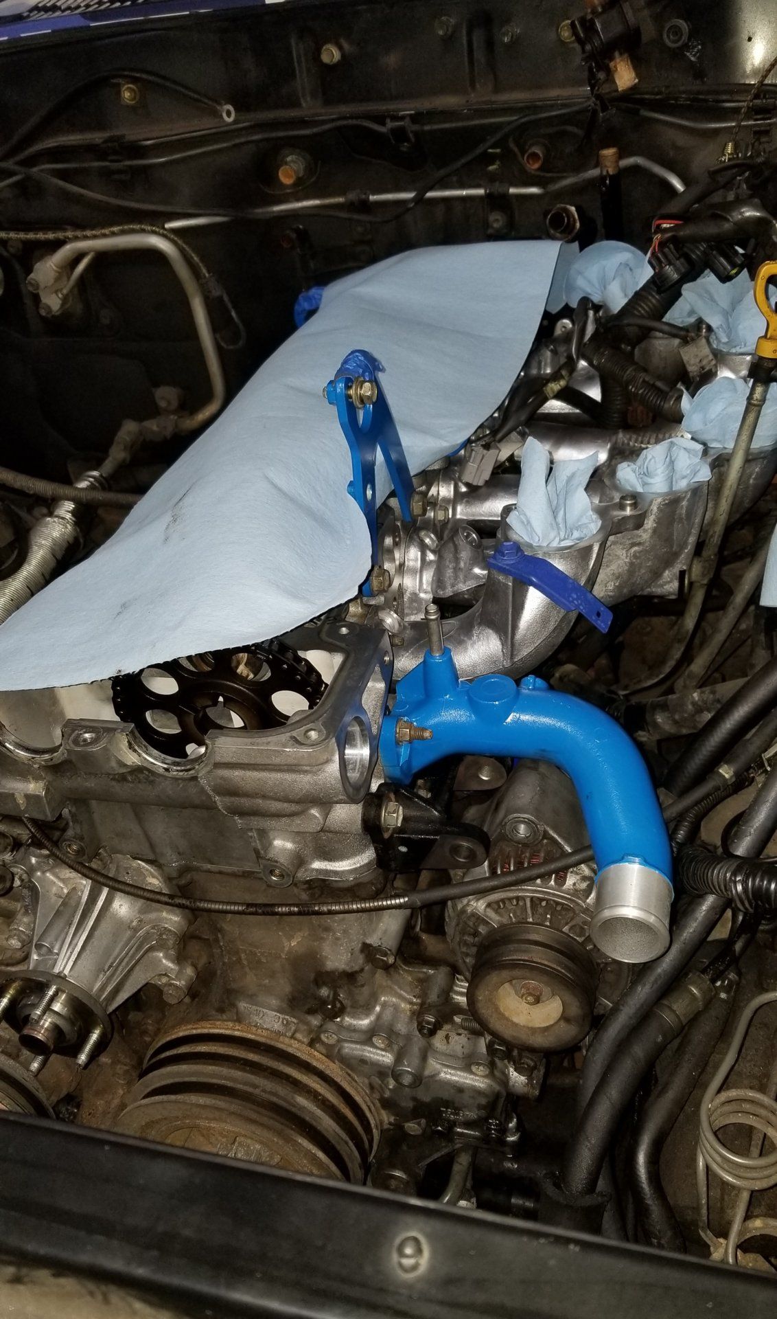

Made a big step forward as well ... the head is on an head bolts torqued properly. Started on the intake cam install, but kept doing things wrong so called it a day.
Found another connector that broke off during removal that I hadn't noticed. Water temp sensor I believe. The wire just fell right out of it. At least it's in the front and easy to reach.
Had my first out of order assembly as well. Had the fuel rail and injectors mounted while the head was on the bench. Getting the harness through proved sketchy, so I had to remove it while it was in the air on the hoist. Very much not looking forward to getting the fuel lines hooked back up on the filter and reassembling the upper intake. After that its all gravy ***he said with much false bravado***

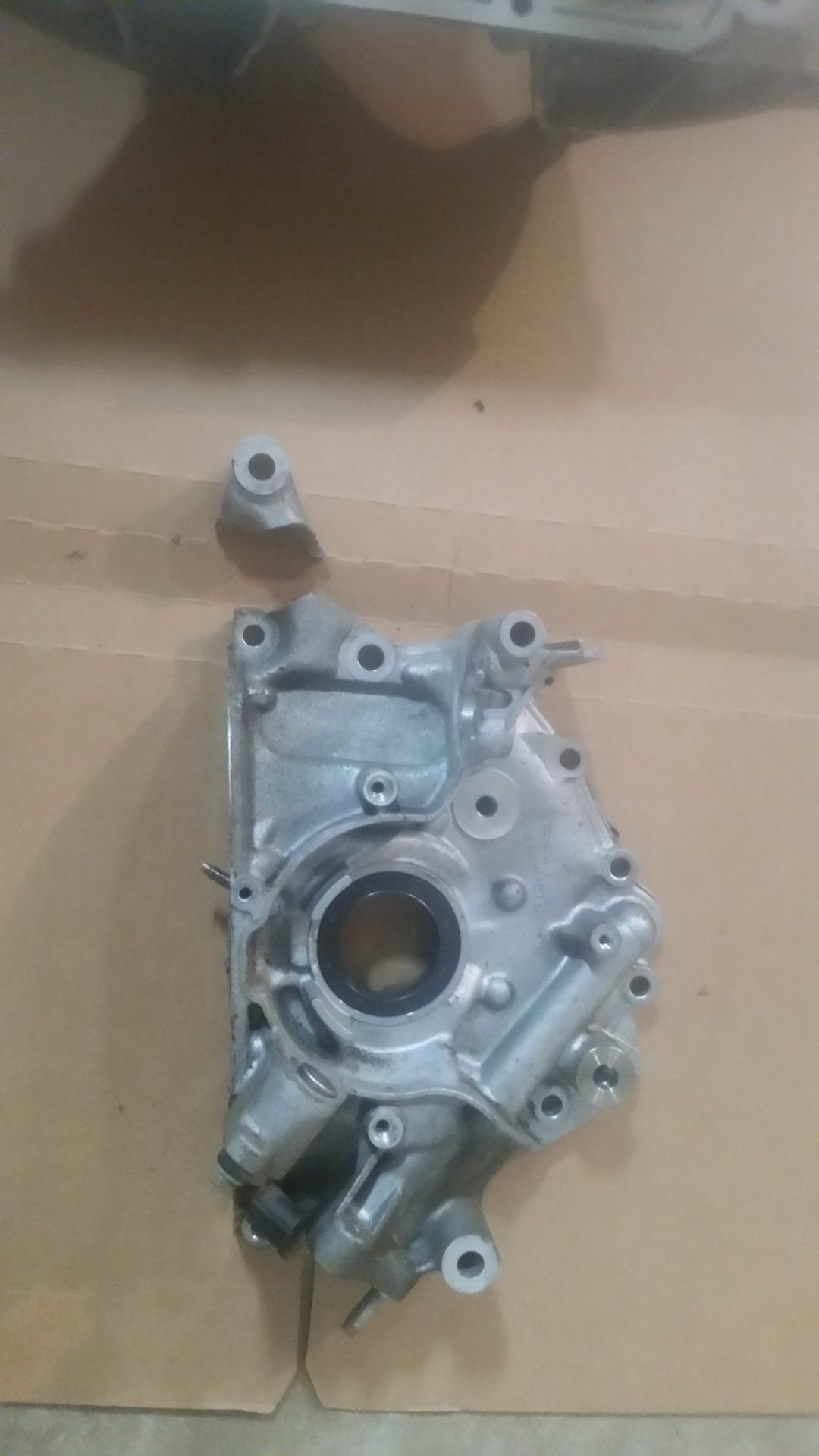

Somthing so small can turn into so much work. A broken tab can turn into removing the oil pump, which requires removing part of a oil pan. Now this stud is in the way, double Nutting it fails and damages the stud. Now I am removing the entire oil pan to fix a tab and stud.
