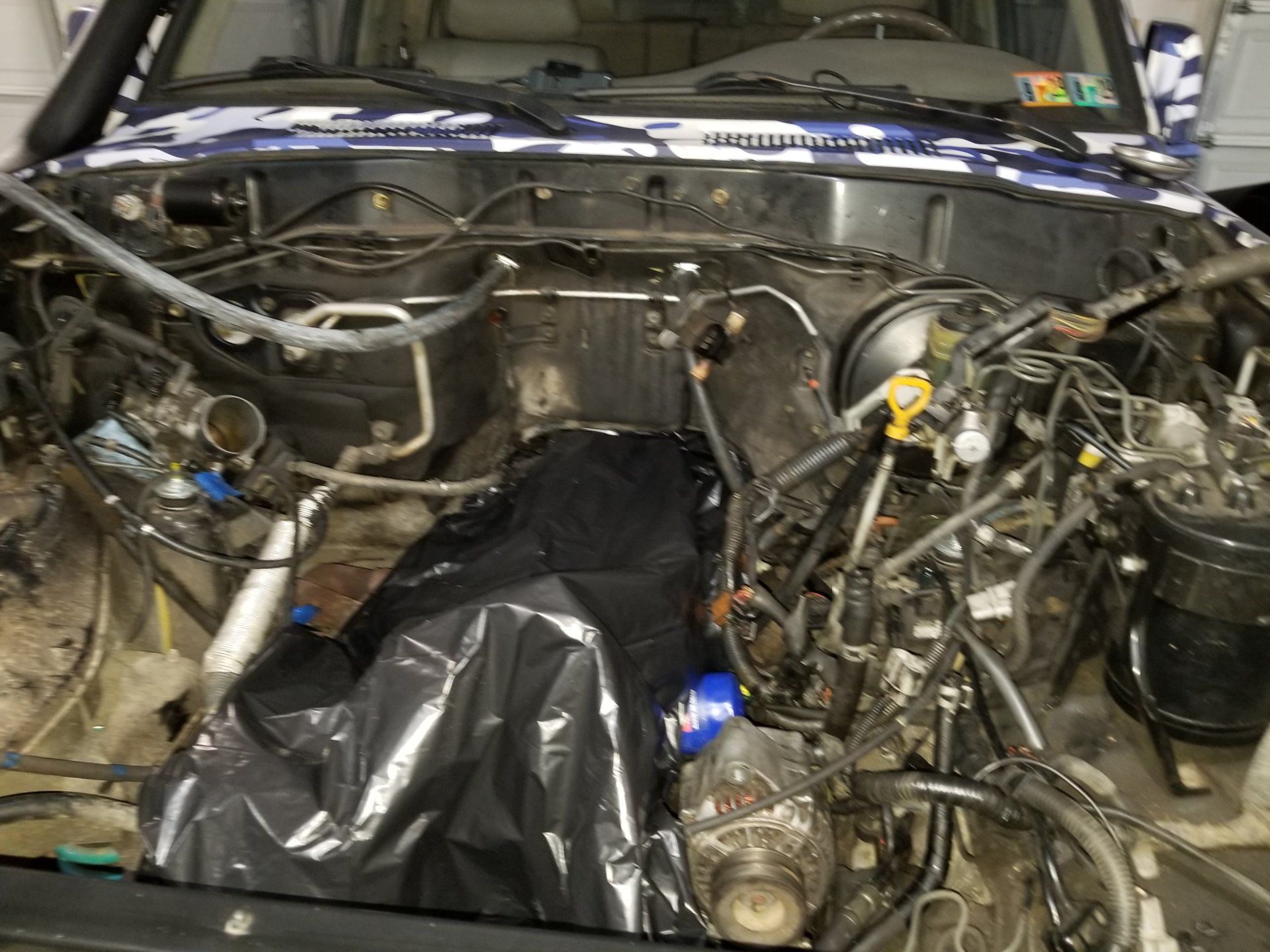

Checking small things off the list while waiting on the head. Valve cover cam back cleaned today, so another piece is back. One of the things on the list is the rear heater delete. With no carpet in the truck it got hella hot in the cab during summers unless I ran the AC. Got all the factory clips and hoses removed and figured I should go ahead and purge the heater core just in case ... $30 in hoses later and its done.
Sorry for the blur .. have a few beers and it comes right into focus

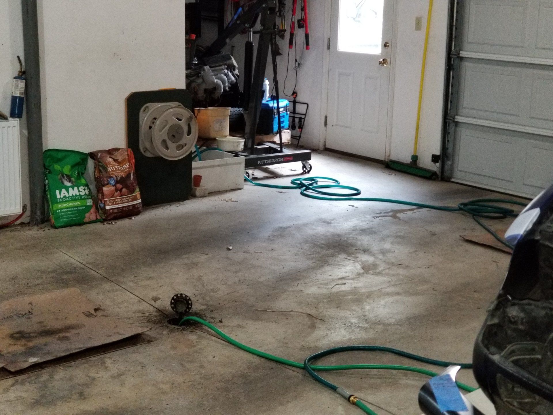

Ran the drain hose into a bucket until it was clear, then down the floor drain in the garage. Disappointed that it basically came out as clean coolant. Was hoping to get some muck out?

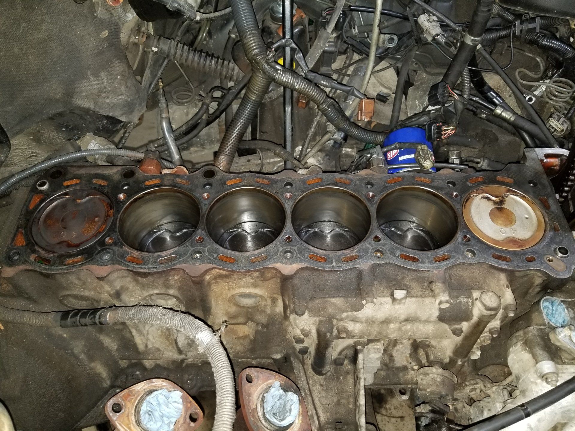

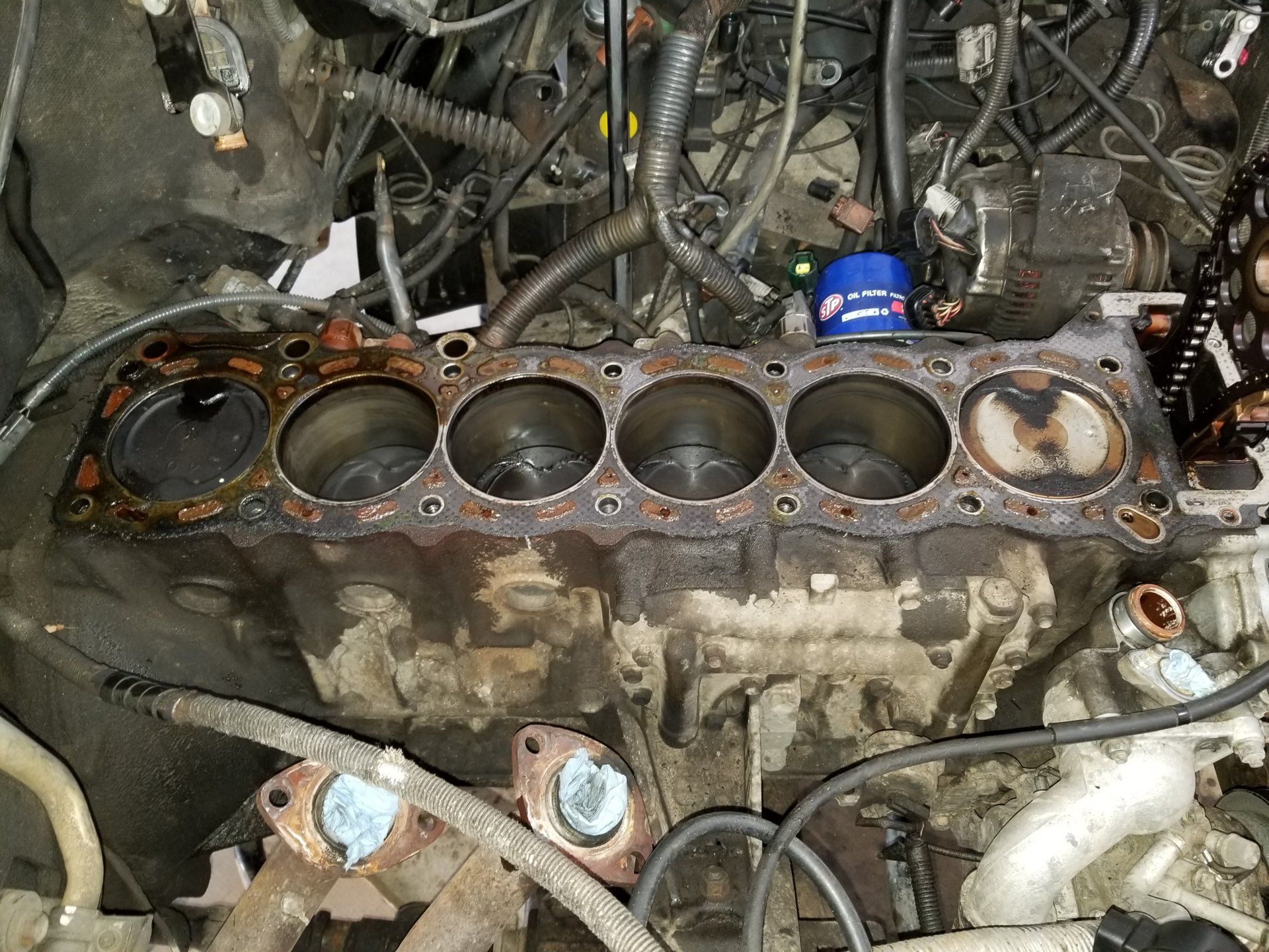

Remounted the alternator after getting the steering pump back on and then took some time to clean up the block surface. 90% of the water jackets were clogged off with the Bars stop leak crap from the PO. It's now on my list of things to never do to an engine.
Before:
After:
Worst part so far was standing in the engine compartment on the frame and cross-member with a scraper in one hand and shop vac nozzle in the other. A few of the passages were so sealed shut that I had to use a pick to get the bars to release and be picked up by the vac. You can still see the Bars gunk coating everything, but at least all the passages are open for now.
