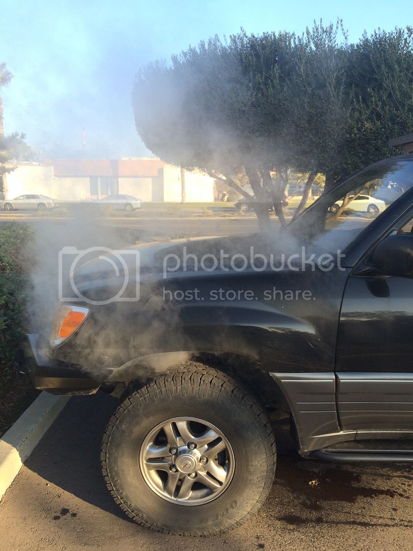

I put it off and put it off and put it off and paid the price. At least it didn't happen in Death Valley. The T literally disintegrated on me. I replaced both Tees, but I suspect plastic pieces fell inside engine during the process. I am running HOT, HOT, HOT after changing the tees. Clearly the cooling system is not working as it should. Is there an easy and cheap solution for fishing plastic pieces out of cooling system?

Fast forward to now, I showed her the pic from OP above. Told her this is why I did what I did - she said "I dont remember what you did 6 months ago". The things that I do to make sure she would never get stranded anywhere with our kid alone.... Thank you for posting this. It makes me feel better that when I insist on how things are done for our vehicles, I am not just crazy ;)

No harm no foul here. I just needed to run it with cap off for a while and add some more coolant.
I blame myself for this. I had planned on changing tees for a while, but never got around to it. Simple and cheap process to swap these out, no reason not to. Its a good idea to keep a spare. I went OEM on replacement but brass has me curious. Its kind of a silly weak point on what is otherwise solid platform, but i'll take this over the fuel system and other reliability issues on Land Rovers any day.
