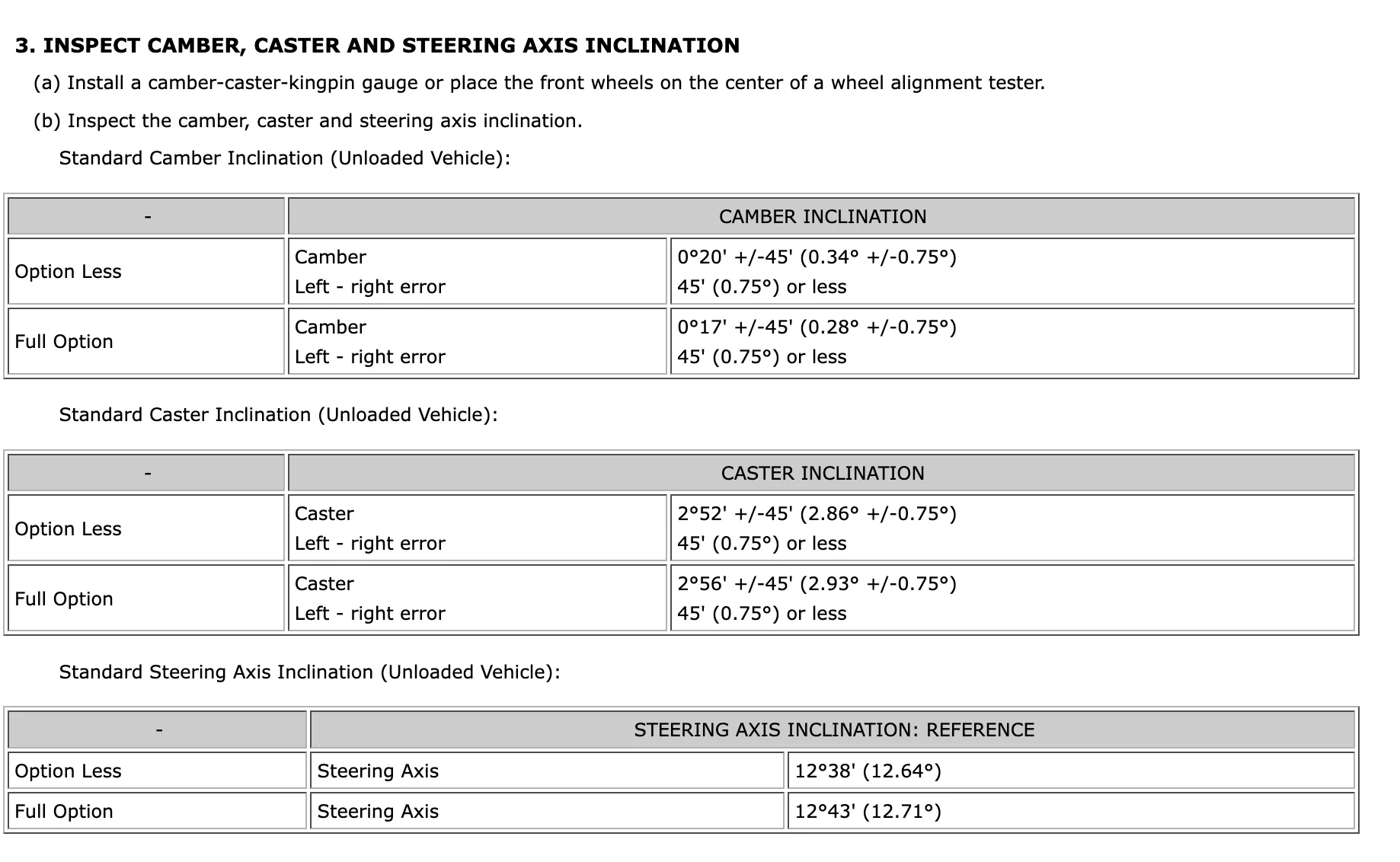

So it's just occurring to me that I only have specs for a landcruiser, not a LX.. though I'd expect the numbers to be very similar if not identical.
This is from the 2013 LC factory service manual, other years would be the same.
Turns out I was a little off on my memory.. @linuxgod has written extensively about alignment specs if you want to do some digging.
Note that "option less" and "full option" refer to the option package of the vehicle. It says earlier in the article that that can change ride height by a couple millimeters. I'm not entirely sure what I'd do on a LX that can correct ride height.. maybe @TeCKis300 has some info.

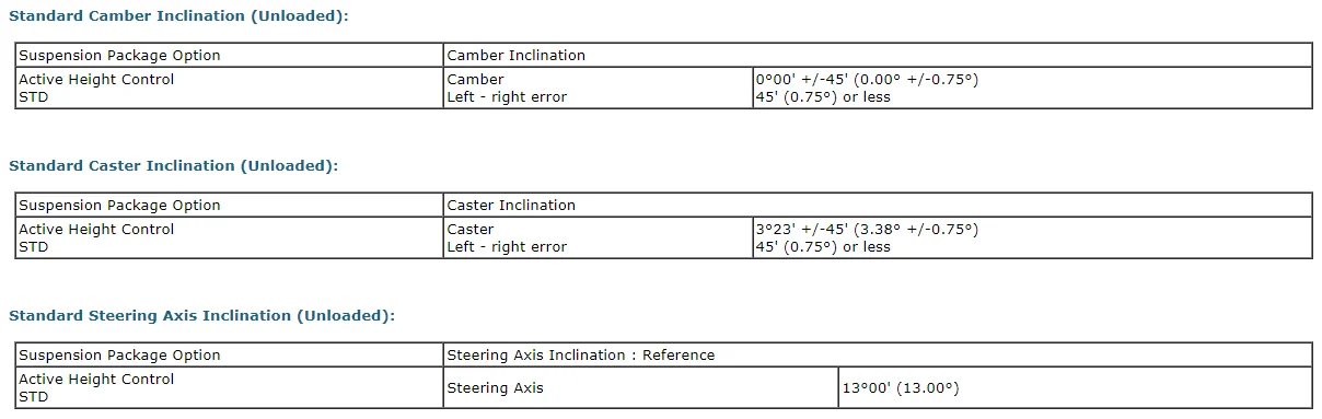

In regards to alignment, it's somewhat similar. The LX has constant ride height because of AHC, so doesn't really consider full or lesser optioned. Alignment calls for less camber, probably due to less nose dive and the need to compensate for braking alignment. And a touch more caster, probably to account for usage of AHC high.

Are those specs you posted for the LX?
