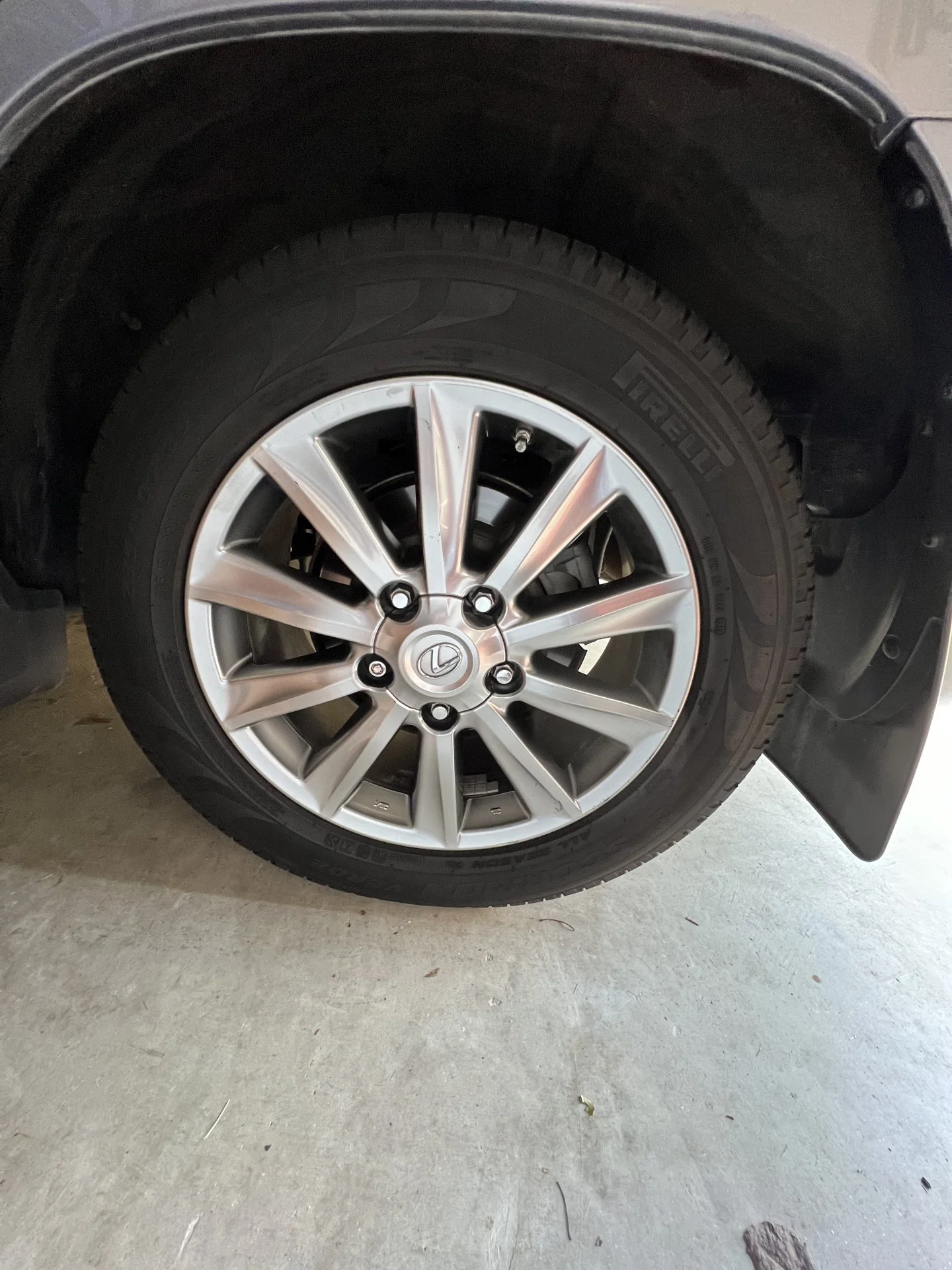

I just bought this LX a few weeks ago so IDK how old they are. There’s plenty of tread left and the guy who did my alignment (who sells tires) said they’ve got a lot of life left and look good. I checked them and don’t notice any cracking or wavy spots.
They’re Pirelli Scorpion Verde All Season Plus 285/50 R20
Use this link to determine age of tires.
