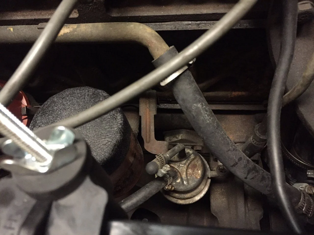

I can’t imagine a carb running better than my Jim C tuned stock Aisin on a correctly desmogged 2F. No way would I replace the OEM Aisin with a Weber.
To narrow down a fuel starvation issue you could try running a boat fuel tank to the fuel pump. I had a 90% clogged fuel line once that allowed the engine to start and idle but it would stall out under load. Blowing the lines with compressed air didn’t fix it. I eventually applied vacuum to the fuel line and could barely suck any fuel through. Once I fixed that the engine ran great!
