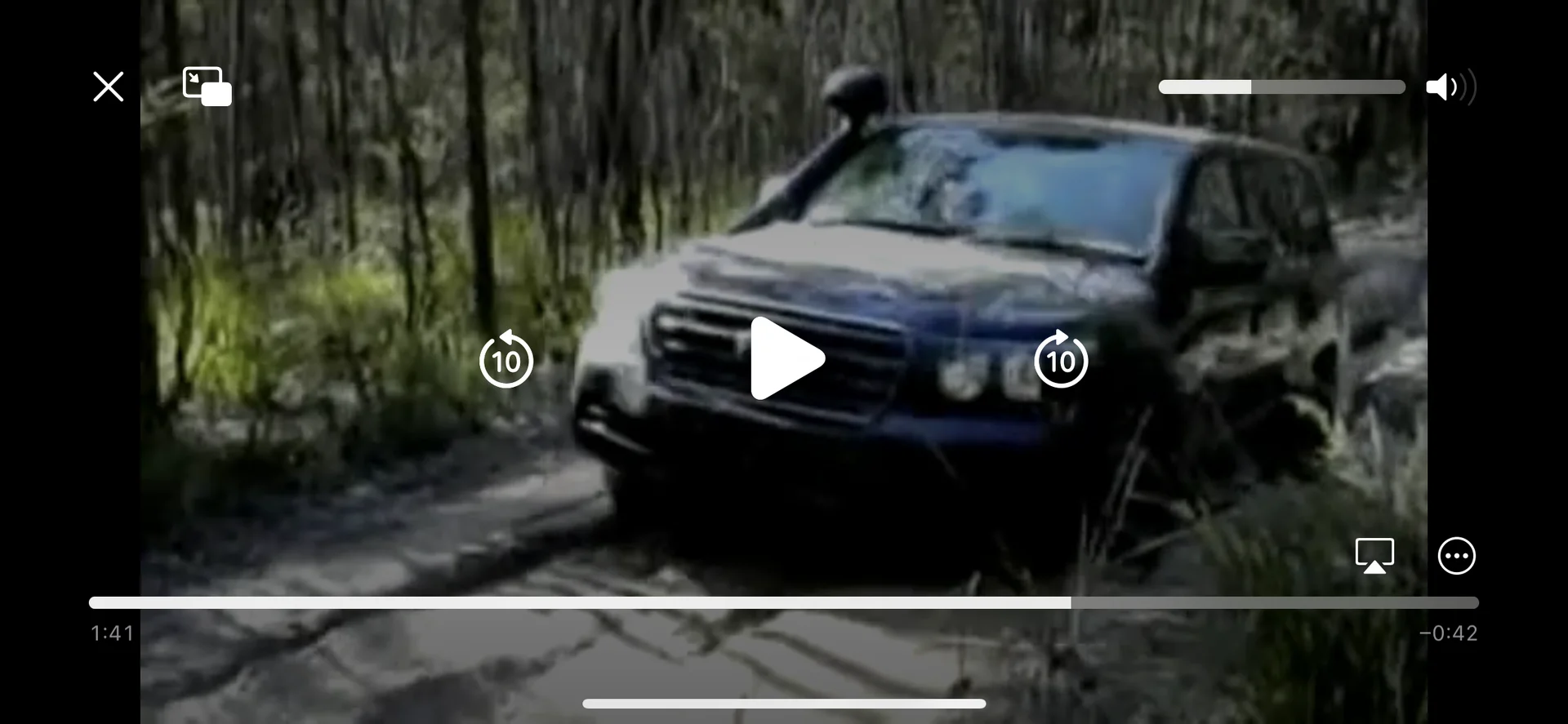

Why didn’t this snorkel make the market?
I believe it did, looks like the stock Toyota snorkel:
