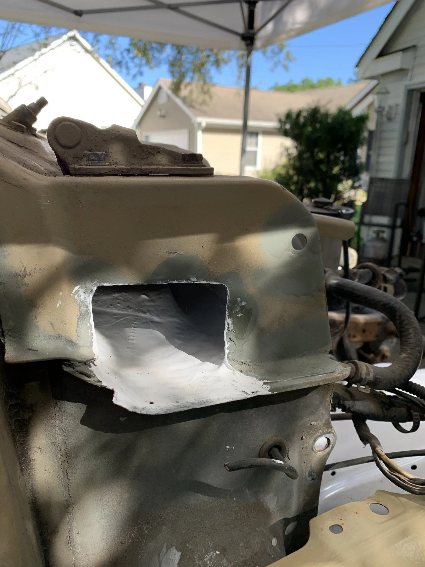

Look above to the windshield for leaks or it could be the usual rust hole that forms inside the fresh air intake plenum. I had a hole on both sides that could only be accessed by removing the fenders. Time consuming but not hard. And better than having water run down the fuse box.
Most likely I am just blind, but where was your leak in the picture? I have a leak on the passenger side and I am suspecting its coming from that area. The windshield has new rubbers and seems legit. The water runs down the panel and under the mat so it has to come from inside the panel.

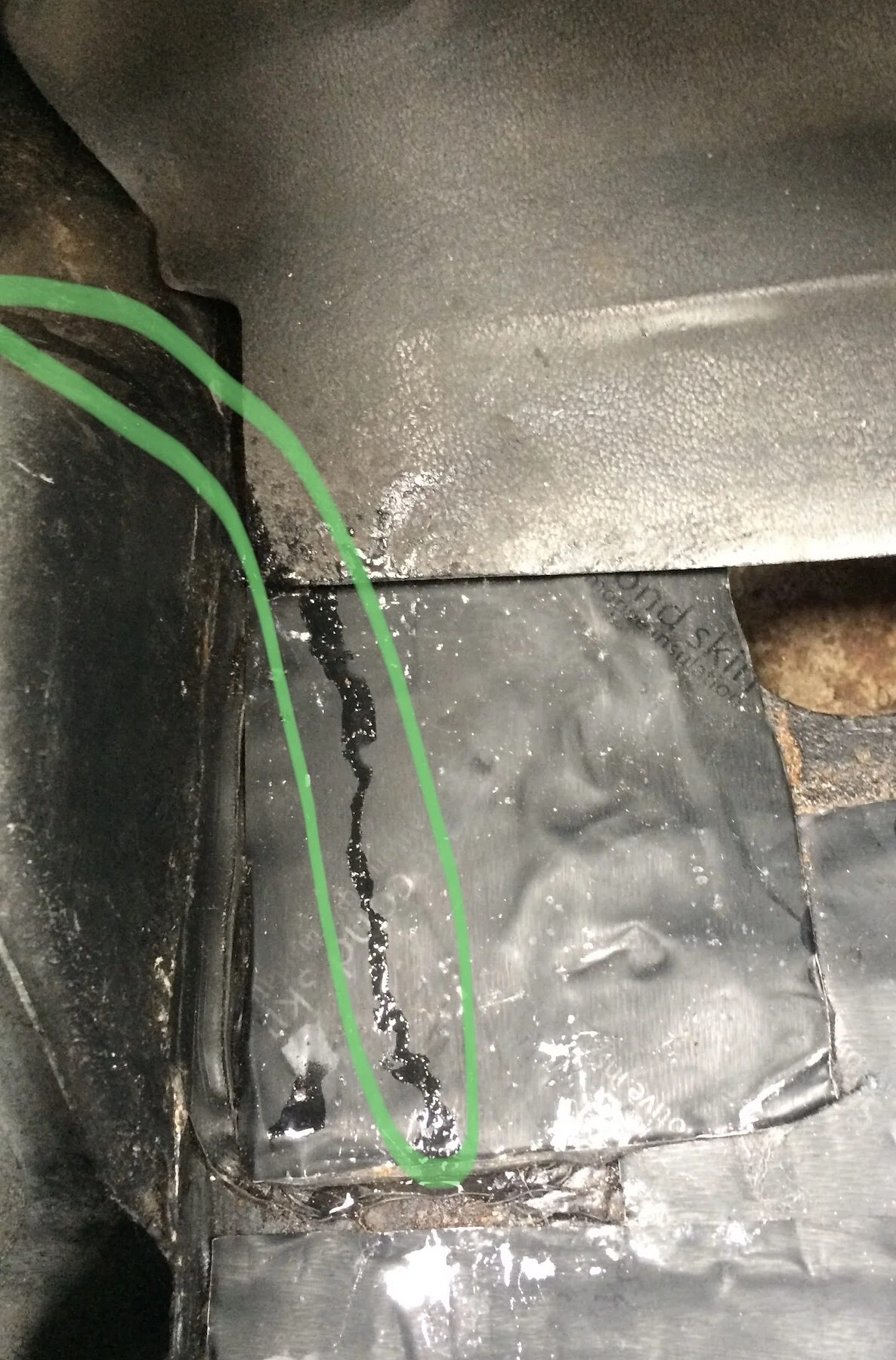

I'm trying to trace down a water leak into my right foot well.
It clearly drips down from where the air blower is. Either beside it or even from it.
I suspect that " rust hole in the fresh air intake", but couldn't figure out yet where exactly to look for such rusthole.

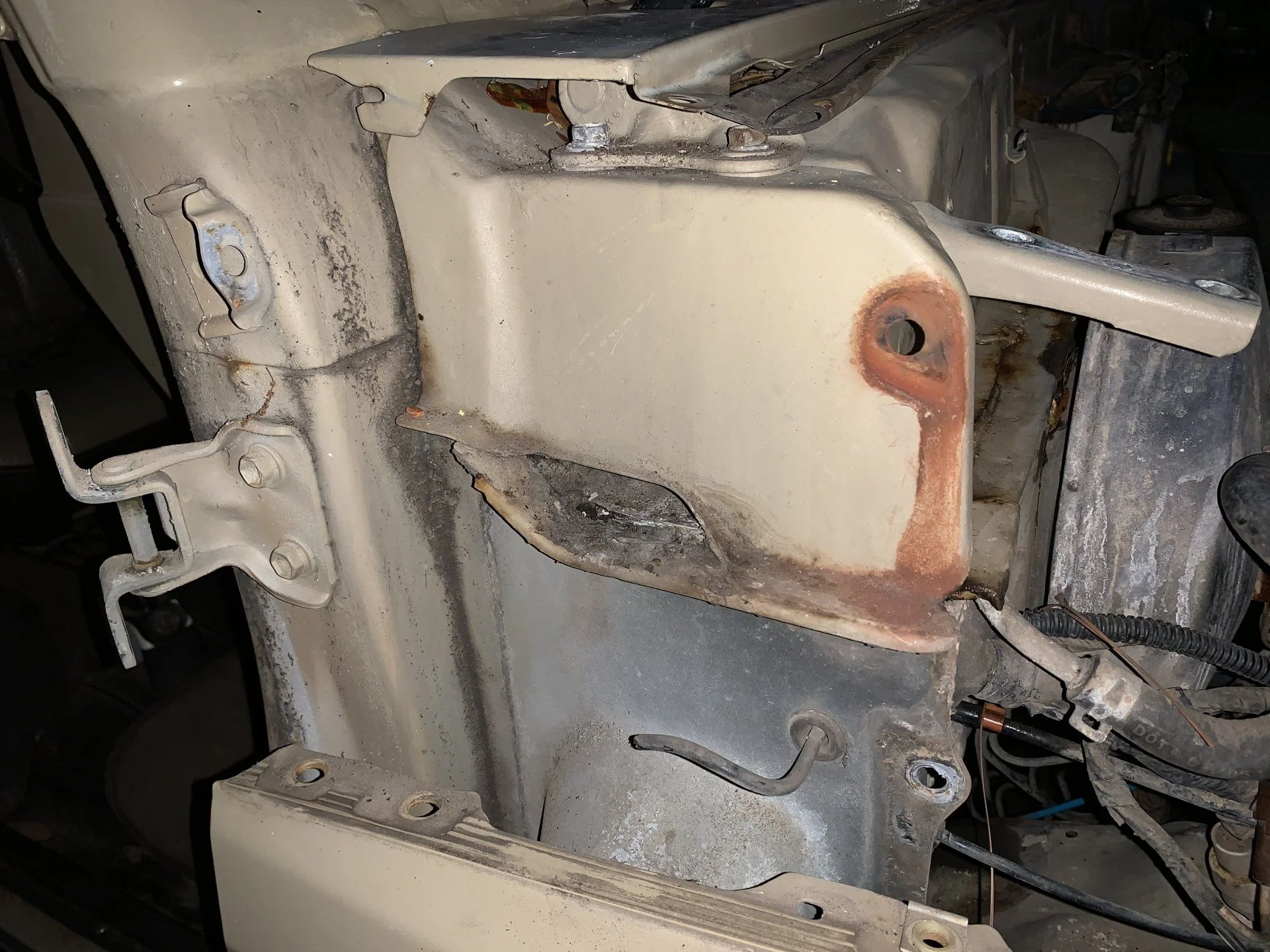

I understood, the water is supposed to run on that panel, which was sealed in white, and drain to behind the fender, through that hole, @RhinoRig opened up 'a little'. In other words: If that panel (sealed white) forms a rust hole, the water drains into the cab?
Can anybody tell where that would be visible from inside behind the dash / glovebox?
