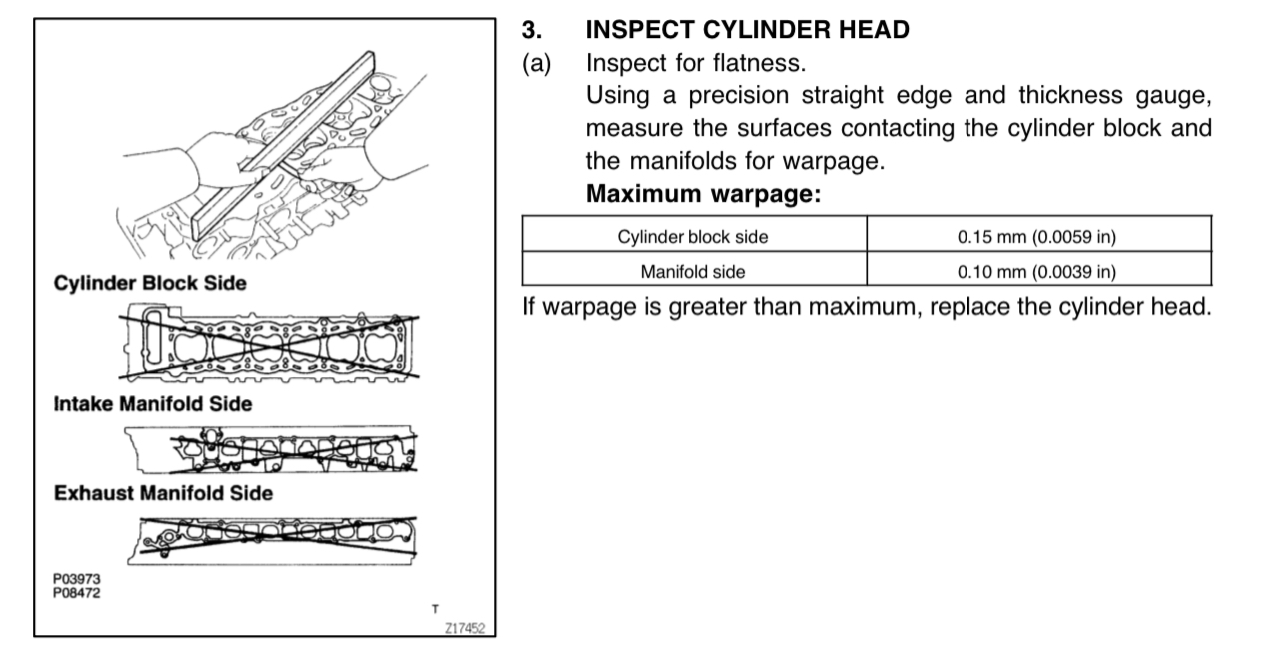

I had a call to pick up my head and I hope I heard wrong. Machinist said head was warped either 60 thousands or 6 thousands, couldn't hear him very well. I know Spec is .0059 but 60 thousands is a junk the head no? I am pretty sure I know where to stand but would like confirmation, as this area is newer to me.
If .060 off, it seems they are taking me for a labor ride when they should have just billed me for checking warpage and sent me packing. I am going to clarify when I go down there.

It's not .060. You could see that by eye and use the head as a corkscrew.

FSM yes, but from searching, most on here have no issue milling .006 off and running with it.
I was just looking for an obvious answer to my question of it being junk at .06. My lack of confidence wanted more experienced individuals to back up my argument should I have one when I go down there in person. Their phone skills suck.

Ok, it was at .006. In person they are great and helpful. Everything is buttoned up and back in my possession.
Others may disagree, but I would straighten that head for sure....by putting it on the block and letting the head bolts flatten it out.
They machined flat the .006.
