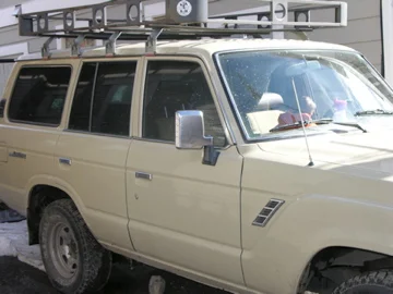

my new Fj60
I figured a picture of my "new" FJ60 was in order. Thanks
