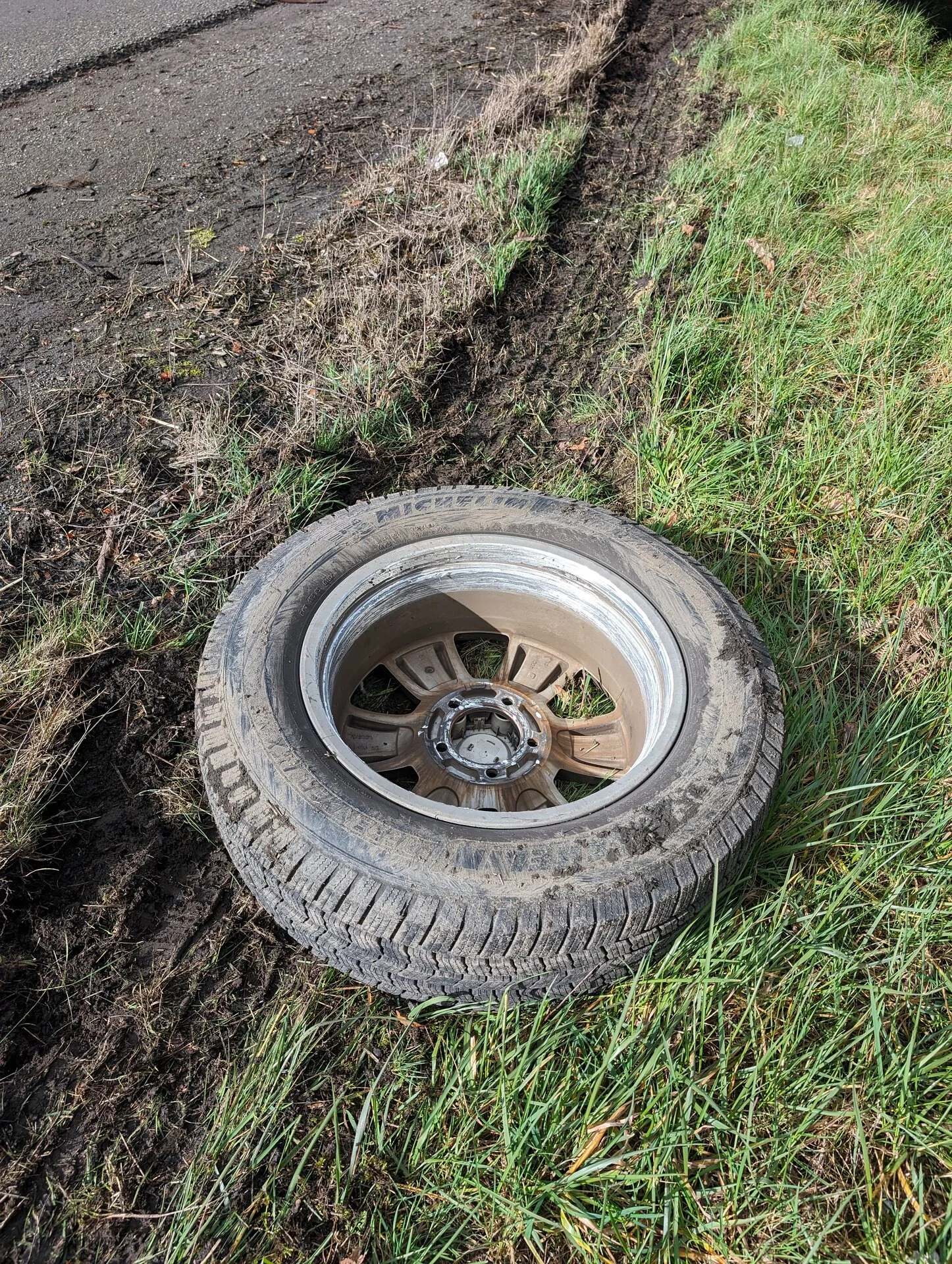

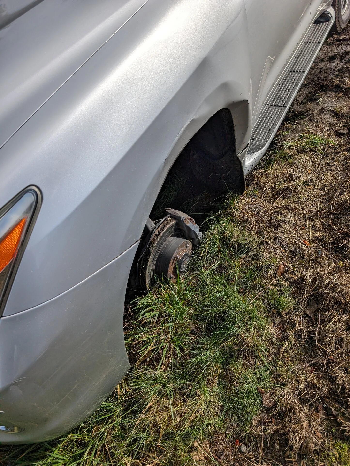

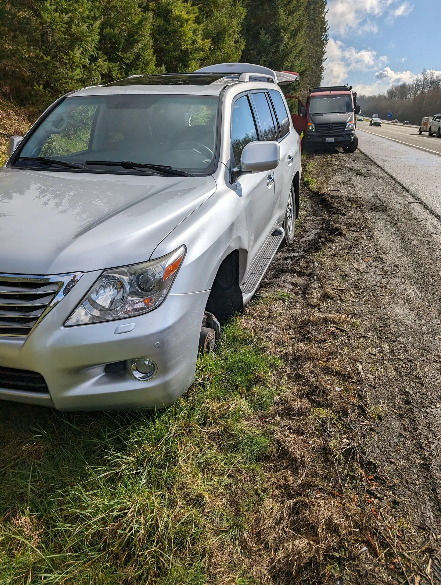

Over the weekend I drove from Seattle down to Portland for my son's basketball tournament. During the weekend I went over multiple potholes in and around Portland and Vancouver Washington. At some point my front drive wheel started making a kind of weird squeaking noise, it sounded like my brakes needed to be replaced. As the day went on, the squeaking turned into thumping and some vibration at higher speeds. My next stop was Les Schwab, they pulled off both front wheels and did a visual inspection and spun the wheels while on the lift with no noticeable noises or problems (brakes had plenty of life left and the front wheel bearings were replaced within the last 50k). I watched the technician reinstall the wheels and torque them down and we were on our way. The next day on our way back home we made it about 50 mi on the highway and my wheel flew off the car, thank God I was in the far right lane and was able to get off the road before the wheel came off. I'm racking my brain on what would cause the lugs to back themselves out???

Hard to see but it looks like the studs broke off. If so, may have been damaged on the potholes and when they torqued the nuts, it gave them the final stretch they needed to finally snap.

speculation on my part but from a distance the rotor seems deeply gouged or at least uneven wear, frozen caliper? studs look sheared- possible over torquing after inspection?

Definitely due to wheel nut torque. If I had to wager, this issue came about prior to your trip to Les Schwab. For whatever reason, and you might be able to fill in who last worked on the wheels, it is more likely that wheels were under-torqued. This led to cycling and fatigue wear on the studs. By the time Les Schwab got to it, the damage was done. The last torquing of the nuts did them in.
To a degree, it is more dangerous to under-torque than over-torque for bolt seeing cyclic loading.

New quarter panel and any door or rocker panel and side step damage is probably the most expensive part of the repair. You’ll likely need a new hub, studs, and brake rotor, but all those are cheap. I suspect all the rest of the suspension etc is actually fine.
Over-torqued Lugs..100%.. that will break the studs.. you have at least 2 broken ones, chances are one broke, causing the others to break.
Verify with a torque wrench on the other side wheel... set it to 100ft-lbs and see if it clicks before the nut turns and work your way up to breaking torque to get an idea.
