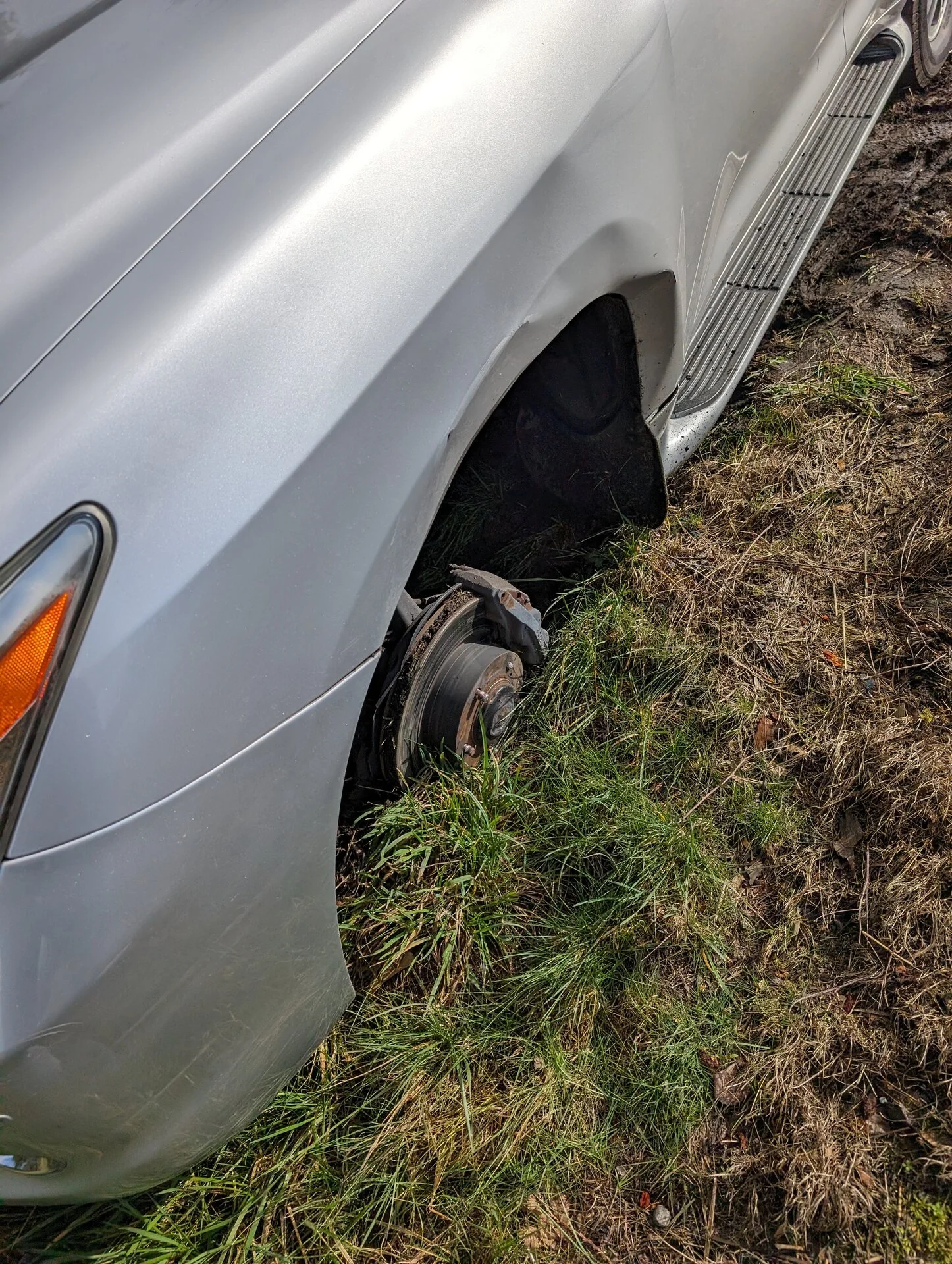

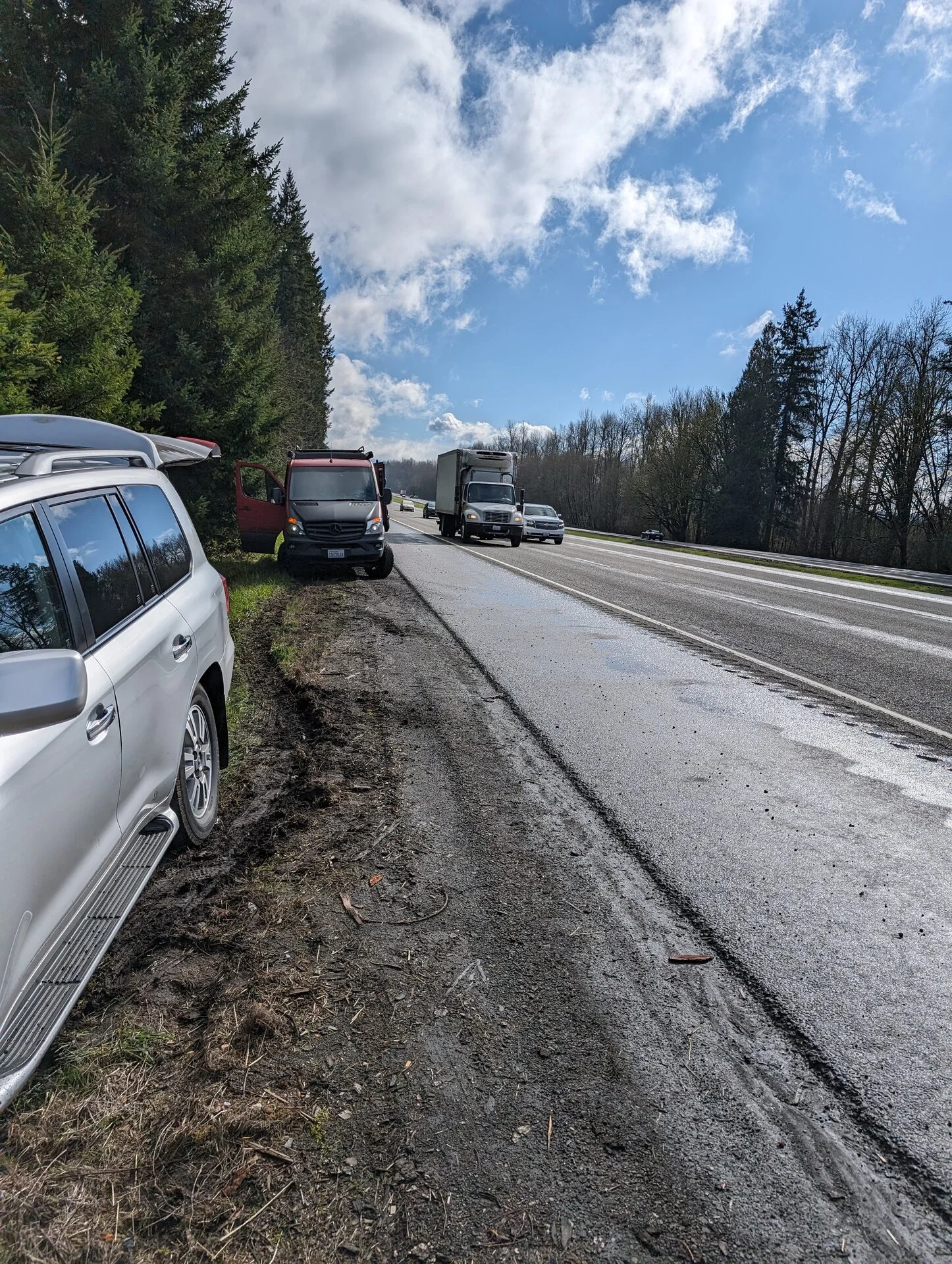

Vibration / squeak / thumping (not a good outcome) wheel fell off
I tend to agree with this. Torque spec for steelies is 154ft-lbs, so the studs should be able to take way past the 97ft-lbs spec for alloys.
Oohkay… I will tomorrow morning tourque my steelies. Must have made a mistake a few years ago when I researched the tourque for my wheels like „oh 150, fine“ without thinking about someone was writing about ft-lbs.
So my car is driving since years with 150Nm‘s -> 110ft-lbs…. and I did alot of sketchy stuff with the car (you wouldn’t believe how far a 200 can jump…).
Maybe the good thing is that I had removed the tires like every half year to work on things at the car. Maybe this and the fact that steelies are a bit more tolerant saved me from a situation like it happened to OP.
And yeah I also think that they might got kina loose over time or didn’t had enough tourque -> that damaged the studs with the years/ months/ whatever -> then the retightening with the right tourque finaly killed them.

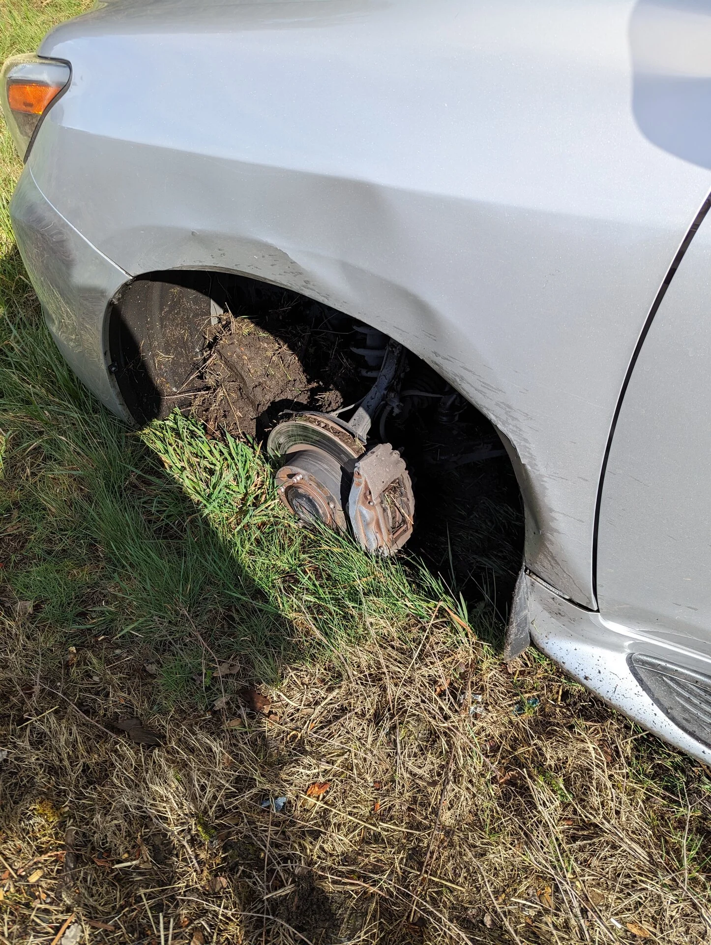

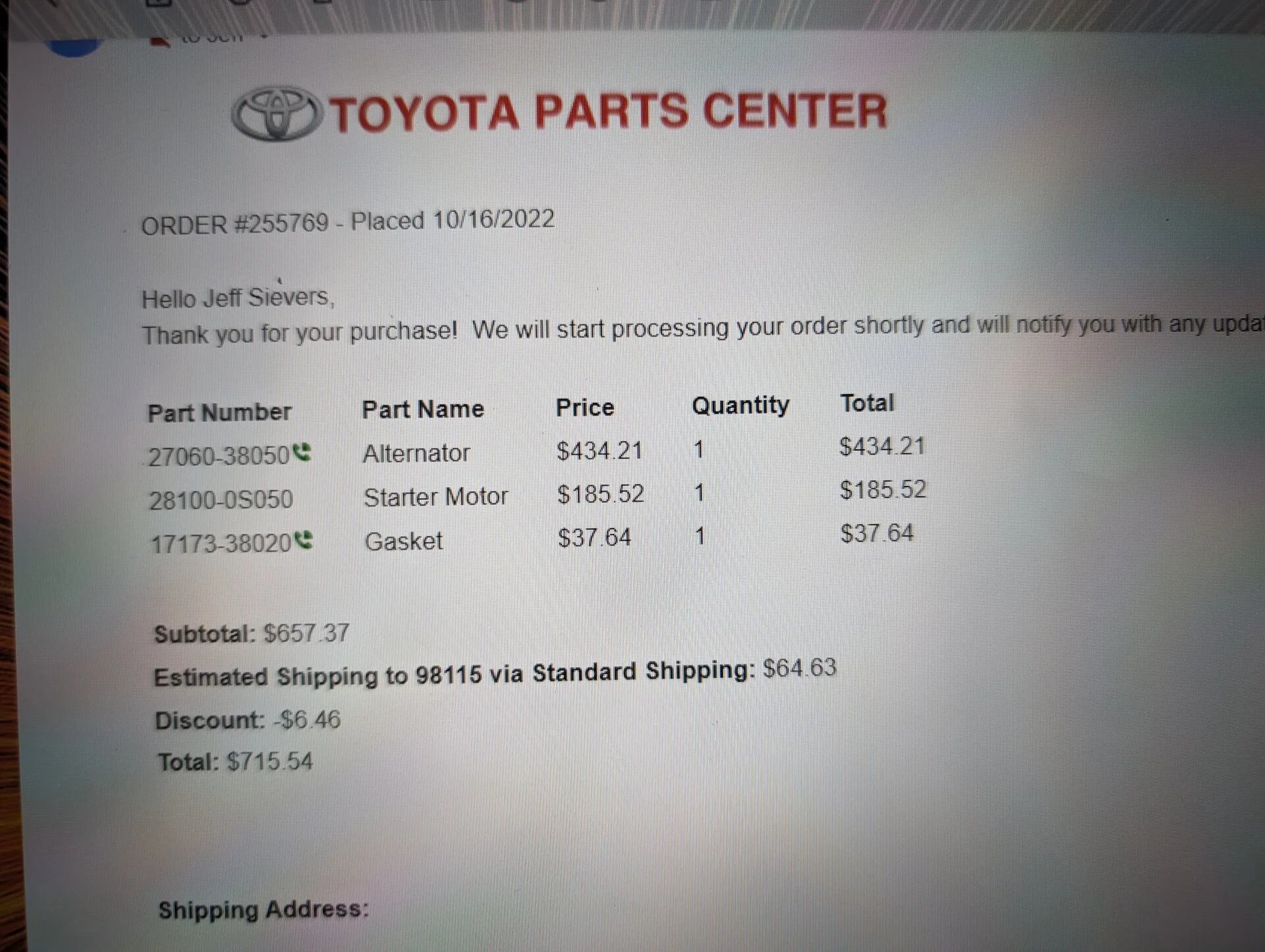

I talked to the claims adjuster about how they decide if they're going to fix it or salvage it. From what I gathered they get a guaranteed bid amount/ salvage value from Copart (insurance company salvage yard/ auction house ) then use that number against the retail value/ payout amount. Some place in between that spread there is a cut off, she told me that they generally salvage cars that have lost their wheel because the unknown damage to steering, suspension, frame... If you are a mechanic, this will be a good deal for someone. Over the last 2 years I had done all of the maintenance (starter, alternator, water pump, radiator, front wheel bearings, battery). This car is parked at the Portland, Oregon salvage yard.

I could easily see the lower suspension crossmember making contact with the ground with a lost wheel, and that’s work most shops won’t want to touch, given it’s a part of the frame and can’t easily be replaced. Also the lower ball joint, LCA, ball joint bridge, all in harm’s way.

When the wheel came off, I was on the shoulder in the grass. You will need to replace the front wheel studs, and then you should be up and running. The front wheel and tire should be in the back of the rig; that is where I left it.
