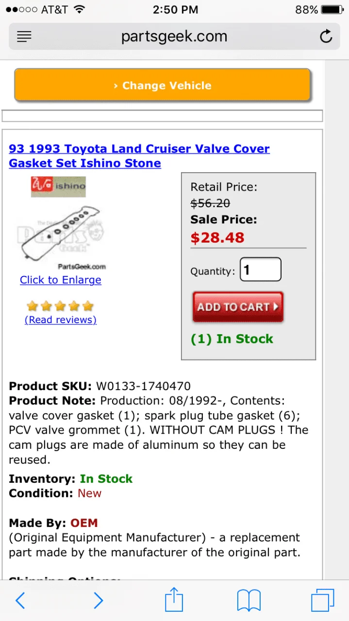

Also does anyone know why on partsgeek.com it says ishino stone is "OEM"
I used the beck Arnley set on mine a couple years ago. Still no leaks. I also used their tube seals. No issues. Great product and it was pretty inexpensive
View attachment 1337487 Also does anyone know why on partsgeek.com it says ishino stone is "OEM"
Ishino may be the OEM Supplier for Valve Cover???
I know they are OEM supplier for the PCV valve grommet of which I would replace at same time else it fall in when removed and you have to remove valve cover again.
