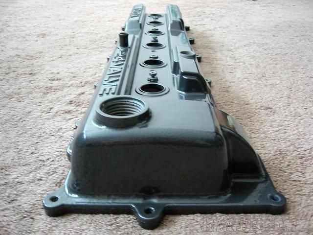

Had my valve cover hot tanked and bead blasted today. Sorry, didn't take before photos but it did have some baked on varnish inside and was oil stained and oxidized on the outside. Noticed that a ton of sludge was semi-trapped above the riveted-on baffle plate. After hot tanking/washing it we pressure washed the baffle area from the ports in the top of the cover and gobs of softened sludge came out the few openings. Then I sprayed a couple of cans of brake cleaner through the ports and more crud came out. If I were to do it again I would let it soak with some strong solvent sitting up in the baffle area and spraying that out before taking it to the hot tank. Only concern I had after the fact was that I noticed that the edges of the baffle plate had been sealed up against the underside of the valve cover at the factory with a sealant and some pealed off from the hot tank washing. The process didn't take everything off, you can see some FIPG still stuck on near the front. Now the question is what color should I powder coat it?

My main goal in powder coating it is to make it easy to clean but would like to keep it looking OEM Toyota. If I put it back on as is the cast aluminum it will dirty up all over again. I'm leaning toward something like pewter or silver. Talked to one powder coat place, they said there is a lot of taping work to try to powder coat two different colors, he said it's easier to coat the whole thing one color then hand paint the letters.

aclos3: It cost me $40 to have it hot washed and bead blasted. Looks like it will cost $150 to have it powder coated one color, a slightly metallic greyish/silver. The painter said he cleans the surface with some kind of acid then bakes it at 400 degrees after applying the powder.

Will know how it turns out monday and will post photos once it's done. Hope they can get all the old oil out of the pores of the casting; there are still some some spotty stains right up front even after the hot tank and bead blasting. Another shop that does powdercoating said their method is to heat up a cast aluminum part after cleaning and then will let it sit outside to sweat a couple of days, then wash it again before coating. They said sometimes the powdercoat still bubbles up from old residues stuck deep inside the cast aluminum. IDK. Keeping my fingers crossed.
At my work now we anodize roughly a few hundred aluminum parts a day. Mainly mic6 and 6061. What was said about anodizing is 100% correct. Also if you do it black, its fingerprint town. If you do not polish the cover I will guarantee you will get a speckling in the anodizing. Anodizing tho does scratch very easily and does rub off in time if there is something rubbing against it like wires or a hose.
