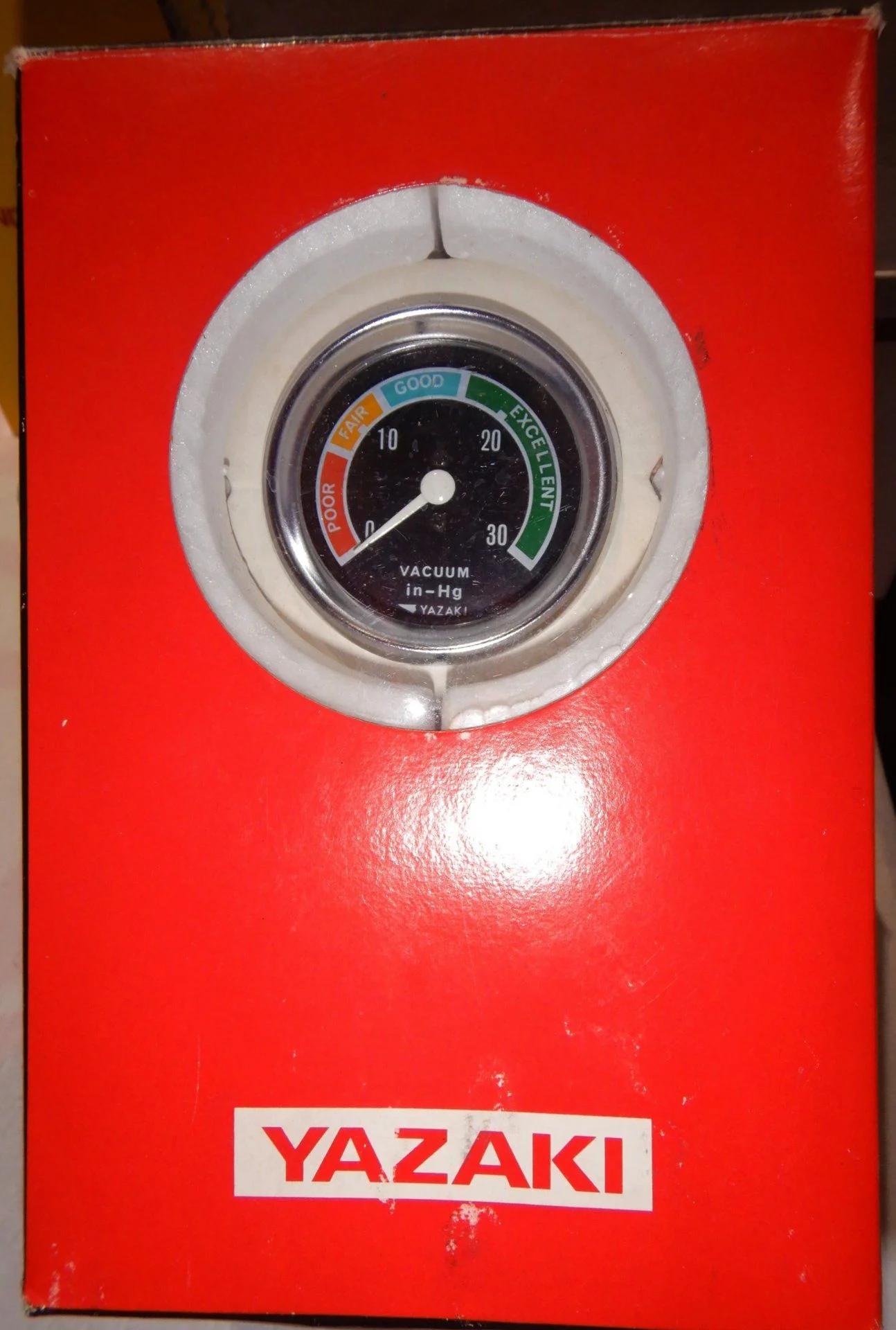

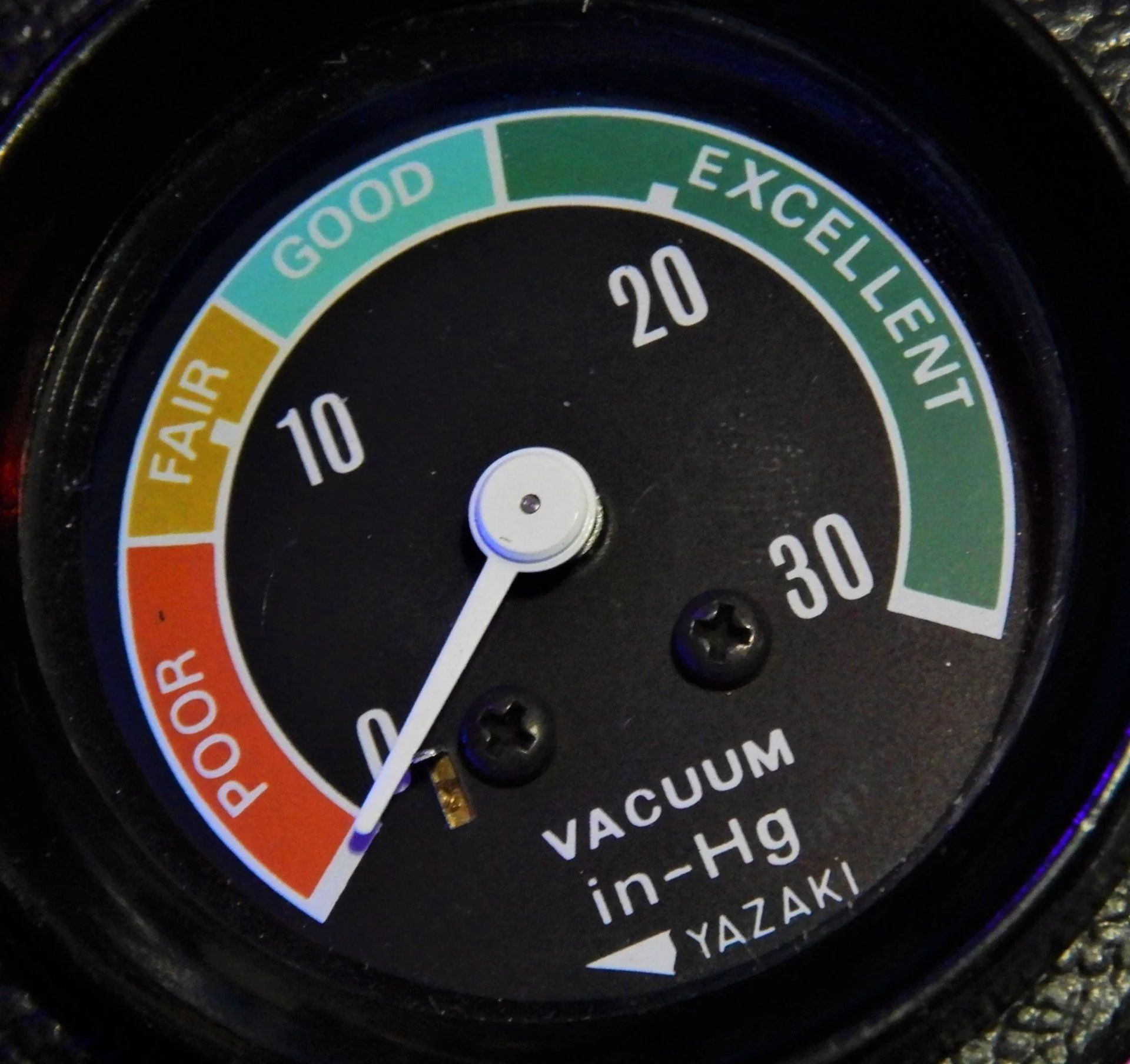

Also Mike ,
if u can find one , This is In No Uncertain words the Best Stand Alone VACUUM Gauge on planet Earth ever made
It's precision Level , Steady and True 1 Motion Needle Sweep back and forth is Kilometers Ahead of Anything
you see in the Summit Raging Catalog today in 2019 . This is at least me 5th , YAZAKI VACUUM Gauge
I have been Rolling with YAZAKI Gauges of all kinds since College in the 1990's and they never get tired it seams
it matches and compliments the Instrument Cluster Gauges , which are ALL made By YAZAKI as you might
already know .
Thanks, I have not seen one of those gauges in years . We had one in a Pontiac GTO. Mike
