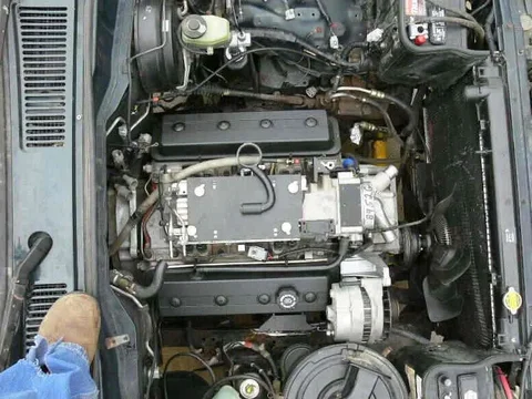

As far as routing air, either go with a 1LE air intake or go custom. The marine unit does not use a MAF sensor therefore will have to be adapted. You can also buy an aluminum piece from Paxton that bolts to the air valve and can be plumed to the MAF then to a filter. 1st pic is using the Paxton piece, second is the 1LE piece. Both have provisions for the IAT sensor.

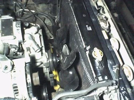

Here are some pics of the mechanical fan mocked up. I never knew this fan existed, it is from a LT1 Caddy Fleetwood. Ironically it is in almost the same position as the 1fz fan is. I could use the OE fan shroud with minimal trimming.

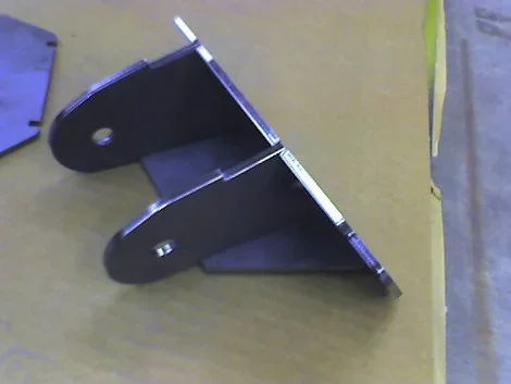

Did I here you say they were cut by laser? Very cool. My buddy has a water jet cutter and I use it some for brackets. The laser seems more precise, but not as versatile. Lets see some progress pics.

Laser cutting is more precise and faster than water jets. Lasers can hold +/-.002tolerance on size and waterjets are more in the +/-.008 range. Both are better than high definition plasma.

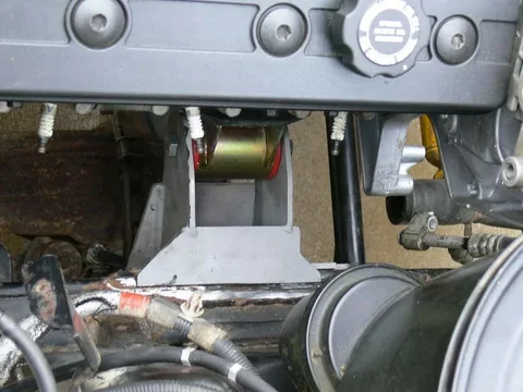

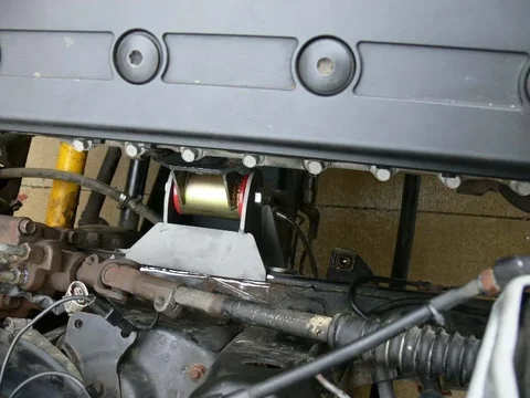

Anyhow, the pics I posted of the tacked driver side mount fit perfect. Tomorrow I will work on the pass side. The motor is not in the true center of the frame so the passenger side is about 1" longer.
I am semi perfecting all these parts and documenting all my work. All of my fabrications will be for available for anyone else interested in doing their own swap.
The engine is finally sitting on the mounts. I have the mounts tacked heavily enough to support the engine. When I take the engine out I will finish weld. P1000059.webp
