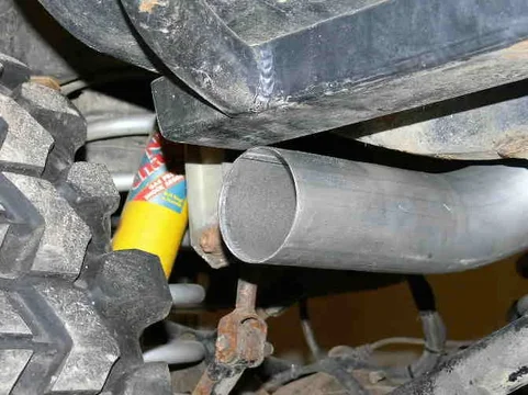

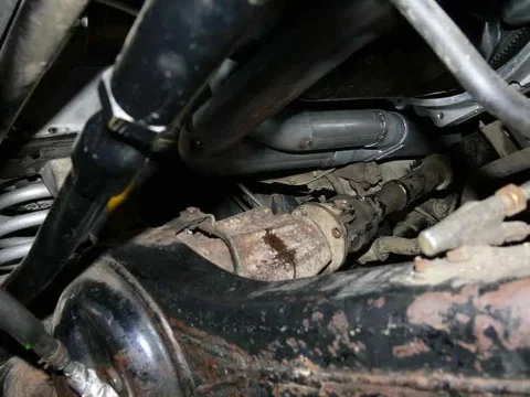

Here are pics of testing the exhaust clearance relative to driveshaft movement.

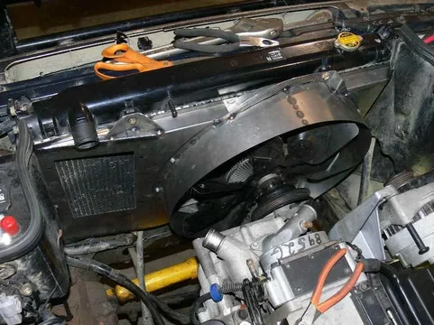

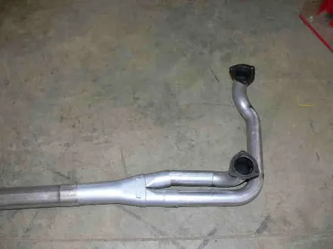

Lunch break right now. finished exhaust pics attached. Working on the fan shroud with additonal transmission cooler right now. Learned some new tricks on the shift points from the l/c guys down under. Basically I am working on all plumbing related items now. After this it will be wiring and then VROOM.. If all is correct. Oh everyones been asking what his thing will be identified as when completed. I came up with something simple... was FZJ80 now will be V80

Is that dual 2.5" into a single 3" Y pipe? Looking good so far.
I am making a SS square exhaust tip and building 1/4" battle armor attaching to the slider around the bottom of the tip to protect it. I like the idea of the sidepipe, kinda musclecar-ish. My factory rear exit exhust was always taking heavy fire from the rocks.

3D model of new fan shroud with mount for additional tranny cooler. Will laser cut and bend tomorrow. Material will be .048 thick steel powdercoated semigloss black.
Kirk
Fan shroud in place.... Need to mount to the cooler, finish TIG welding and then it can get powder coated.
